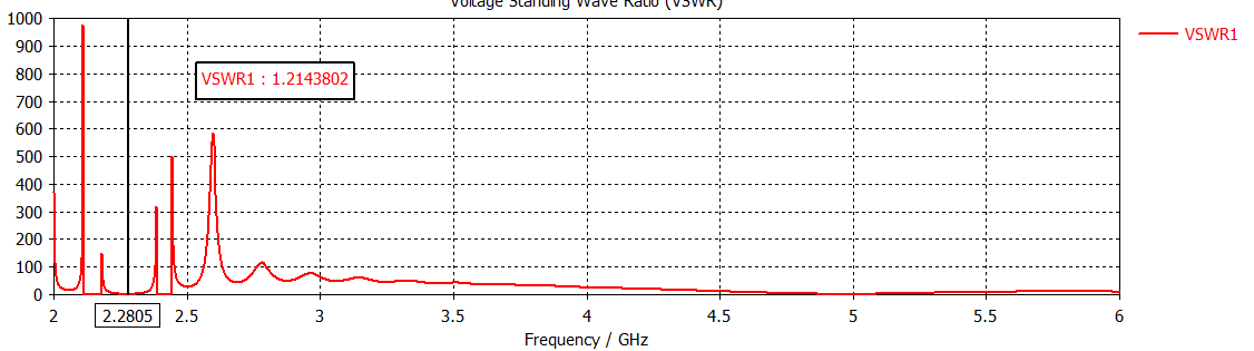

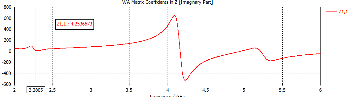

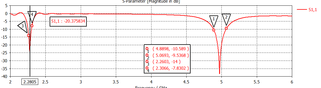

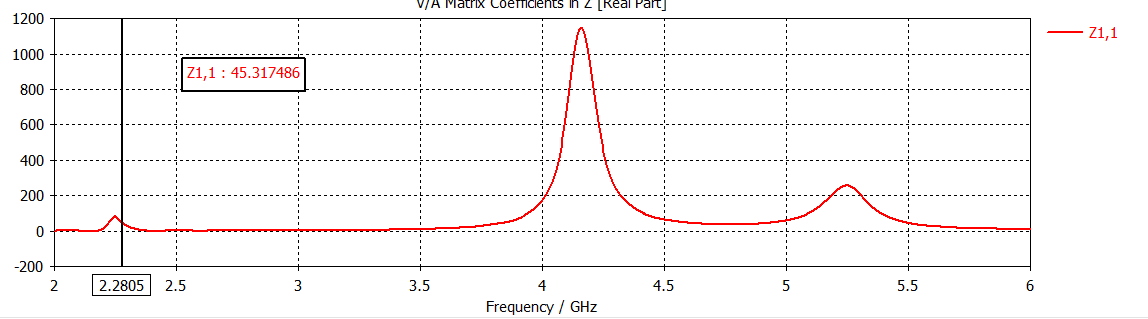

Mean I can use this 2.3GHz result to replace 2.6GHz for LTE applications?
Thank you.

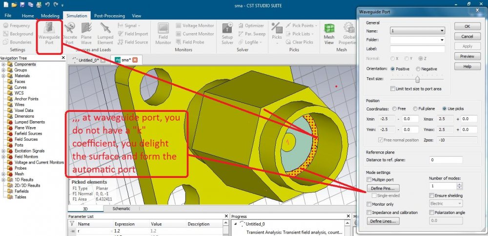

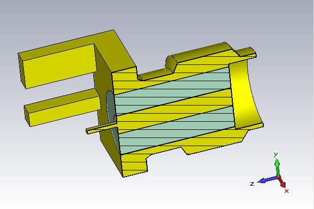

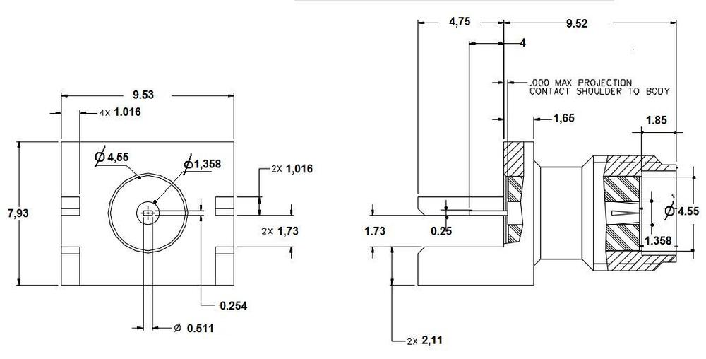

,,,you can try to put this sma conector...
I am using RoHs 5265757 SMA connector. Although the 2.3GHz impedance is nearly matched, nut the gain is still negative.
TT.
you can post here the sizes or possibly the file * cst...???
,,,that would be simulated with SMA connector...

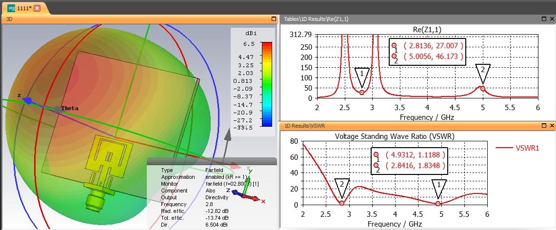

The concern is after the SMA connector is added, the gain of the antenna become positive or not. So the gain improve to positive?
Thank you.

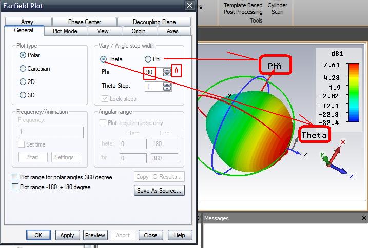

Is it constant phi 0 degree for H-field and 90 degree for E-field?

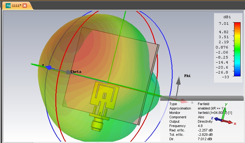

1111.cst

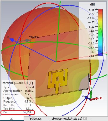

The Gain is negative .
,,,,where from...!!!!

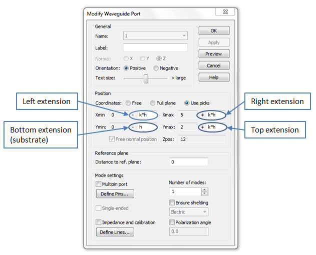

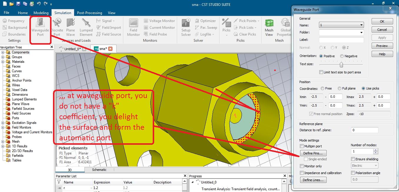

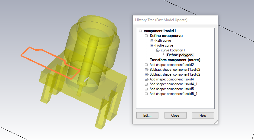

Question : i am confused about polygon in SMA Connector?

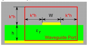

Question 2: how we can calculate the value of "k". Please admin help me
i know this one , i am finding the suitable formula to calculate the value of K for impedance matching.
