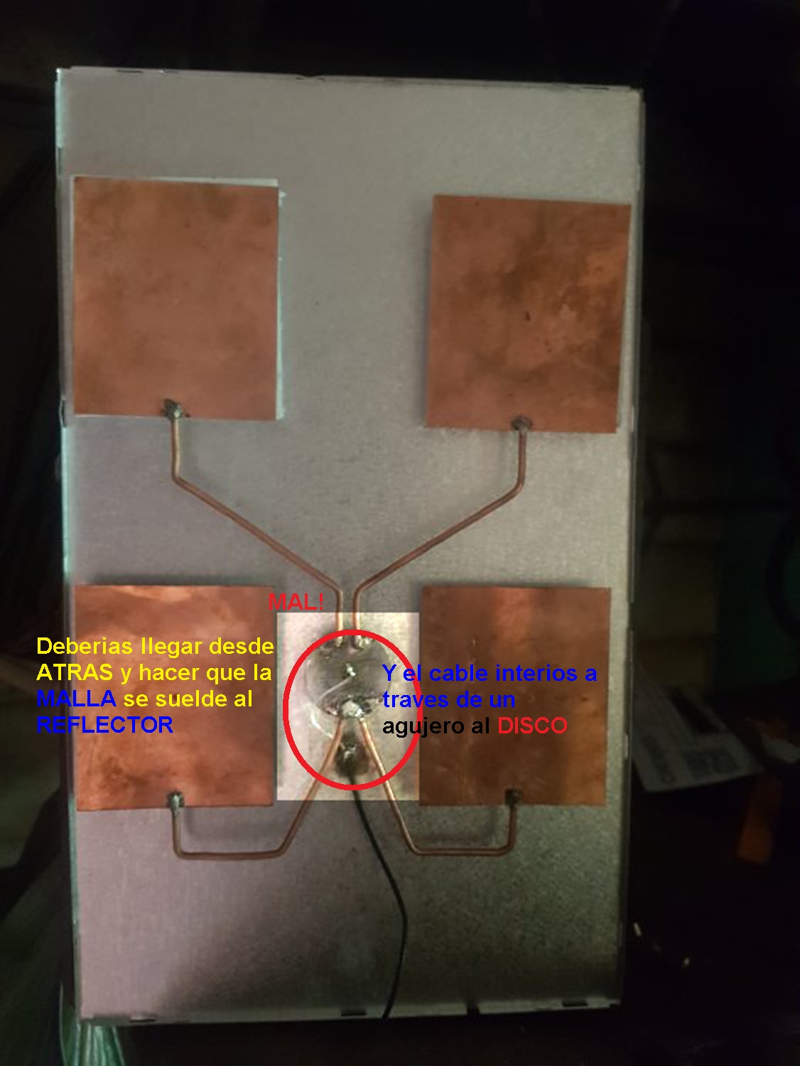

Here's the problem...i think... CENTER FEED the DISC leaving the outer sleeve in the REFLECTOR...IMPEDANCE MISSMATCH!

Aquí está el problema ... creo ... CENTRO DE ALIMENTACIÓN del DISCO dejando la funda exterior en el REFLECTOR ... IMPEDANCE MISSMATCH !
thanks I am going to modify maybe the error is in the antenna but I will also try to do the one recommended
