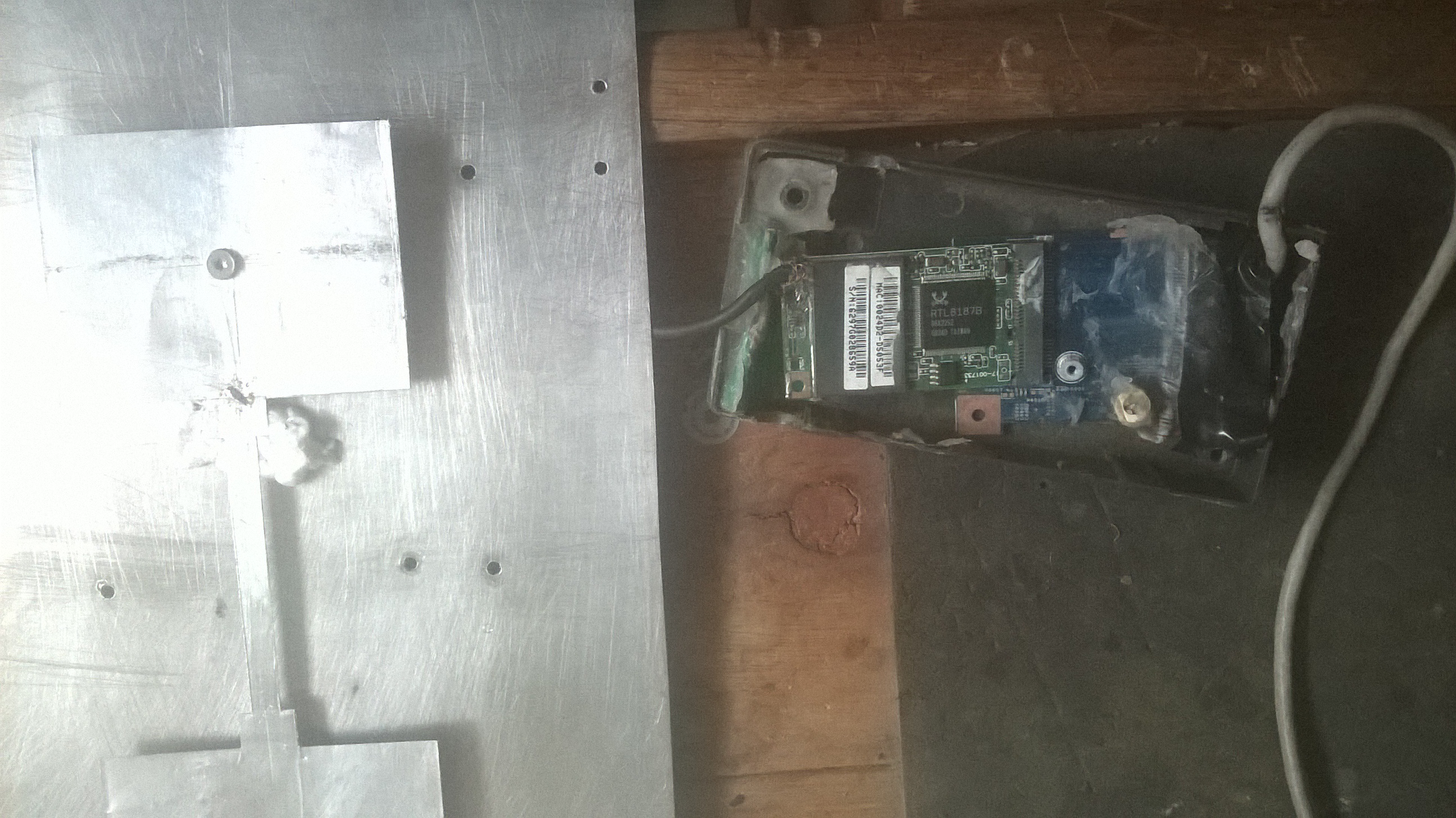

Did this with several rtl8187b with GREAT RESULTS (even better than a tp link722)

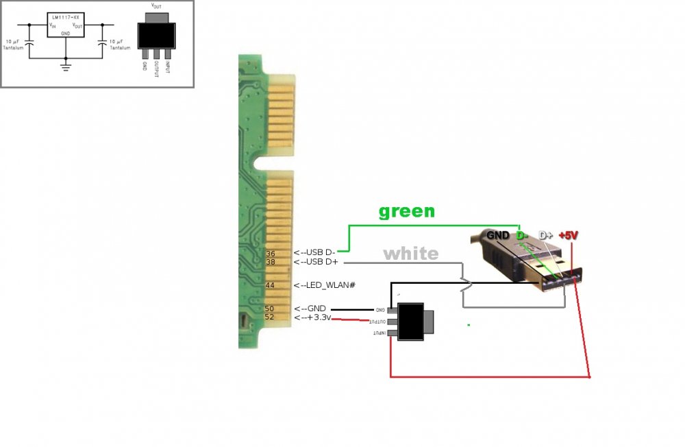

MiniPCIe to USB adaptation

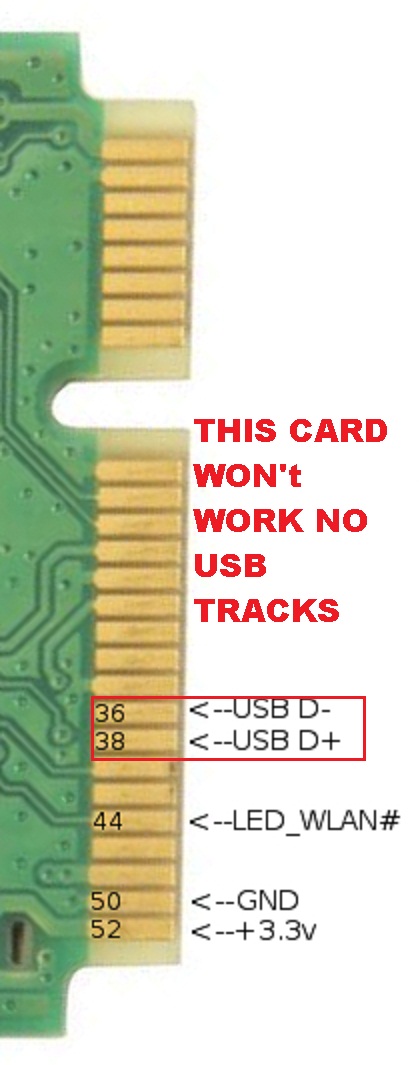

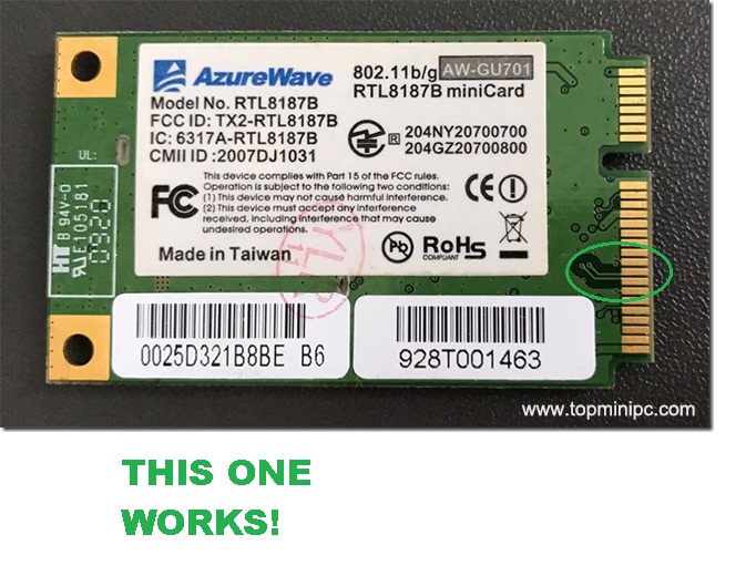

PS: Make sure you have this two -D +D on the card (some cards don't have'em!)
This is IT! a 3.3v power supply and -D +D wires and is done! Mini PCIe to USB...
PS: AHH you mean a usb card on minipci  female...ALL you need is -D +D wires and giving 5V to usb card...
those 3.3 volt regulators are EVERYWHERE...that's what make the hack so CHEAP!
It's all it takes a 3.3 volts regulator from5v usb...
Well, then post the electrical circuit of the assembly...!!!
