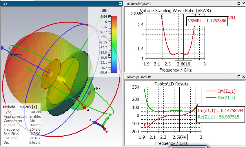

2 hours ago, Admin said:
,,, vars-cat, these are the results...!!!

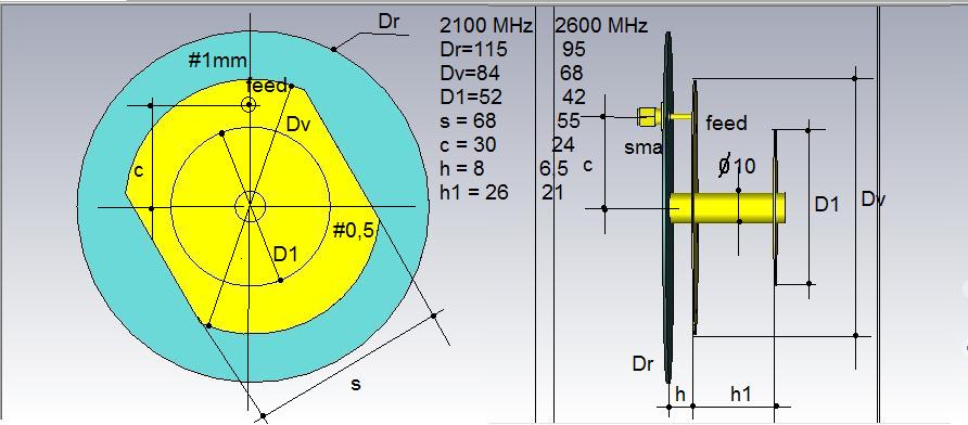

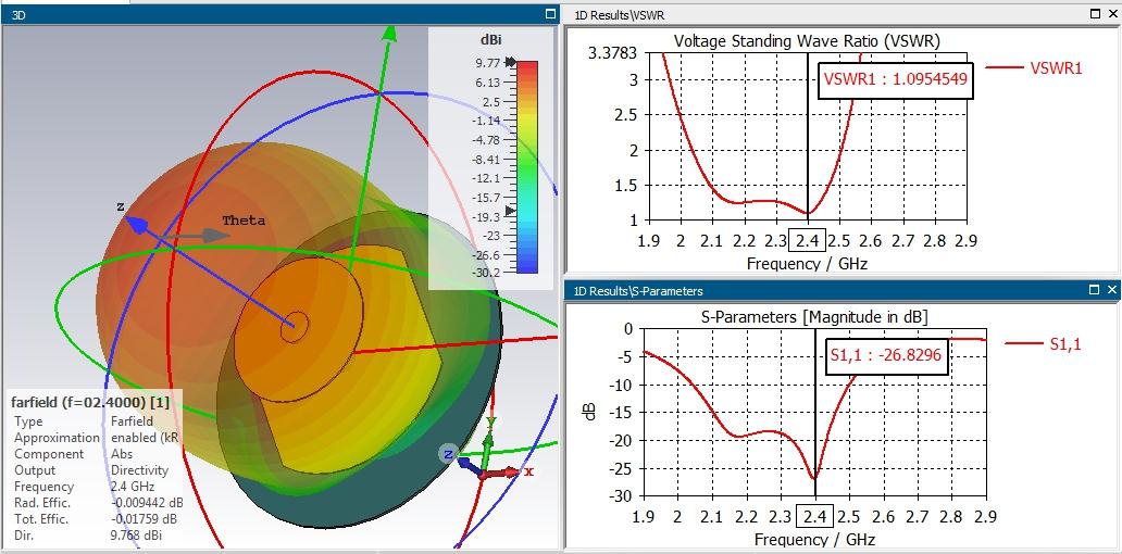

Hello

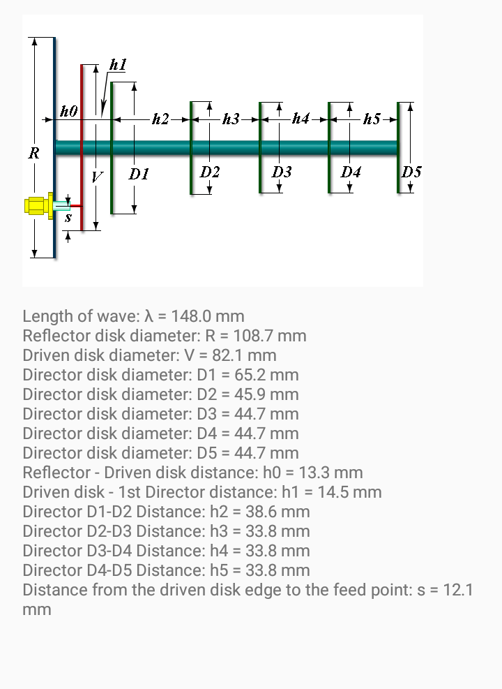

Just to let you know with just 3 elements
reflector, patch and director i get 46% of signal from 400m distance.

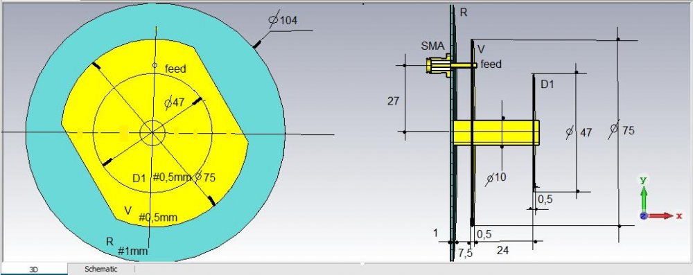

4 minutes ago, Eric said:
V is 75mm for 2.4Ghz?
,,, if "v" is diameter, then yes...!!!

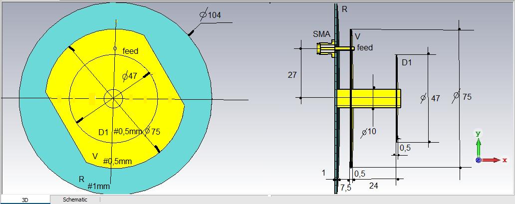

ADMIN je peux   ajouter  d' autres elements  directifS   ?   et la distance d'espacement entre deux elements ?? merci d'avance..
could  i add another directers ?   if  its  agreed    how much distance between 2 ELEMENTS ,   thans by advance
", yes, other directors can be added, but other simulations have to be done......!!!

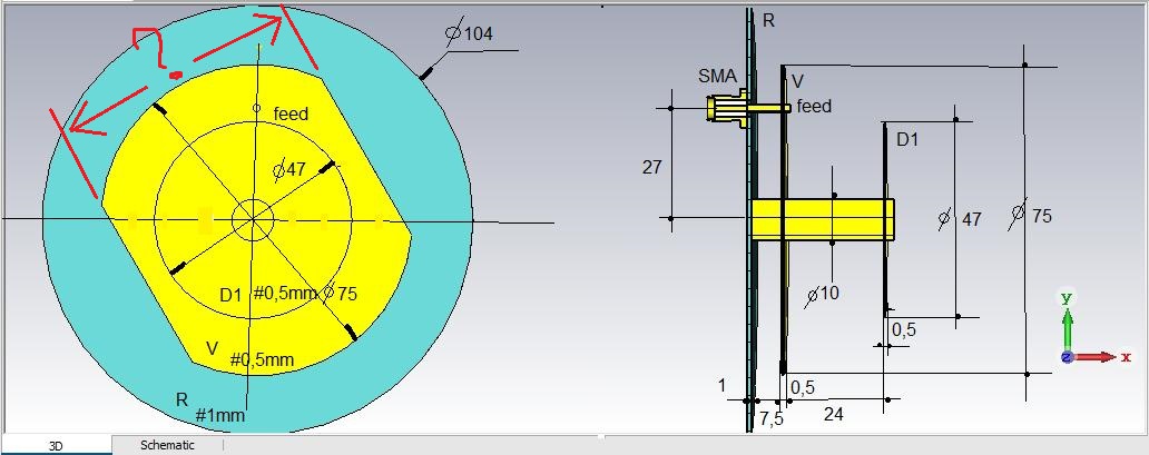

ALSO   THE ANGLE  WHERE THE FEED IS LOCALISED !
,,,,the angle it"s 60 degree>..1!!
thanks admin   if i try   the distance lamda / pi = 39 mm  between 2 directers   ?    i dont know  how to do the  simulation  unfortunately.
if i try   the  distance lamda /pi   =39 mm    ?
and   the  mesurements of cutting !    61 mm  ?       75 +61 =136 .         ..136 /2 =68   the diameter of resonanance  for 2.4 gh ? or i am just  stupid beginner !

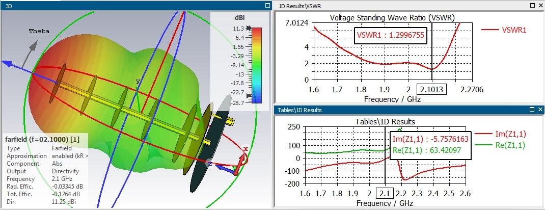

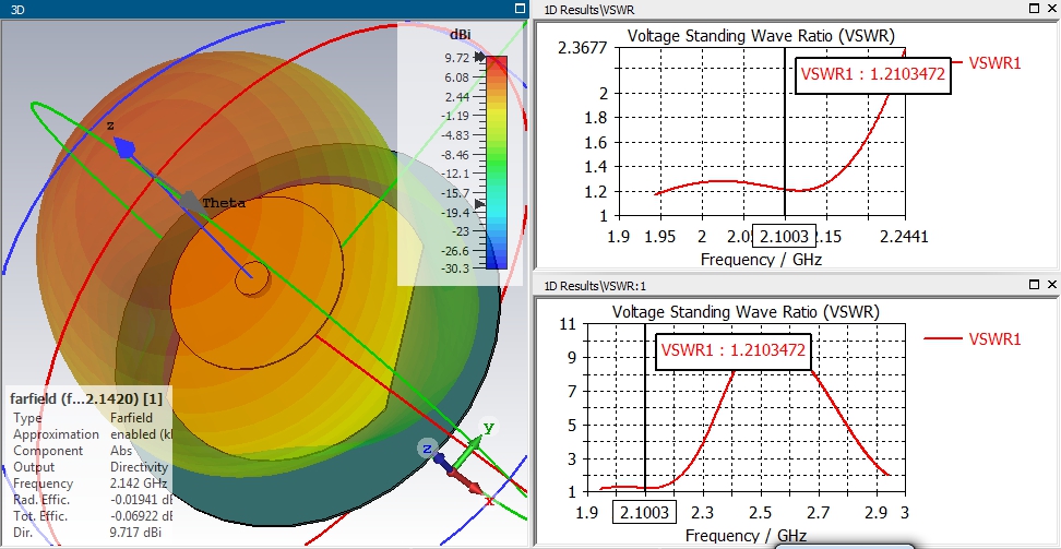

Hi admin ... Please make 3G 4G antenna simulation with sparated type
Hi buddy....!!!
Here are the results for 3G, 4G antenna...
