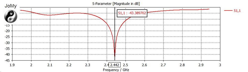

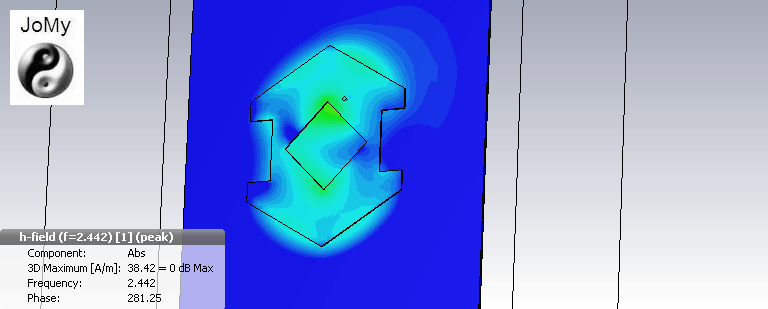

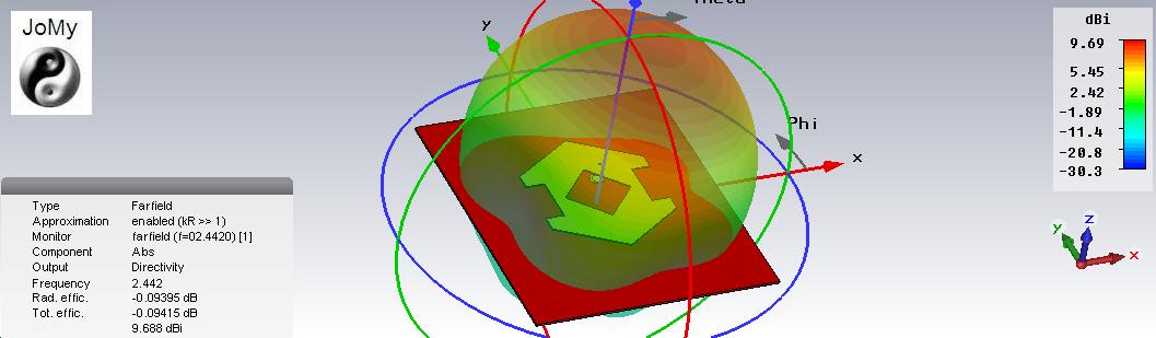

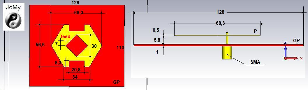

You could say it's a new form of the antenna gain in a reasonable direction ...
