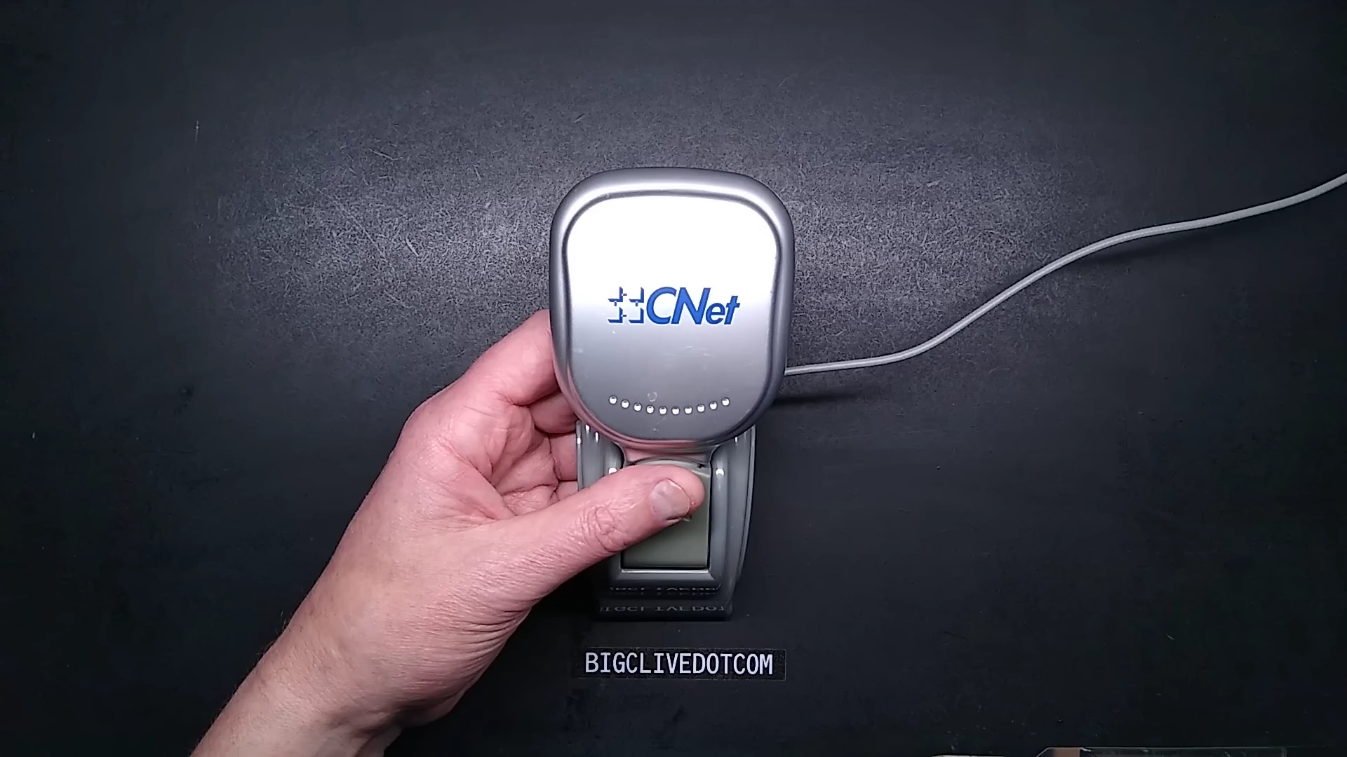

High Power Wifi Usb Adapter Sinmax SI-7300NA
Cheap High Power Wifi Usb Adapter Sinmax SI-7300NA Sky Wireless Antenna Signal Long Range Wifi Adapter 30dbi High Gain Wholesale. Single frequency (2.4-2.4835GHz)

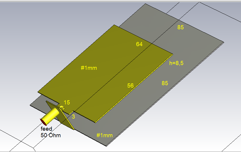

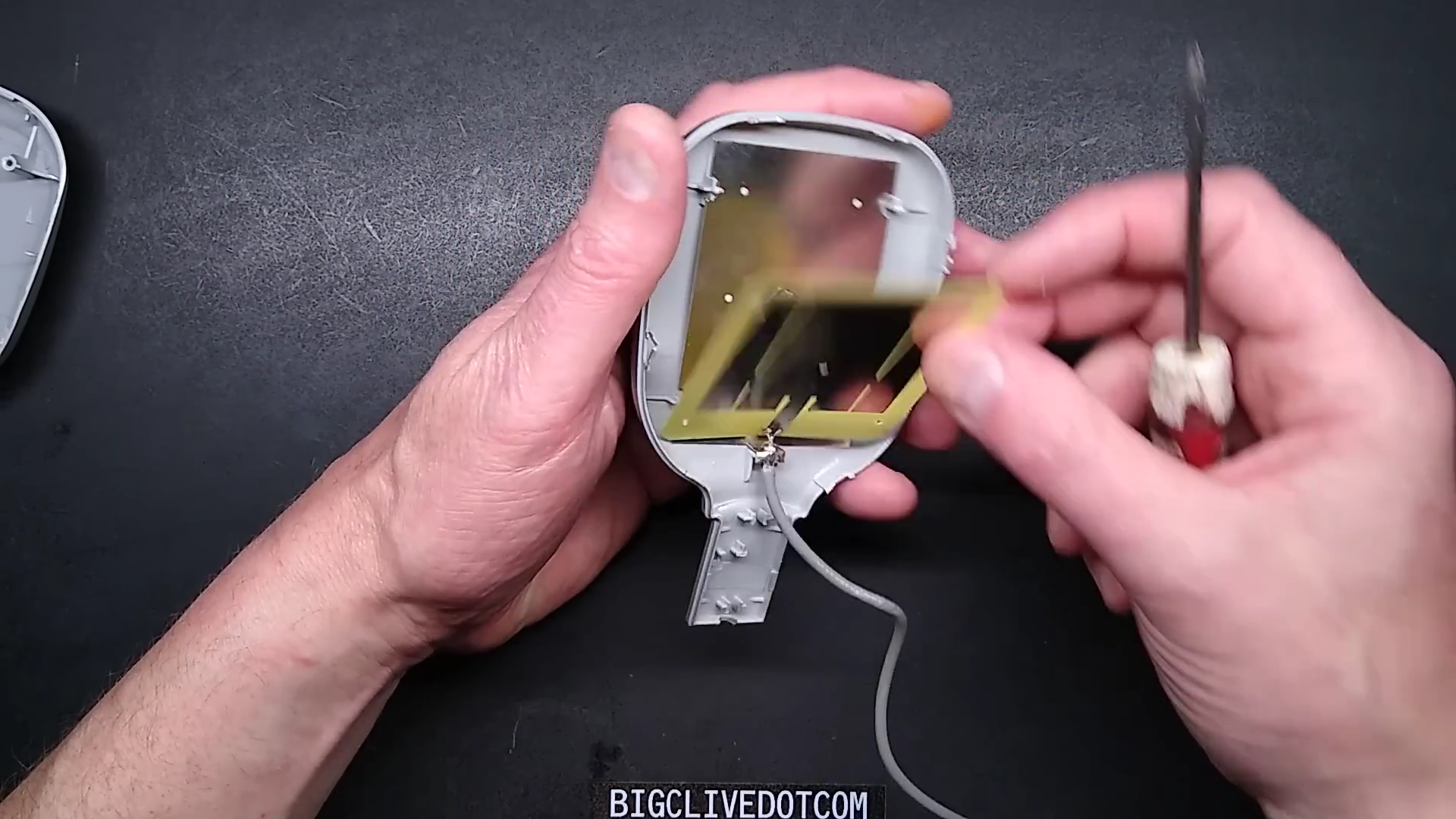

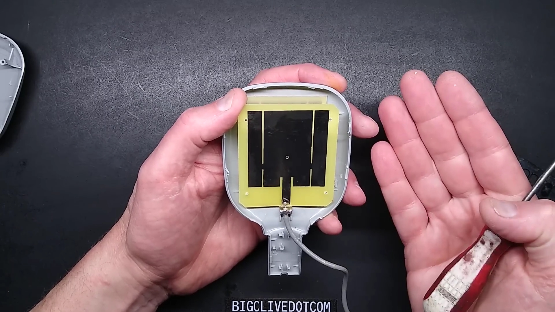

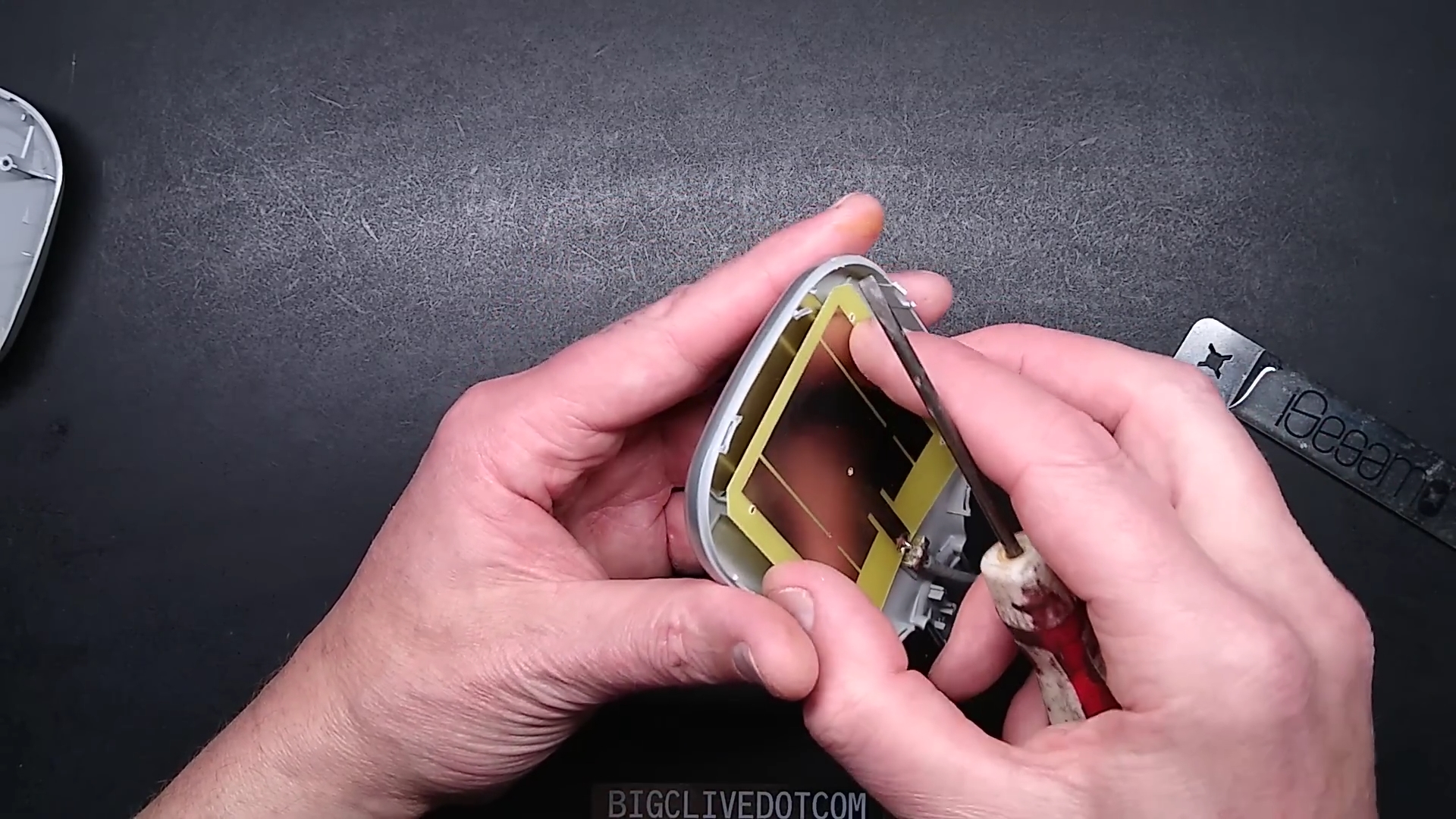

Inside antenna...

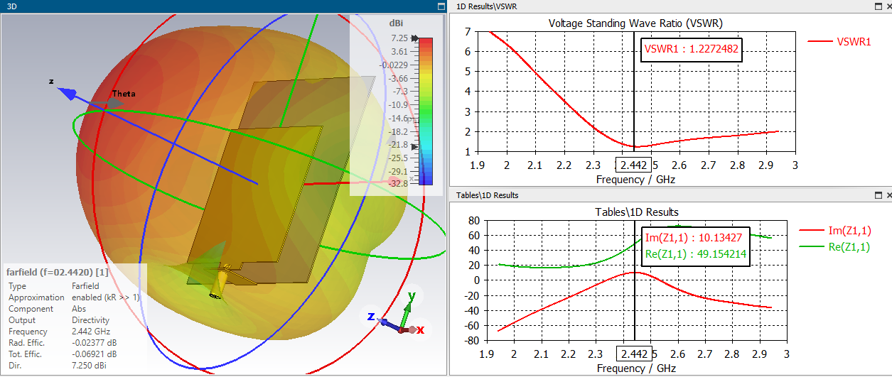

,,,this is the real gain of this antenna(without Wifi Adapter)...
the slits slots must be for wideband impedance matching...for FR4...
