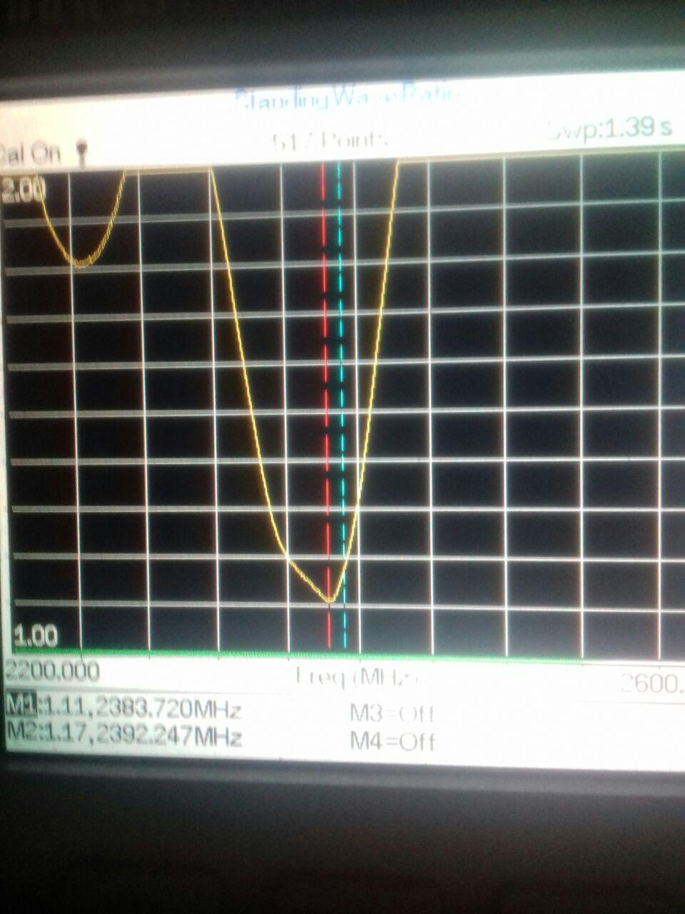

Erkin, you made a comparison in these antennas with Anritsu...???

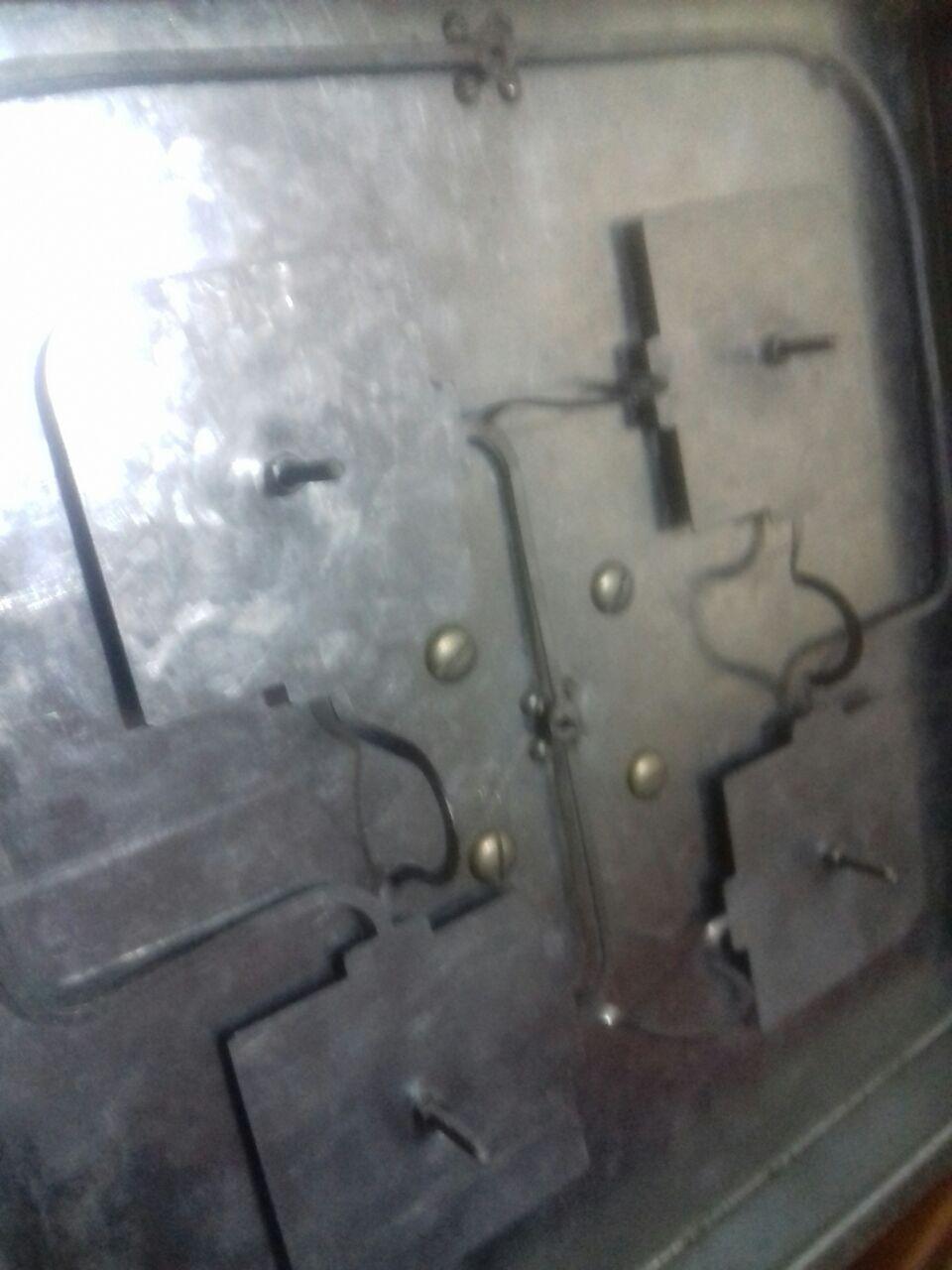

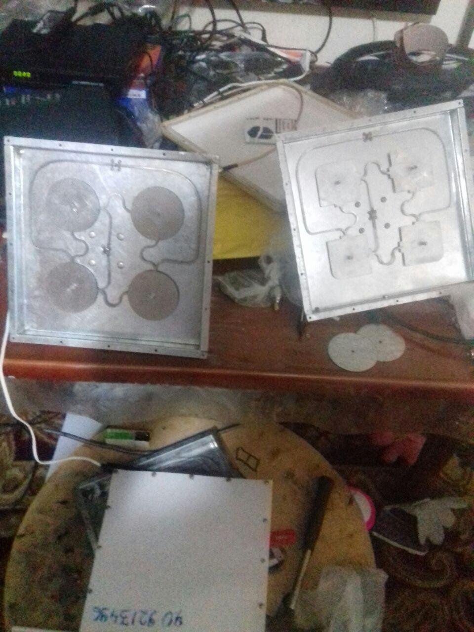

The first antenna is gone.
Echoing the Israeli antenna, written 3500-3800. If you need it, I can post it. Yesterday I found out. From me to you 1kg - 5dollars
The third. I think with round patches work better.

Yes, but put it on Anritsu,,,,
Best so,,,,
I will do it....!!!!

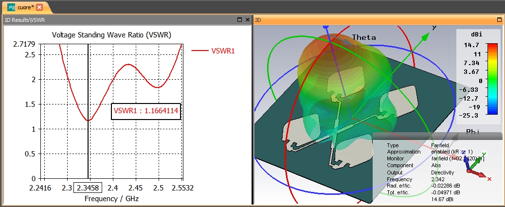

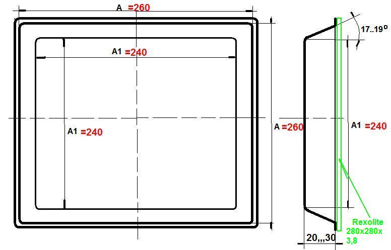

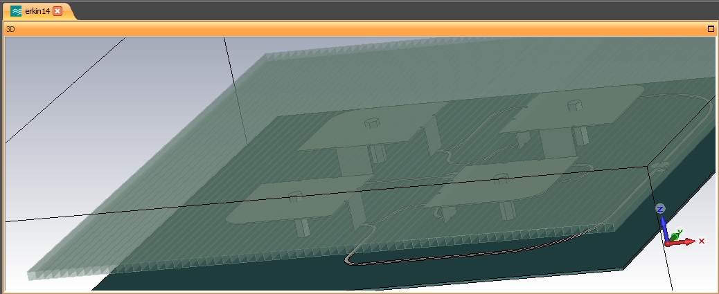

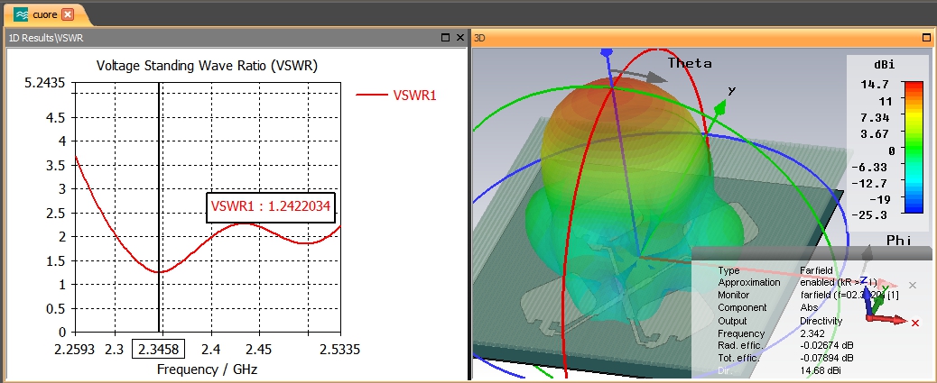

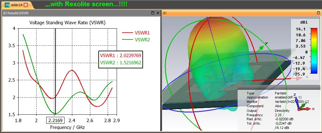

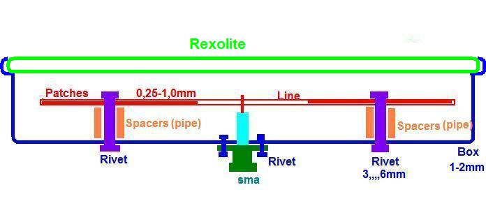

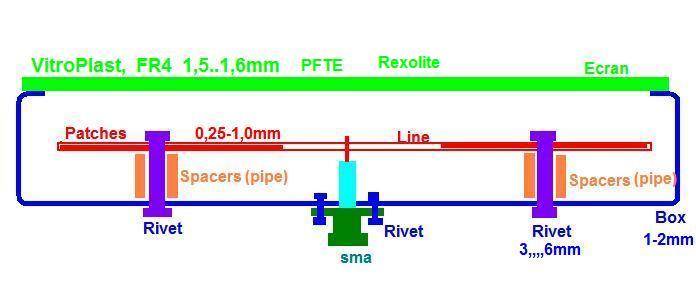

How to screen a box  of panel antenna with
Rexolite
Dielectric Constant(1MHZ-500GHz) = 2,53-2,62

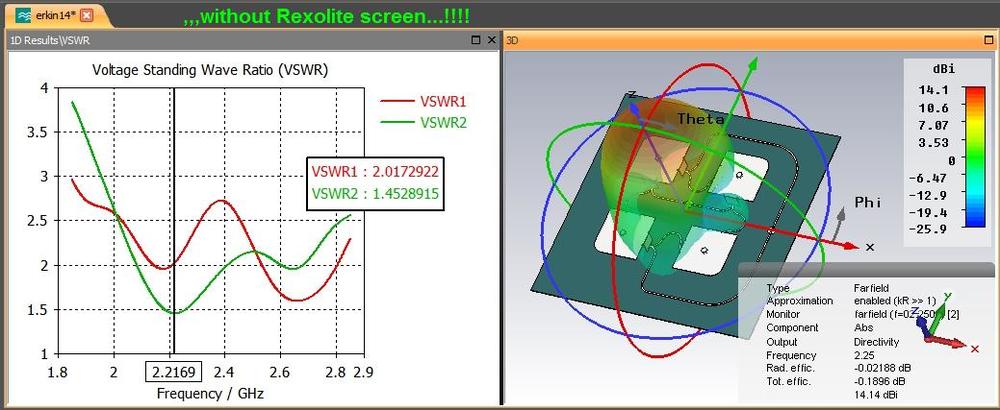

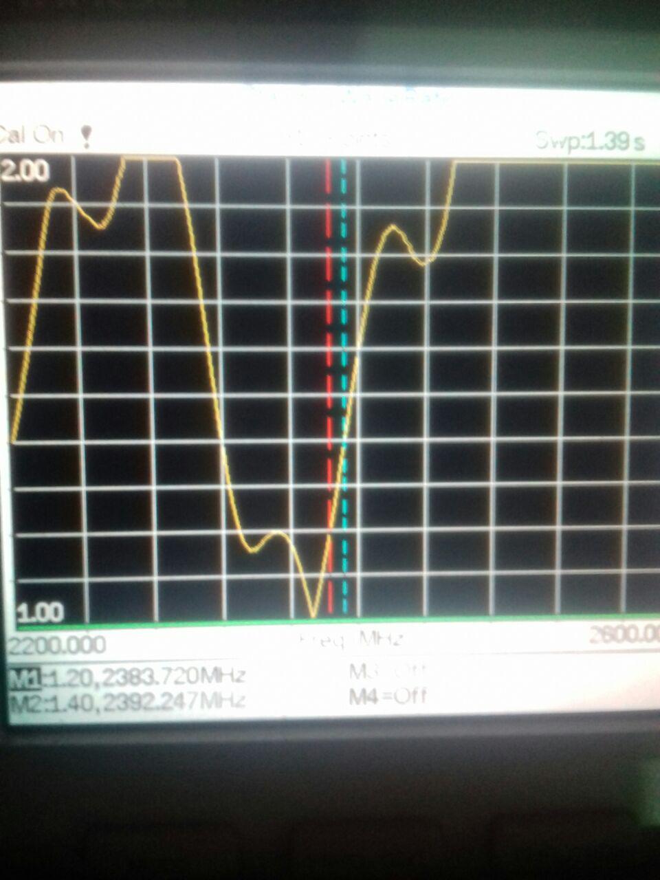

As can be seen from the above images, the VSWR does not change significantly by attaching a Rexolite screen
Due to the relatively low dielectric constant and the high frequency range, this material is recommended for shielding the antenna panels.

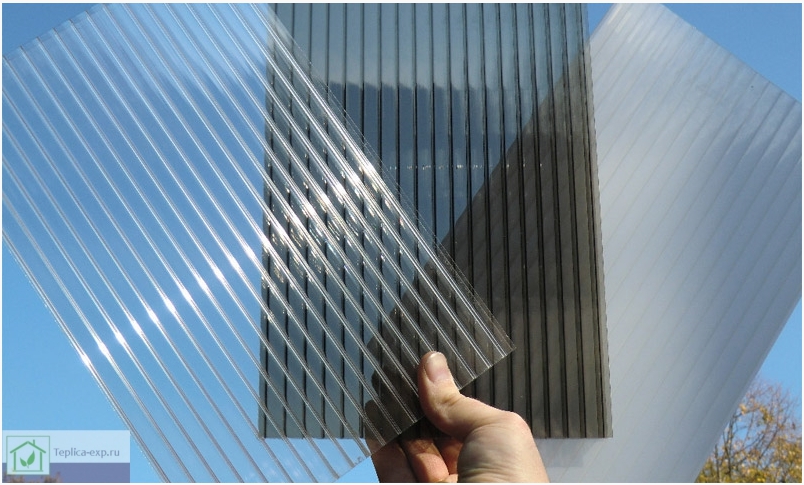

This is very expensive .. very expensive. The cost of the antenna is too expensive. We have about such sheets for the roof.
Policarbonat Rexolite  2000x1050x3 mm=350 rouble
,,, это дорого?
350 rubles is 6-7 dollars.
Policarbonat Rexolite 2000x1050x3 mm = 7 $. Very cheap. We do not have such
But the difference here is more pronounced..
