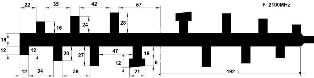

Jomy, you are a generator of ideas and thoughts.

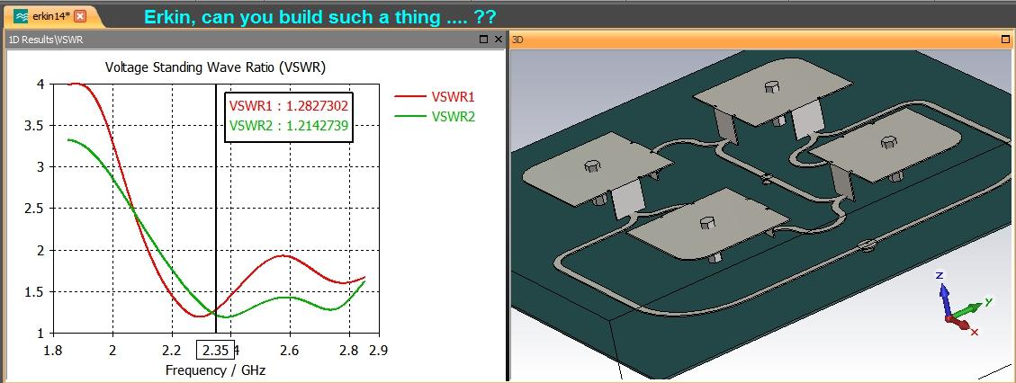

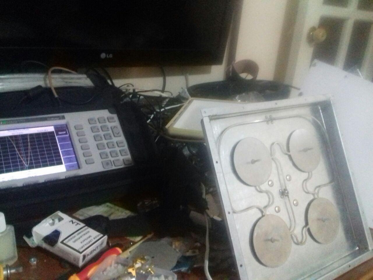

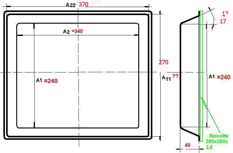

Erkin,what"s the state of work with our antenna?
Of course, these sizes are excellent! But, the protective covers of what? There are no them. I plan to fly to Moscow. Very soon. Maybe I'll buy there 50-100 pieces of such strips with a casing. If there is.

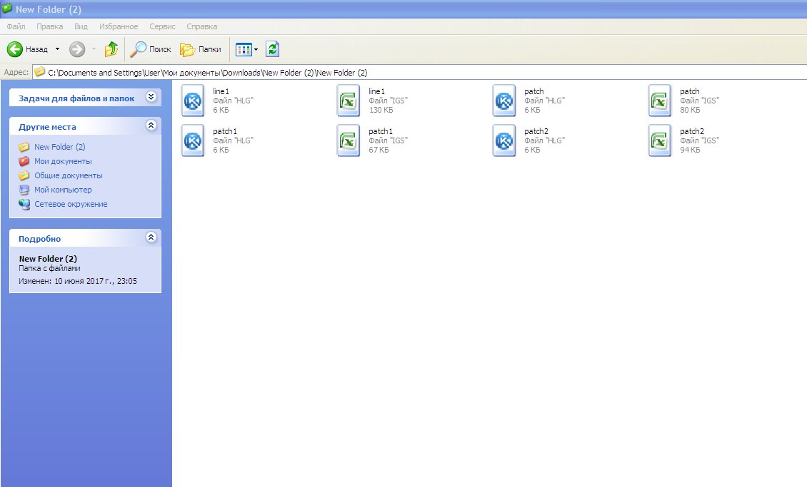

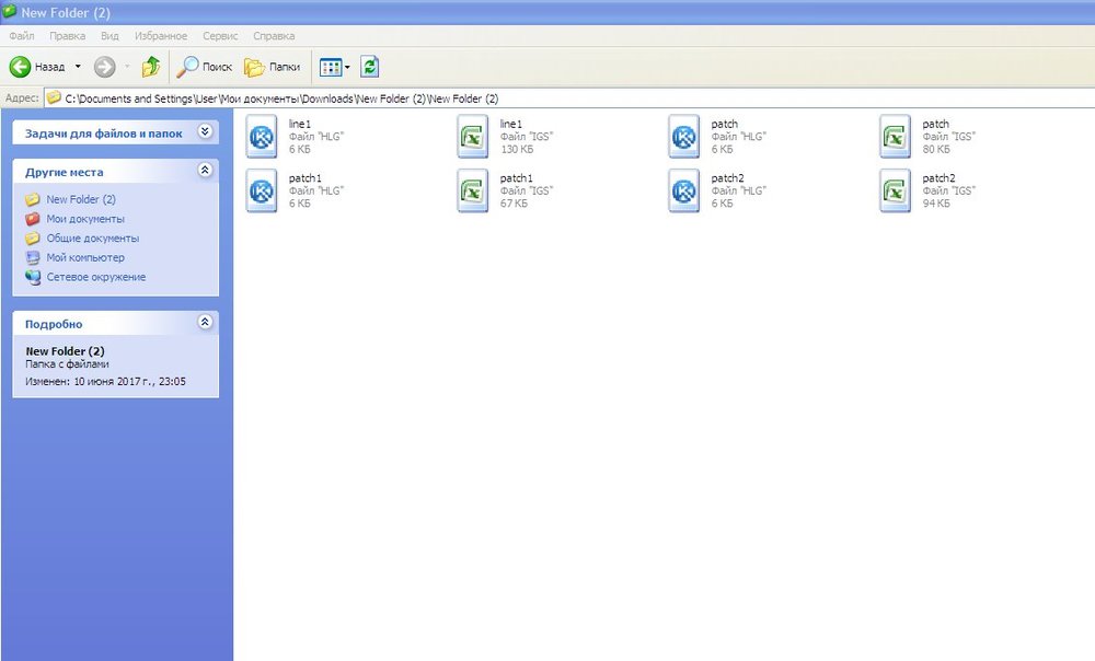

What opens the file HLG?
what do you want to say?
I do not know how to open these files HLG /
I have opened igs, ..... HLG - no....:(
Edited by chilanzar2
But, this is your file .. I unpacked it, and this is where the folder came out. What to do with it, how to open it - I can not understand
logper2,1.cst,it is a CST *file
I posted it to have it in the future
What a nightmare .... ??? !!! I do not even know the NFSS, but, already ....csttt...t

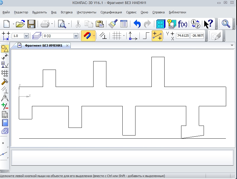

You want the KOMPAS file..??
Jomy, I do not know very well about it, but I read a lot to understand. So hard is all this. Yes, you need a compass. Or AutoCAD

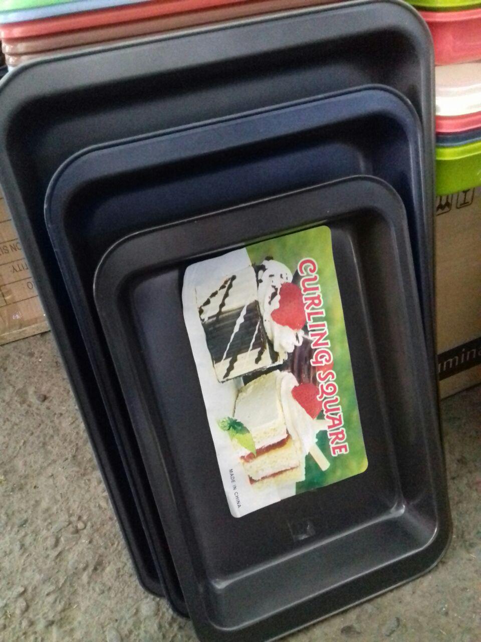

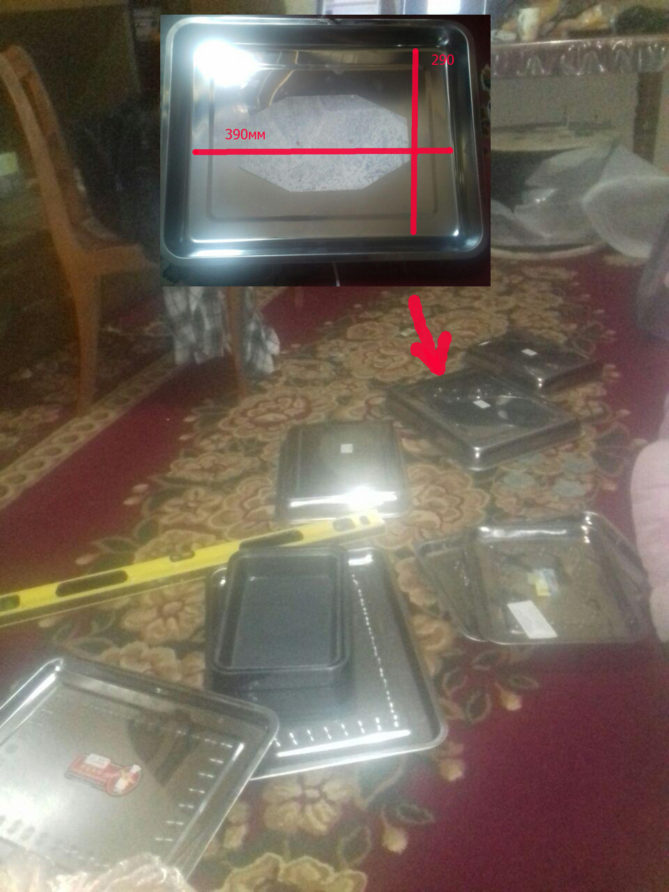

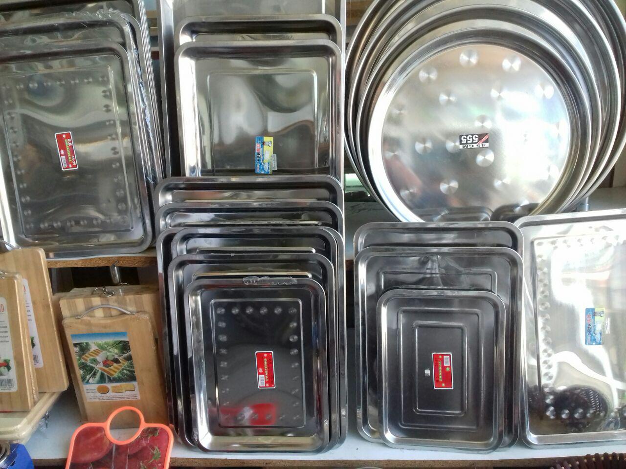

Jomy, enameled strongly affects the characteristics? And then, here such patriots are so beautiful, and cheap. They seem to have been created for antenna reflectors

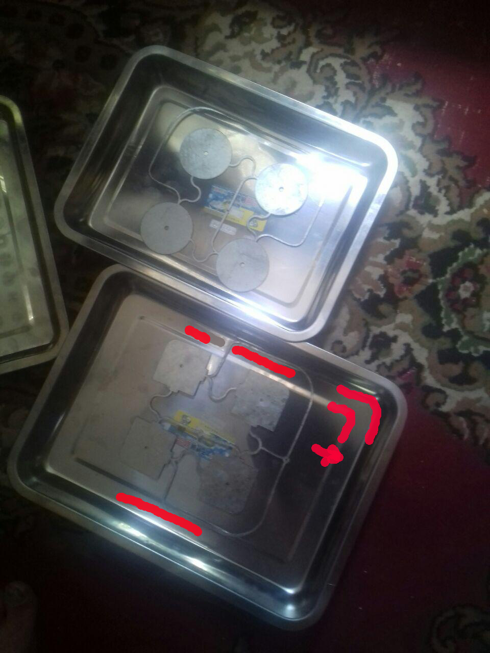

Will these depressions greatly damage the characteristics?
не...!!!

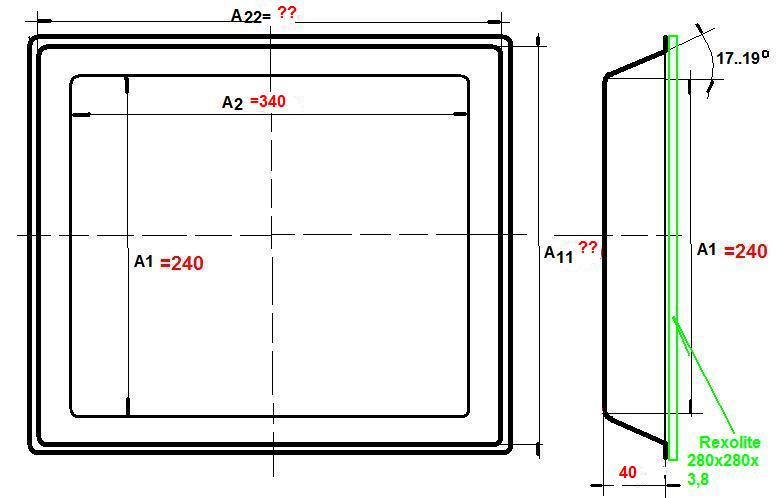

,, но должна быть квадратным лоток .. !!!

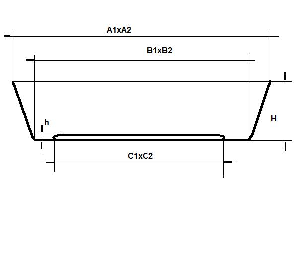

The septum can be soldered from a strip of galvanized metal. No problems. And if so, what characteristics deteriorate?
I do not know, give me some size at the tray to do a simulation...!!!
