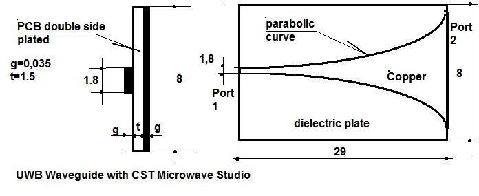

Philos, and this Waveguide with CST Microwave Studio ,is for a school project...???
No, Our University Working Group is using a (little more complex) waveguide as a sampleholder to investigate dielectric properties.
And i want to substantiate our measurements with simulations
Well, then try to do a simulation at this....

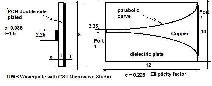

why should i do this? as I said before i'm very limited in my dimensions. 12L x 10B is already the maximum we can use
or do you think the dimensions in your drawing (29x8) are not relevant?
If not is the parabolic curvature relevant?
what can i expect for S11 and S21 in this setting?
We are still looking for an ideal design, so i'm really interested in.
,,,or so...
