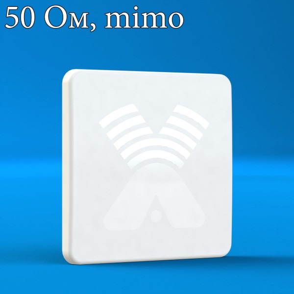

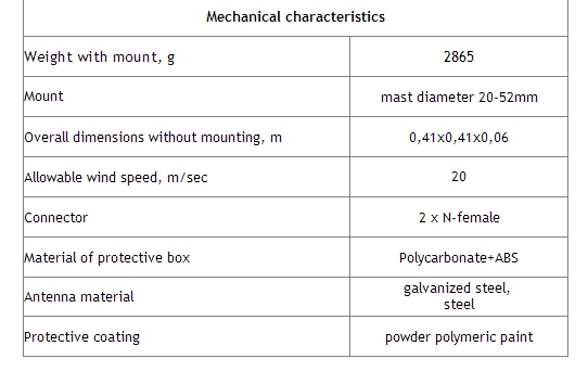

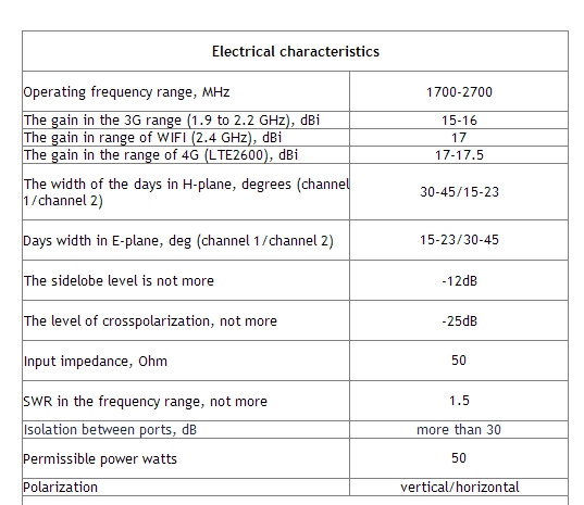

Powerful broadband antenna 3G/4G/2G/Wi-Fi with support for MIMO 2x2. Strengthening 15-17,5 dBi.It is recommended to use complete with universal modems Huawei Е392,E3276(M150-1) and conventional 2G,3G and 4G modems.
Panel antenna MIMO 2x2 AGATA is intended for use in complete equipment of wireless data transmission systems standards:
2G(EDGE, GPRS frequencies GSM1800)
3G (UMTS 2100)
4G (WIMAX,LTE1800, LTE2600)
WI-FI (IEEE 802.11 b, g, n)

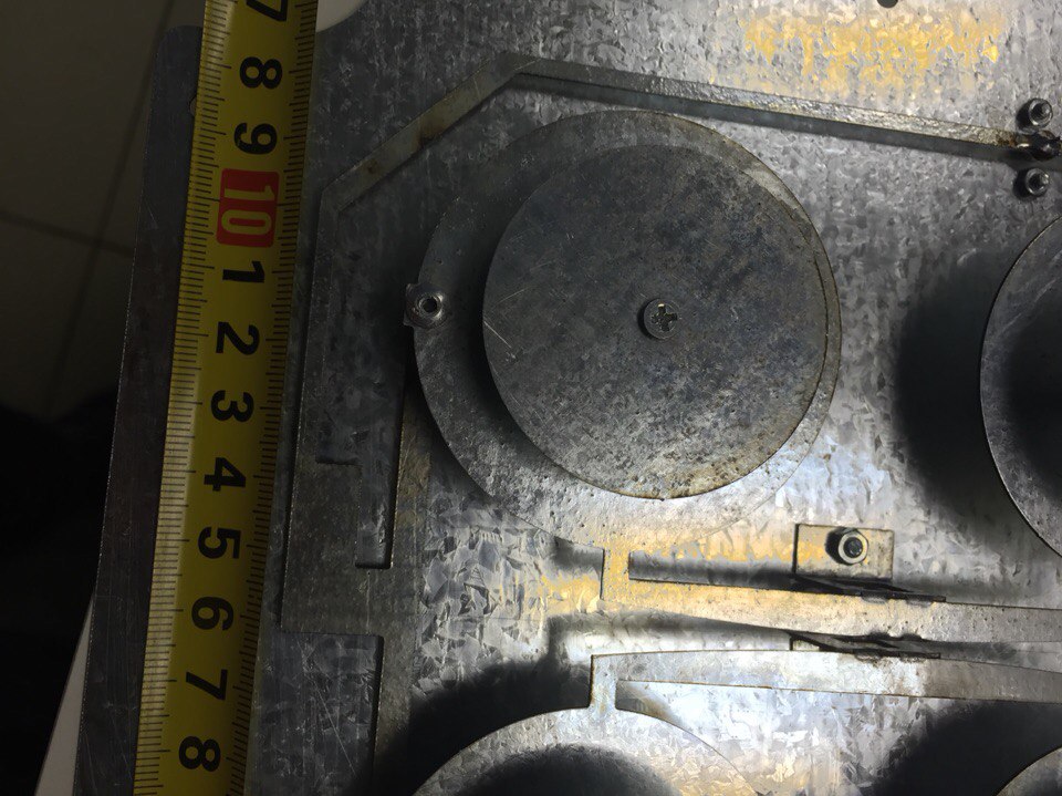

in other systems the range of 1700-2700 MHz. AGATA MIMO 2x2 antenna is highly directional and ideal for use in communication systems "point to point" and "point-multipoint". Antenna is a structure of two spaced in-phase arrays with orthogonal polarizations.

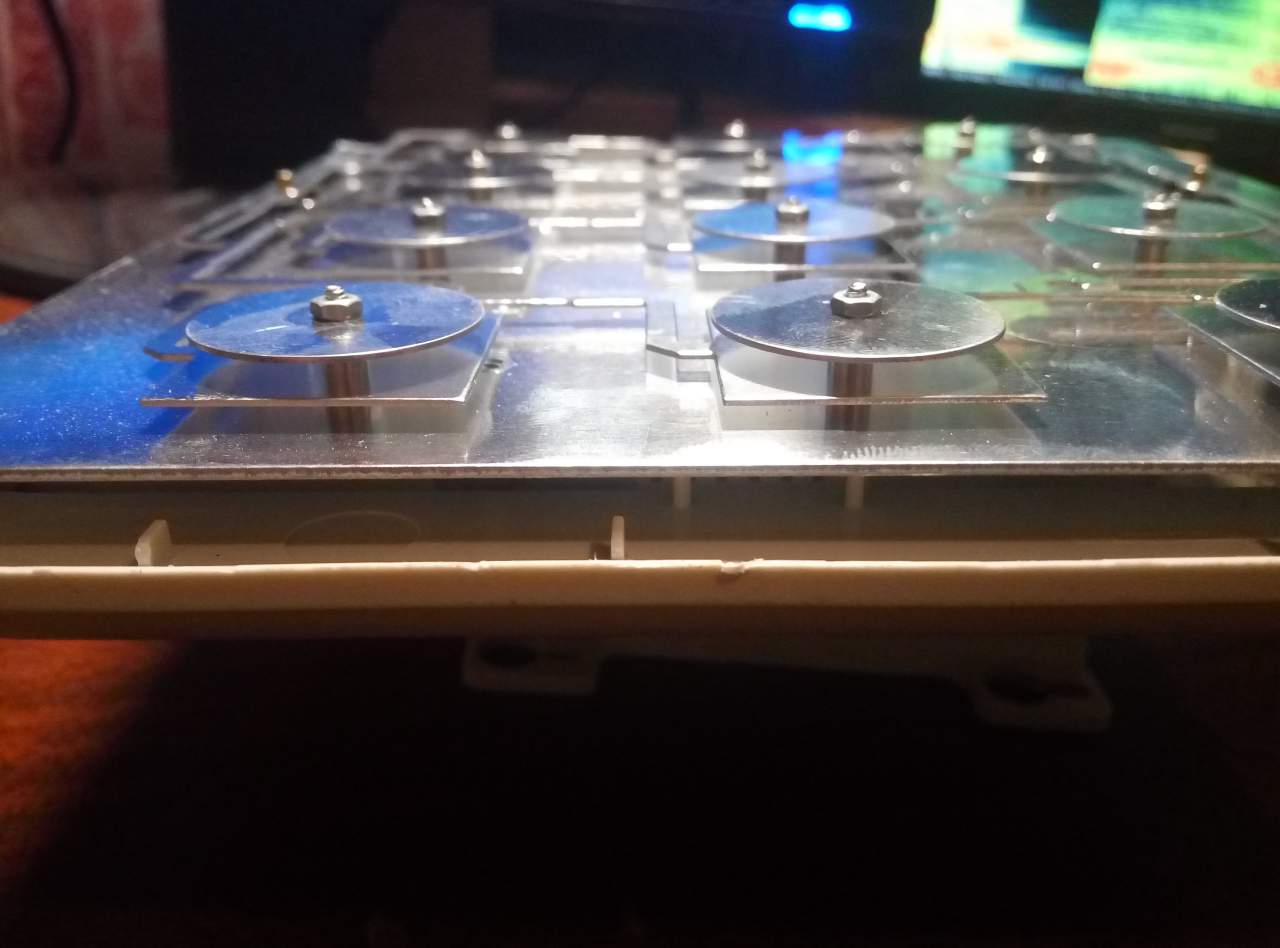

Because of that antenna 2300-2400, I became more interested in other antennas too. Apparently, I started antenna illness. Where can I buy such an antenna? I will try to remove the dimensions, and repeat it to make

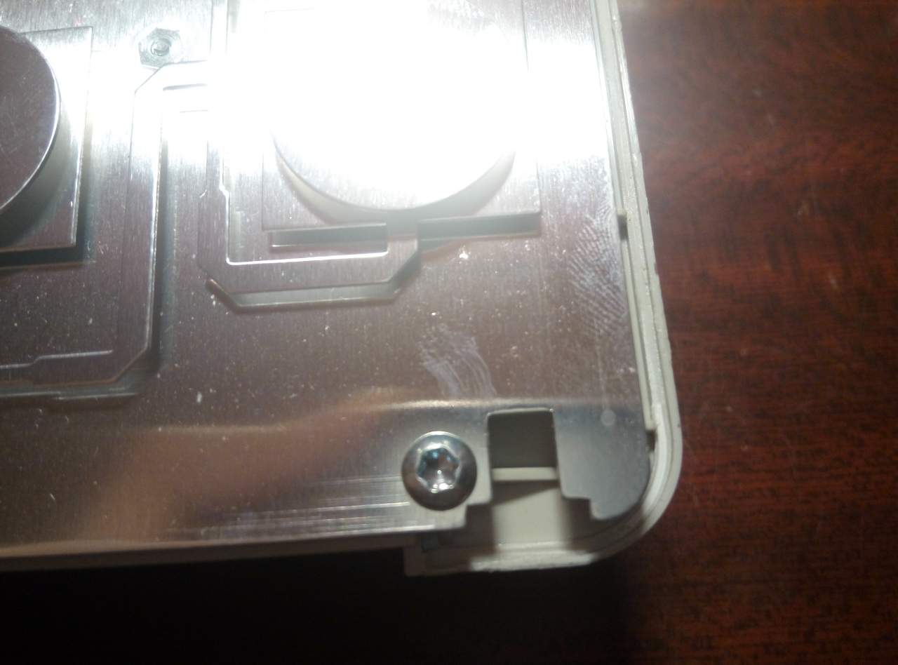

Yes, but in this case there are some feed lines of this kind...

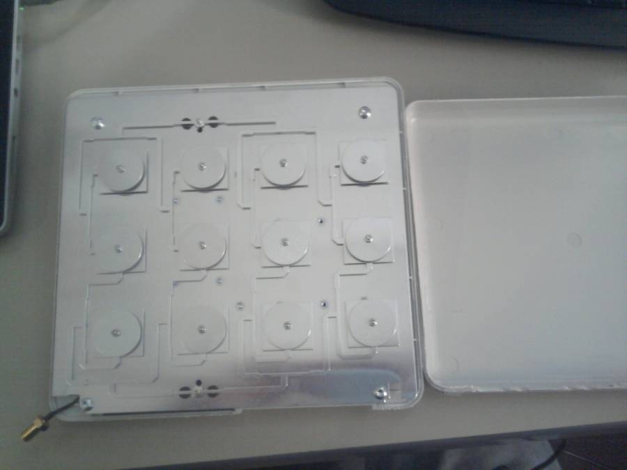

A very large antenna! And why one of the rings of a smaller size? Is it to receive high frequencies?
This lower-case directory increases the frequency bandwidth
This is simpler,,,,
50/50 cm antenna size reflector? Apparently, it's made of stainless steel. Oh, how expensive the antenna is! very expensive!
