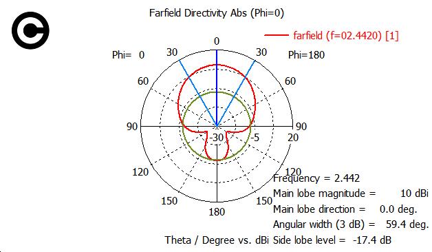

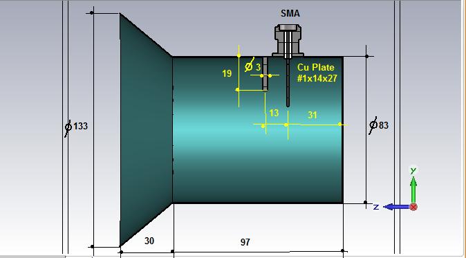

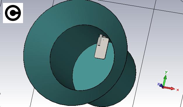

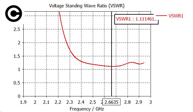

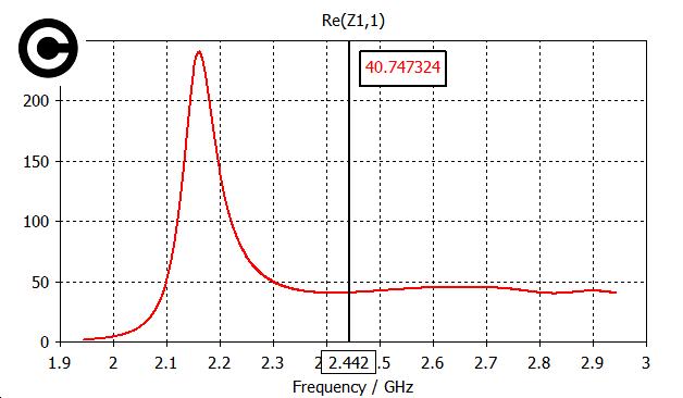

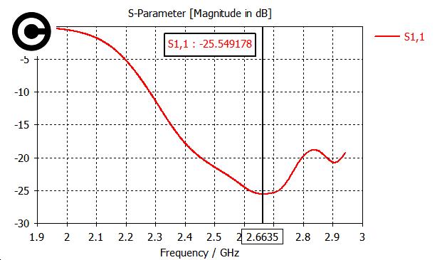

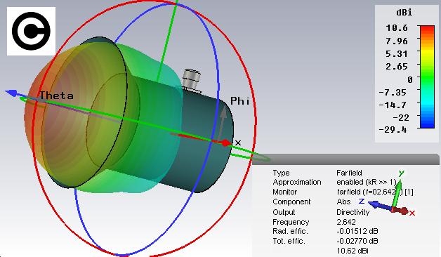

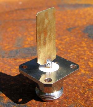

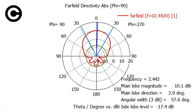

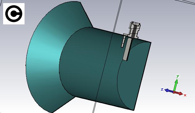

This cantenna, presents some changes as it would be
1) plate vibrator
2) adding a directing element
3) attaching a cone to the cylinder

You can also use the simple vibrator....
Very interesting. This is easier to make and more gain than Bester feed.
Probably easier to optimize too!
