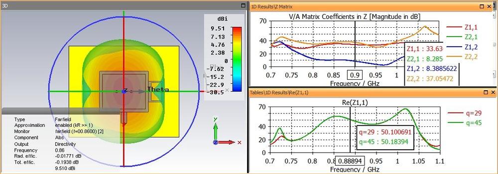

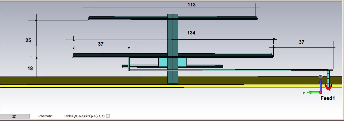

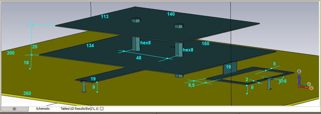

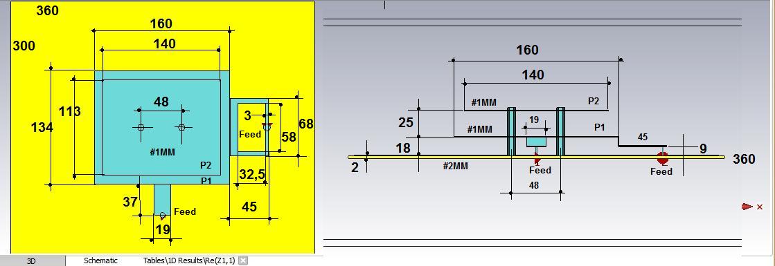

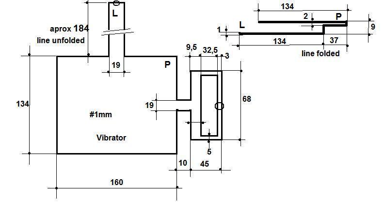

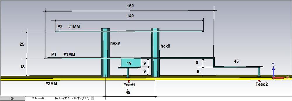

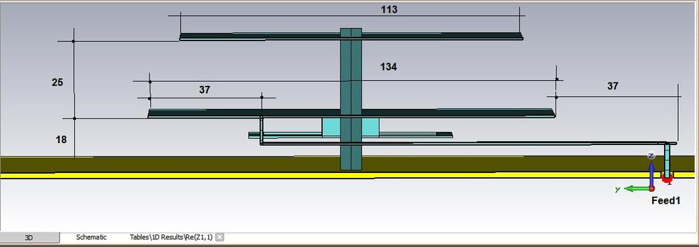

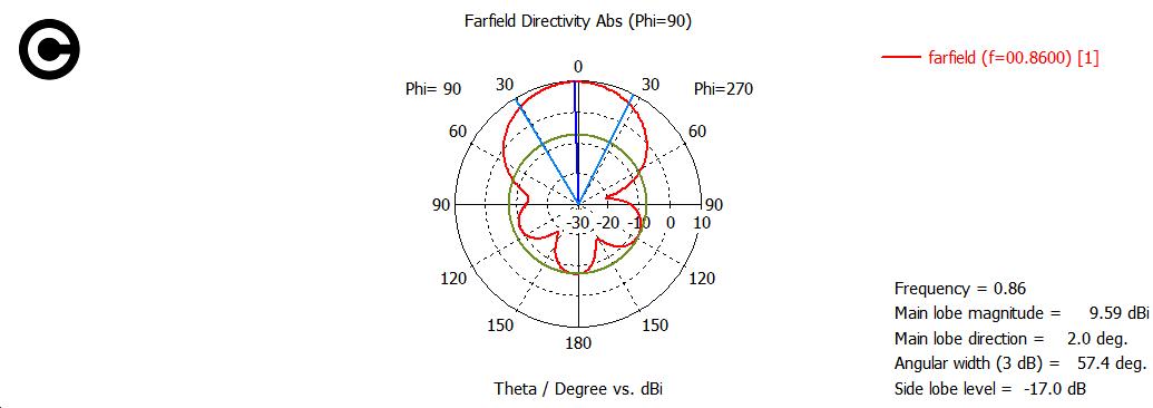

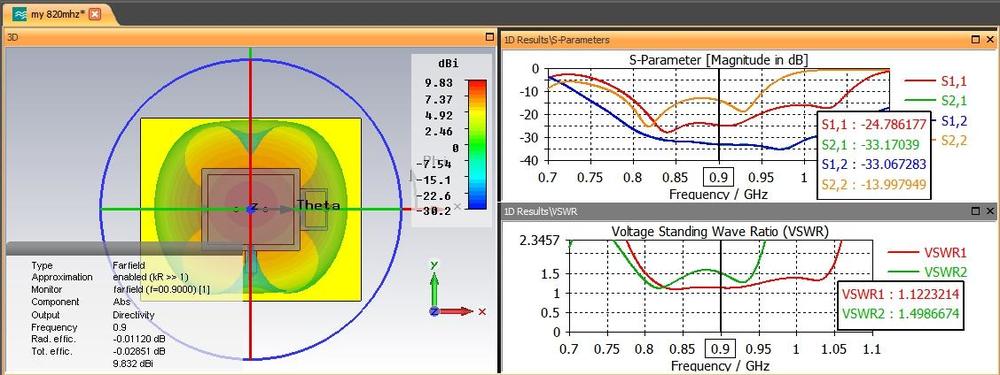

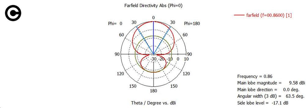

At the request of a friend 'Ahmed", I designed an MiMo antenna  of the GSM band(800-950MHz)
On the territory of the Russian Federation go to the following standards:
GSM 900: transmit frequency 890 – 915 MHz receive frequency 935 – 960 MHz.
GSM 1800: transmission frequency 1710 to 1785 MHz receive frequency 1805 – 1880 MHz.
So it should look like a vibrator unfolded,,,
