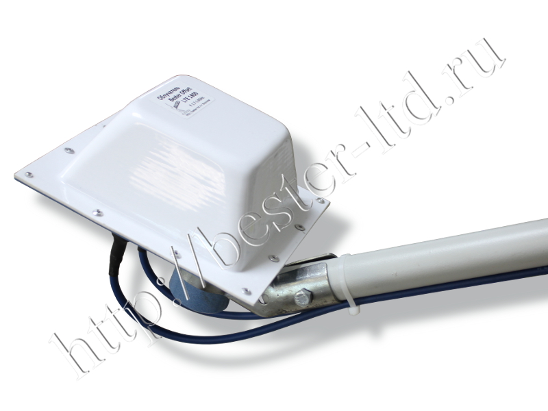

Dual port 4G irradiator BOF 4G mimo (1800 MHz)
Advantages:The Opportunity radiator BOF-4G MIMO to operate in a simultaneous multiple transmitting and receiving data (standard MIMO - multi input multi output) provides additional stability of the wireless connectivity and two-channel high-speed data transmission.
Irradiator BOF-4G MIMO is used with satellite dishes most manufacturers. We recommend you to install our reflectors on the satellite dish manufacturing plant Supral (Supral, Ulyanovsk), as the most proven and stable working with irradiators Bester via WiFi, Wimax, 3G, 4G.
Irradiator BOF-4G MIMO is set to the standard seat mounting satellite LNB. The radiator will automatically be in focus because the location of the radiator to the space in front of the plate defines the shape and length of the rod is calculated by the manufacturer.

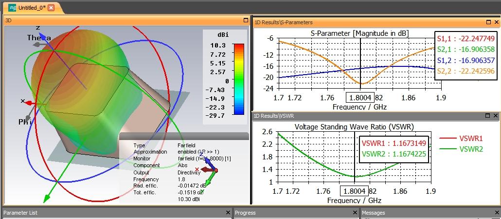

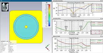

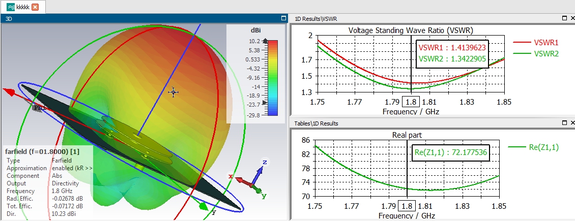

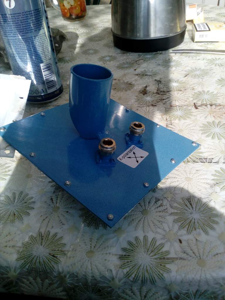

And here's the results,,,
,, where is the broadband frequency and especially the isolation between the ports ... ??

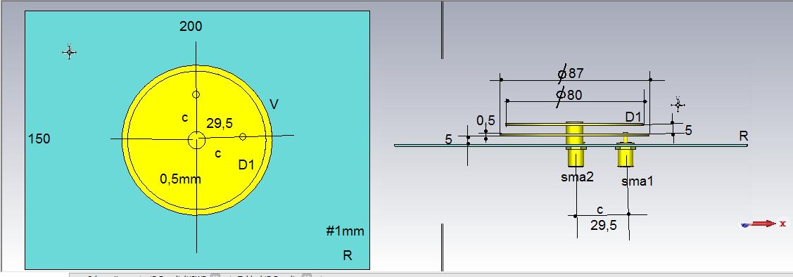

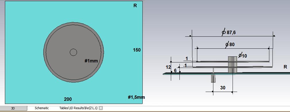

8 hours ago, roman55524 said:
what is the distance between the first and second ports?
- distance from center = 30mm
- two ports at 90 degrees
- distance between the first and second ports=42,426mm
On 8/19/2017 at 1:24 PM, Admin said:
И вот результаты ,,,
,, где частота широкополосного доступа и особенно изоляция между портами ... ??

Yes I would like have this  offset  for 75 ohm  it's possible mister jomy?
,,, why don't you try to make this type of antenna, better ... !!!
I am looking for 1800 4g not 2600  and with 75 ohm. I read on LAN 23 but I had headache with the false traduction and A lot of  negative critic
I m looking for 1800 4g   not for 2600 !  and for 75ohm
I read on LAN 23 I had headache with false traduction and A Lot of negative critic ?  So I m confused ! I need your help

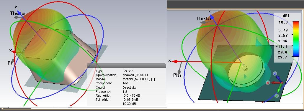

I managed to do an optimization for you(75 Ohm impedance)...

On 11/15/2020 at 4:37 PM, Admin said:
Мне удалось сделать для вас оптимизацию (импеданс 75 Ом) ...
можно ли сделать разъемы типа "F" вместо "SMA"?
can you make "F" connectors instead of "SMA"?

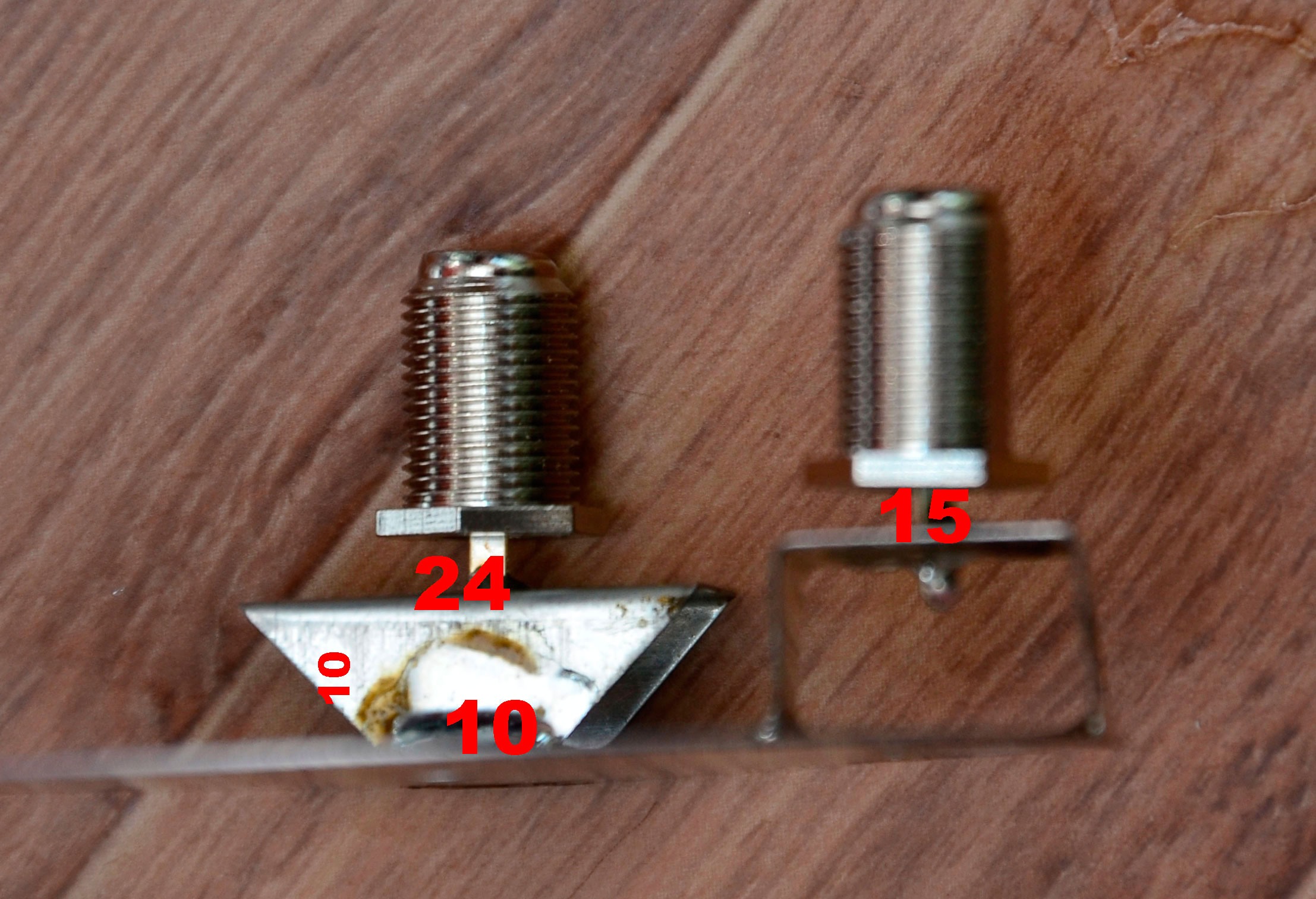

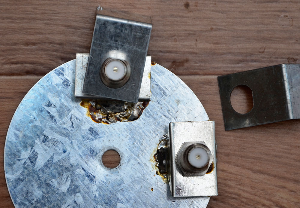

,,, in my picture above, I mistakenly passed the SMA connector, when in fact it is an F connector...!!!

,,, to obtain the 75 ohm impedance at connector F, it is necessary to use the 2.8mm diameter pin...
Jomy. I m off ! The thickness of  patch and director. You shared 0.5 mm and now. 1 mm ? Wich I follow?
,,,0.5mm or 1mm, it doesn't matter...!!!

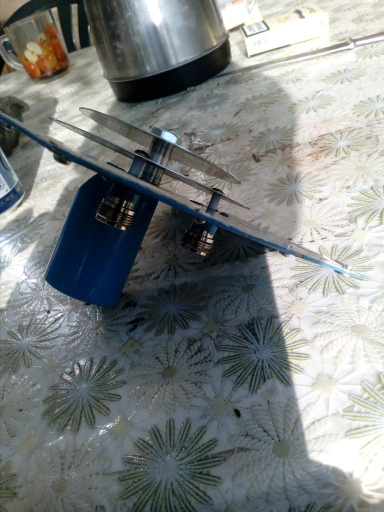

,,,this works too...!!!
