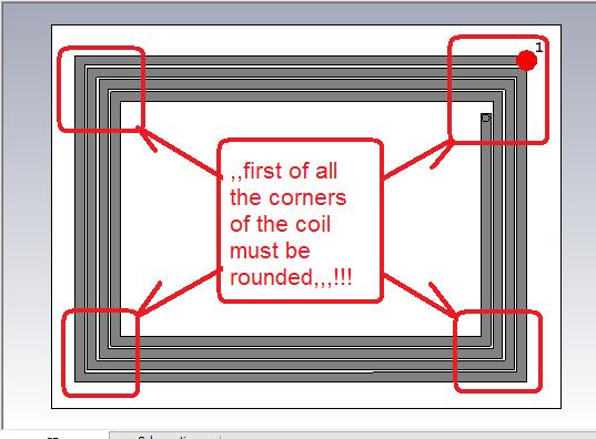

I made antenna by myself, I understand that corners must be rounded but I started with this  version to have a simpler meshing...
The version with rounded corners gives me  quite the same inductance (around 1.24 uH)

here is the original antenna:

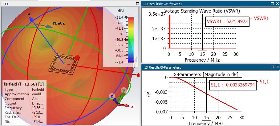

But the simulation, is clearly, not correct...

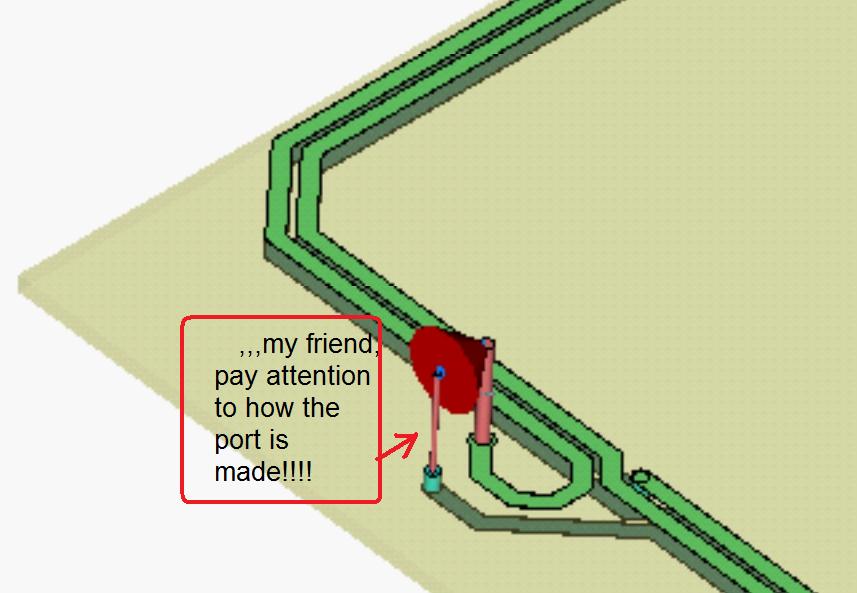

interesting, but seems lumped port, I don't understand well...
Do you have this example in .cst format?
,,, no, this is from your pdf file...!!!
