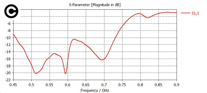

In the model not included * box construction for a balun, in which the waveguides are almost in contact with the body or charge of the balun/LNA. Even if galvanic contact there is very small gap to the land-side of the Micarta or the metal casing of the LNA. The cable itself is also making an impact on the line impedance, and the cable is asymmetrical to waveguide, their impedance will change, will be unequal, and they will additionally radiate from assymetrical.
