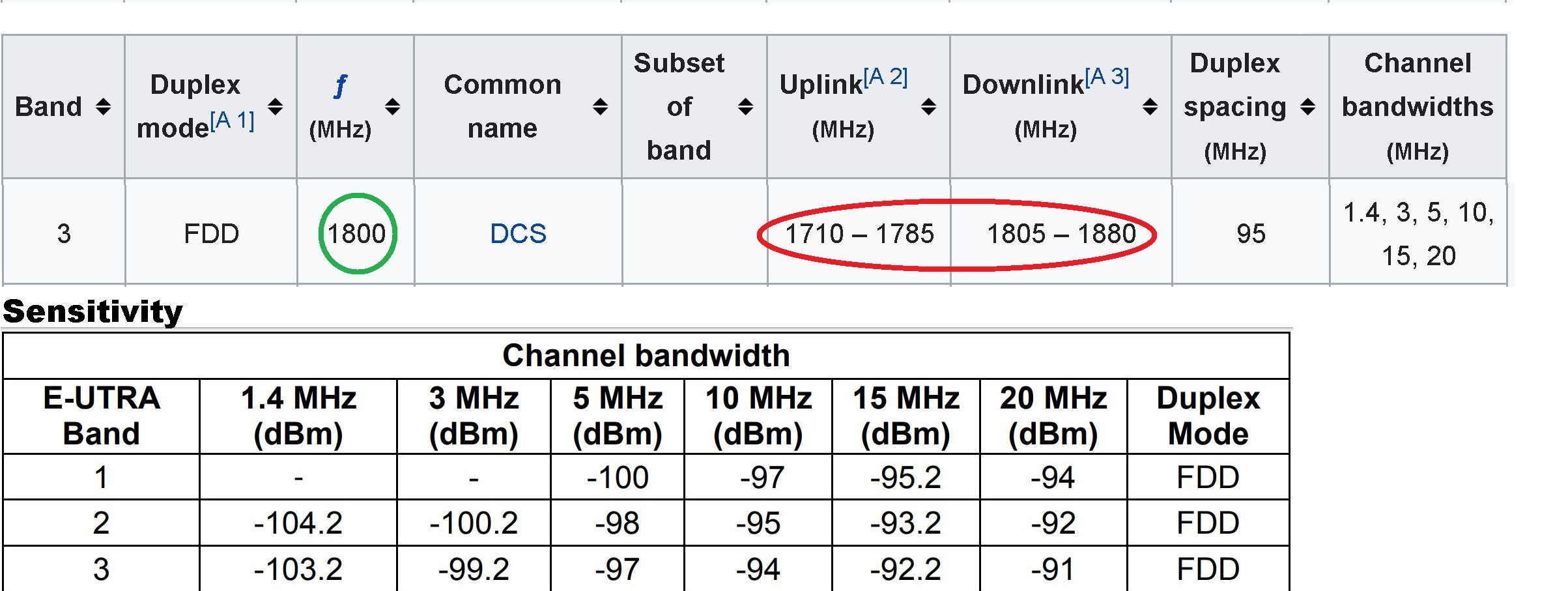

LTE, UMTS, GSM are supported , but my focus is on LTE BAND 3
23dbm (100...150mw MAX) output UPLOAD
104dbm max Sensitivity DOWNLOAD
Still it looks like you gonna need a parabolic dish...NOT SMALL with more than 20dbi of gain...perfectly pointed and the modem close to the antenna...which should be on the ROOF...IMHO
Thanks Clanon,
That's exactly the frequency.

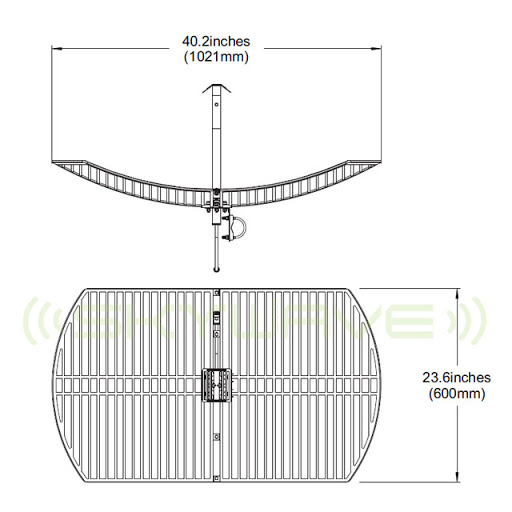

the reflector could be something similar to a TL-ANT2424B (tp-link) but about the feeder you gonna have to ask JOMY (admin)
This is the common parabolic antenna and highly recommended at my country.. but due to its expensive price, i can't get one..
yeah that one is really good and expensive,,,,BUT

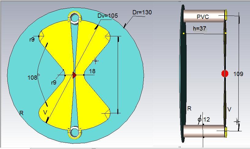

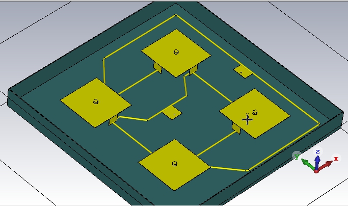

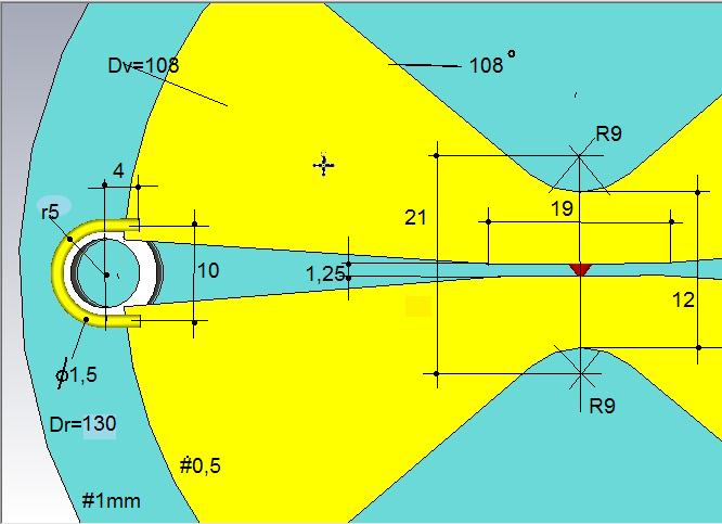

... wouldn't one be better than this ... ???
,,,a good antenna for parabolic(offset) dish....!!!
We should adjust it for dielectric PVC for sure (DOME) and test it on a parabolic dish...

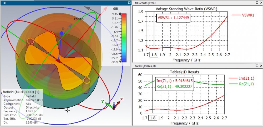

(PS: i could give it a try if you want..) My CST is 2017...can't open new files...
Clanon, try to install cst2020(or 2019)...!!!
Jomy , could you save the cst files in an older version...? (old PC , less than 4gb of ram here) I have a parabolic dish ready to test your antenna...trying a regula feed right now
... I can't ,,,, with 4 gb of ram your pc has to work...!!!
my pc RAM 4GB
AMD Atlhon X4 am3
is work
Nice one Admin ??
Thank you for this.  Even it's hard for me to do that with accurate measurements.
thanks for your effort.
I'll try to make this one.
  On 5/29/2020 at 2:14 AM, acri said:
my pc RAM 4GB
AMD Atlhon X4 am3
is work
Solver type and settings...? (Time , frecuency...etc)
