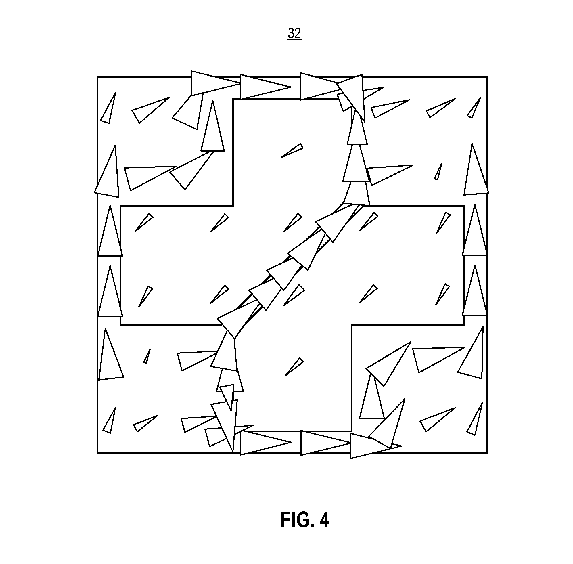

yup, it's dual polarized. But it's quite big and has dual port. Looking for something more compact.
Broad band isn't important for me. More important is wide beam.
2.4 and 5.8 but dual polarized mainly for 2.4. Radio (rc control) has one port. That's I'm looking for such design.
The dual polarized microstrip antenna was design to generate signals with  +45 and -45 polarized but with a loss in directivity gain of about 3dBi
This antenna is more interesting with symmetrical excitation at a resonant frequency
So, we will get almost the same when using CP antenna with similar gain... ?
