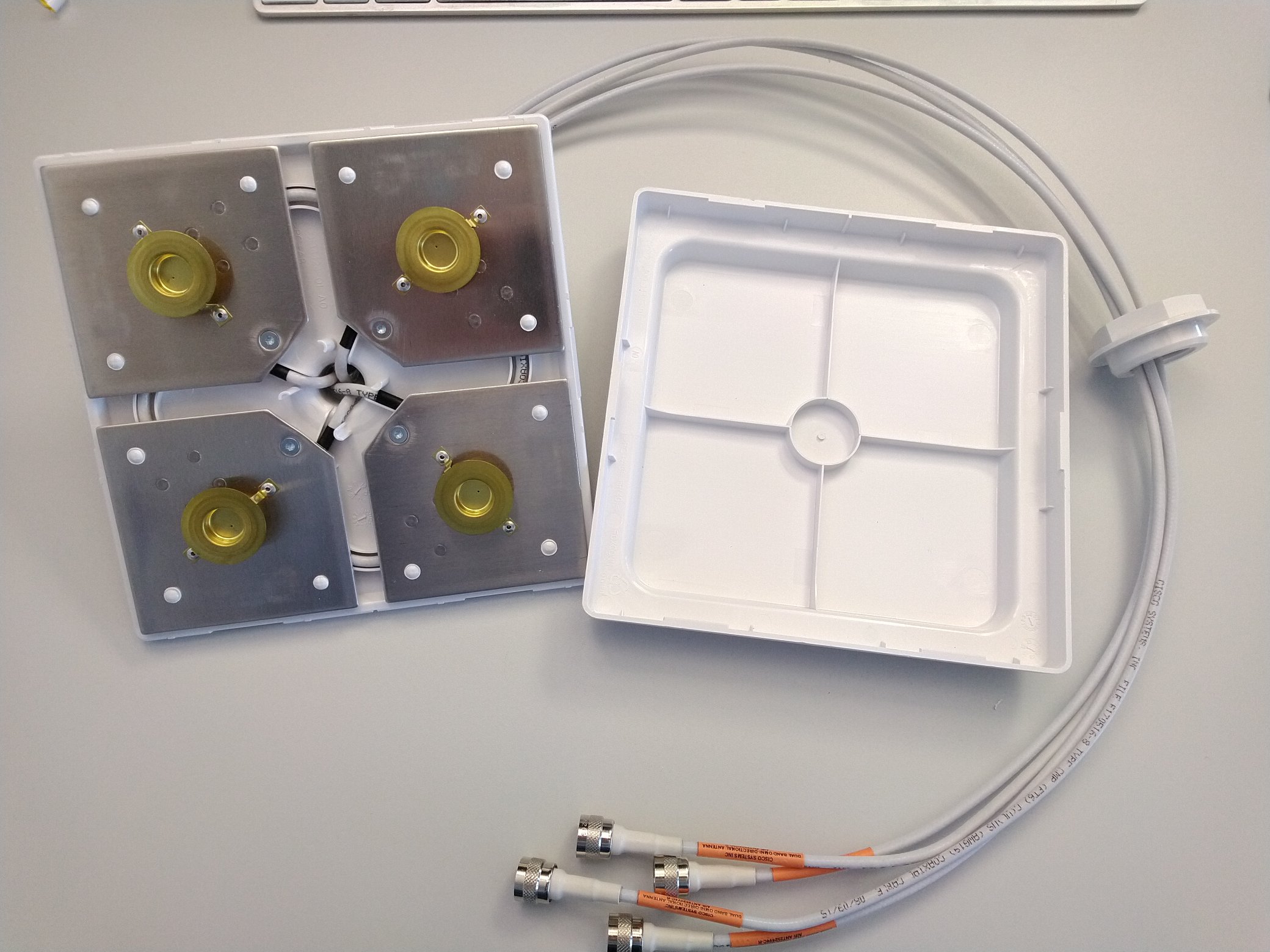

Below are the usual model of omnidirectional antena for 2,4GHz( Ceiling Mount Antenna)
Cisco - AIR-ANT2524V4C-R= - 2.4GHz 2dBi/5GHz 4dBi Ceiling Mount Omni Ant., 4-port,RP-TNC
Aerial Placing / Mounting:Ceiling mountable, indoor
Directivity:Omni-directional
Frequency Range:2.4 GHz, 5 GHz
Gain:2 dBi (for 2.4 GHz), 4 dBi (for 5 GHz)
Voltage Standing Wave Ratio (VSWR):2.0:1
Connector Provided:4 x RP-TNC
Cable Length:91.4 cm Depth:2.5 cm Height:18.4 cm
Product Type:Antenna
Weight:0.59 kg Width:18.4 cm

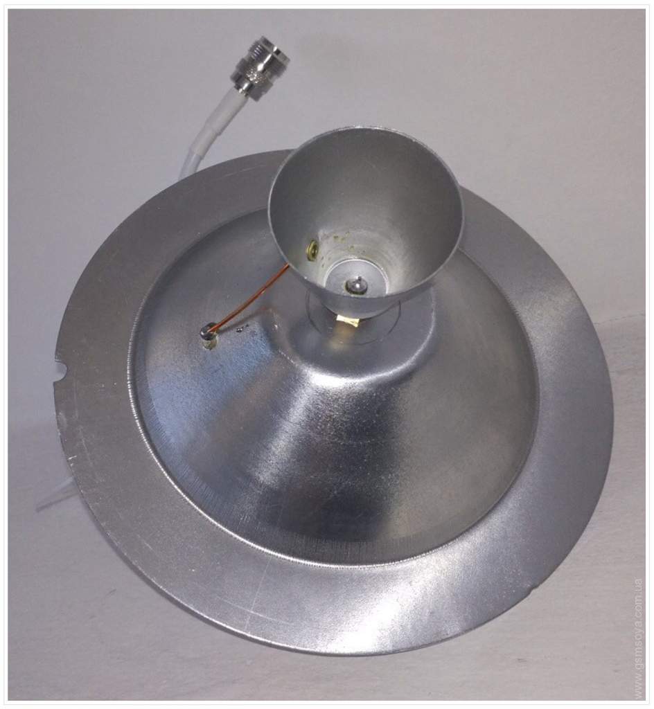

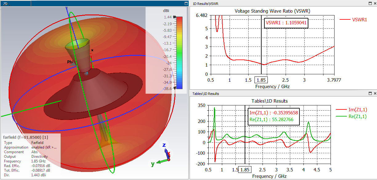

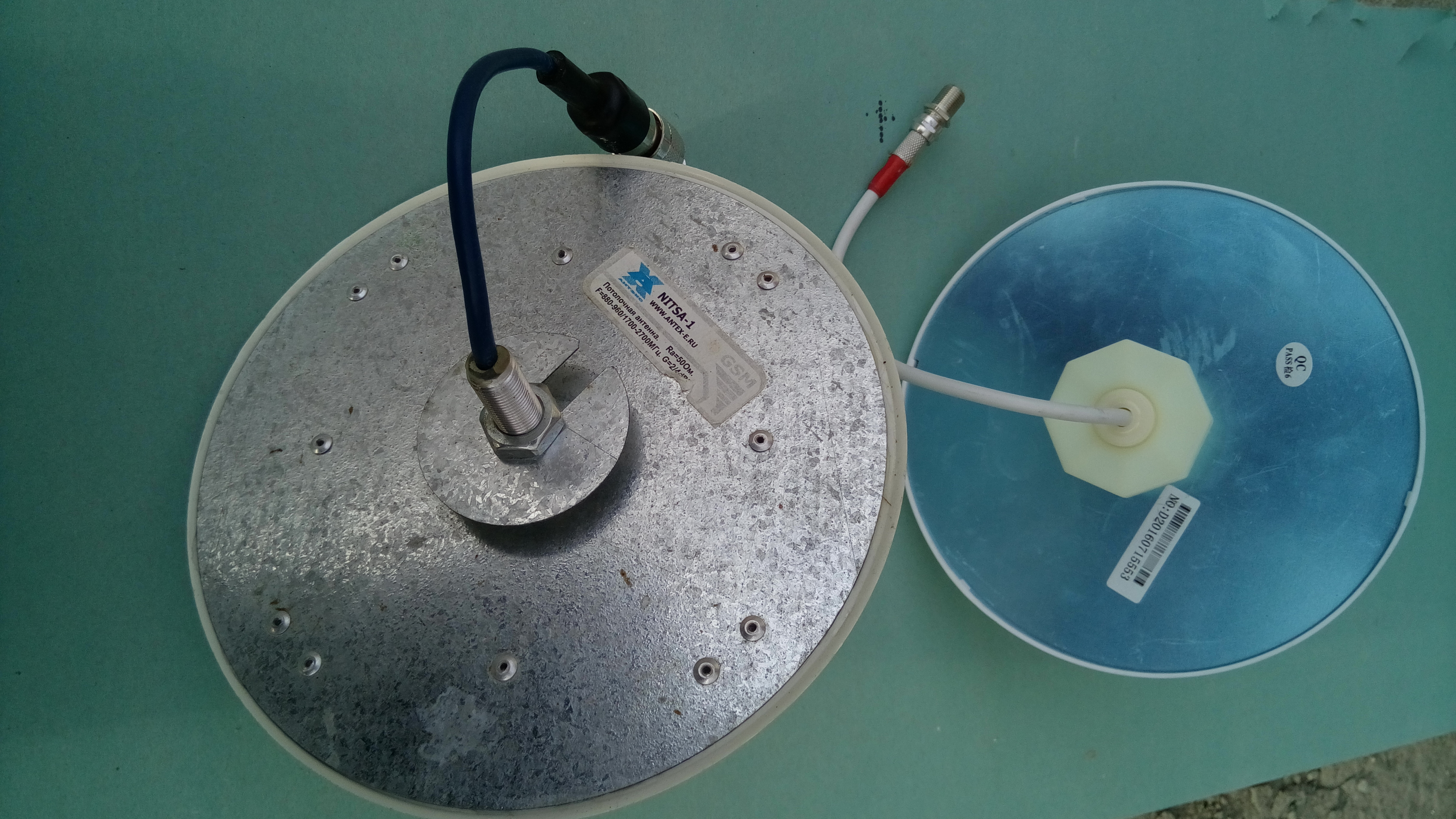

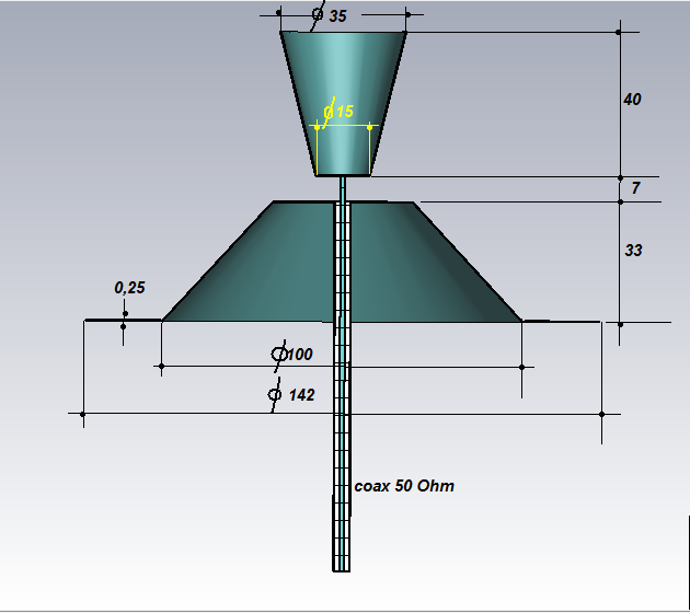

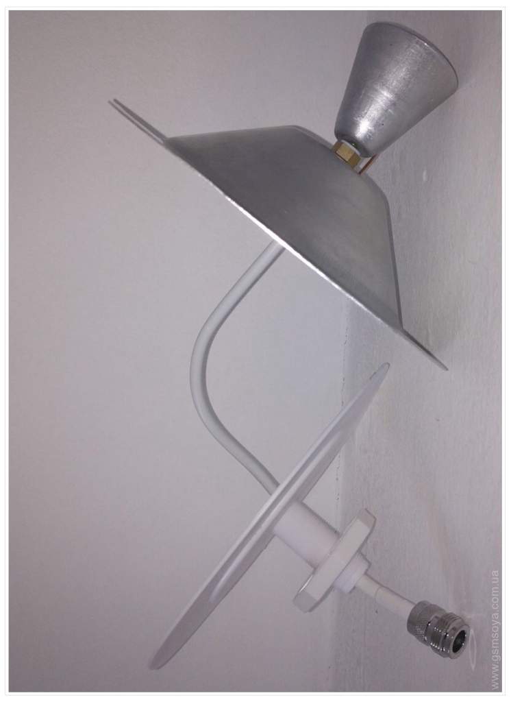

NITSA-1 Antenna or Ceiling Antenna....???!!!
NITSA 1--it's very good, but I think it can be even better...!!!
,,,another type of omni antenna...
