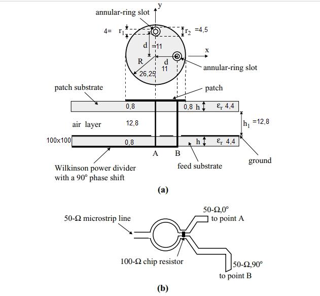

On 10/26/2020 at 2:19 PM, swarg_eu said:

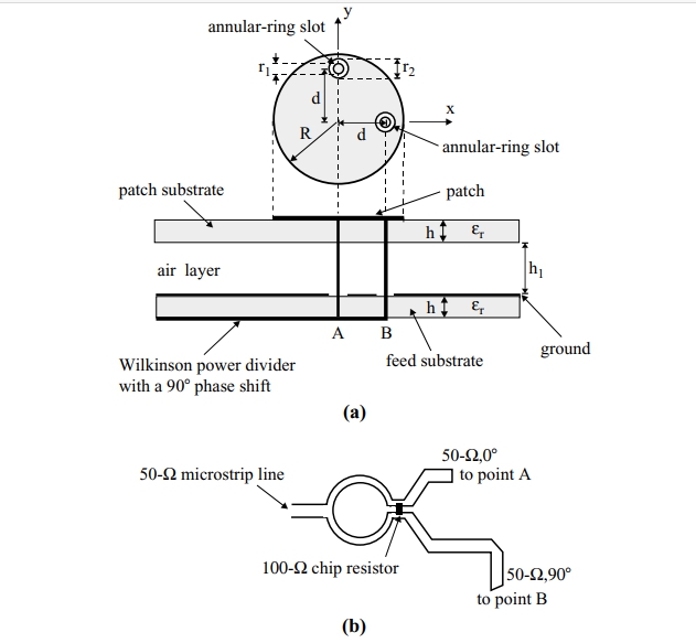

for this type of antenna, a simple power splitter is not a solution (no phase shift between ports)
the patches need to be driven with a 180 deg phase shift, otherwise, there will be no main lobe in the radiation pattern (in its place will be a zero)
Therefore it uses a transformer (wire loop) that transforms the single-ended (asymmetric) to differential (symmetric, 180 deg phase shift) port
the rest of the PCB traces (GND below) ensures a proper impedance match

swarg_eu,You can design such a divider...???
that not a problem,
but depending on the frequency a 90 deg hybrid or a ratrace is a better solution
1400 MHz-2600 MHz, broadband circularly polarized microstrip antenna with two gap-coupled probe feeds;
Dimensions ..

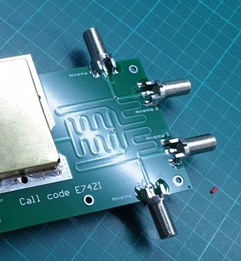

On 8/13/2020 at 9:52 PM, swarg_eu said:
Combined via 3 x wilkinson splitter
2x antenna on wilkinson
2x wilkinson on wilkinson
Its just added 6dBi gain by combining the 4 antennas to a 2x2 array

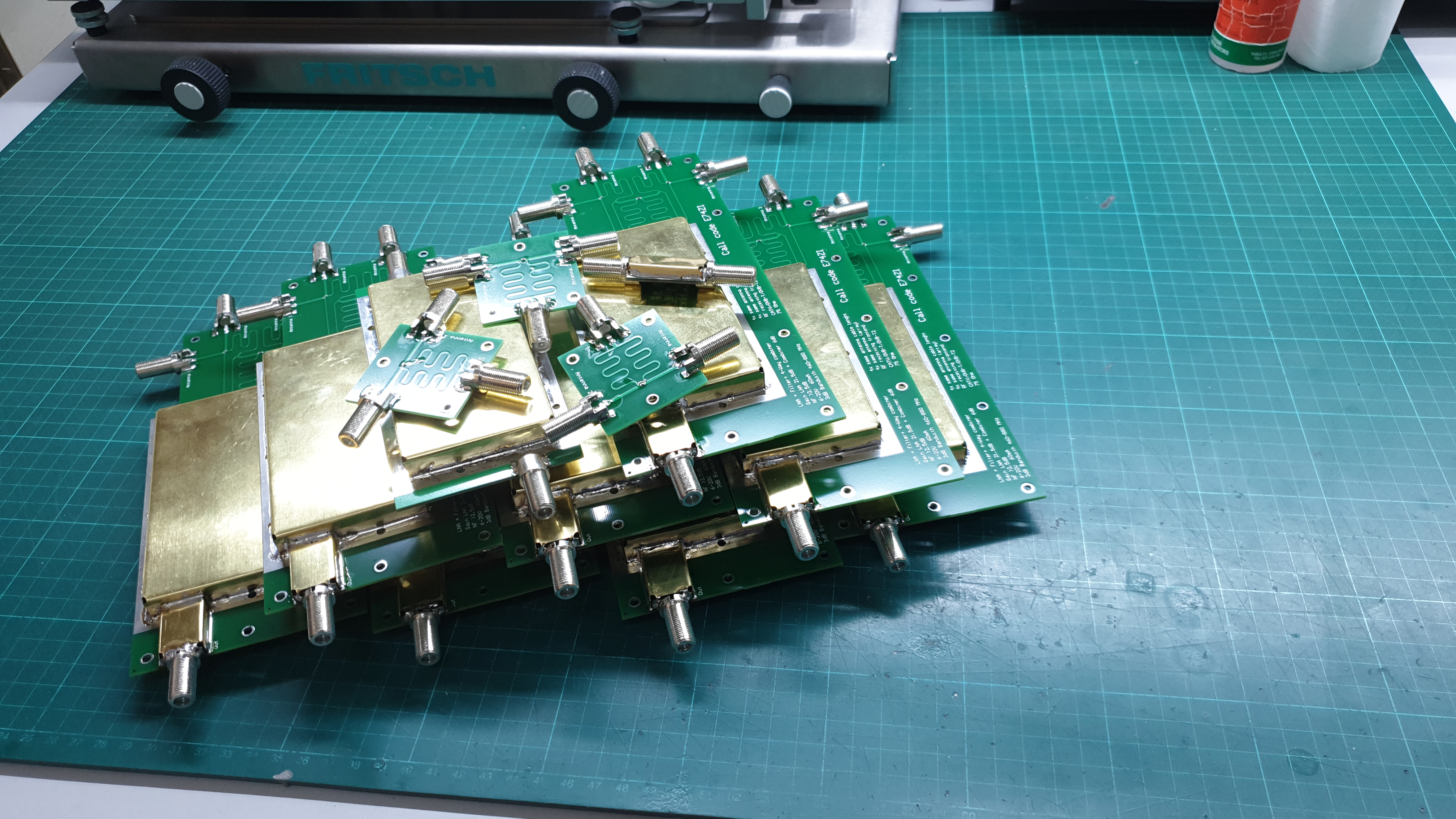

Jossip,if I understand you want something like that....
There are 2:1 4:1 combiner, filer, LNA separately and the 4:1 filer and LNA on single board
