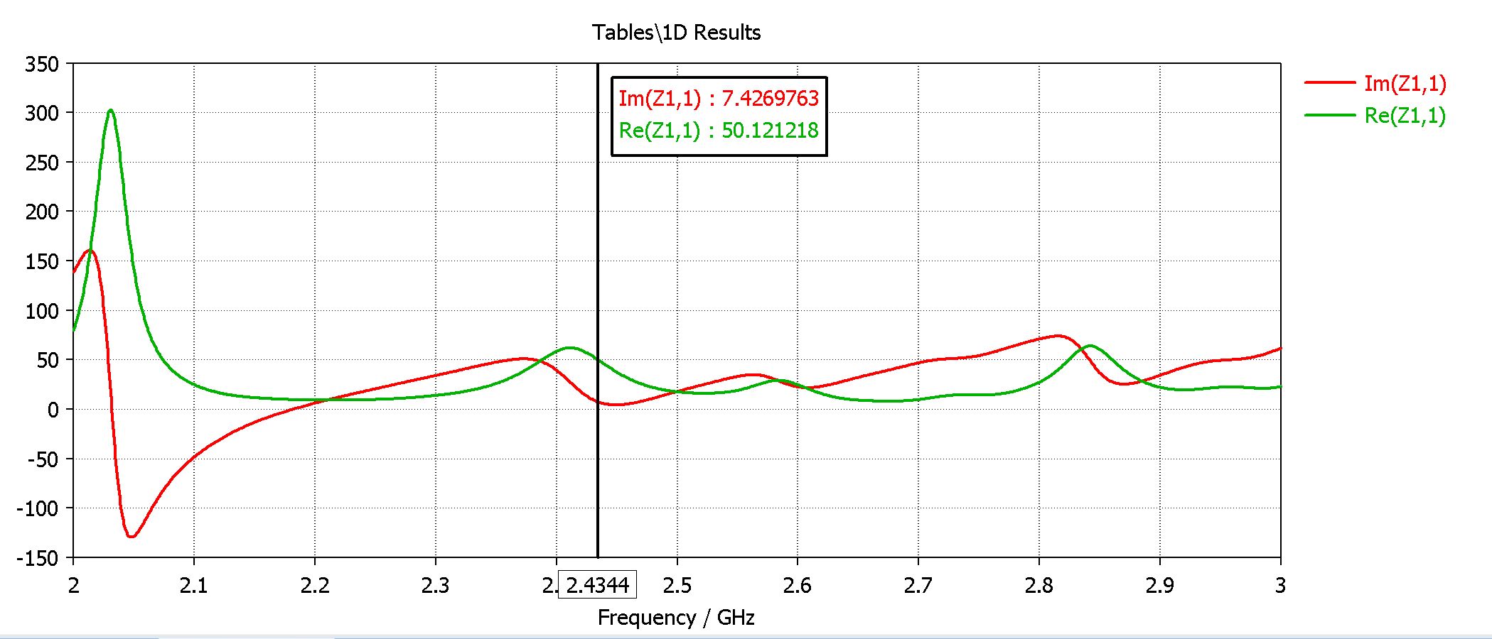

3.5ghz to 2.4ghz

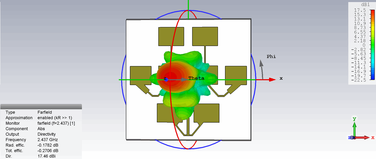

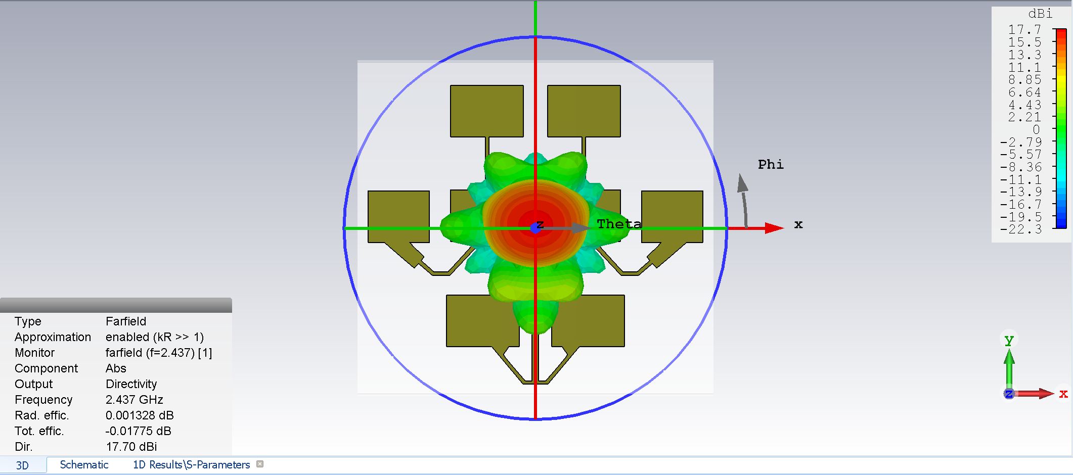

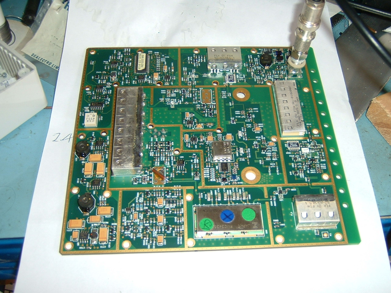

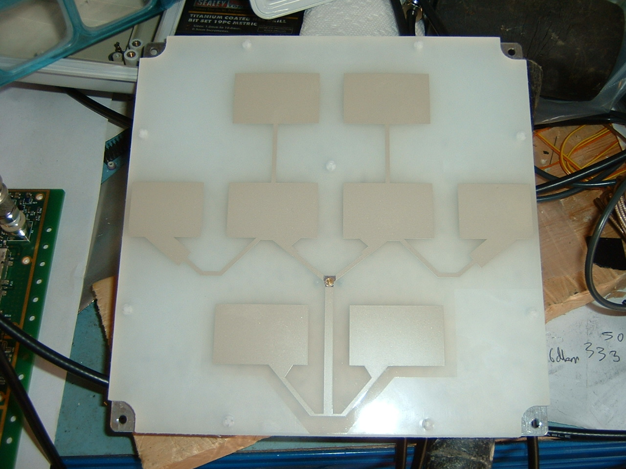

UK 's Amateur radio unit (3.5ghz) reverse engineered to 2,4 ...working on it
Using teflon as dielectric about 30 by 35 cms
It SHOULD be closer to 18dbi...
Efficiency still low...(depends on DIELECTRIC and Thickness)

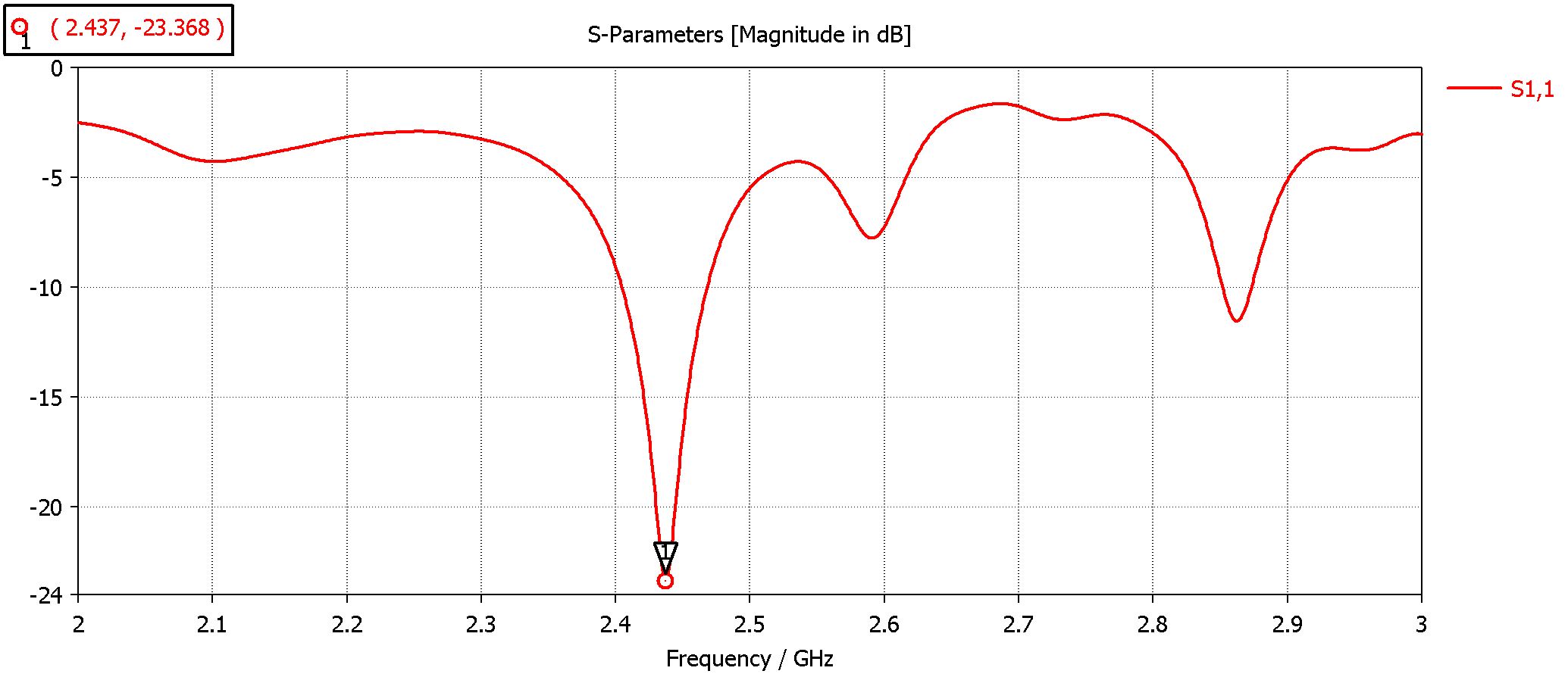

,,,the impedance is for the narrow frequency band..!!!
Slot feed could give some more Mhz...maybe...Designed for GAIN mostly...imho
