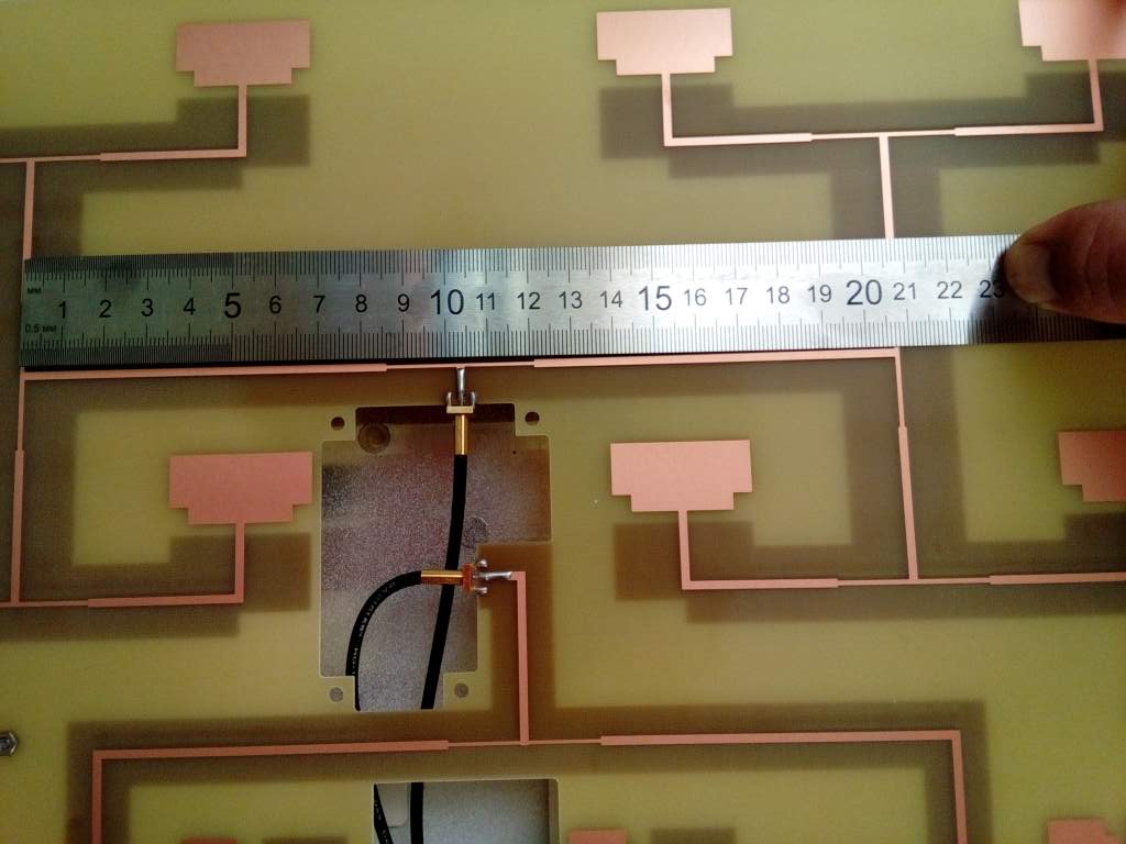

Novicom vs Anteks MiMo Antenna 1,7-2,7GHz

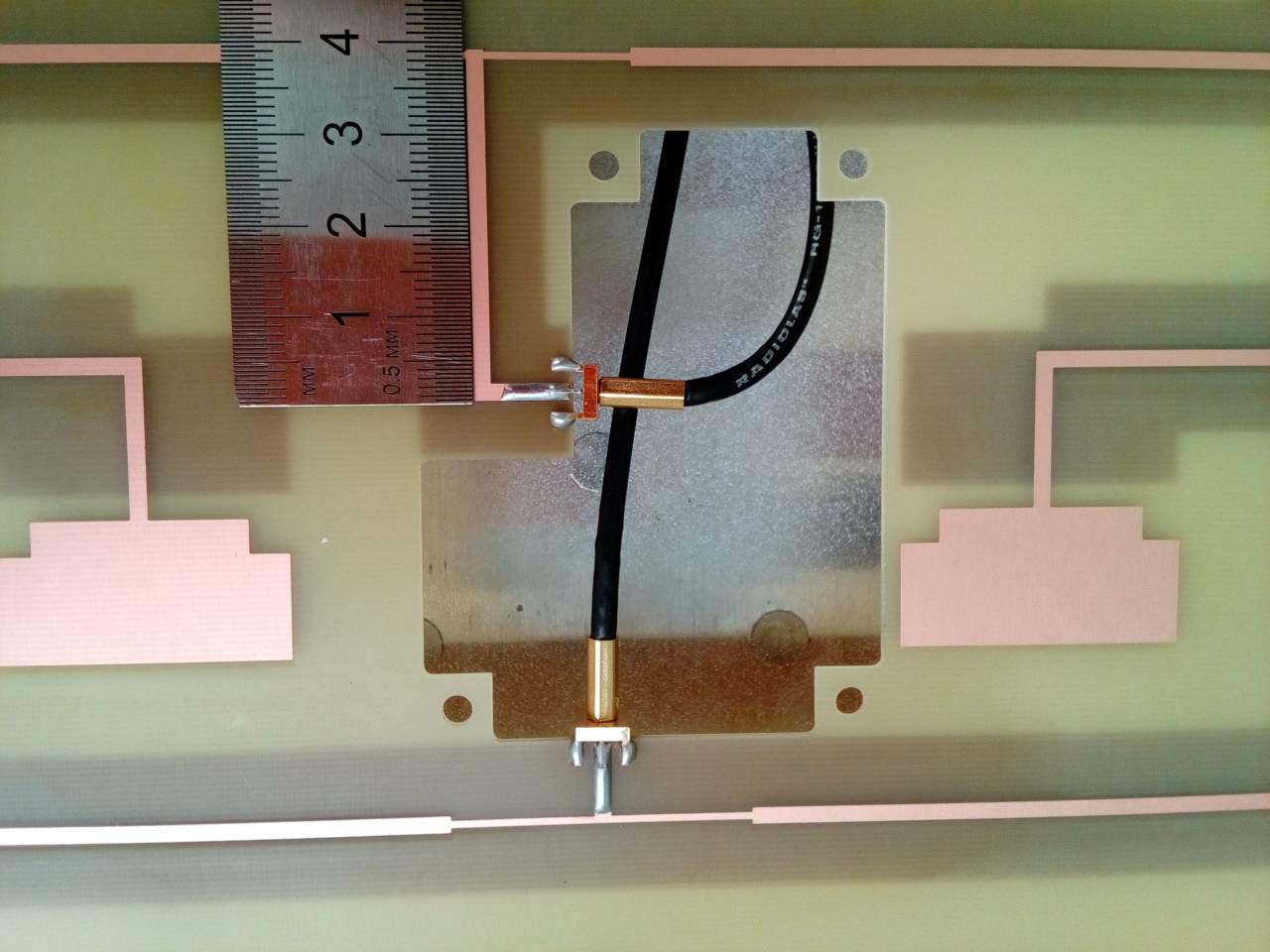

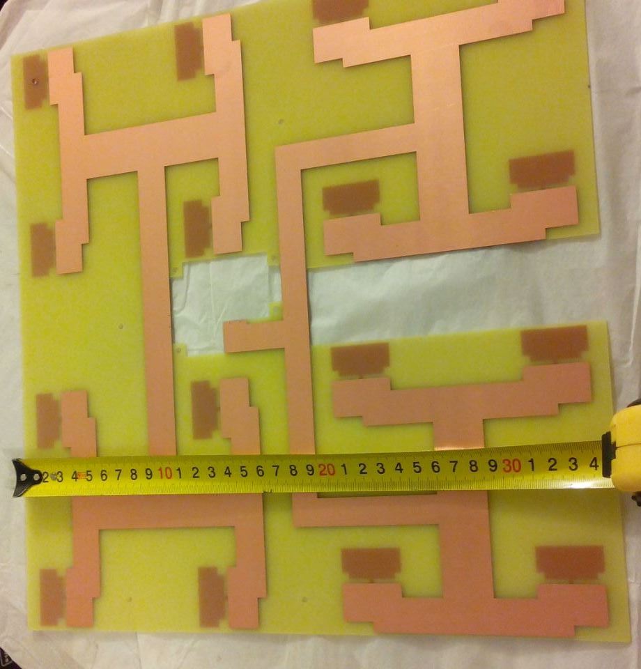

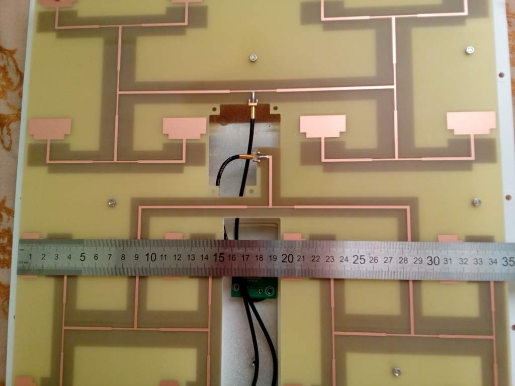

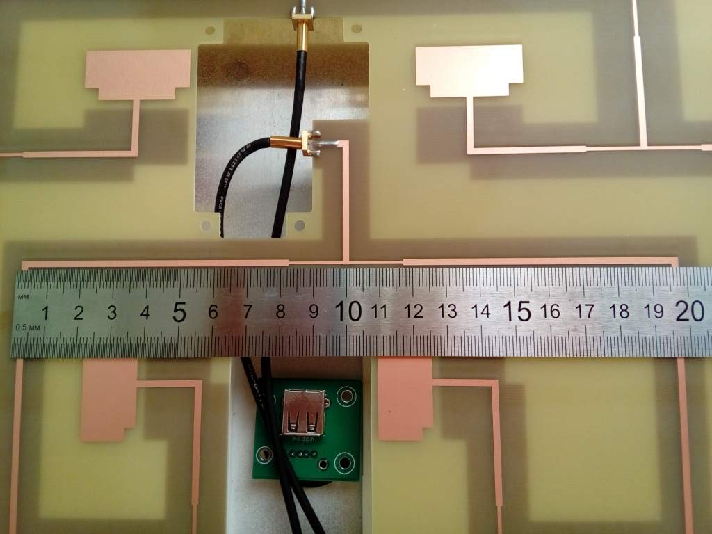

Novicom antenna on PCB
,,,from video,,,

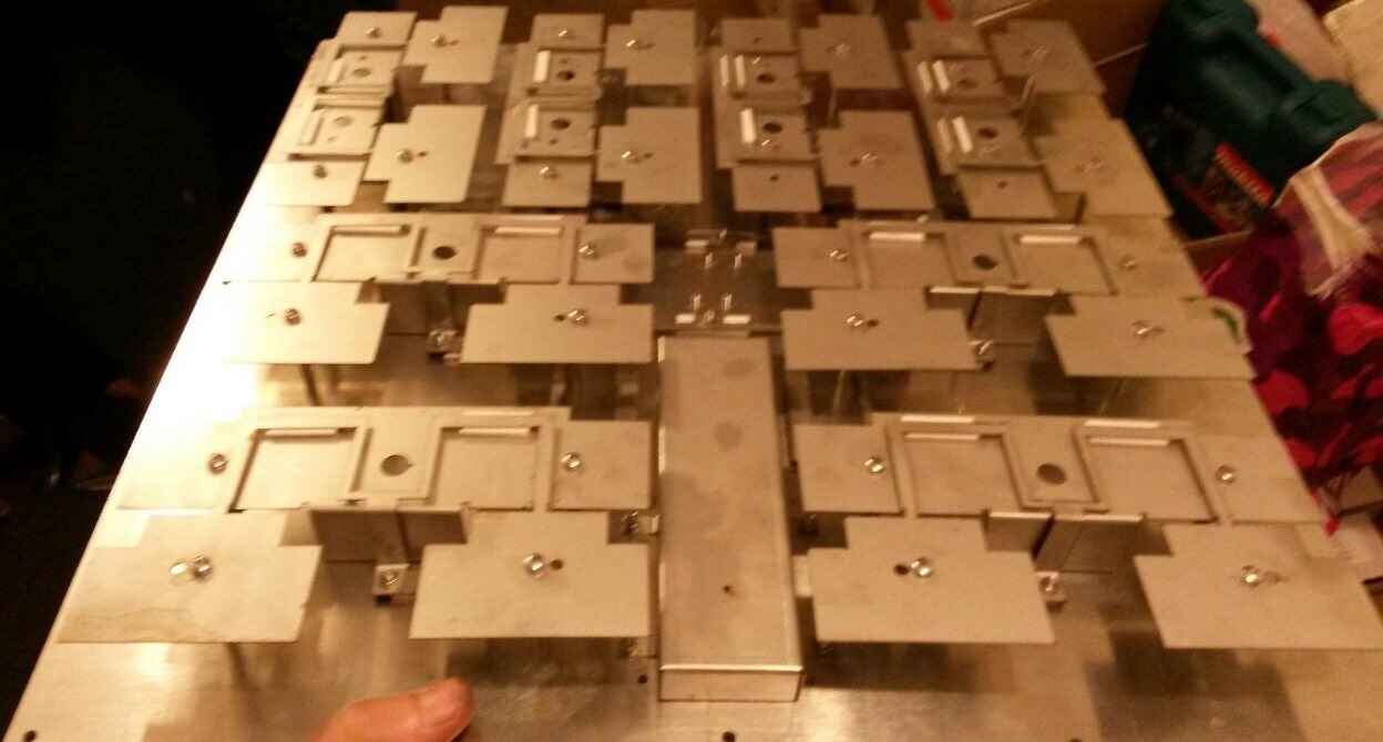

Anteks antenna on the air

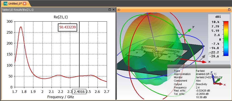

"Yes, it seems that this impedance adaptation with suspended adaptive lines can provide a higher frequency band
