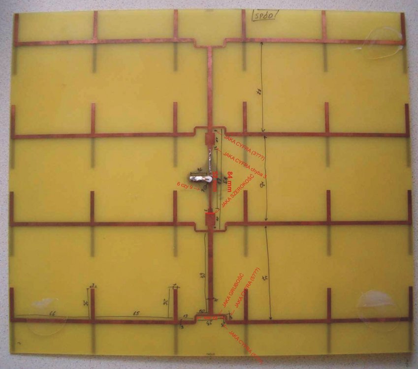

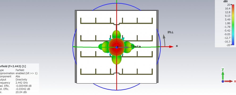

18dbi PCB dipole array

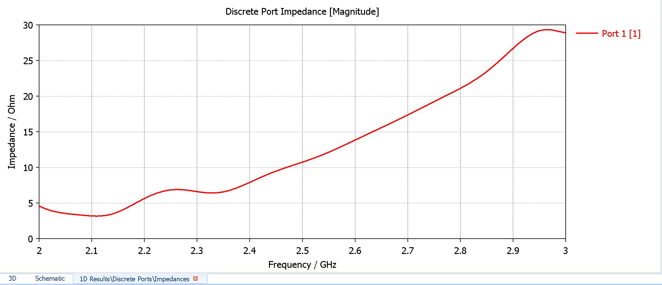

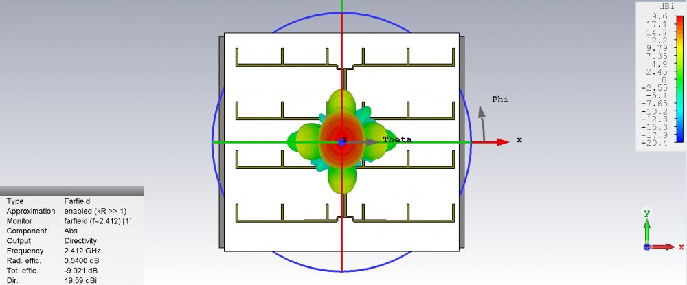

Jomy , NEED HELP this SUCKER doesn't take energy ,
Z is wrong (Too LOW)

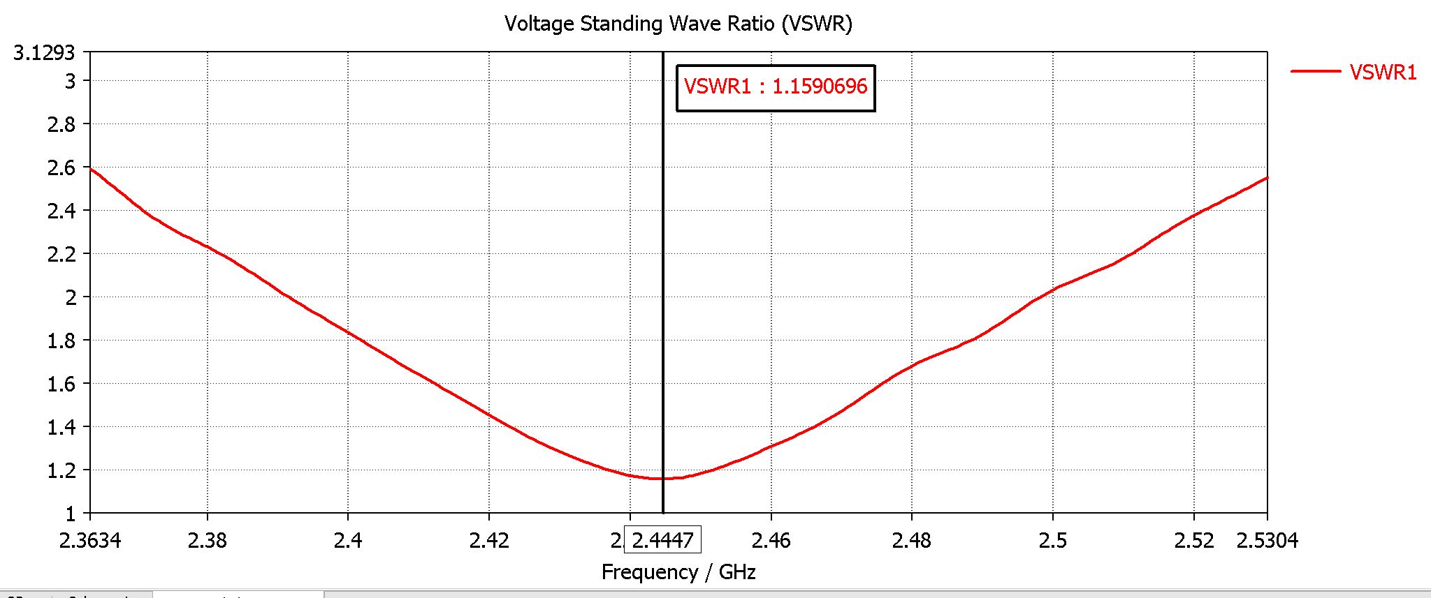

S11 (too LOW) almost 0
Vswr HIGH as HELL
(PS: tried everything can't make it "dance")

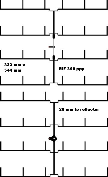

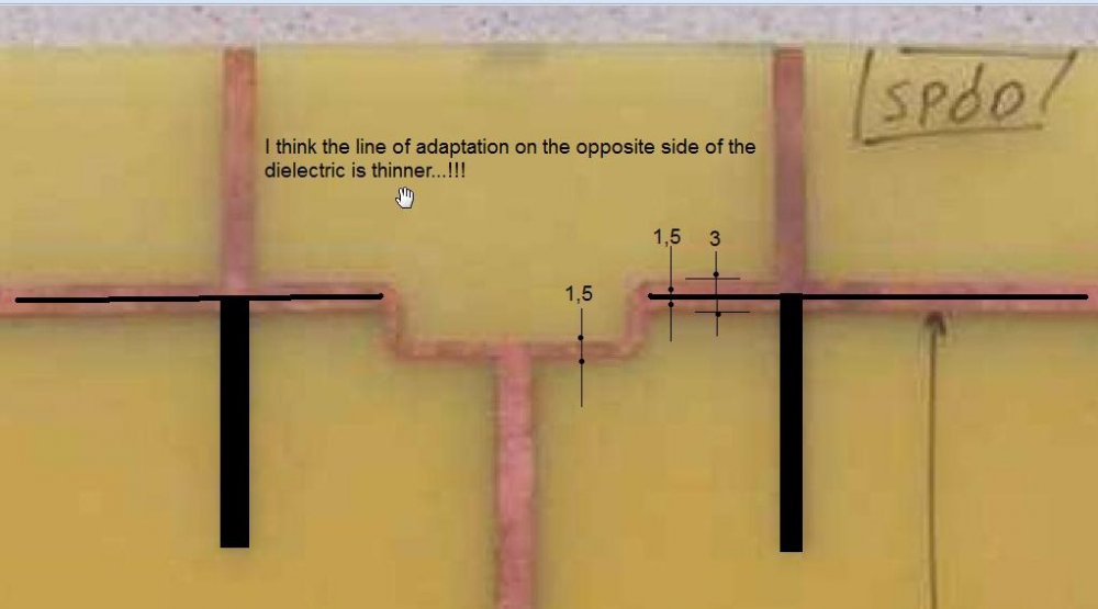

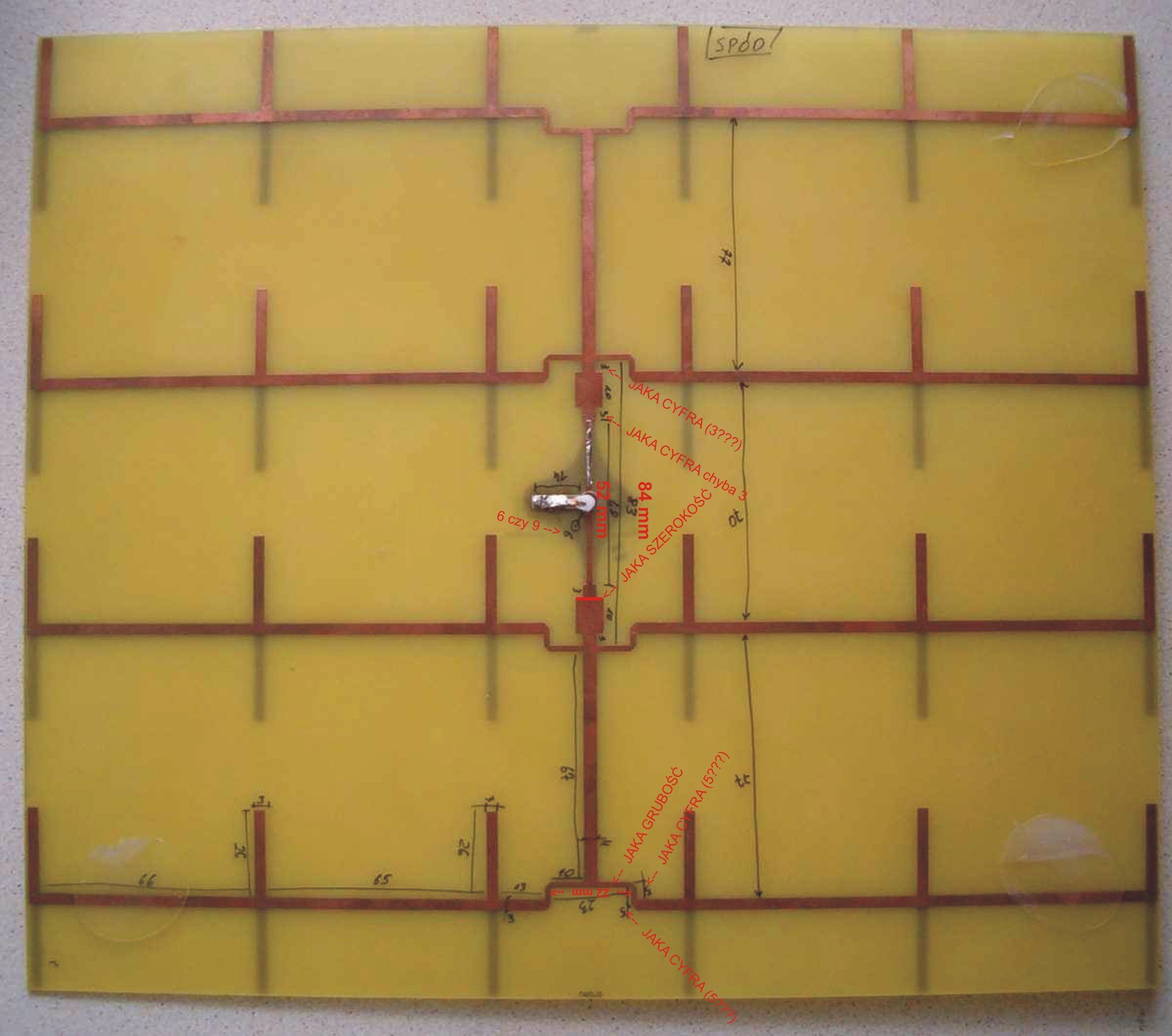

,,, what is the distance between the vibrators and the reflector and impedance ... ??
(Its supposed to be 2cm)
i tried from 5mm or less to 25 mm and more...NOTHING S11 never gets under 7 , 8...or LESS
Z goes up to 20 ohms MAX...(never passes 15 , 20 ohms)
tried 1mm and 0.5 FR4 , Rexolite and Roger...(Nothing)
 What i DIDN't try was a DIFFERENT PORT...(only discrete)
