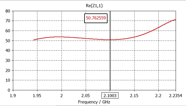

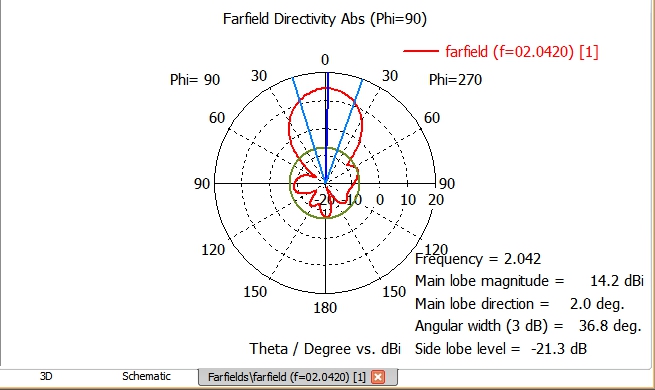

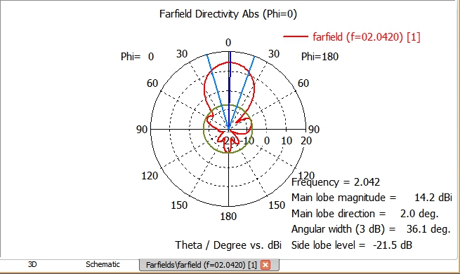

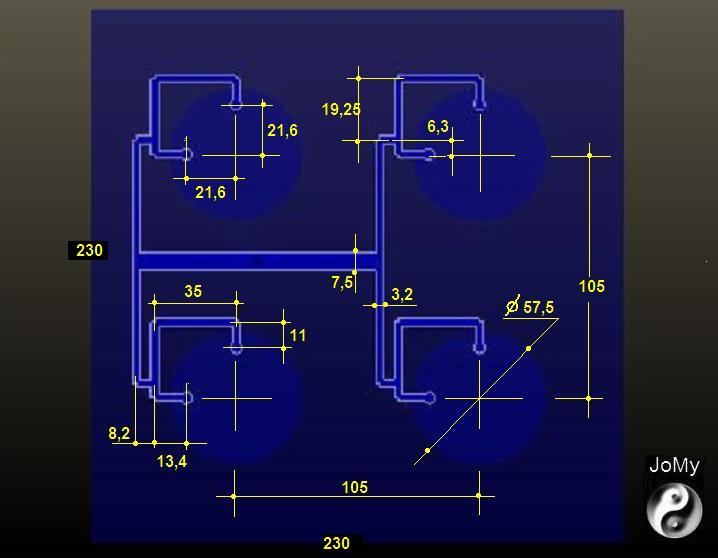

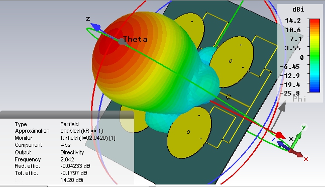

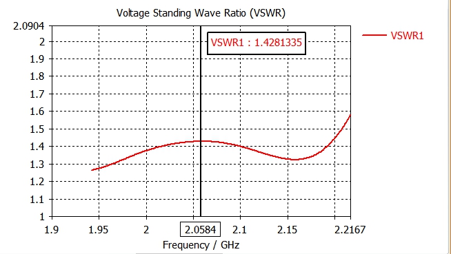

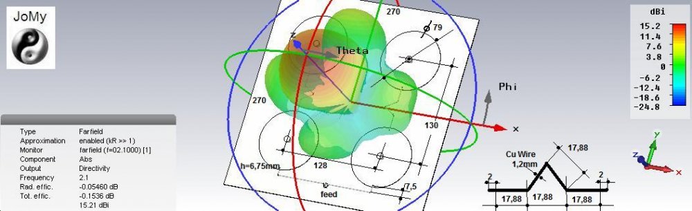

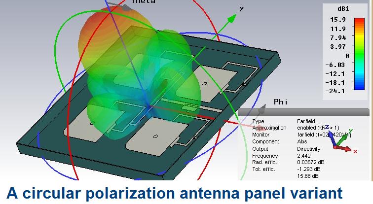

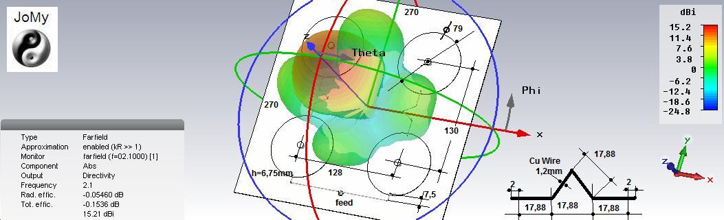

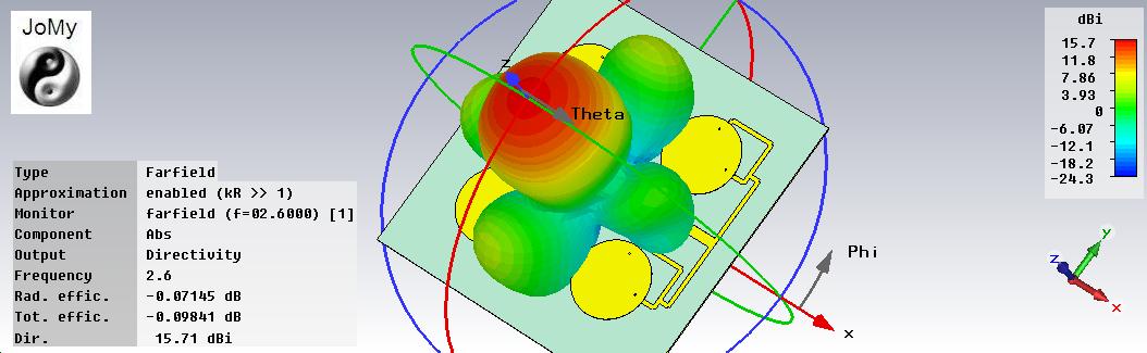

2x2 Panel Anntenna
2x2 antenna panel that shows a circular polarization and operates in 3G frequency band...

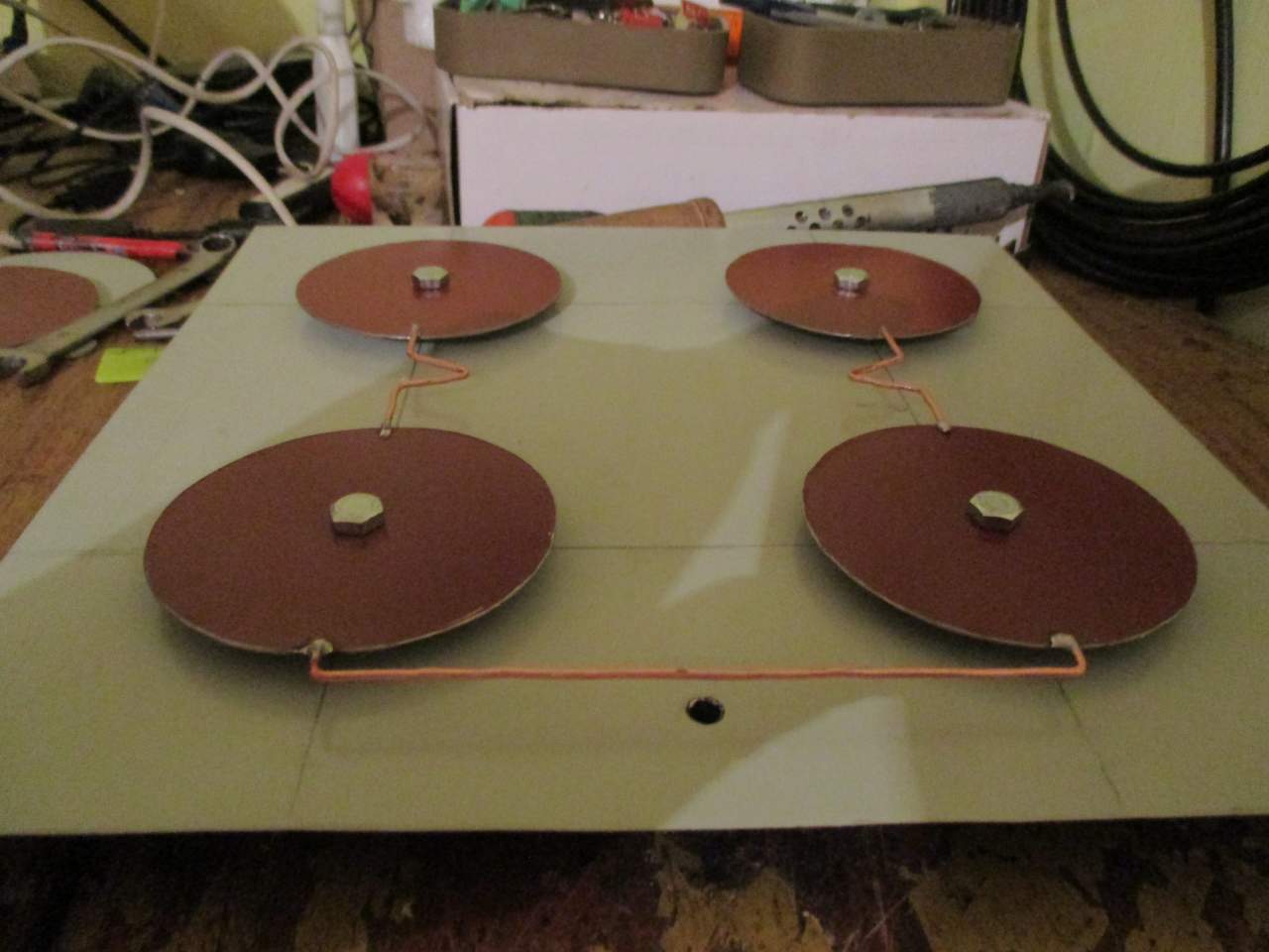

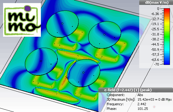

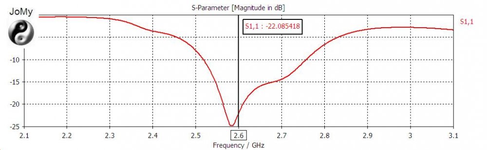

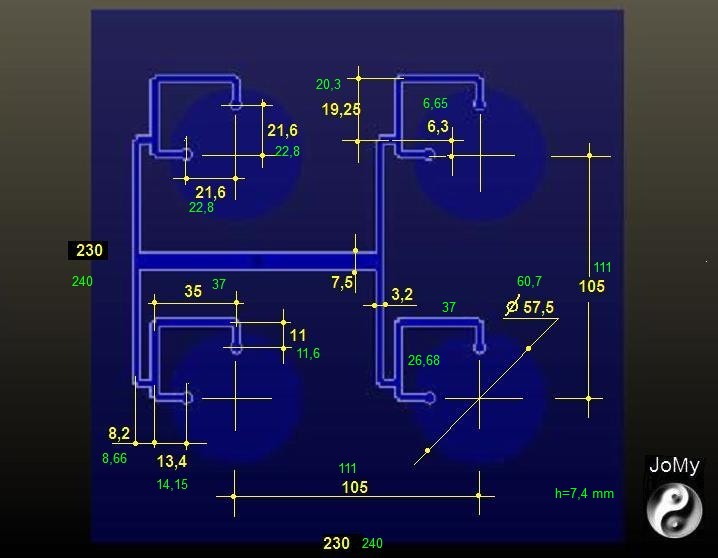

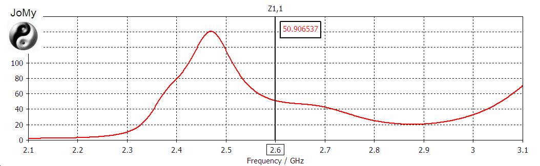

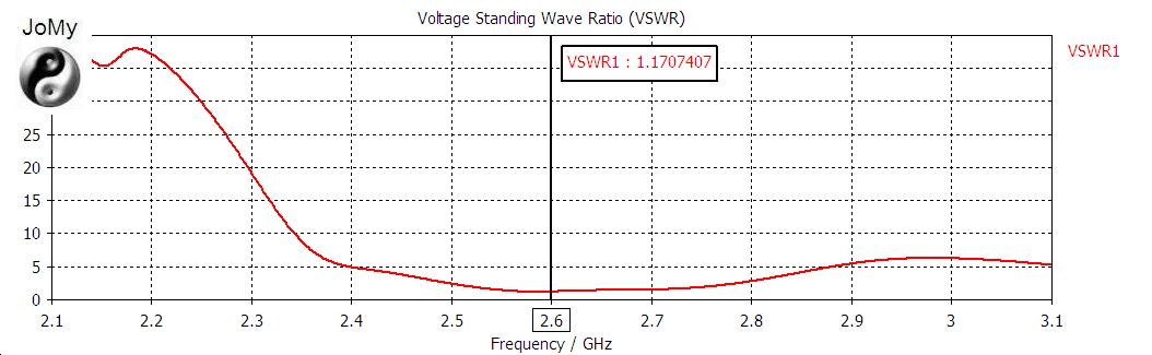

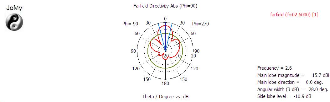

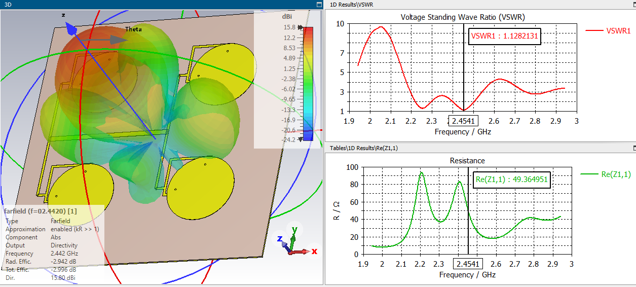

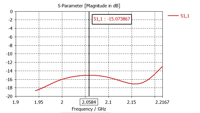

4G Frequency Band

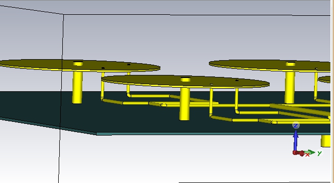

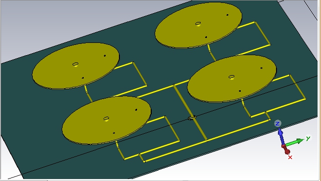

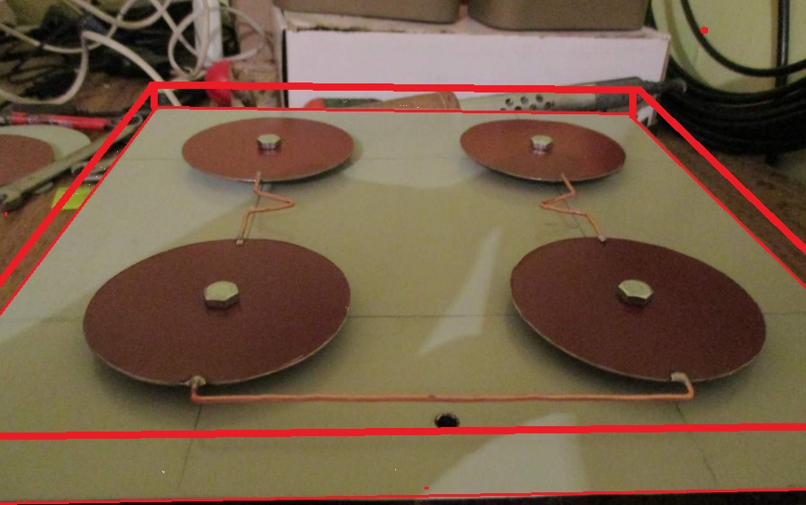

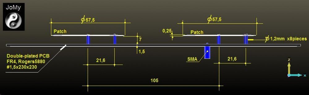

At  this panel antenna, transmission lines between patches as well as reflector are made of double plated PCB.

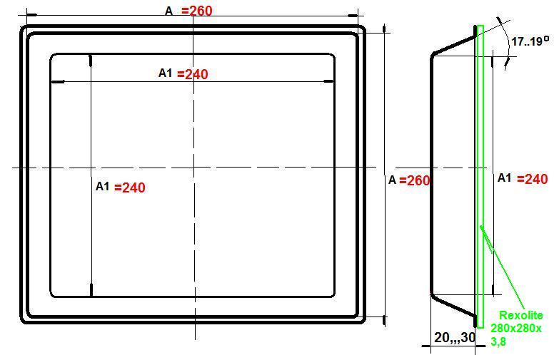

вы можете сделать что-то подобное с наклоном ниже ...
