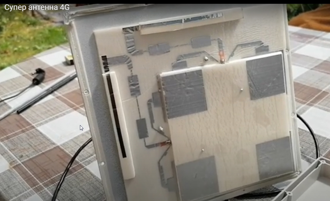

Delta 3G / 4G 20+

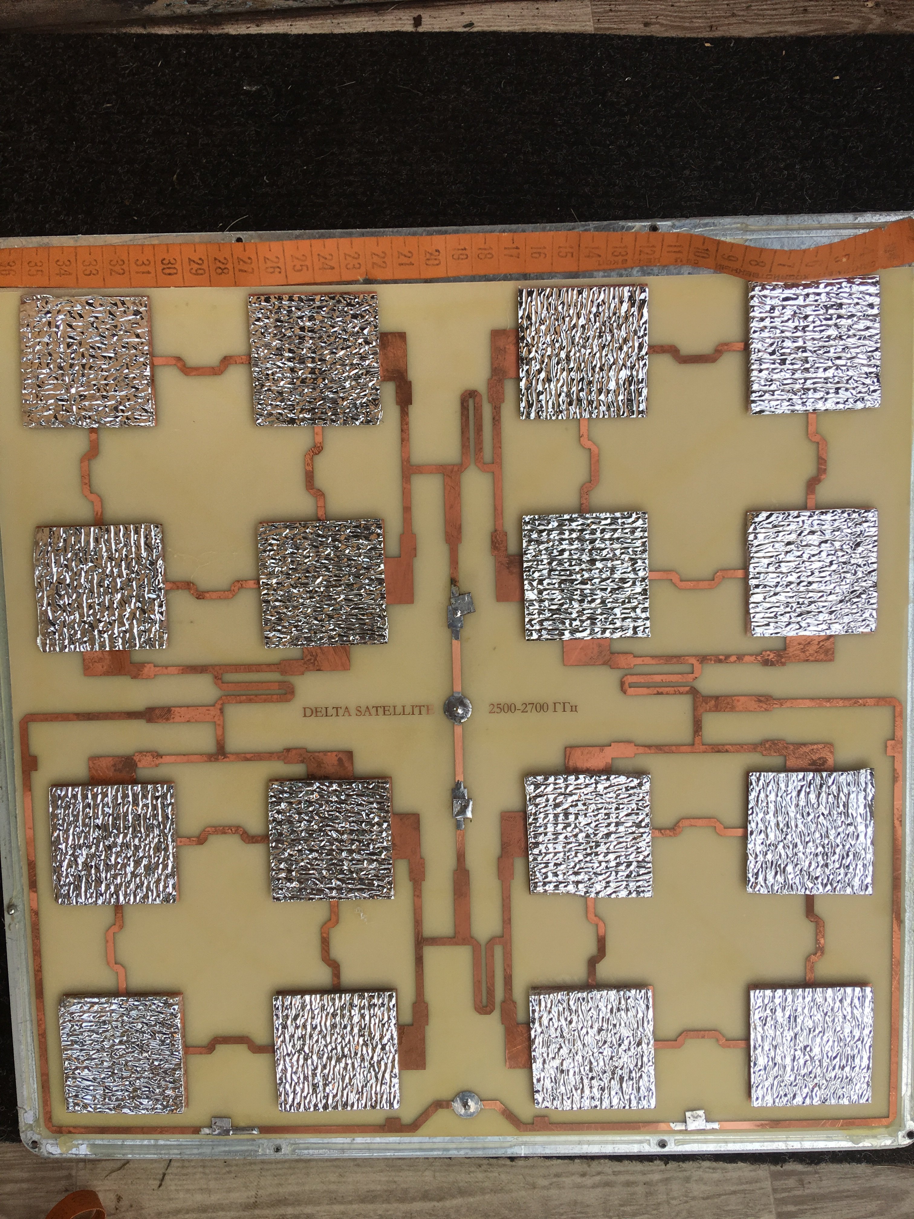

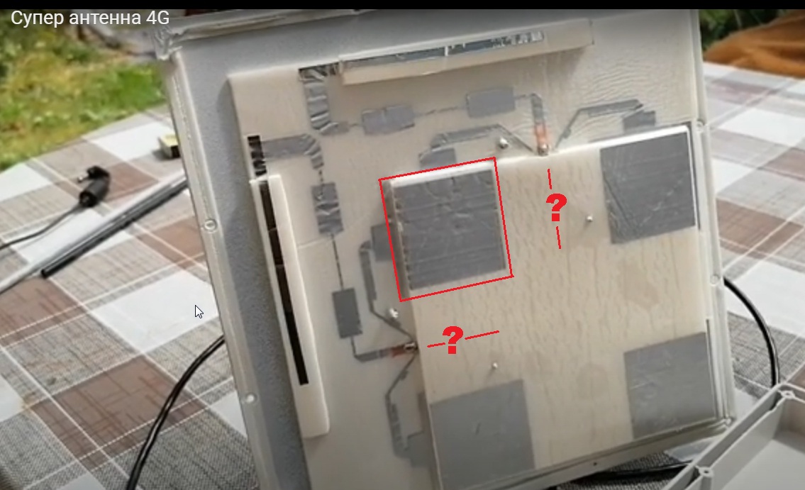

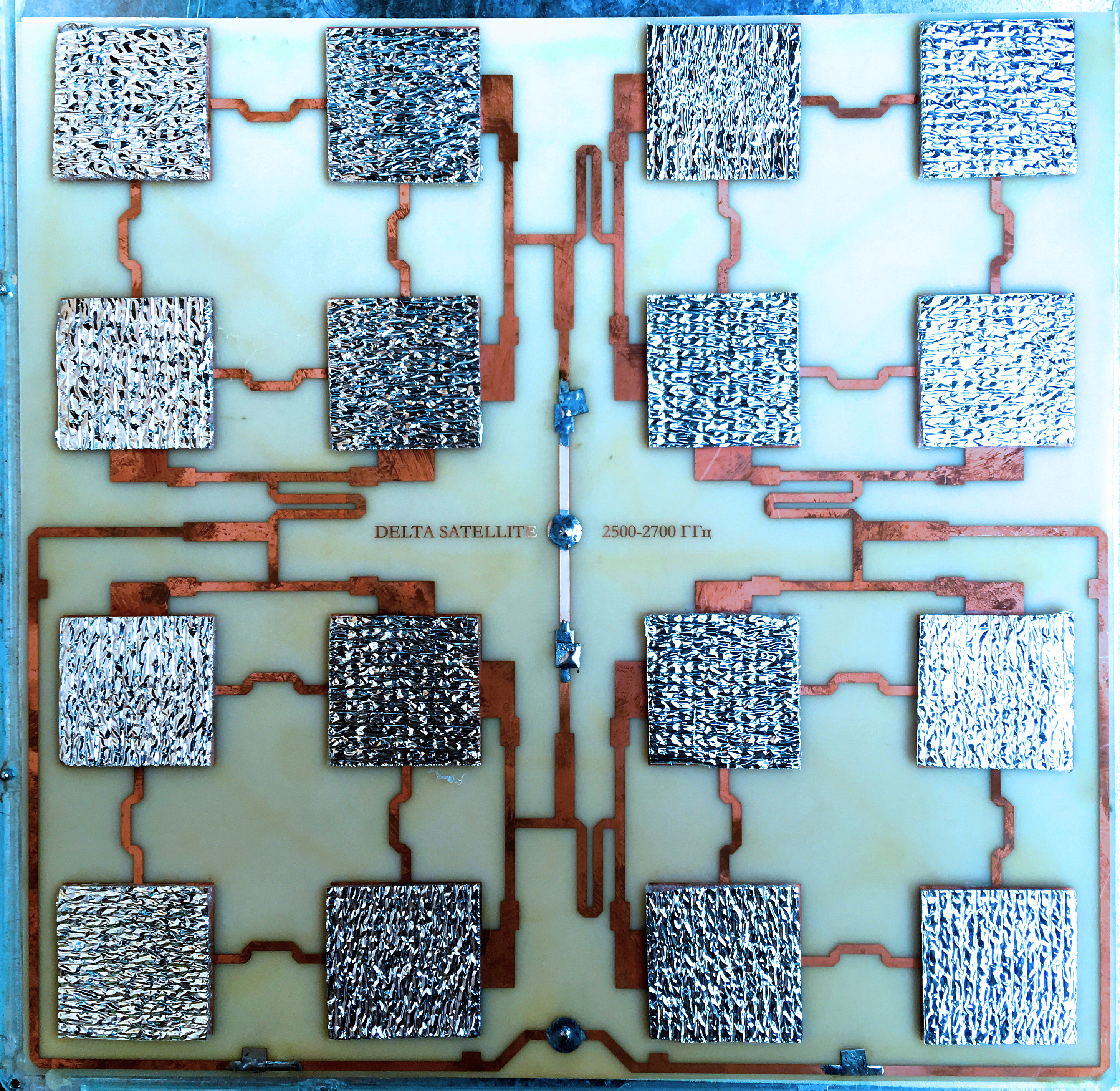

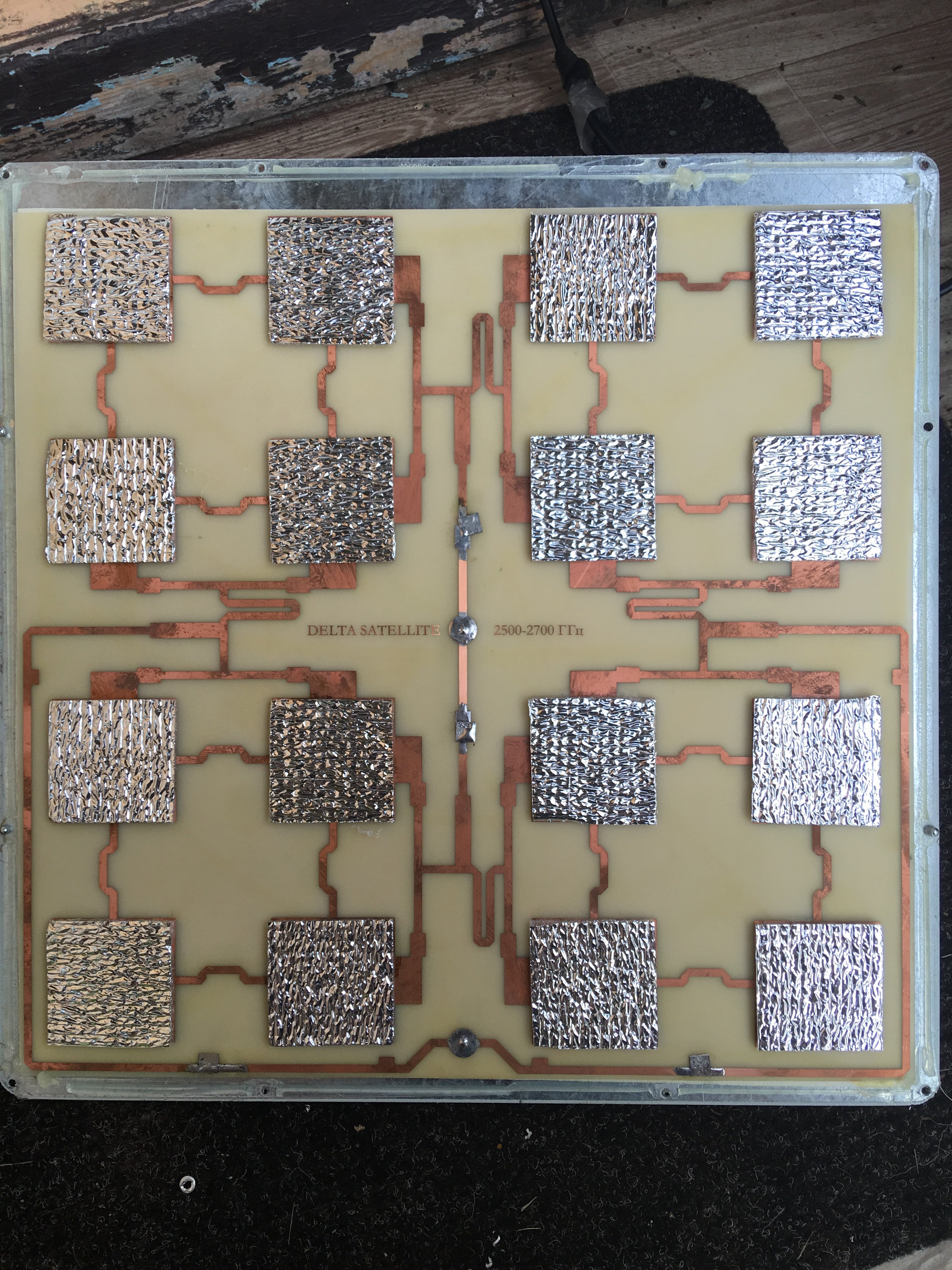

Interesting design , don't know about performance...

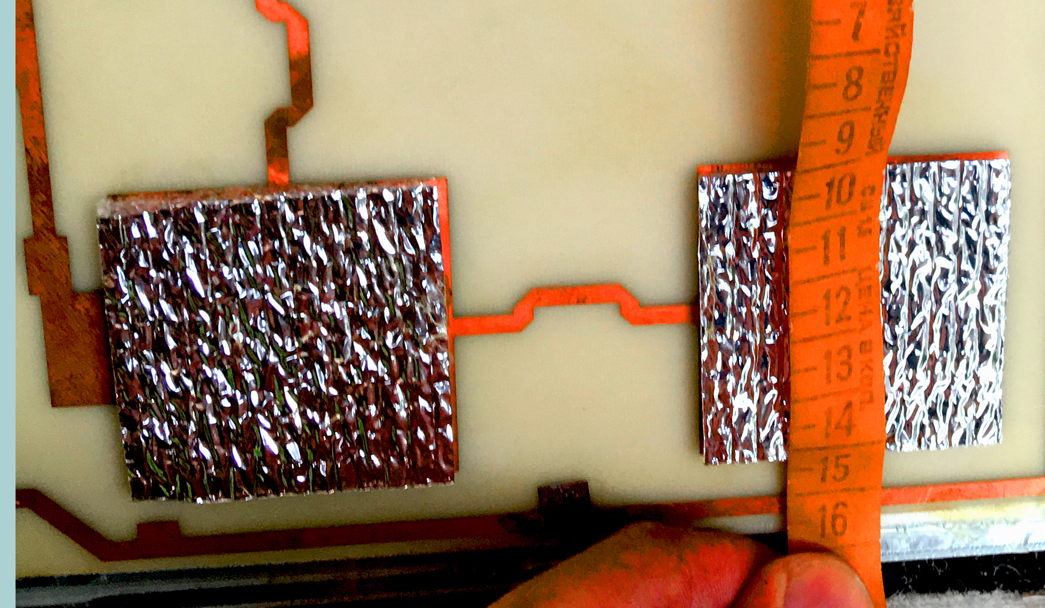

Polyurethane aluminum PATCHES
Manufacturer

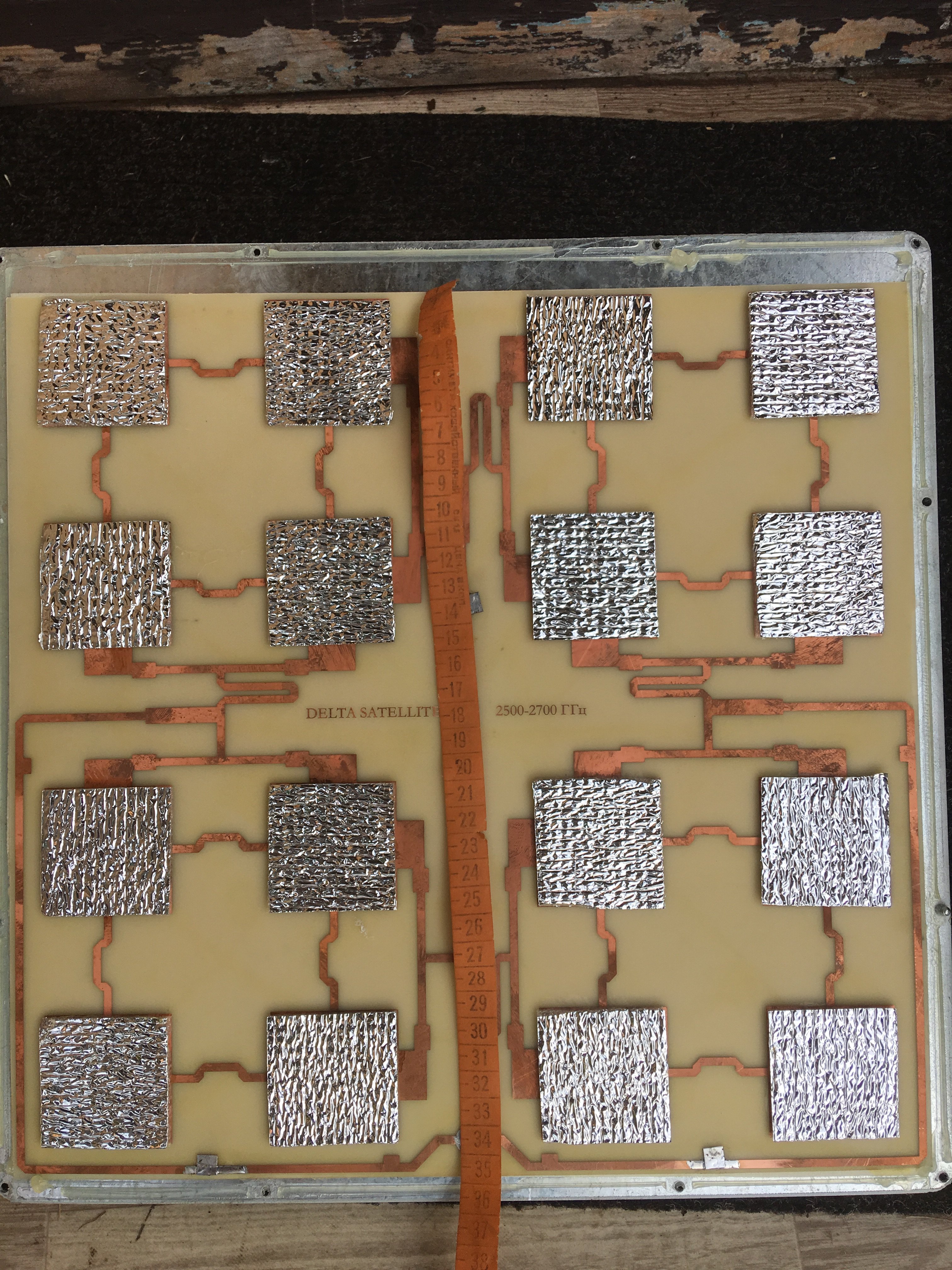

,,, yes, it's really interesting, I've seen it before, you have the dimensions ... ??? !!!
,, and what the vibrating patch looks like...???

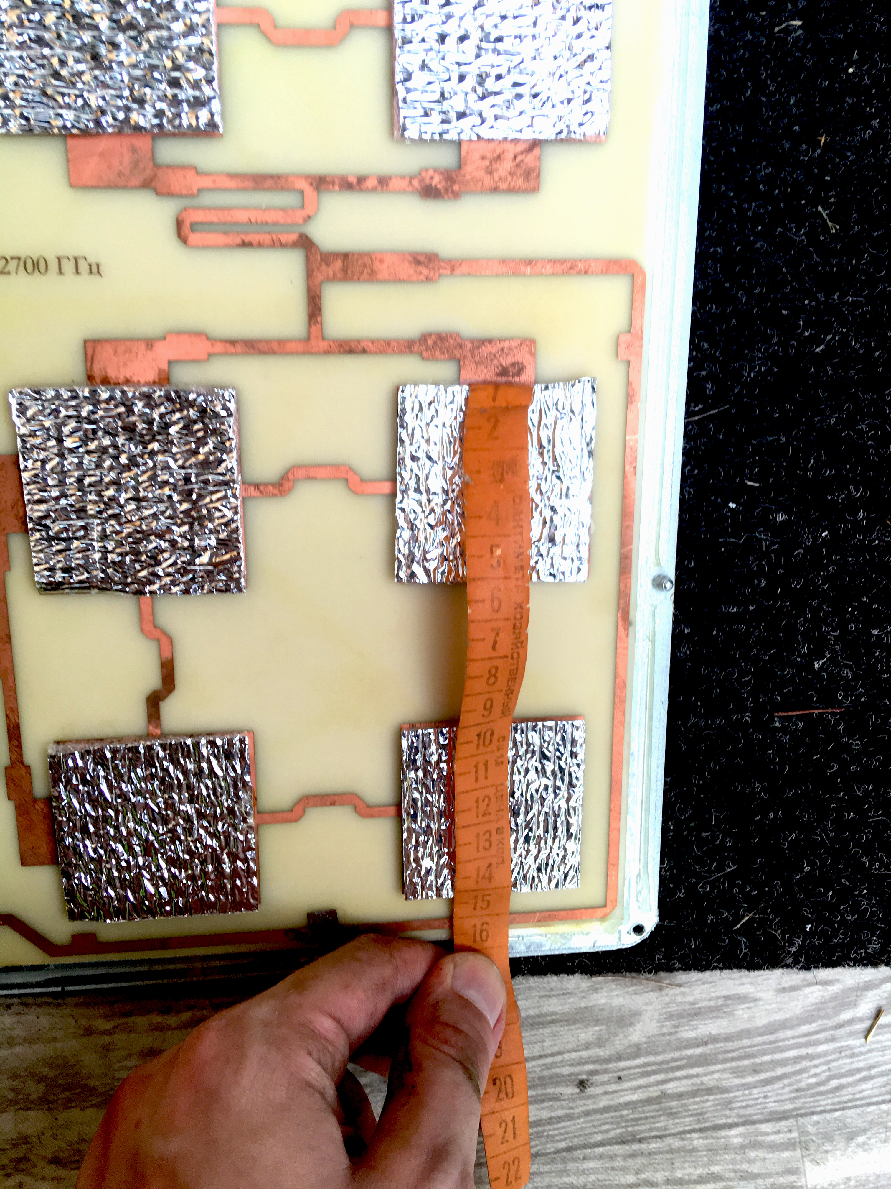

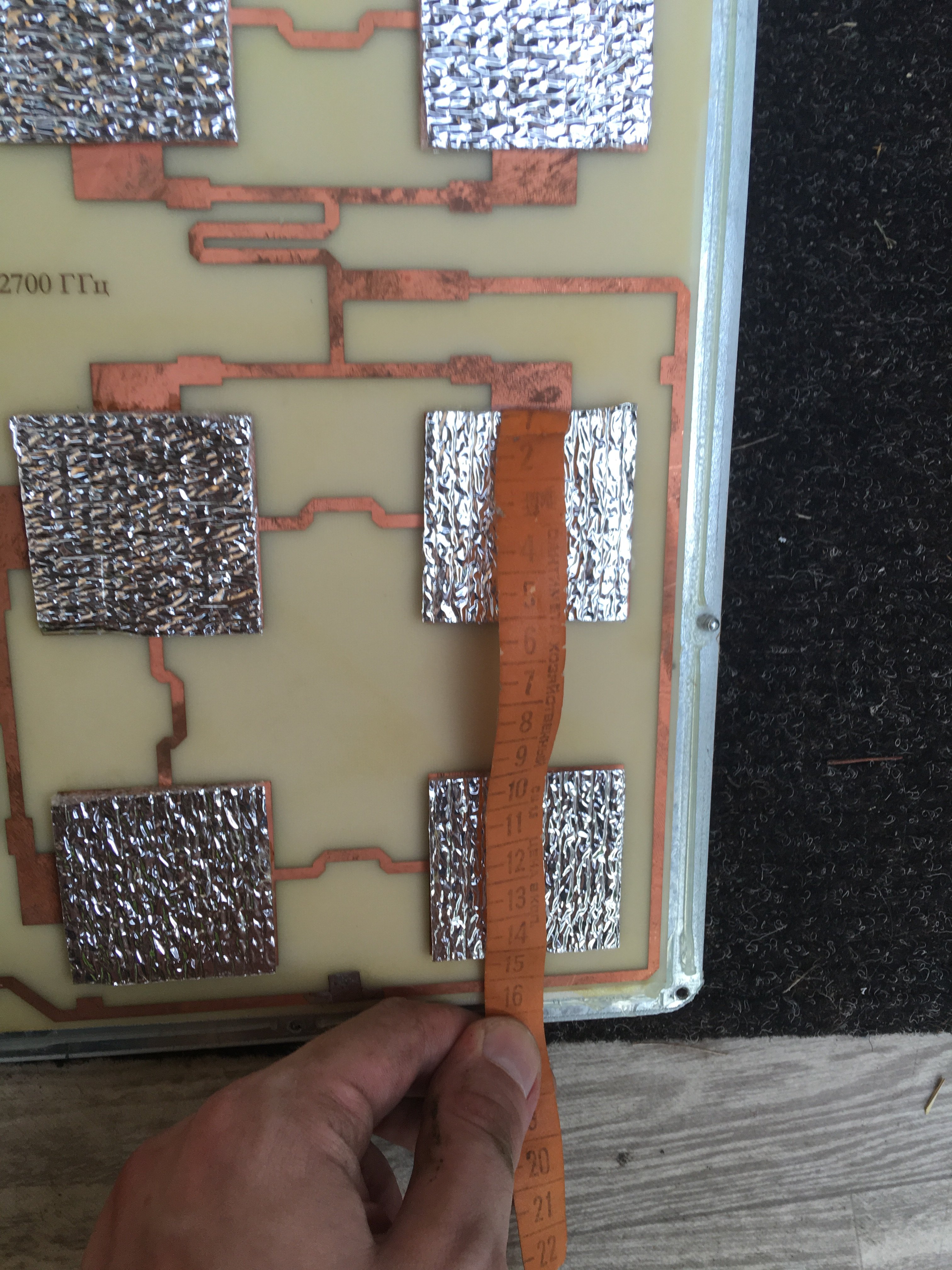

They are squares ;
5 by 5 cm (more or less)
Directors are roof isolation Polyurethane (almost same length)

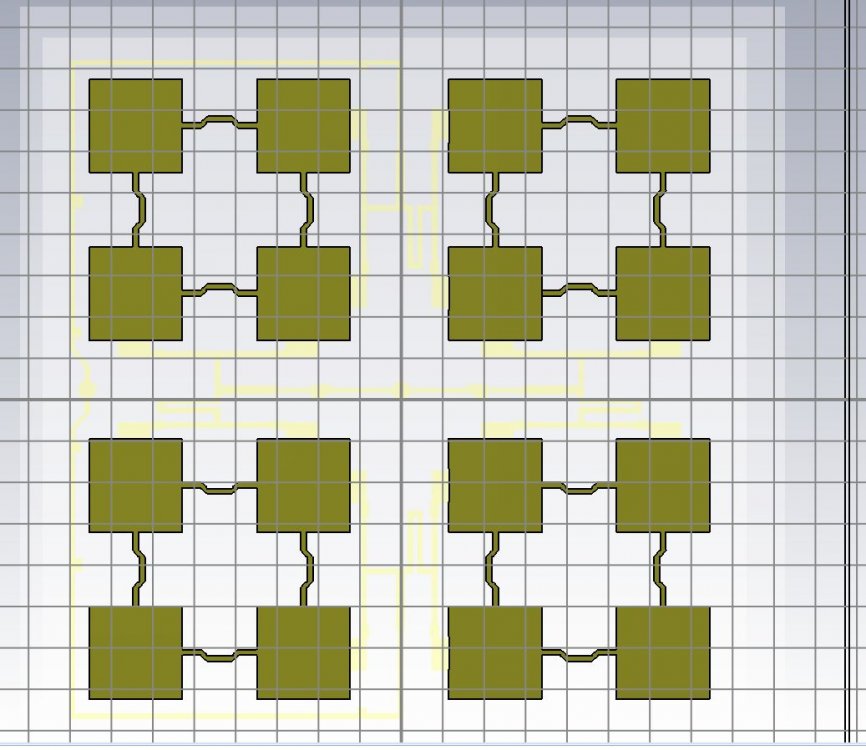

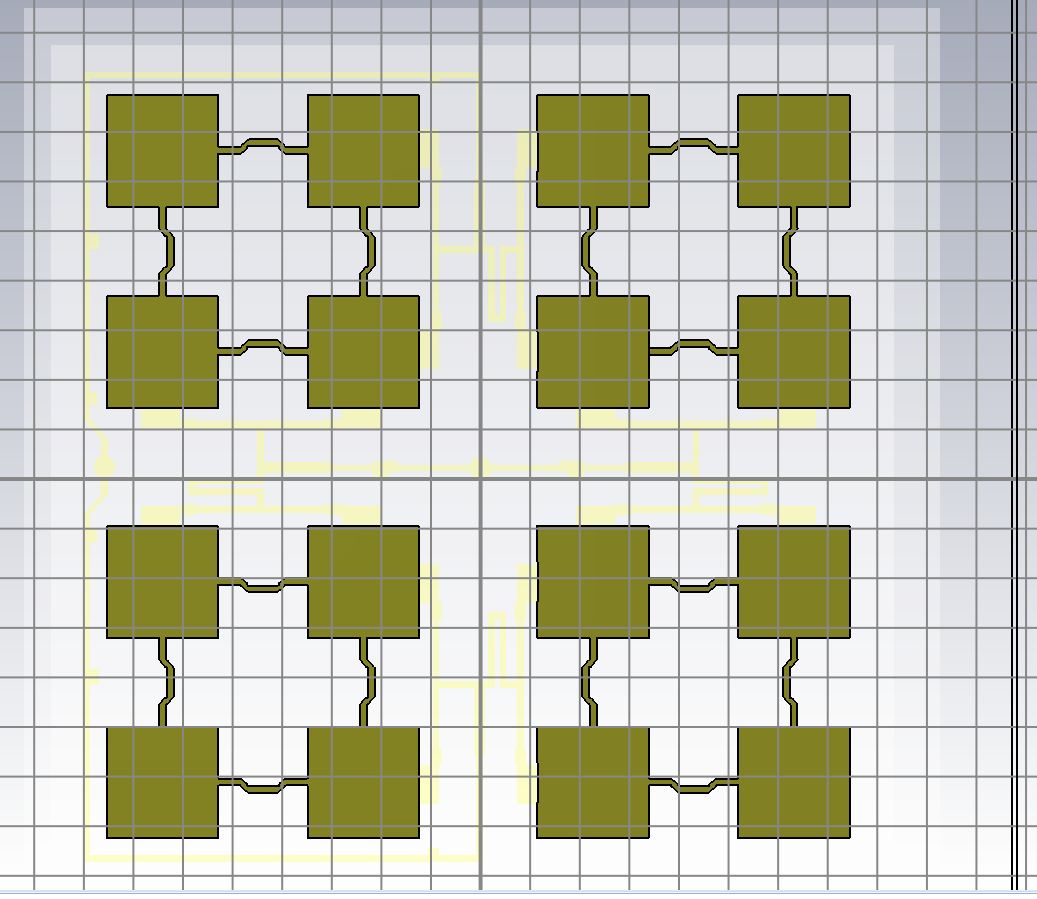

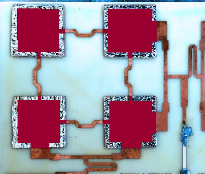

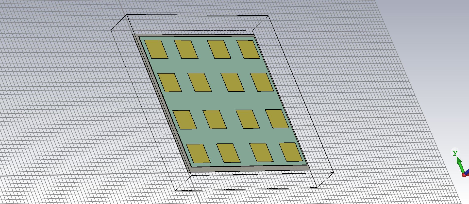

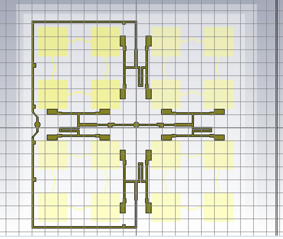

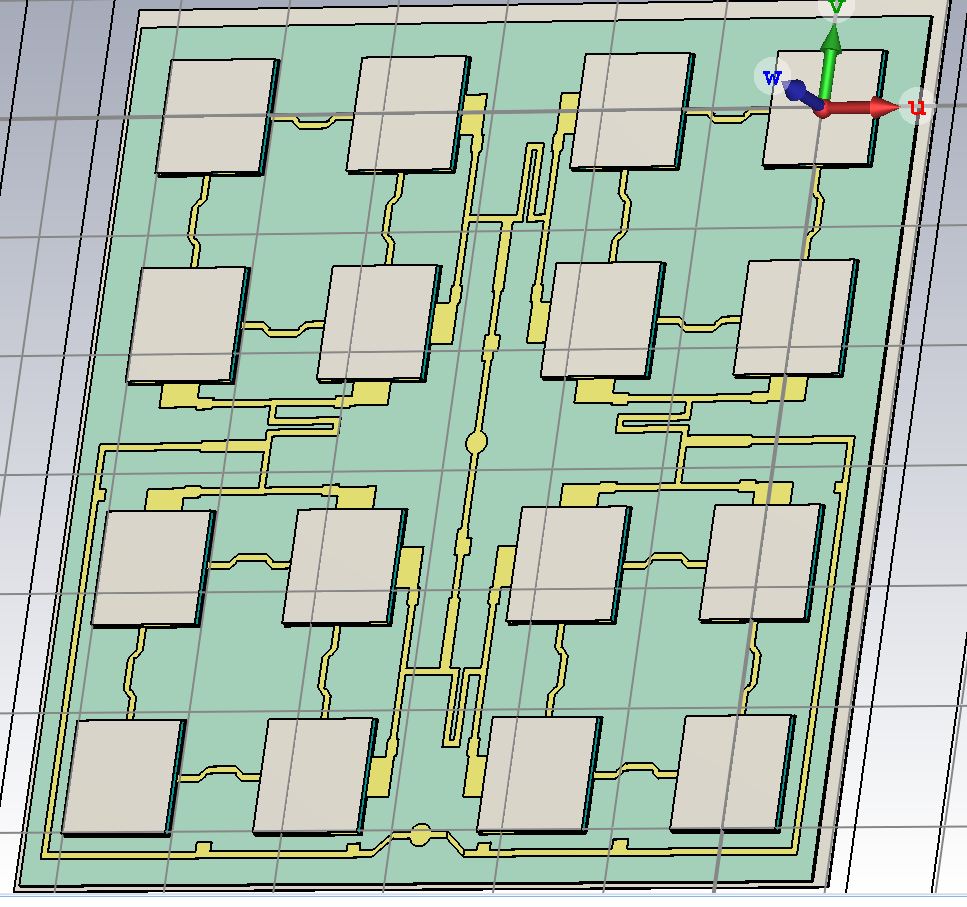

starting to draw right now...
feed lines are complex for MIMO...
we'll see
i'm guessing Patches at 2500 Mhz and directors at 2700 Mhz...
what you think...?

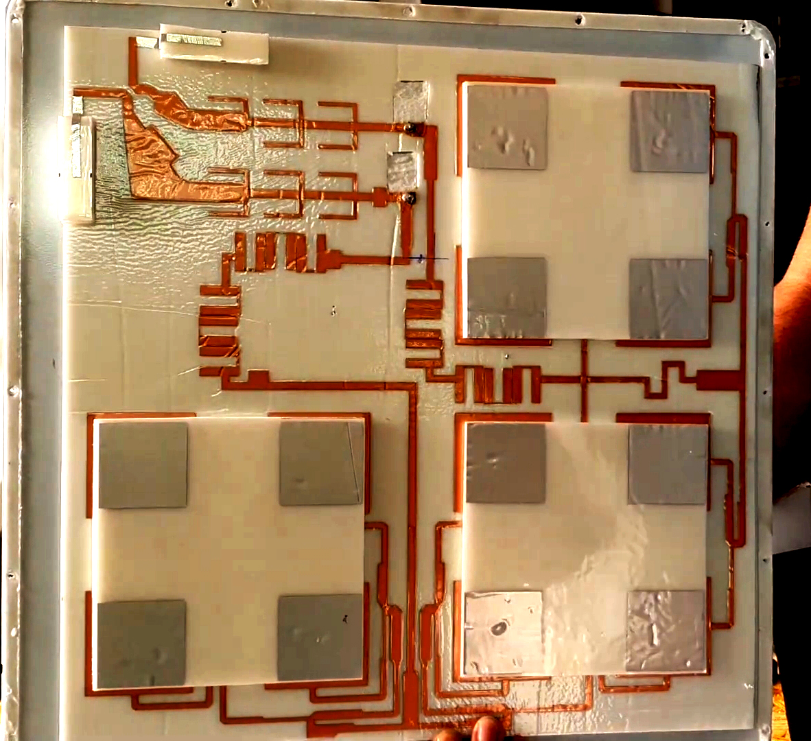

Clanon, don't you think vibrators look like this ... ???
It would be good if this simple version were tested as well....!!!
,,, sorry, but I don't know ... !!!

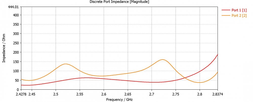

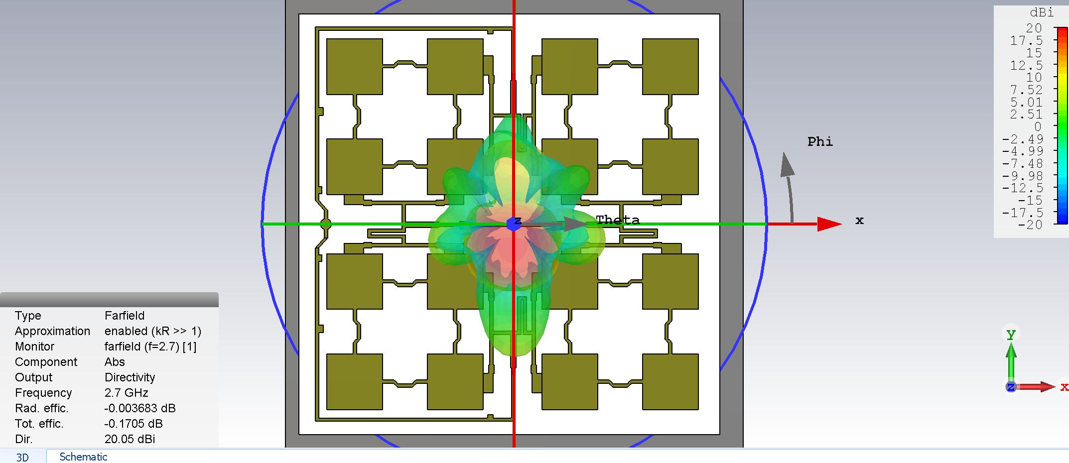

LOTS of STRIPLINE HAIRPIN FILTERS...

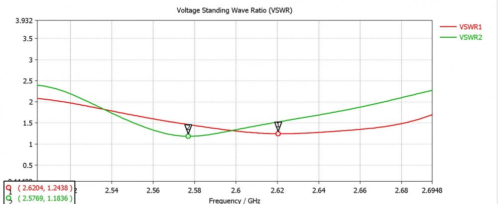

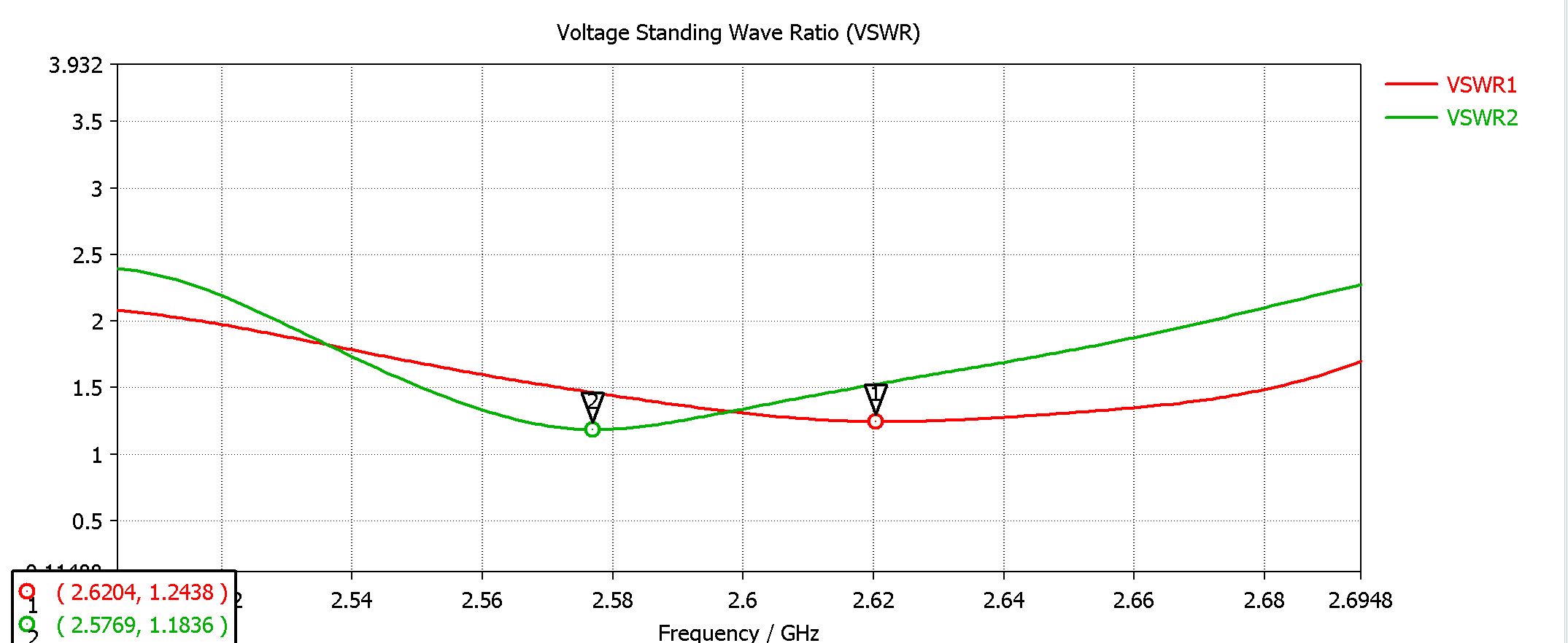

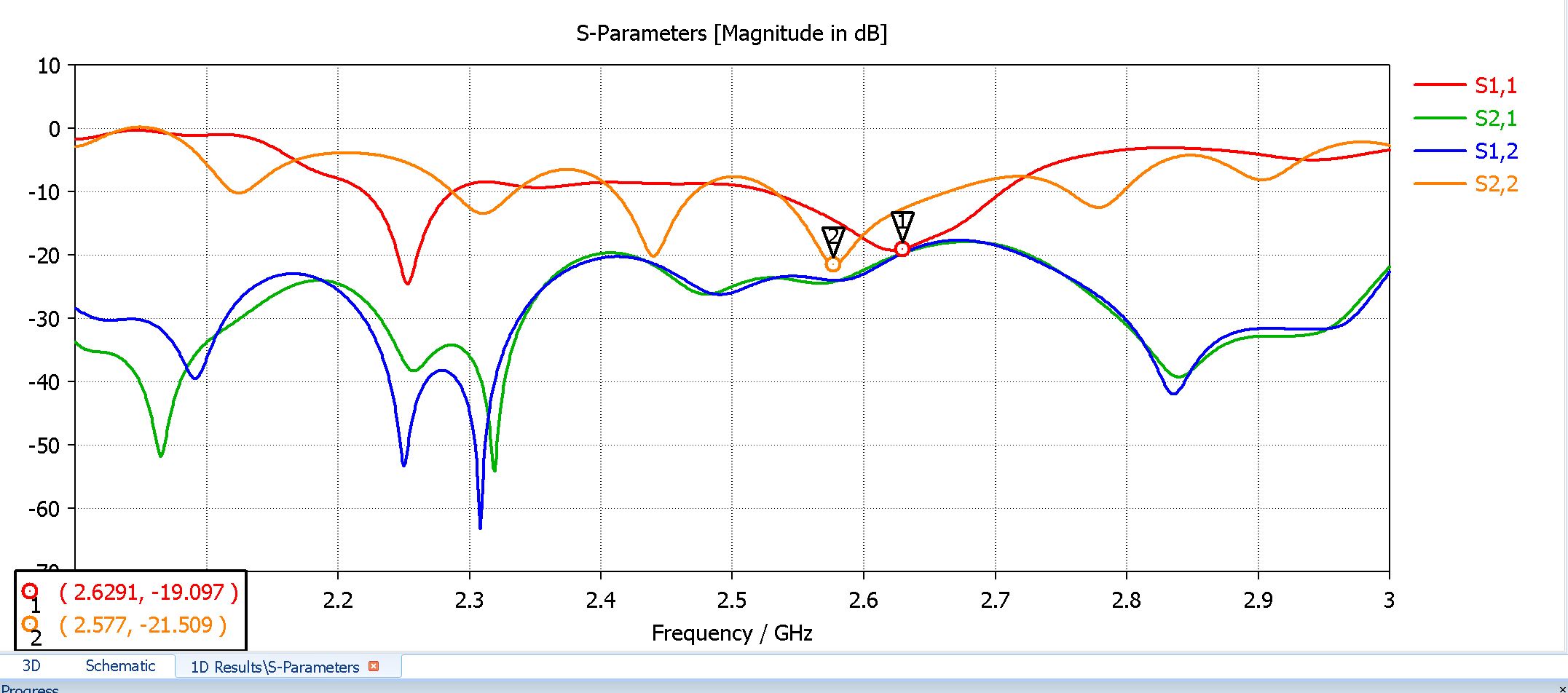

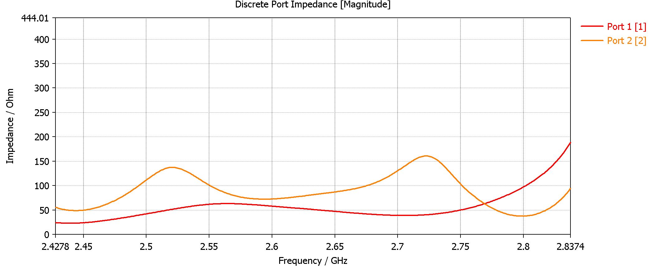

,,, it's good, and the other port ... ???

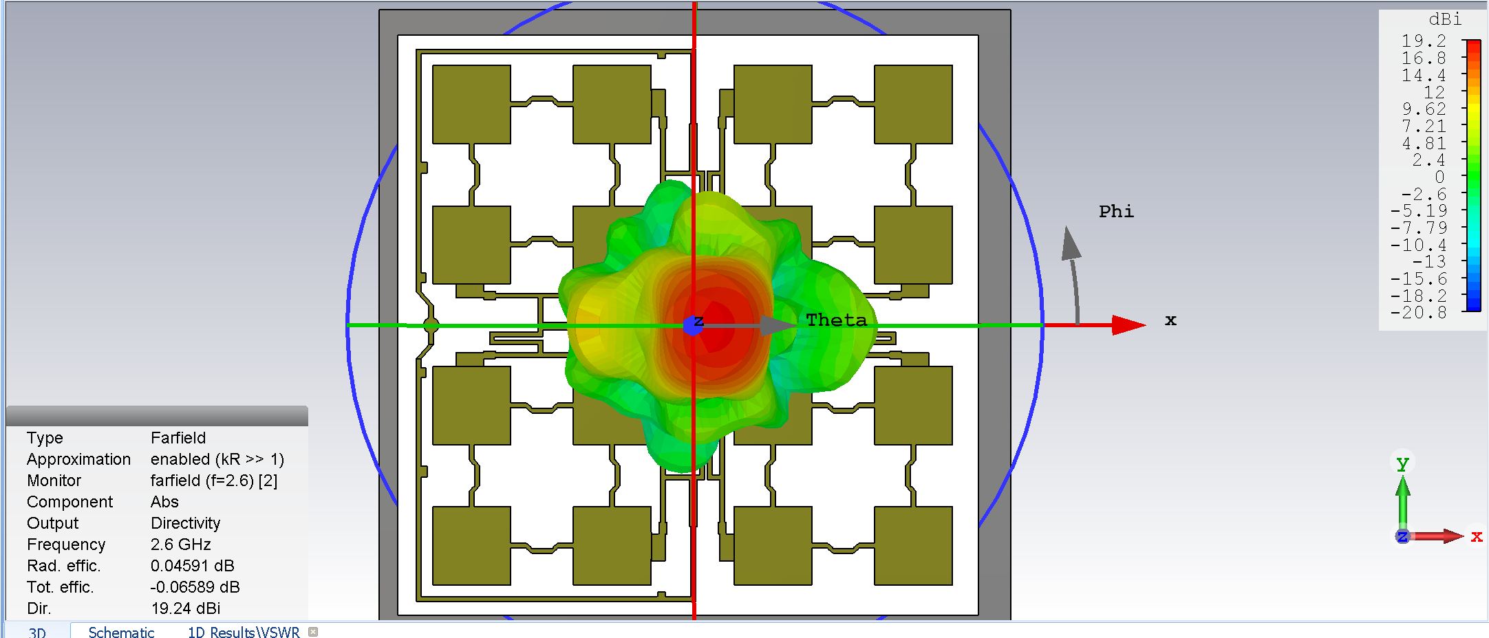

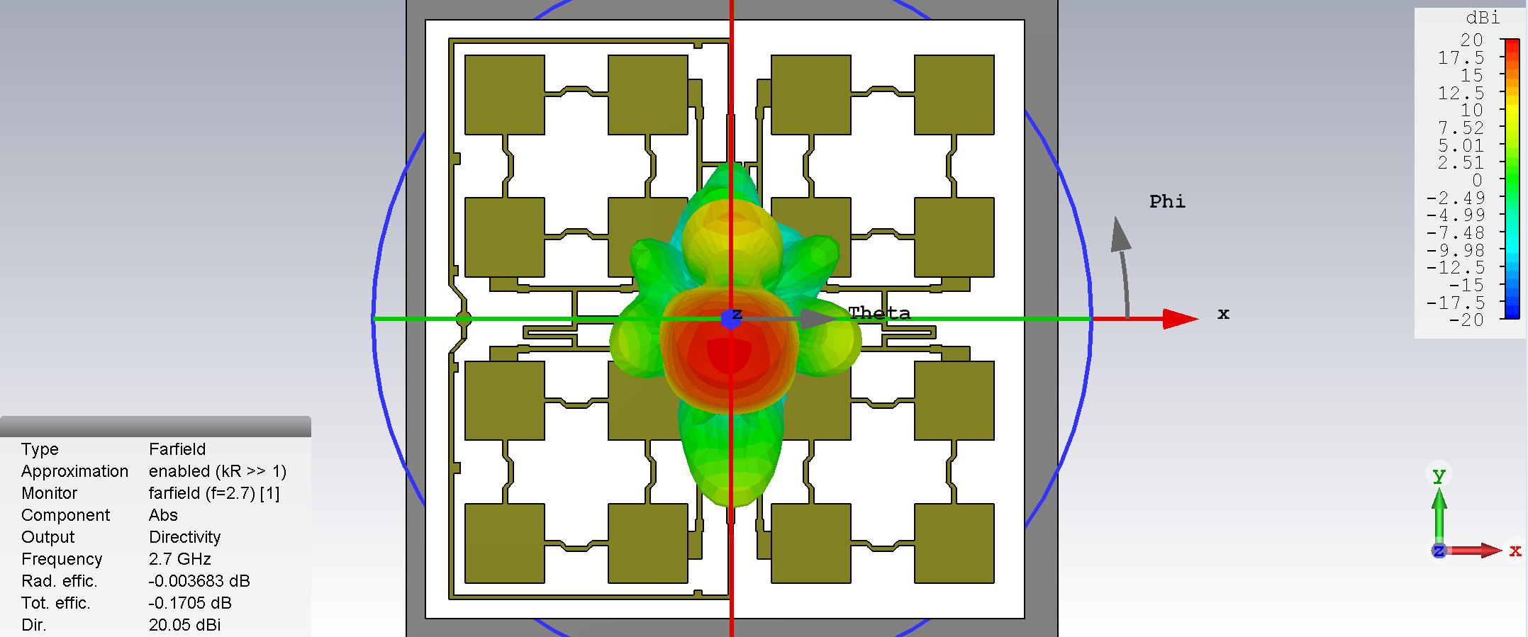

,,, put the simulation ... !!!
Port 2 is not getting to 20...i'm working on it...TOO MANY  stubs and LONG feed lines...
Is the one on the left
