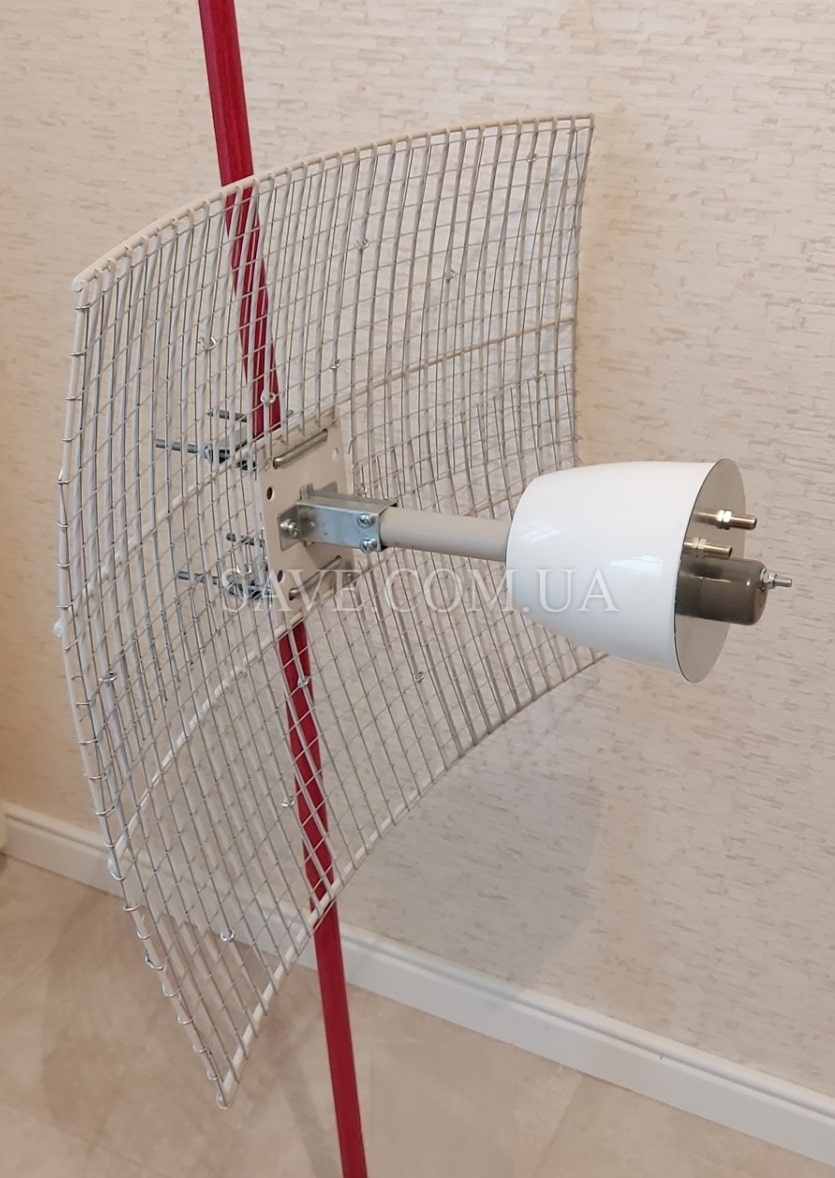

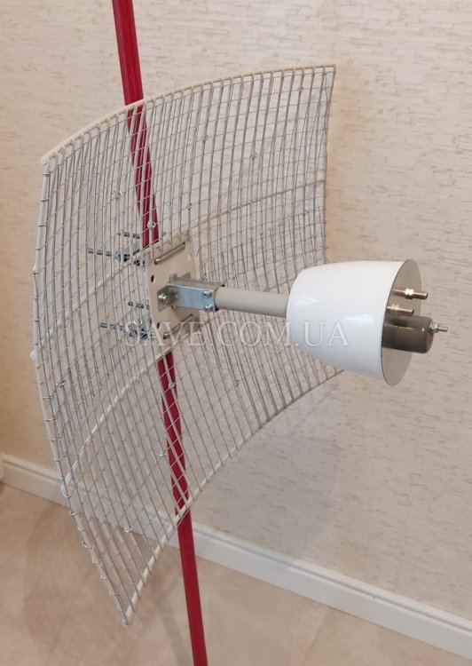

https://yandex.ru/video/preview/?filmId=10434698562256898701&p=1&text=3G+4G+Olkhon+irradiator+antenna&where=all
Type:parabolic (offset) 3G / 4G antenna with mesh reflector
Type of reflector:mesh (steel wire Ø3 mm)
Destination:to enhance the level and stability of 3G / 4G (LTE) signal, as well as increase the speed of mobile Internet
Terms of use:in indirect visibility of the base station
MIMO 2x2 support:+
Operating frequency range:1800-2100 MHz
Supported communication standards:LTE-1800, UMTS-2100
Gain:2х 30 dBi
Electrical circuit:shorted
Input impedance:75 Om
Connection connectors:2х F-female
SWR in the operating frequency range:no more than 1.5
Power capability:10 W
Suppression of parasitic polarization:-25 dB
Polarization:type X (horizontal and vertical)
Lightning protection:integrated
Supported communication operators:Vodafone, Kyivstar and Lifecell
Maximum distance from the base station:up to 25 km
The stated level of mobile Internet speed enhancement:up to 250% of the initial value
Mounting the antenna:on the bracket or pipe
Change the polarization of the:360°
Wind load:5 kg / m2
Operating temperature range:from -60°C to +40°C
Degree of protection from moisture and dust:IP68
Overall dimensions:
- reflector:50x60 cm (netted)
- irradiator:250x125x125 mm
- weight in the Assembly:1.6 kg

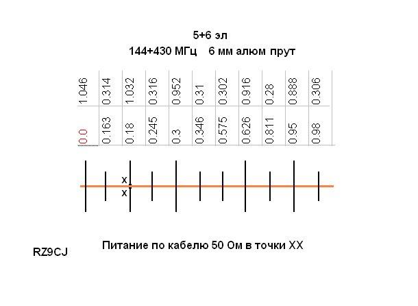

 790÷960 MHz  ang  1710÷2170 MHz... this is completely different .... !!!

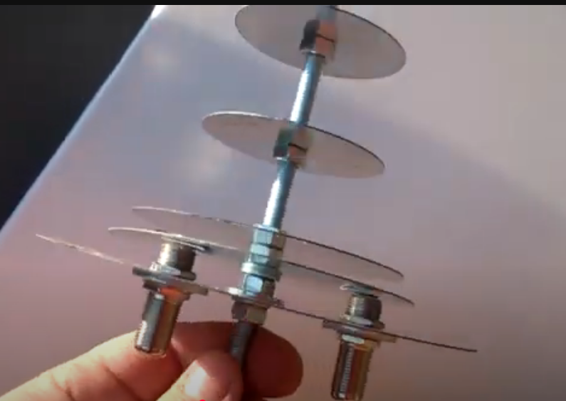

,,,show me, what it's like inside...????
,,, something similar ... double frequency band f1 = 3 * f2...
,,, but all of this, has nothing to do with the  Olkhon patch antenna, so we talk in vain...!!!

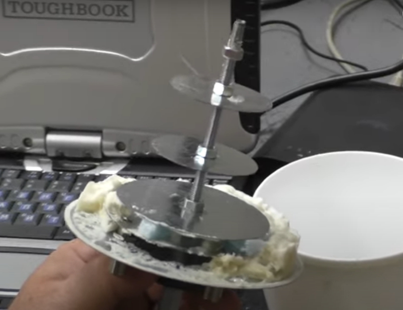

,,, this is what an Olkhon antenna looks like inside...
,,, this antenna does not work well and is not the original...!!!
