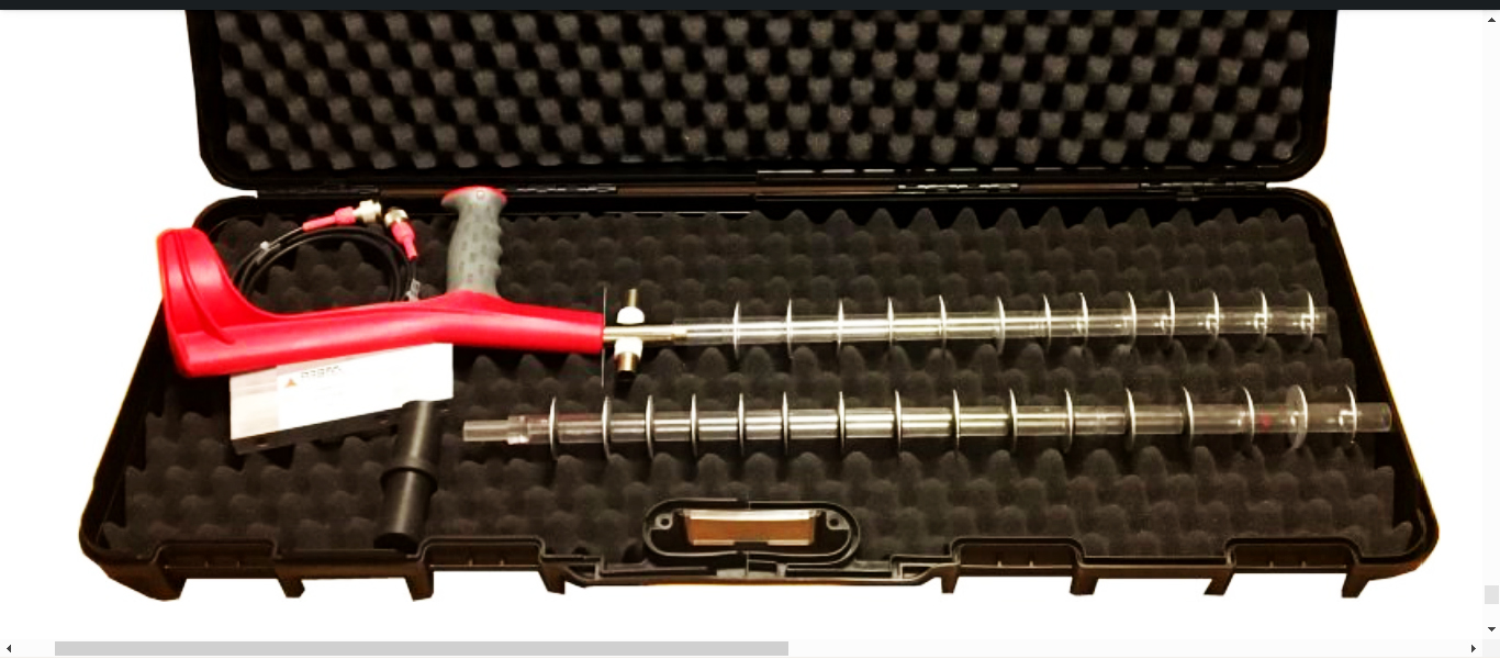

On 10/26/2020 at 8:55 AM, Admin said:

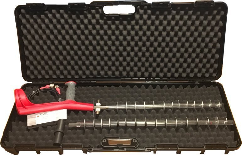

,,, this is what an Olkhon antenna looks like inside...
Is there a scheme or measurements for it?
,,,here on this forum , is such a thing ,,,, search and you will find .... !!!

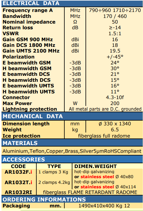

On 10/18/2020 at 9:32 PM, Admin said:
 790÷960 MHz  ang  1710÷2170 MHz... this is completely different .... !!!

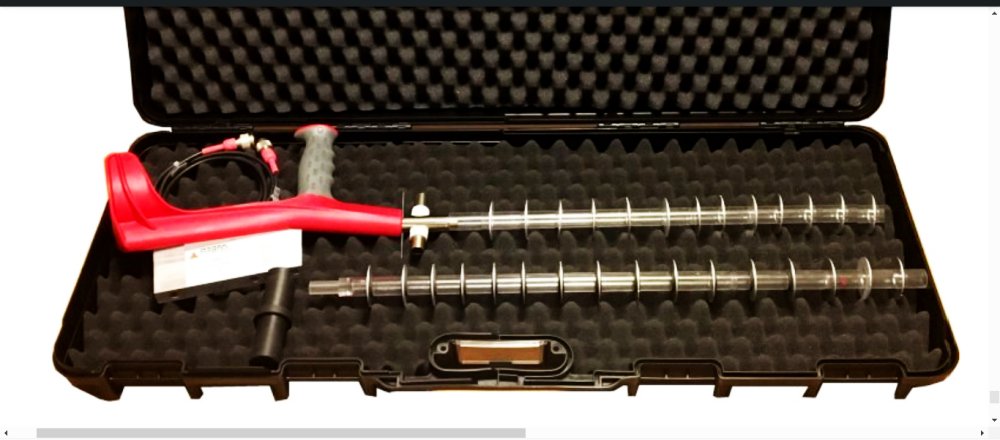

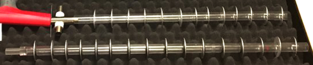

,,,okay, and inside it has disc elements...???
probably for high band...(only directors)
lower band MUST BE Tubes both crossed and combined on one output  is 33 cm by 1,34 meters
,,,clanon,can you give more information about this antenna....????
IT SEEMS TO BE AN ANTENNA FOR DRONE DETECTION

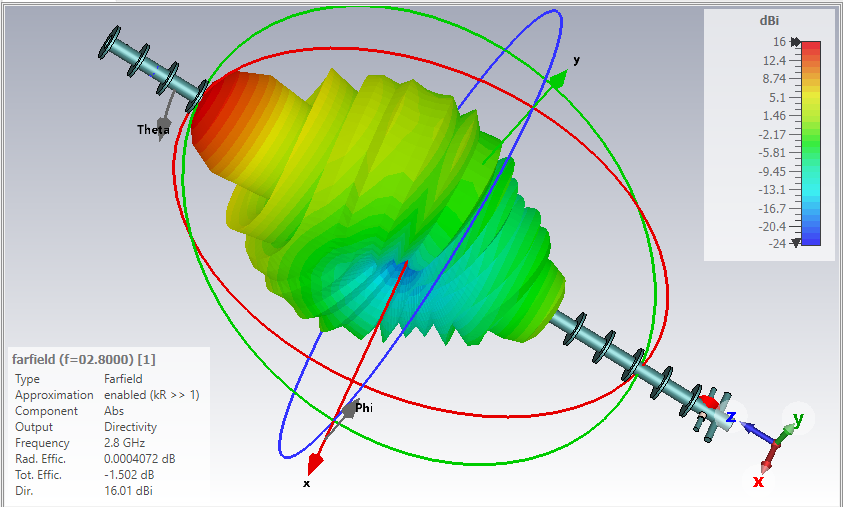

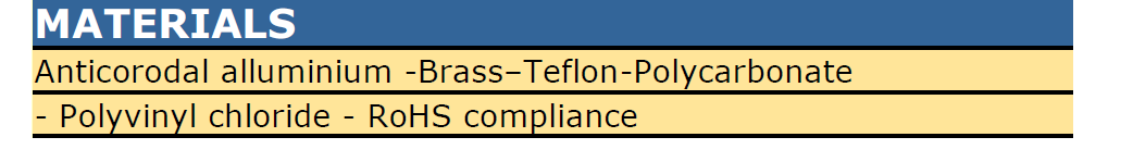

Posted (edited)

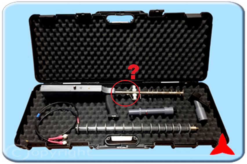

i'll say all Dielectric Boom tube...Polycarbonate (ABS) for sure...
