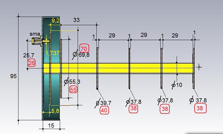

2.31ghz......

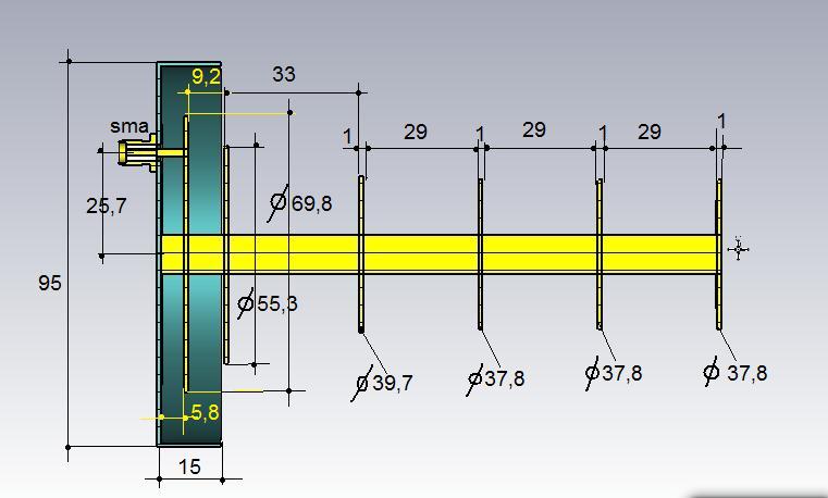

What is that number represents after coma ,
For eg- in the first disc from right its  "37,8"
Here 37 is diamerer of the circle . What does 8 represent ??

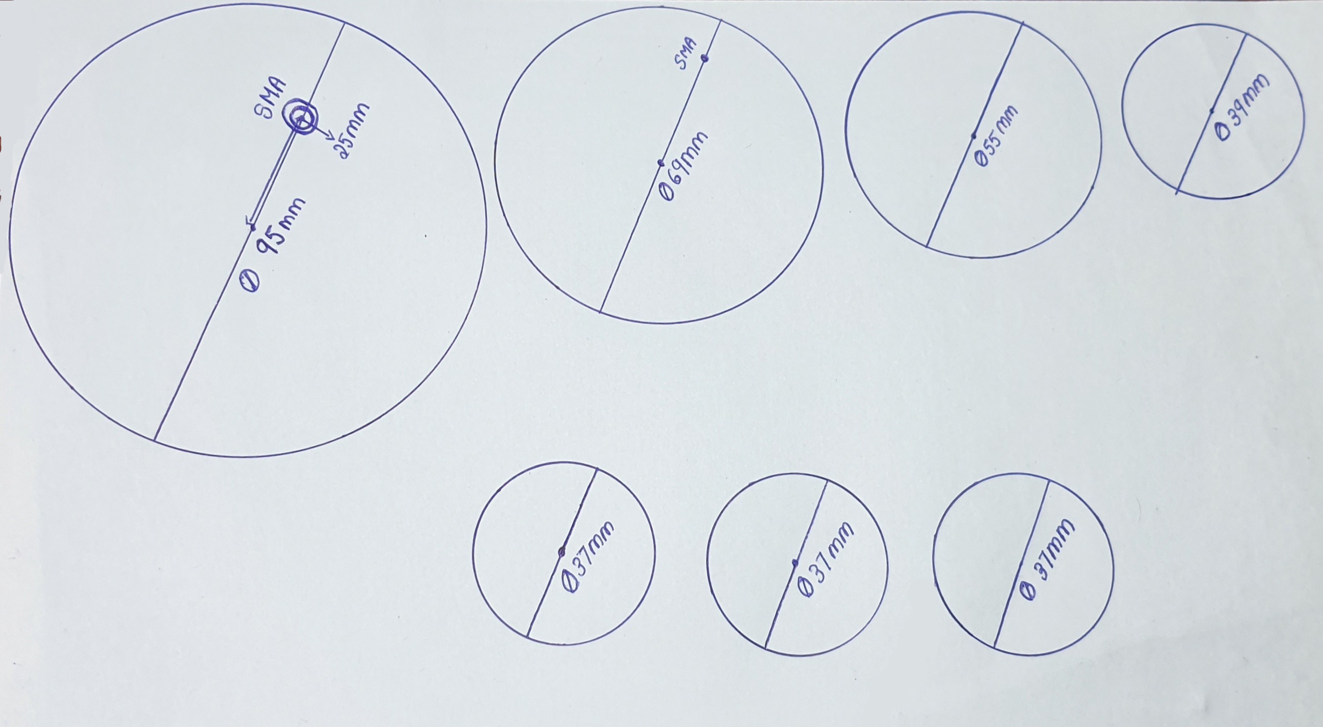

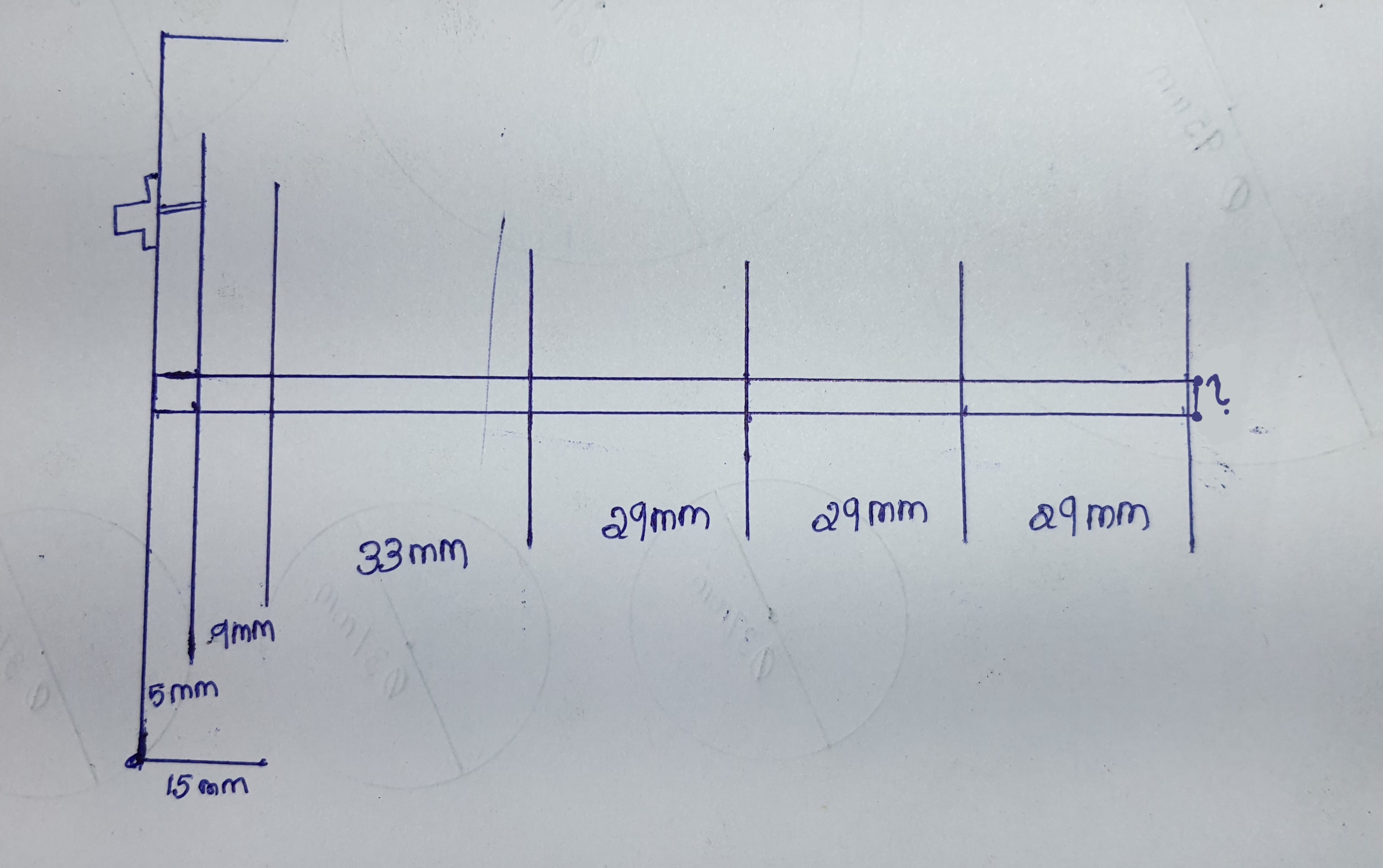

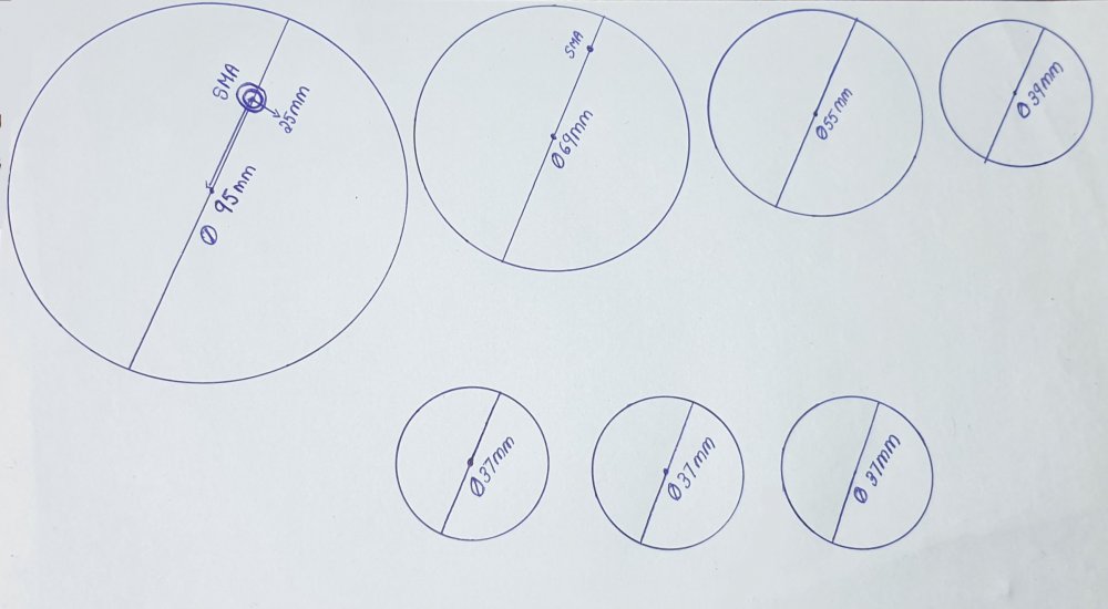

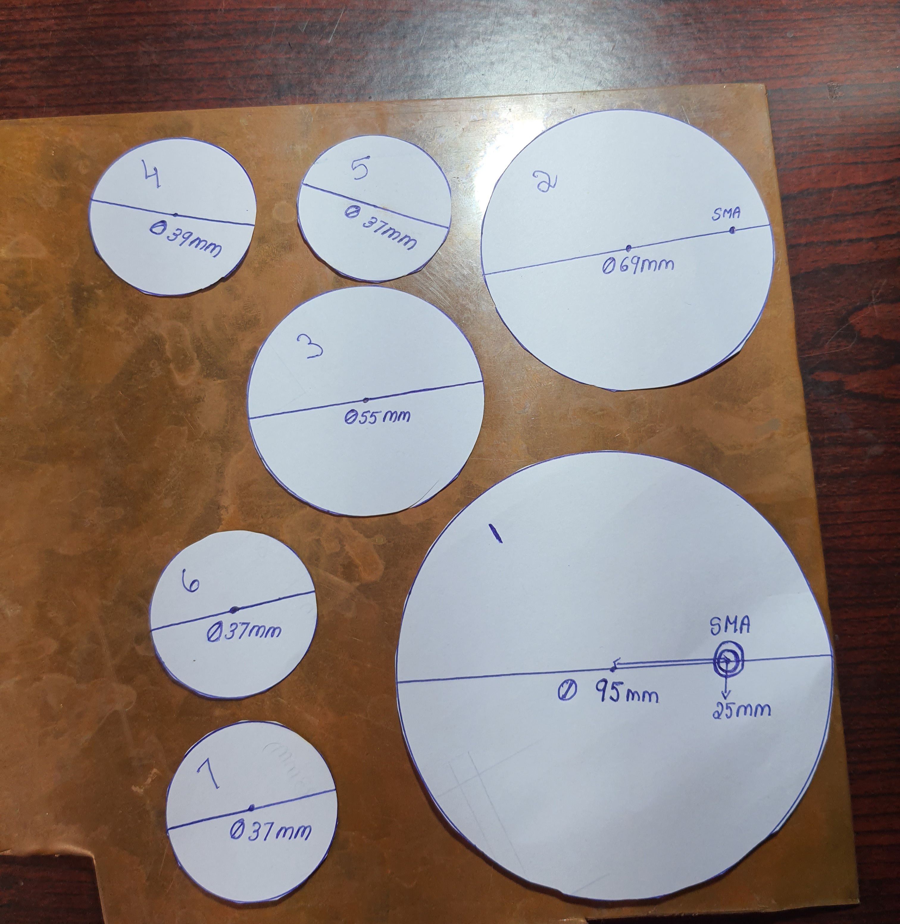

This is the rough plan i made before starting ....
20201214_143811.jpg20201214_145127.jpg,,,This is the rough plan before starting.......
Is this correct Admin ?
Can i know the thickness for the rod ?

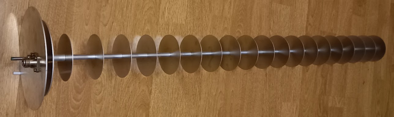

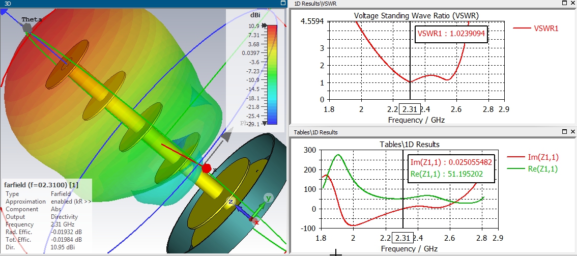

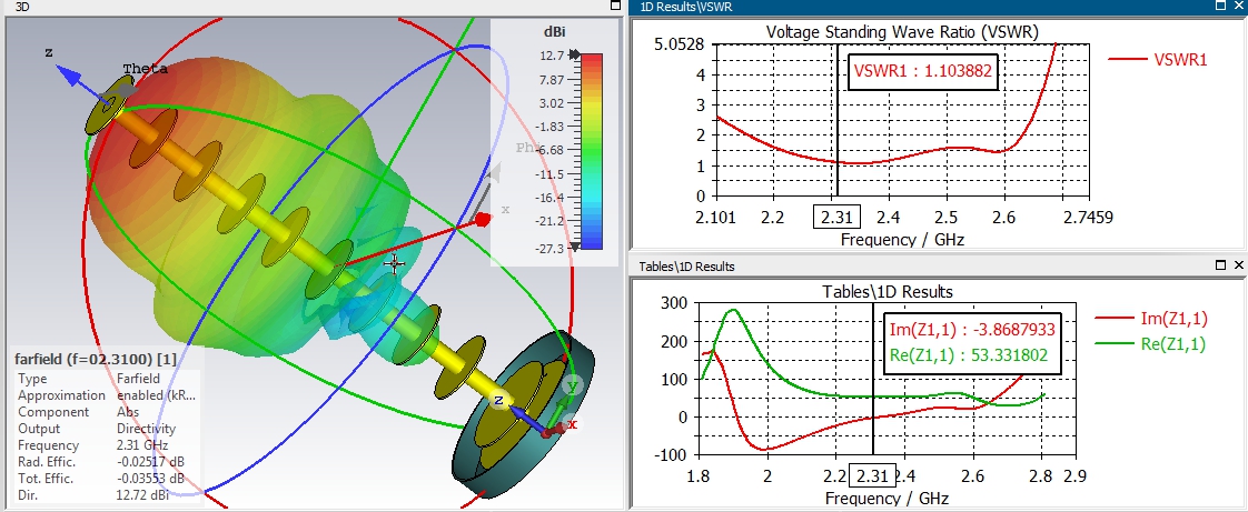

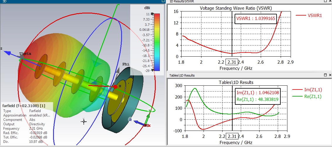

,,,,at Vasuki's request, I optimized this antenna for the 2.31 GHz frequency...
,,, a final version where I adjusted the dimensions...
Comma is used for decimal point in some countries (including mine).
"37,8" = "37.8"
"37,8" = "37.8"
Thank you so much

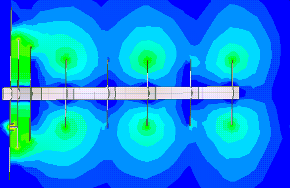

,,, with 12 elements, covers the frequency band 2.3-2.6GHz...!!!

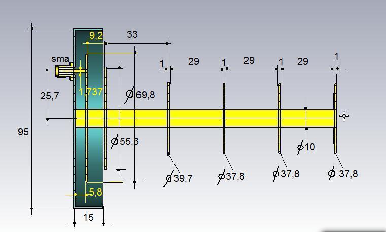

,,, the dimensions are those in the sketch above with the mention that the number of directors multiplies...!!!

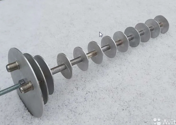

WHICH IS BEST,,,,,,WHICH WILL GIVE ME MORE SPEED , MORE SIGNAL STREANGHT (2310MHZ) ?
1ST OR 2ND ONE ?
1ST OR 2ND ONE ?
,,, normal, as an antenna with 12 elements...!!!
Yes, I think this would be a solution...!!!

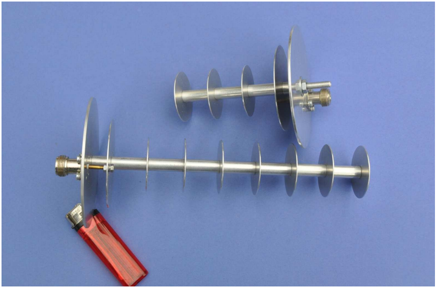

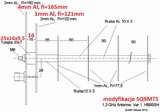

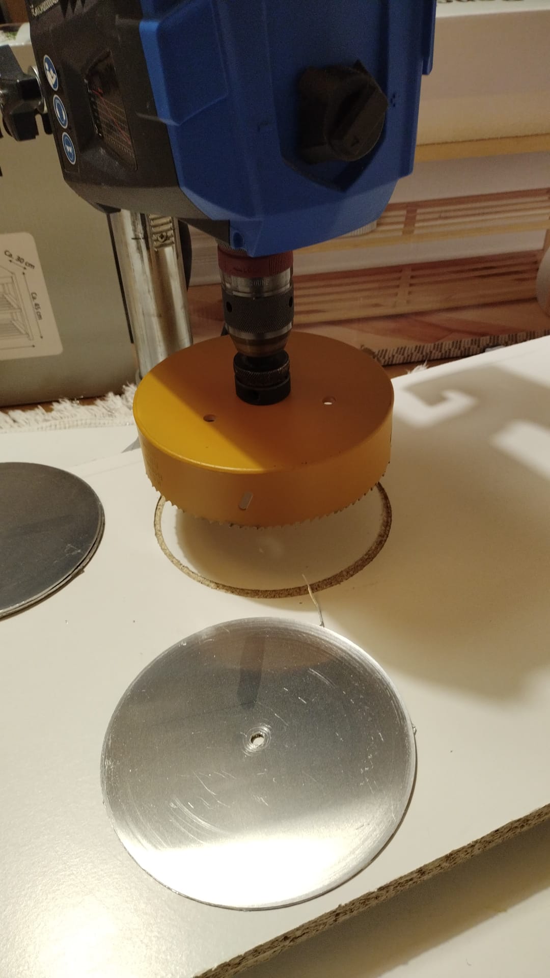

I will try 1296Mhz and 432.2MHz

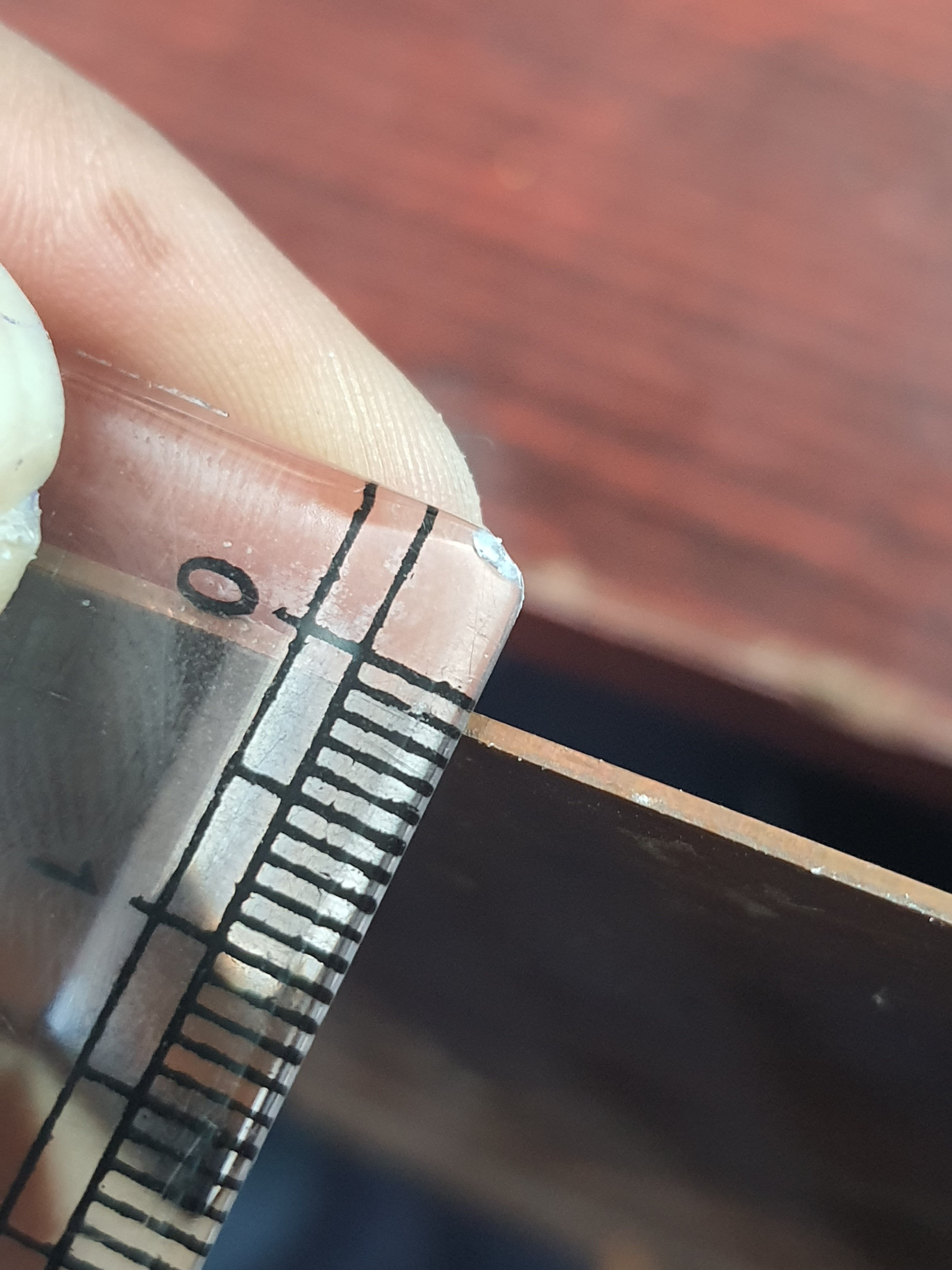

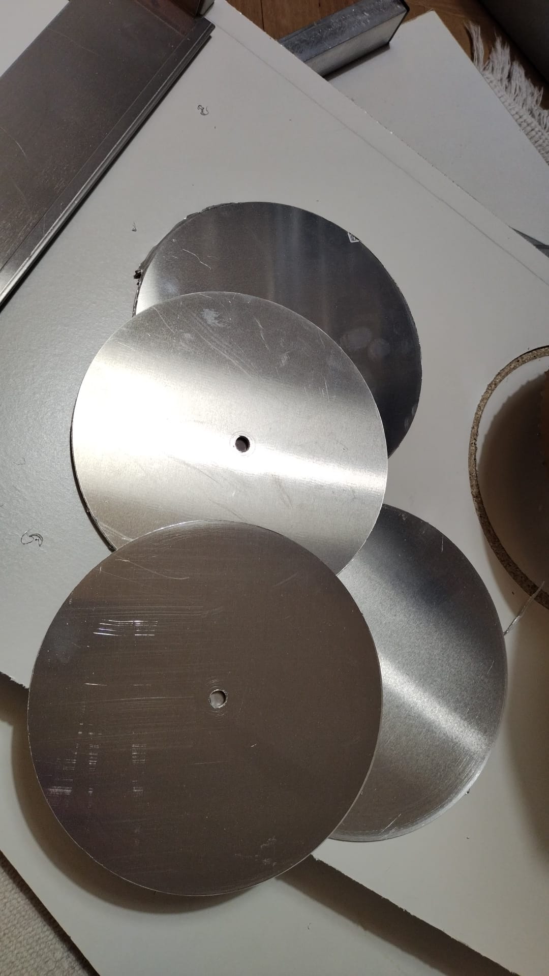

Not eassy, but possible  165mm saw, => 160mm circle.

1296MHz disc Yagi-Uda is here
