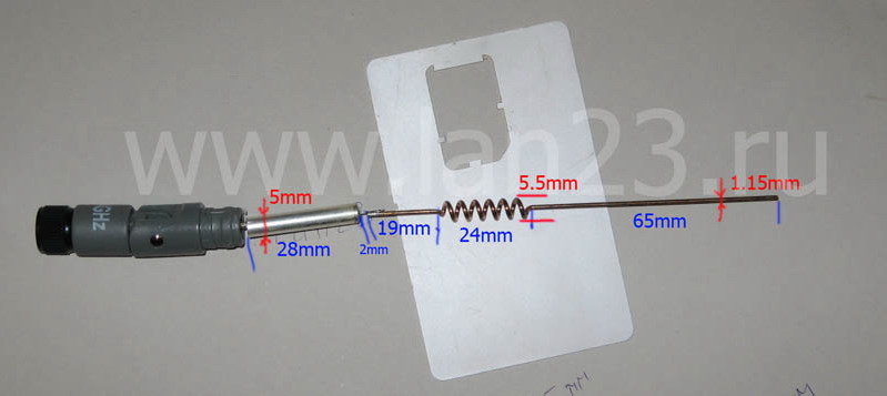

DWL3200 antenna (5dBi Omni-directional).
The design is an elementary collinear antenna and does not require additional explanations. The dimensions are shown in the photos,..

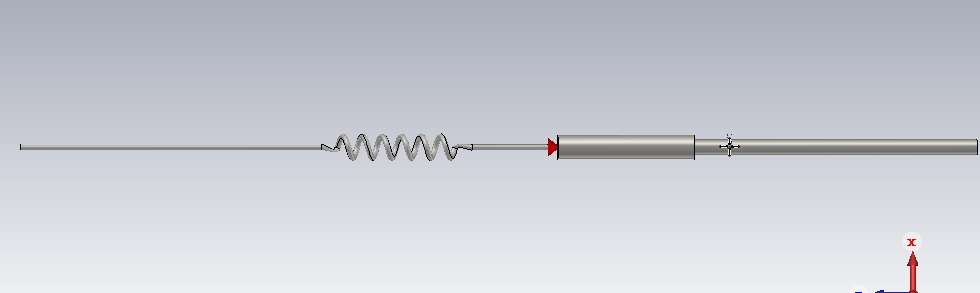

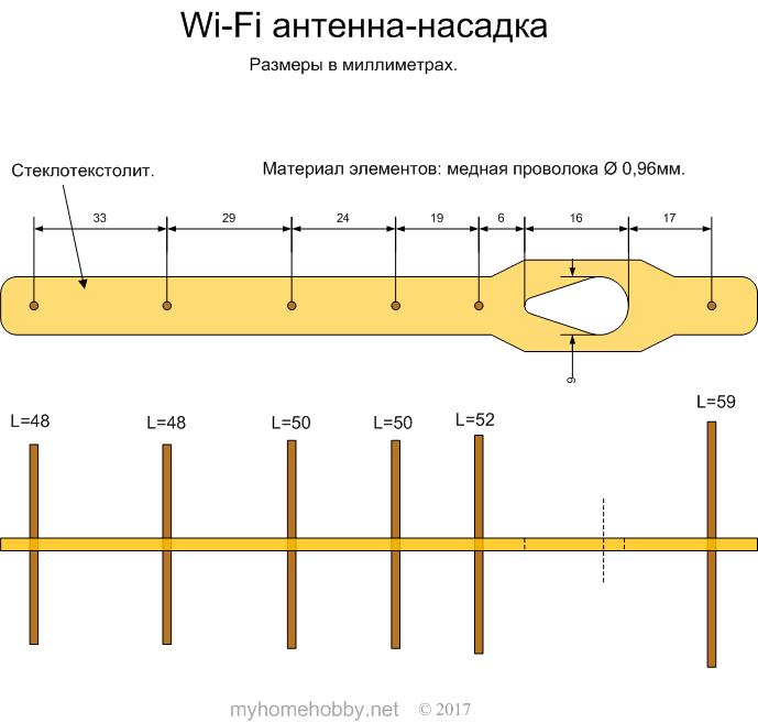

,,, and I think in the future I will do a simulation with this added yagi antenna...
