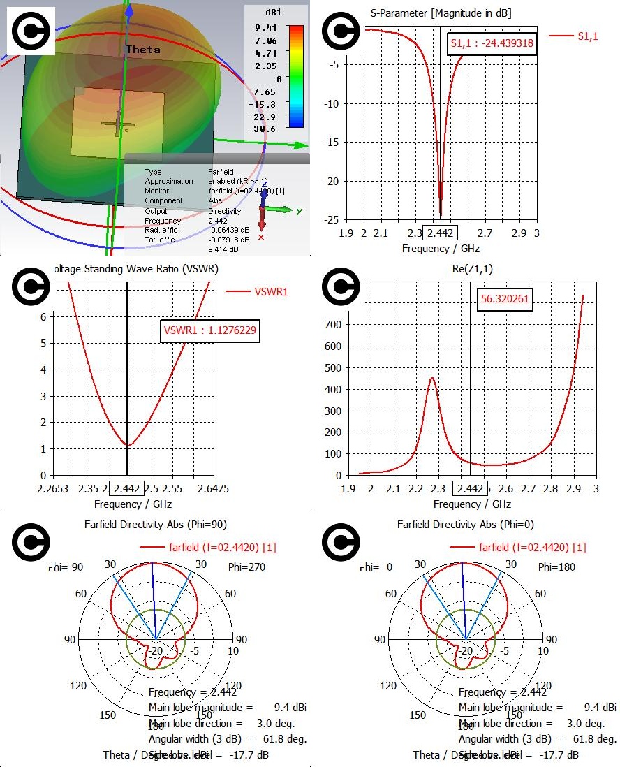

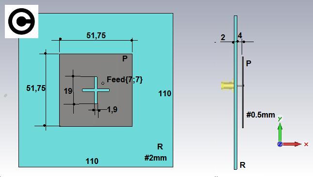

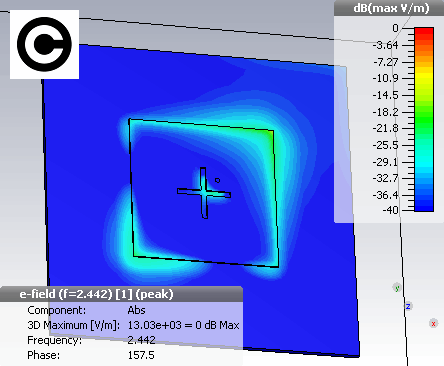

LCP Patch Antenna
The patch may be in a variety of shapes, but rectangular and circular are the most common because ease of analysis and fabrication, attractive radiation characteristics, especially low cross polarization(LCP). These antennas, in general resonant efficiently at a single resonance frequency corresponding to their dominant mode and typically narrow bandwidth (1-2%) and low gain .
