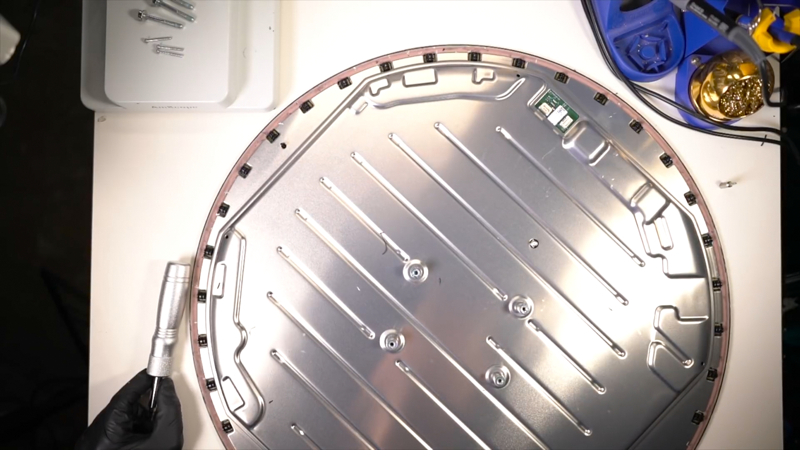

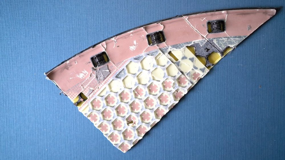

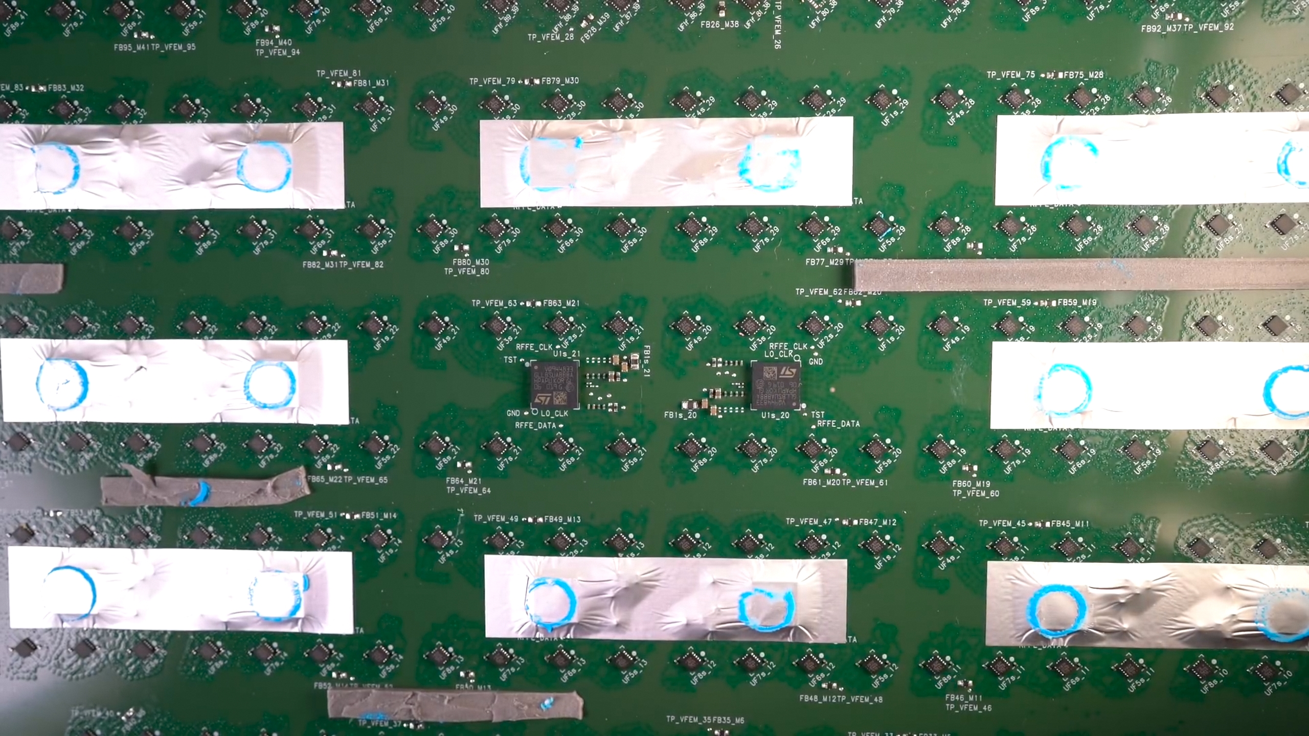

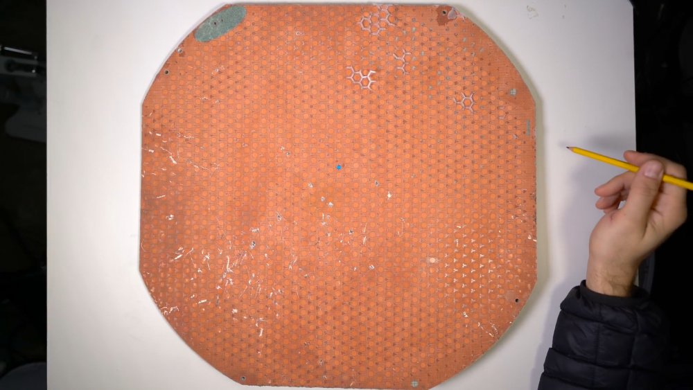

Starlink Dishy

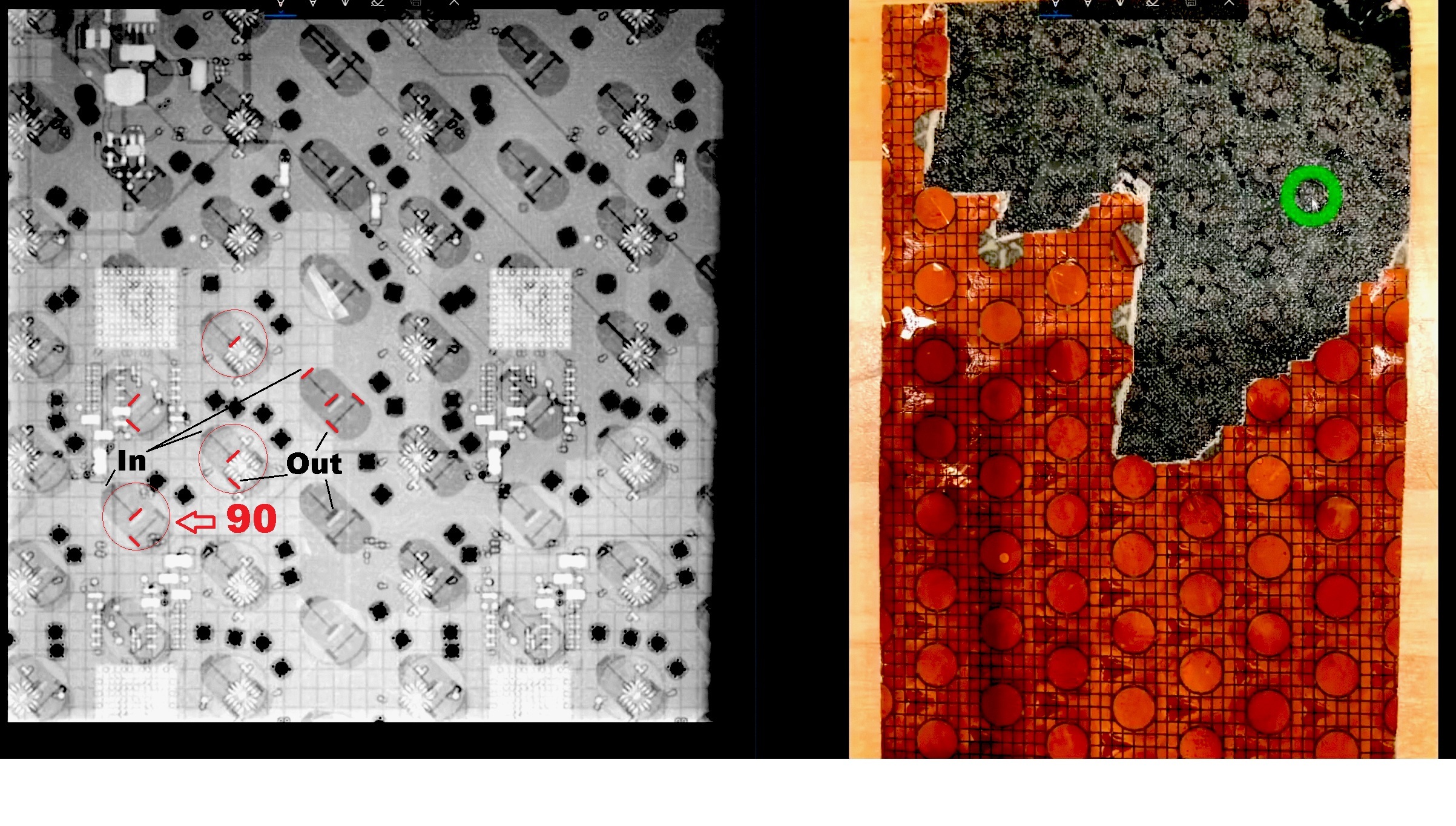

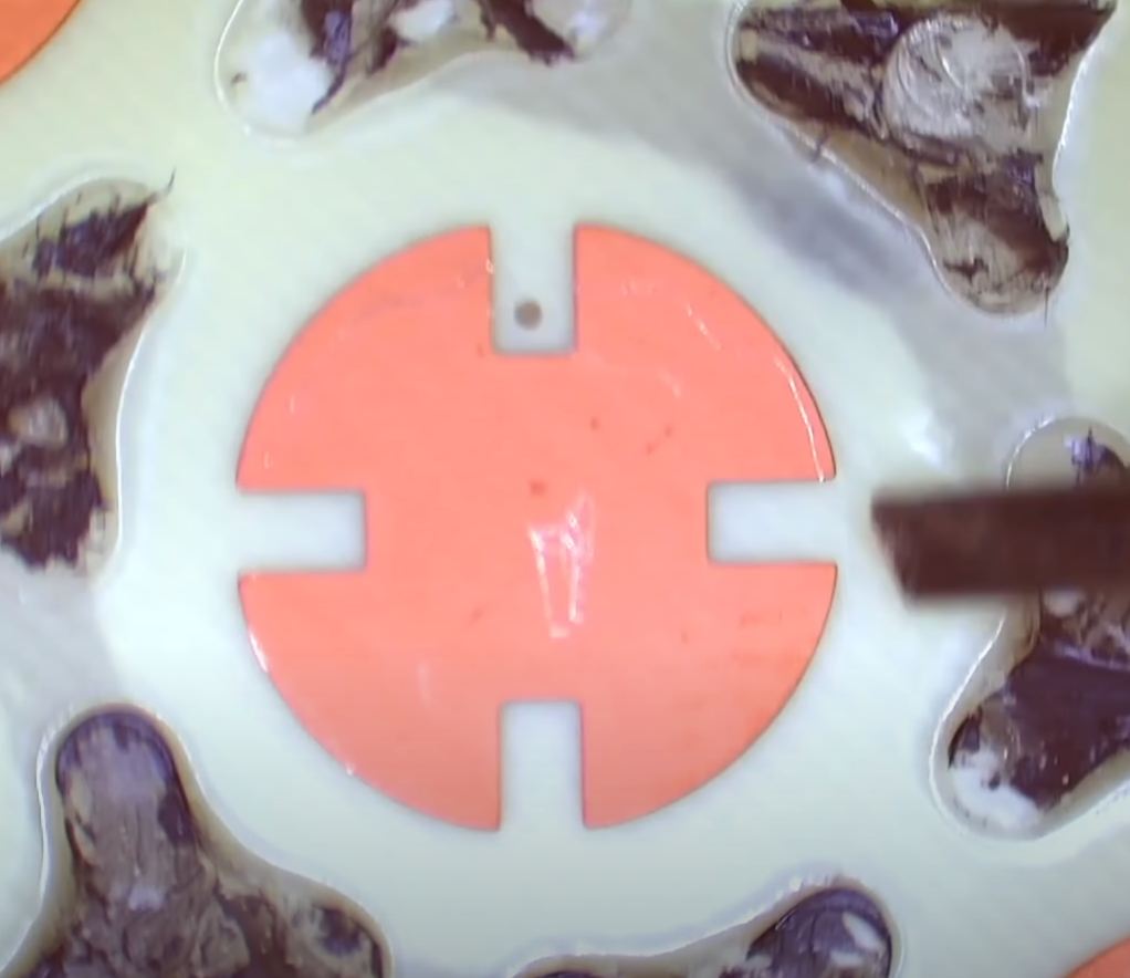

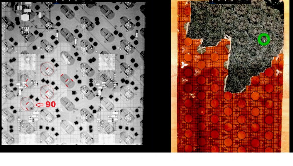

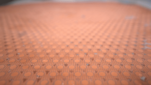

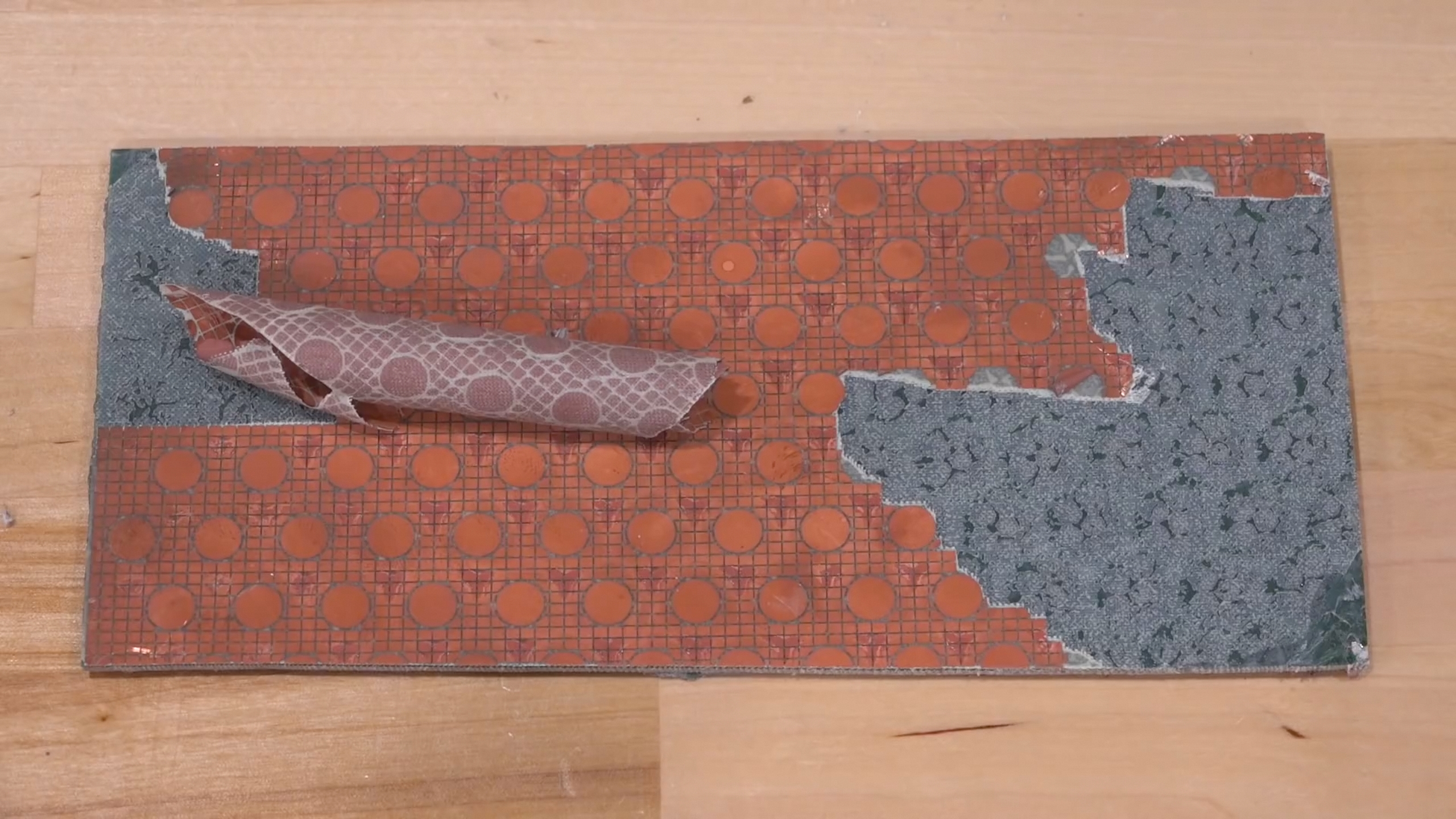

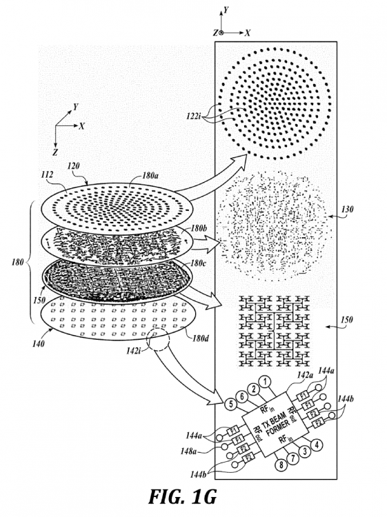

each CIRCULAR PATCH (director too) FLOAT on dielectric NO CONTACT...
Energy is fed trough slots at 90 degrees from each IC Driver
one for each circular patch
Circular polarization , slot feed , direct IC drive...ACTIVE PHASED ARRAY (for satellite pointing)

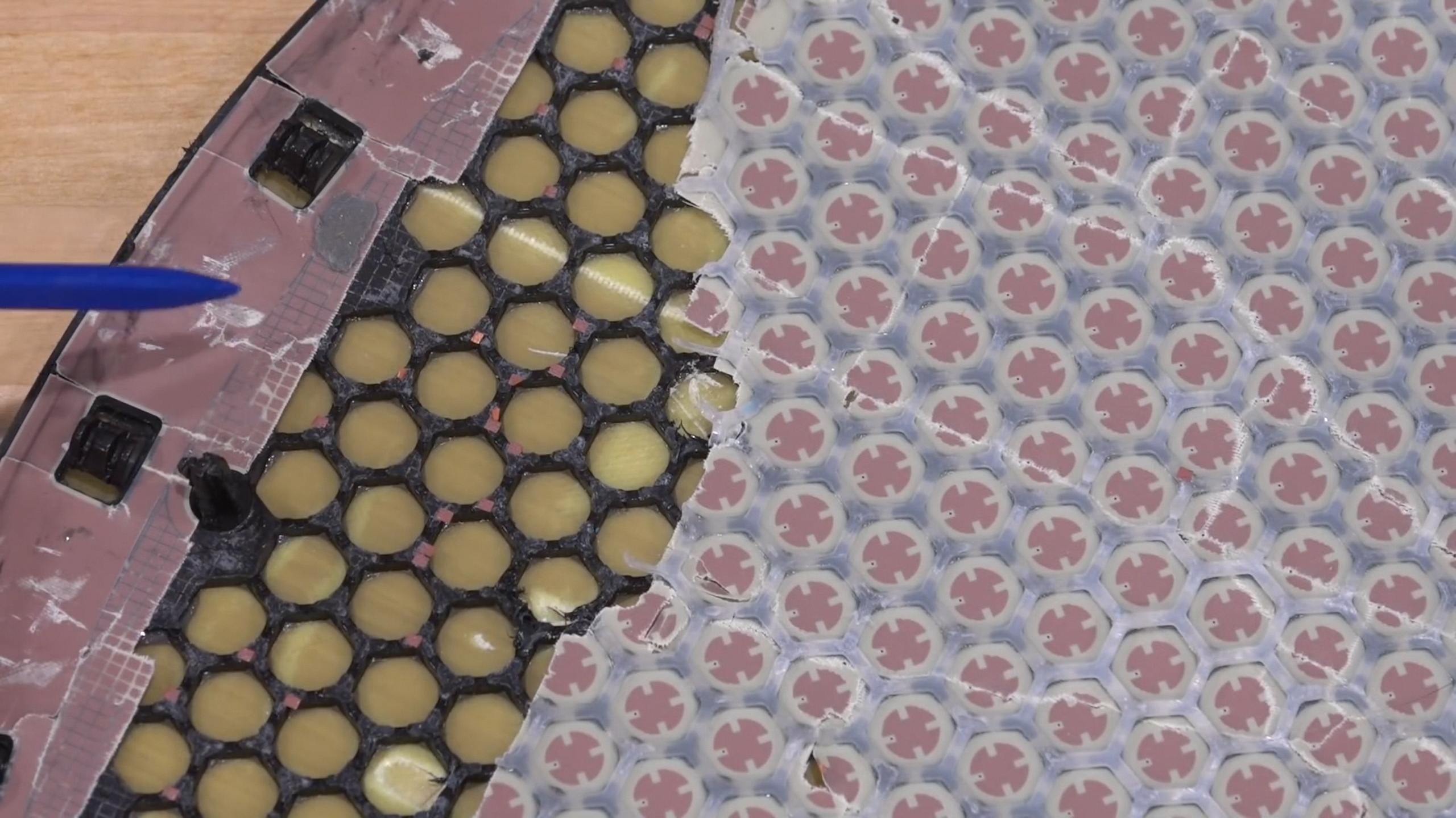

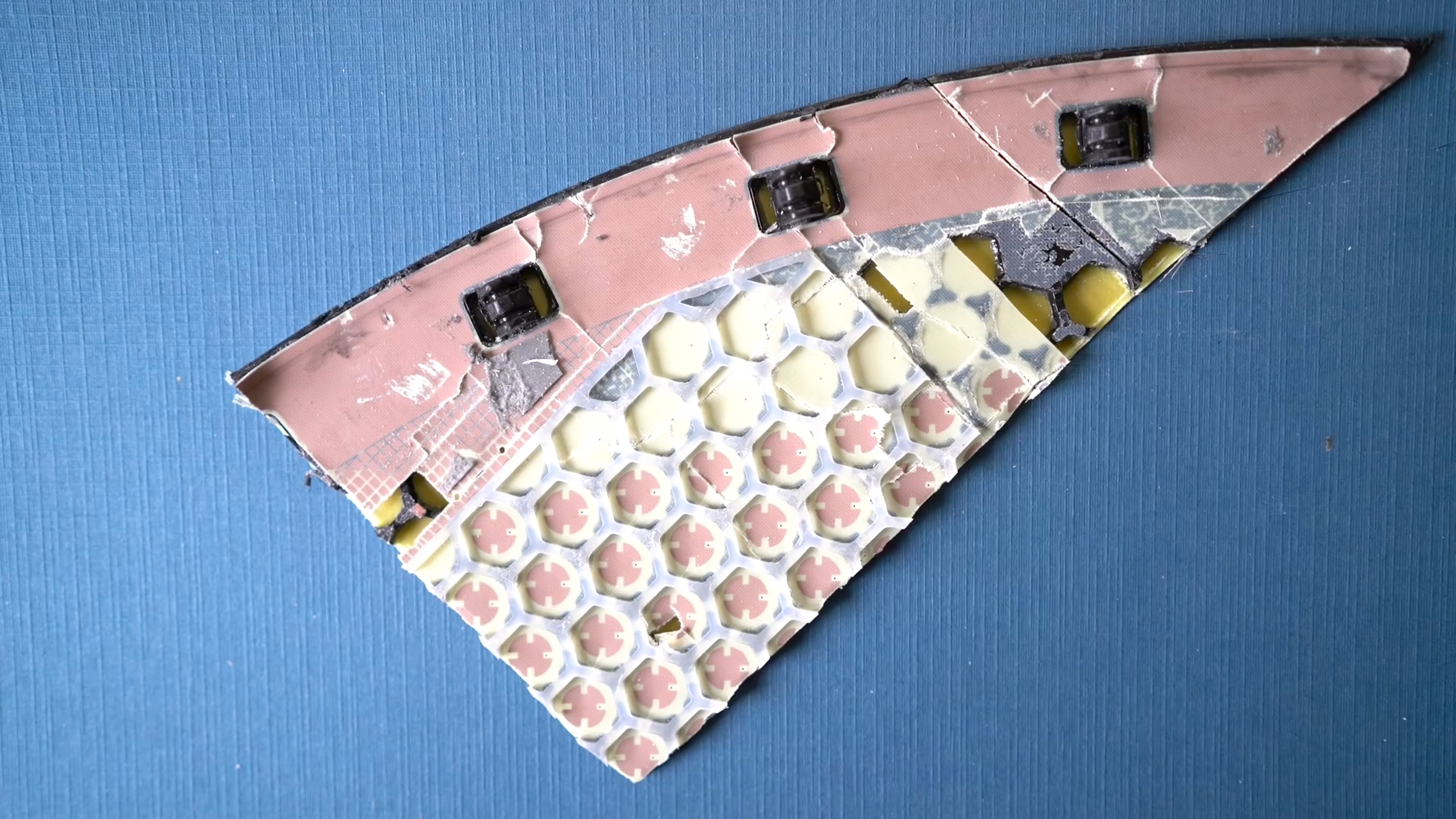

1) What are these cross patch shapes for? Directivity control, so that more gain? ... Surely the cross shape is for circular polarization achievement/improvement.
2) So...  they use slot feeding mechanism?

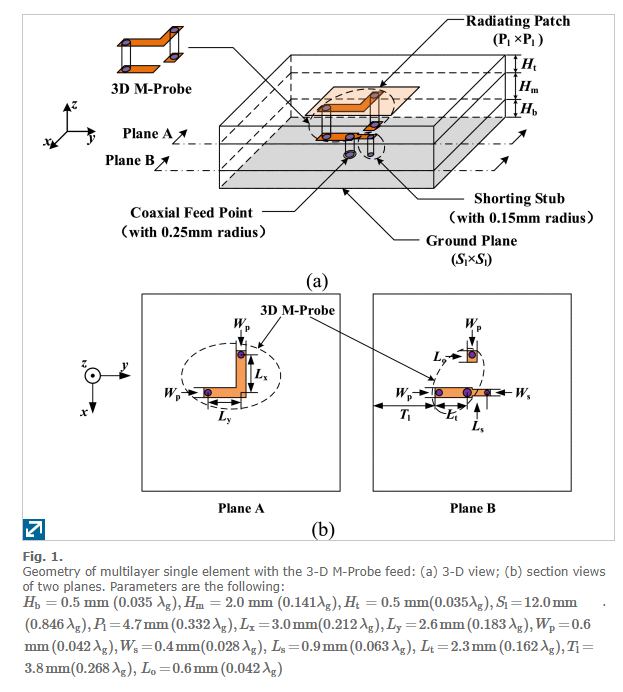

,I think it would be interesting to build a monopole antenna for the 5.5 GHz band...Broadband Circularly Polarized Patch Antenna Arrays With Multiple-Layers Structure
,,,does this by using an L-shaped feed on the layer below, and covers almost the exact frequency range needed (roughly 10-14 GHz)
They are  Circular polarized disc patchs Right hand and Left Hand  without the CUTS it would go linear...
and are switched electronically from RHCP to LHCP
and EACH disc  could be fed (slot feeding) the phase of signal you program (delays) to make an Electronically Scanned Array (no need to point to Each satellite , the electronics do that) AND there is BEAM FORMING too...
