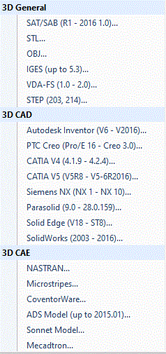

Thanks sir, are you using CST 2020 because my version is not compatible. Can you export the model so it can be use in other cst version?
ACIS .sat sab What year...?
or STL  iges step NASTRAN...?
I am using CST studio 2017. other details is shown in the photo
