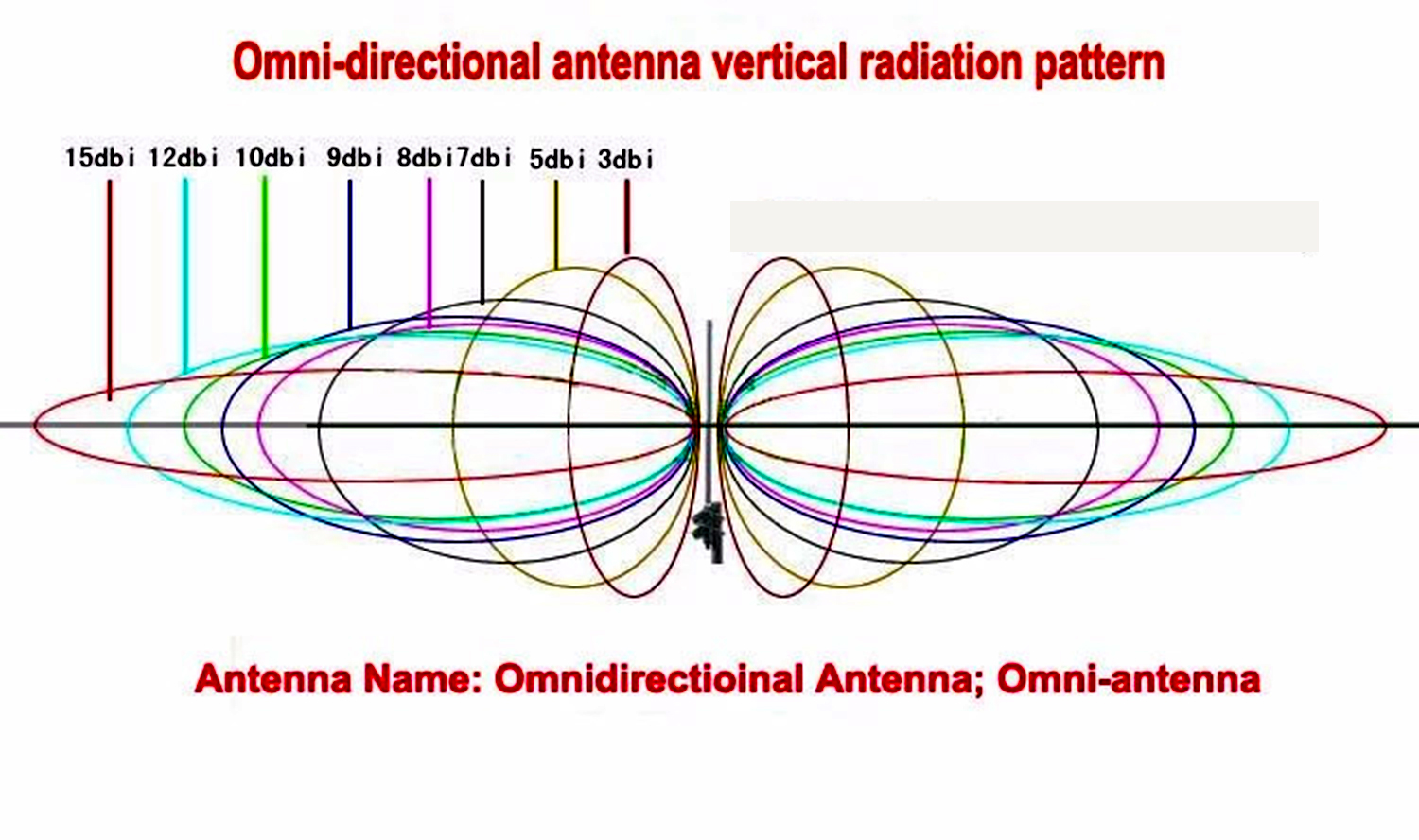

pretty sure is the ELEVATION ANGLE going UP and DOWN

it seems like you gonna need a DUAL BAND omni (with high gain but wide angle of elevation or small angle pointing DOWN)

Here's TWO things you might wanna try , BEFORE changing antenna,...(my 2 cents)
The same 8/9 dbi UP side DOWN (diagram might point better to ground) lower angle
A HAT (aluminum disc) on top of the same antenna (pushing energy down to AP) lower angle
(BUT if 800meters 8/9 dbi  (with lots of obstacles  i assume) is NOT enough closer to 15dbi should do it) New antenna and finding the right HEIGHT
you see...when the mast swings your AP falls OUTSIDE the LOBE of reception UP or DOWN...but OUTSIDE...
,,mfr, for your case I think a disc-cone antenna is good instead of mikrotik bullet...!!!

under 5 dbi wouln't do it for 800 mts and obstacles (disc cone) not sure
