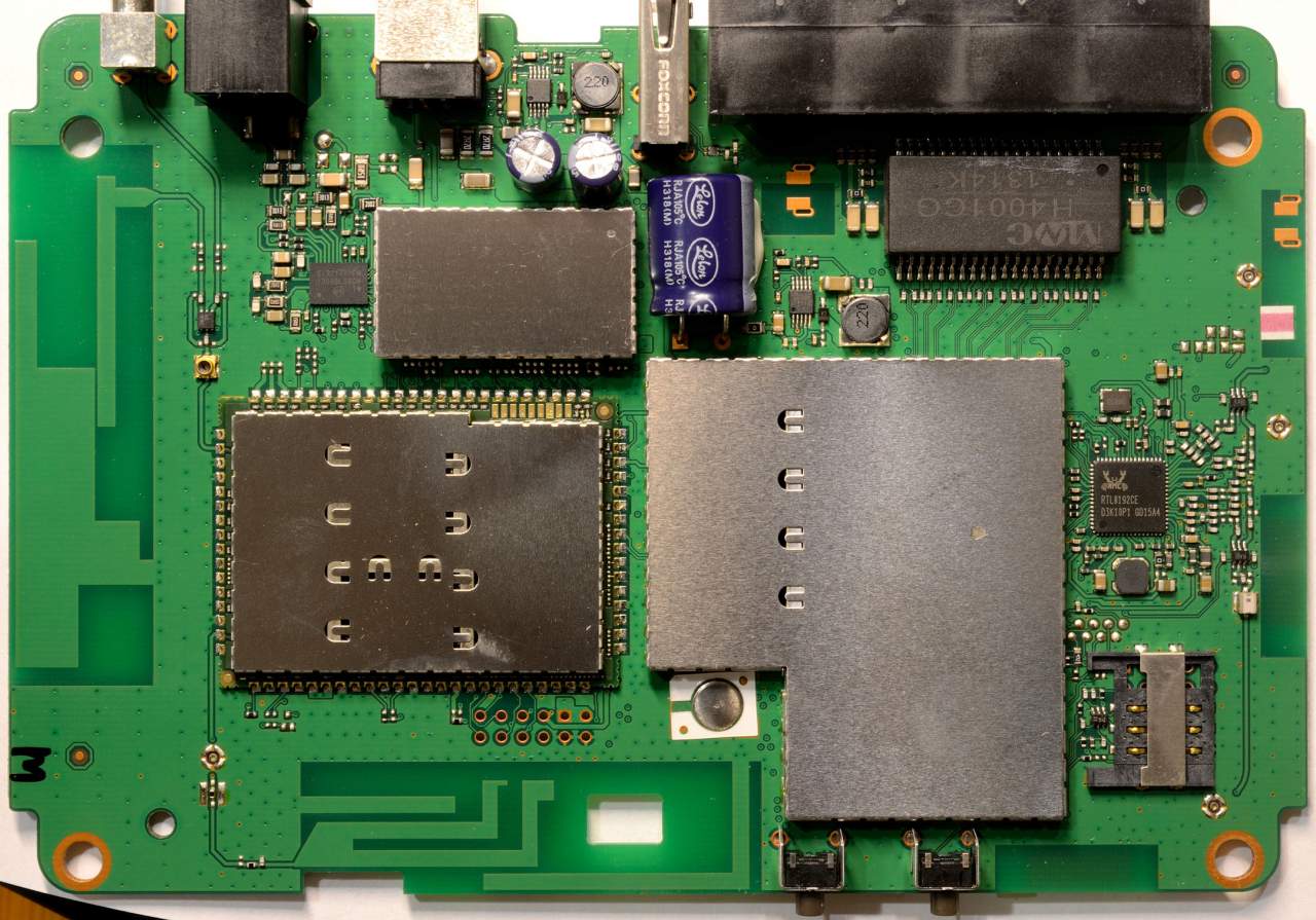

Have a router with built in modem Huawei B683. Used in the country, the range is 2400 there clean.
All anything, but Wi-fi gives it worse than a smartphone, the plot is not even enough, although installed in the wooden deck

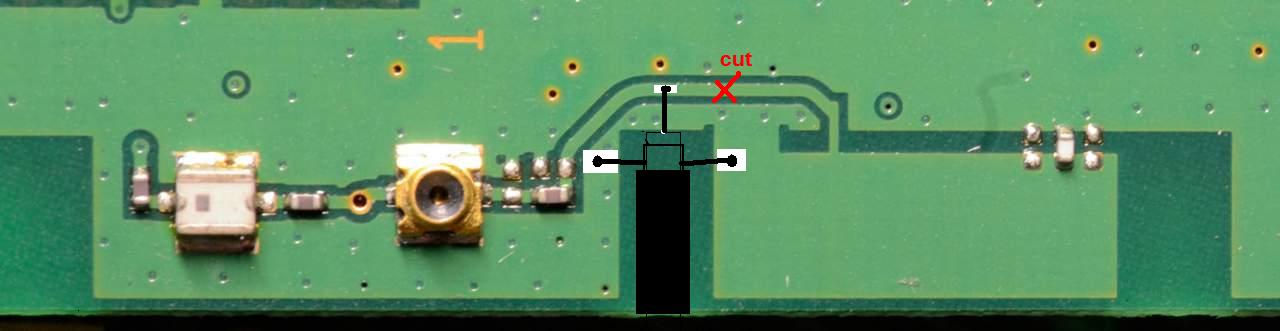

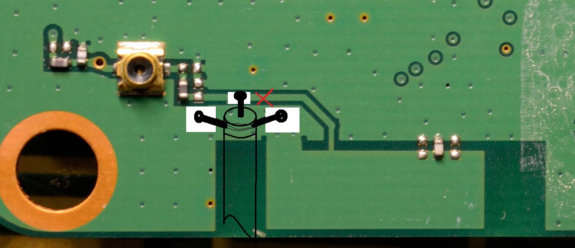

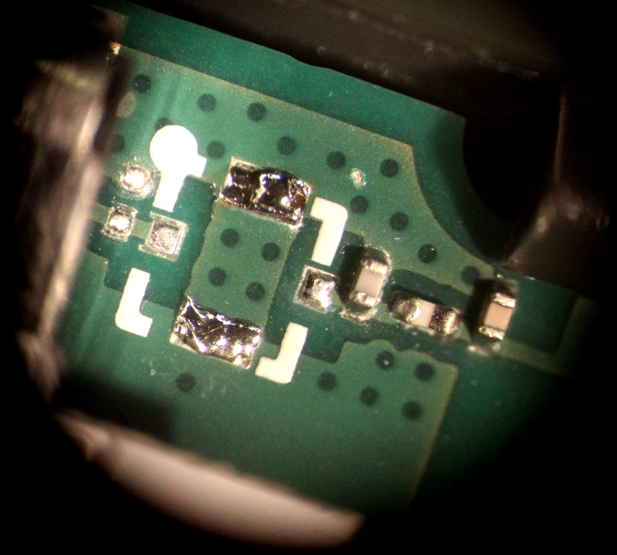

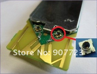

solder the pigtails and screw conventional pipettes from any router.Track is better to cut, as this connector is not found, and if found, it will break with the first poke. In extreme cases, all easy to restore in place

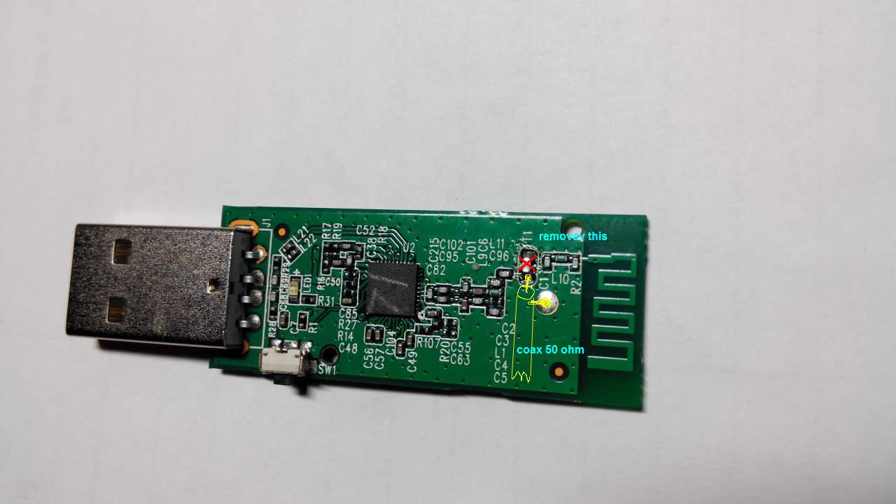

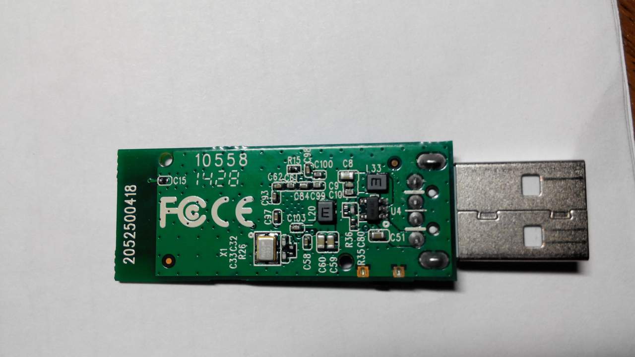

Where to solder an external antenna for tp link tl wn727n...???

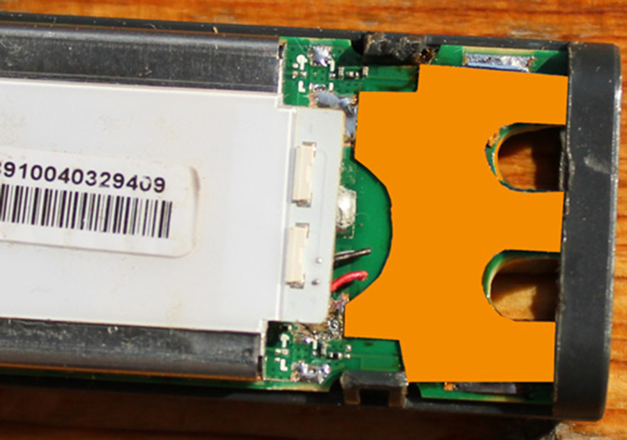

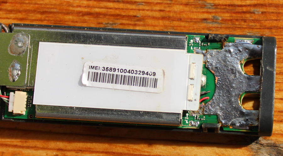

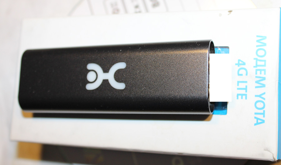

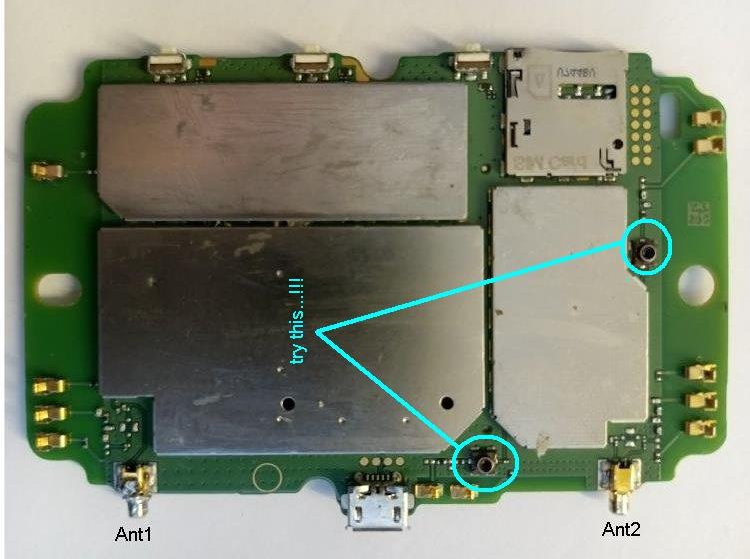

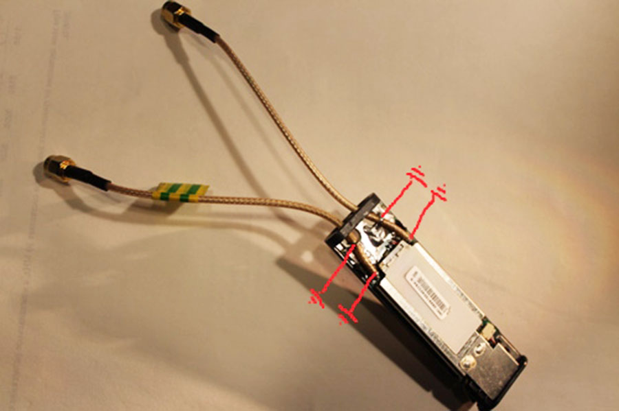

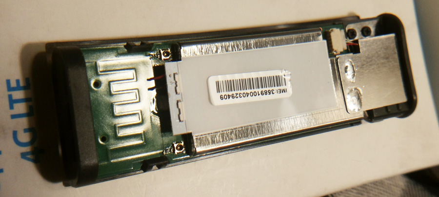

Modification Modem YOTA 4G LTE to operate with an external MIMO antenna.
In weak signal conditions, it is possible to stable operation with an external antenna.
The easiest way is by using two pigtails...

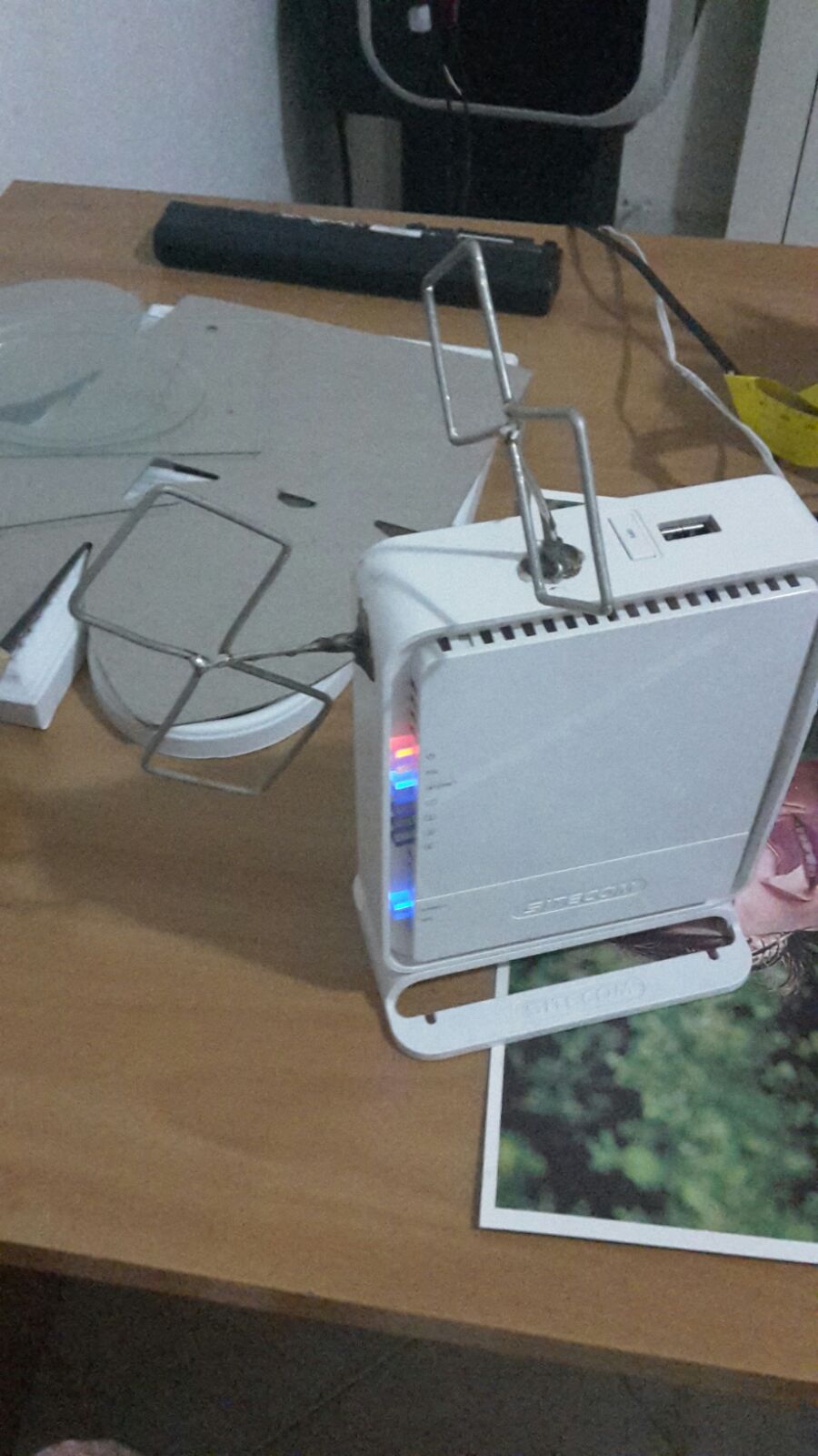

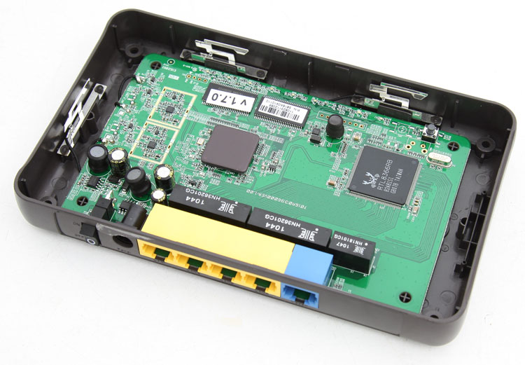

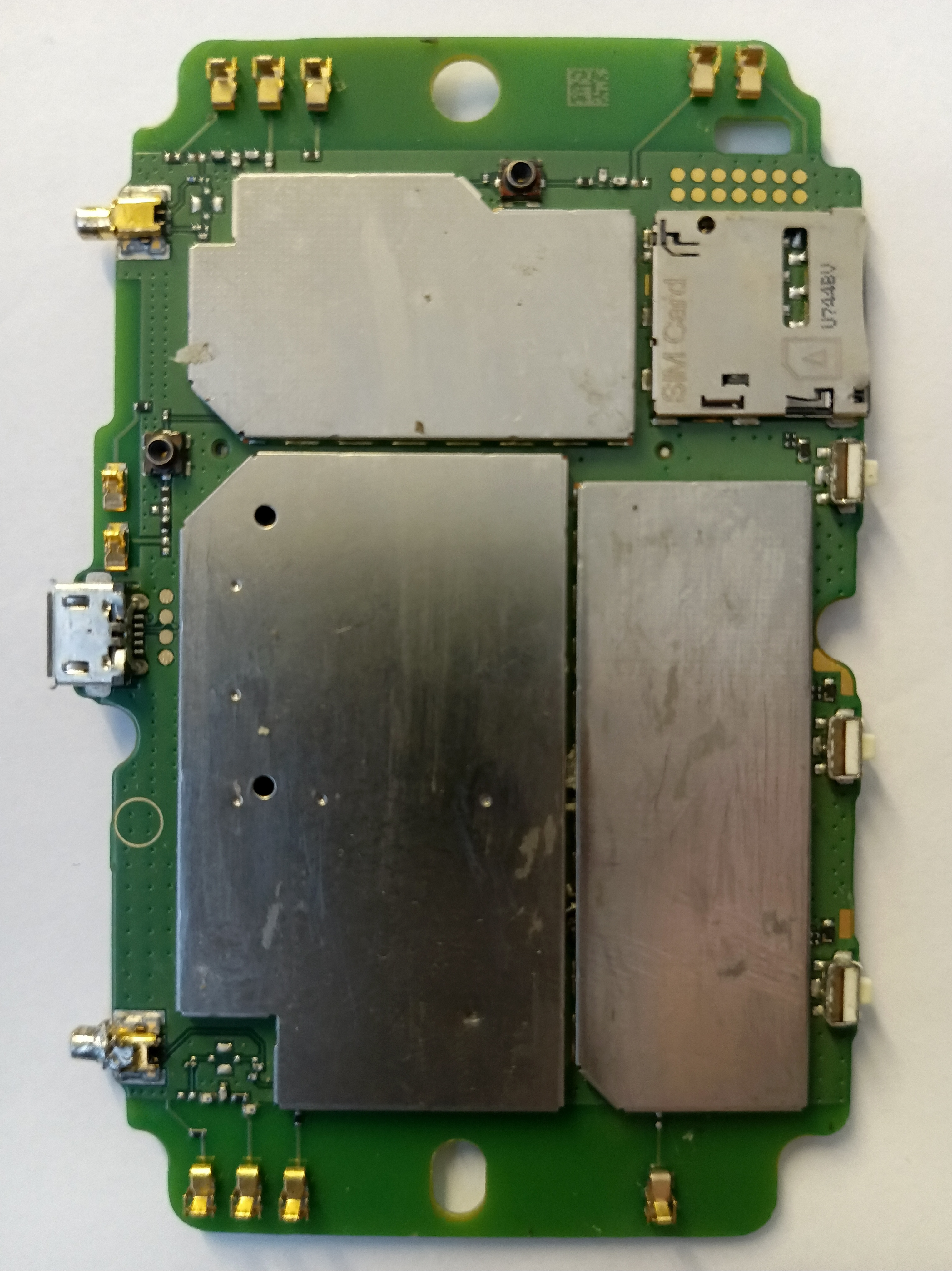

And how you  welded biquads inside Sitecom xn 300 wml3600?
