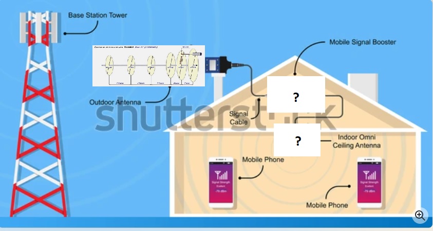

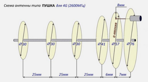

I just created the 4G antenna shown in the image below to catch the 4G signal to transfer it from the external to the internal of my house. This 4G signal is used by an USB modem with the appropiate connectors. Everything is working good.
Now my question is : Is it possible to create a 4G repeter/amplifier? I mean I don't want to plug the external antenna directly to the USB modem but I want to irradiate the signal in the whole room. In this way I will be able to go on internet and also to call with my phone.

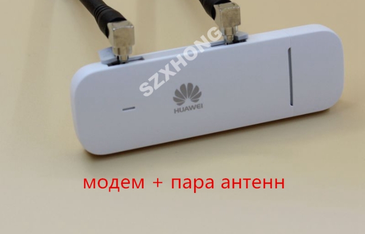

I have  huawei 3372. As you can see in the image below with this model I'm able to plug directly the external antenna with the two cables. I already tested it and everything is working. Now I want to create something (an amplifier or a repetear) that allow me to avoid this connection with the USB modem because I need the 4G signal also for my phone. So I need a sort of circuit that transfer the 4G signal from the external side to the internal room.

My antenna is working perfectly with my USB modem huawei 3372. Internet is working on my laptop but the mobile phone signal it is still not fixed.
Now I want to create something that is able to bring the 4G signal for all the mobile phones inside the room (see image below).
Questions:
1) A signal booster it is required? If yes, do you know how to build it?
2) Do you know how to design the indoor omnidirectional antenna?
Thank you
