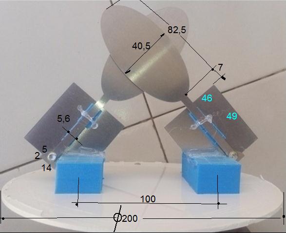

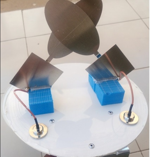

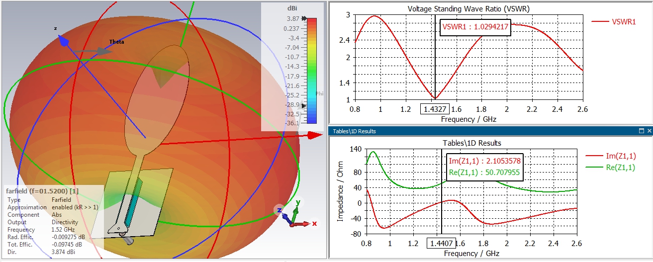

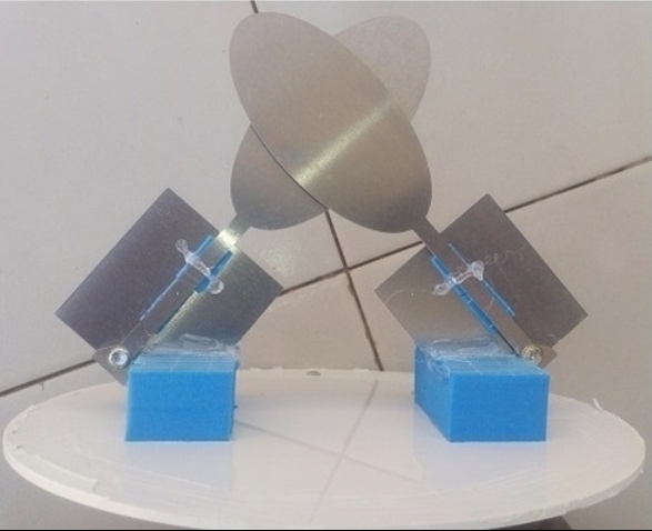

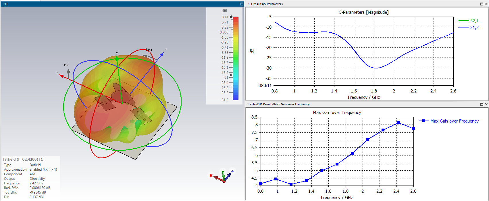

I don't have these dimensions..maybe only by approximation ....!!!
screenshot_5323.jpg.b22245385f679042b12398122011c94e.jpg.3eb499f3174d4d0455ebab1dfbf66583.jpg
hm...they got two 3.5dbi antennas X-pol...
3.5 x 3.5 = 12 (dbi)
THIS is how this chinese antennas arithmetic woks
,,, something like that, you can never say(3.5 x 3.5 = 12 (dbi)).. !!!!
