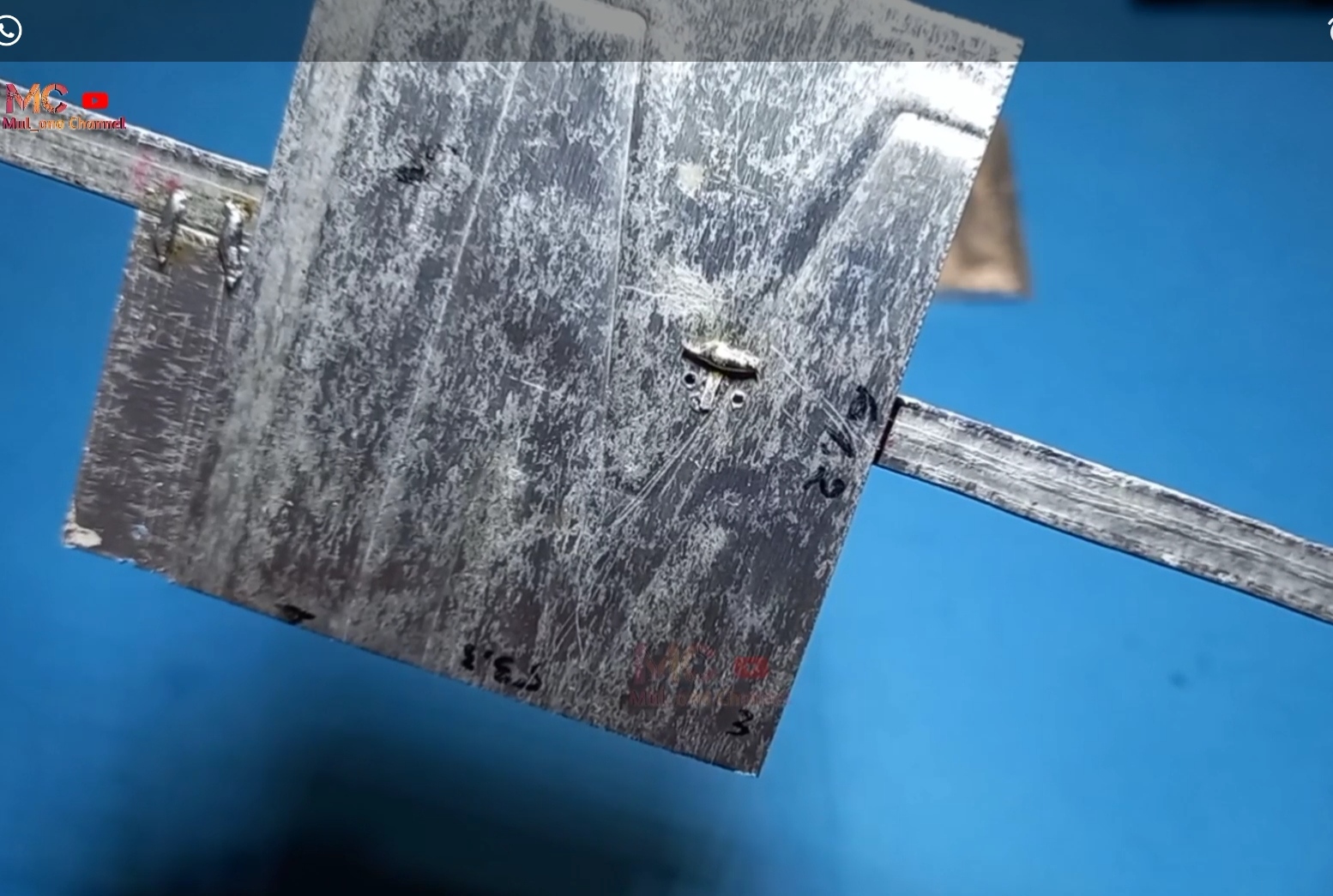

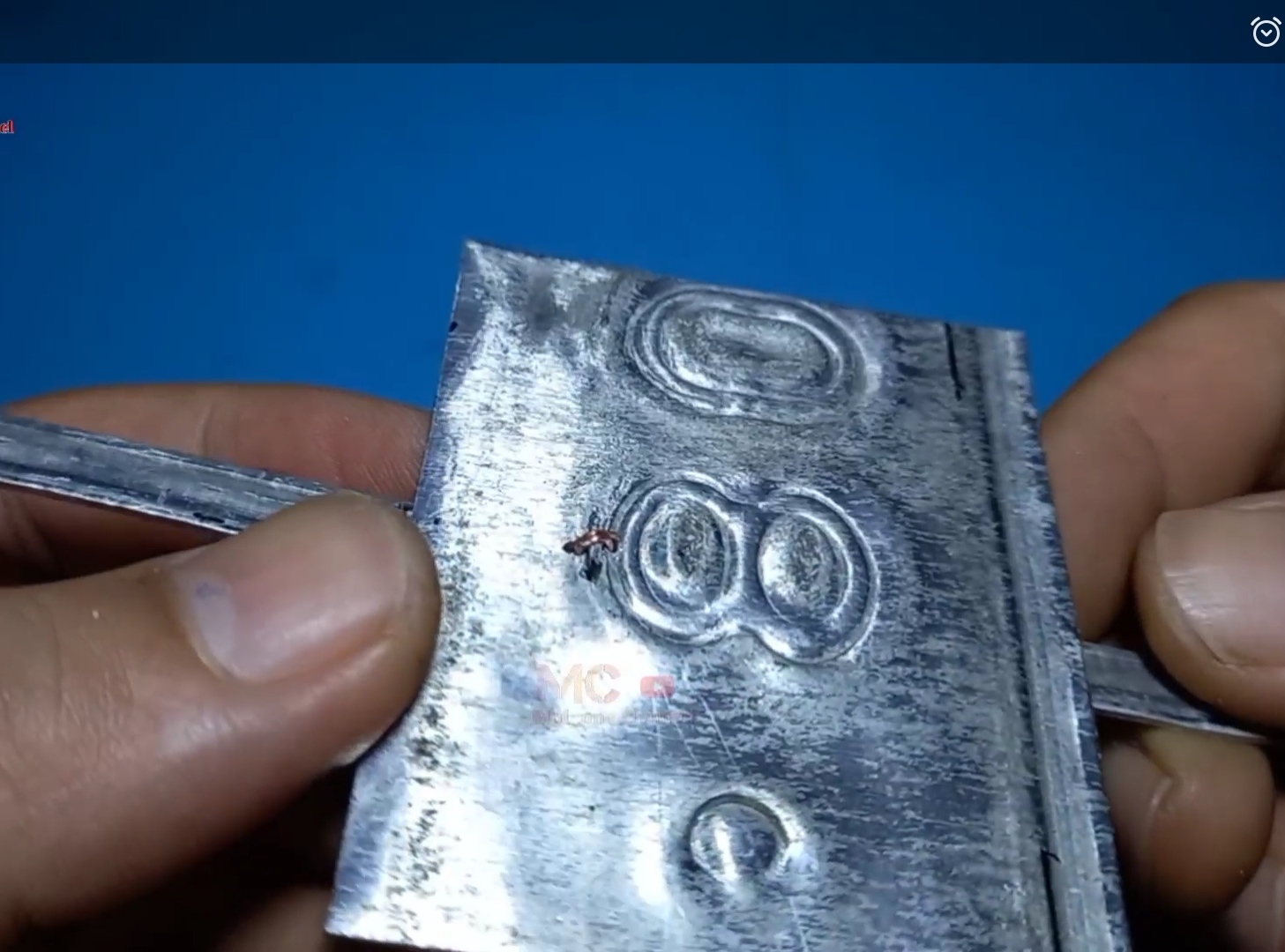

This is my stupid way of soldering aluminum. Will this affect the performance of the antenna? Is there a better way than this? Thank you.
,,, thanks Antonius, no, the performance of the antenna is not influenced by this method of soldering .. !!!
,,, please ,attach a few words for explanation to each image above...!!!

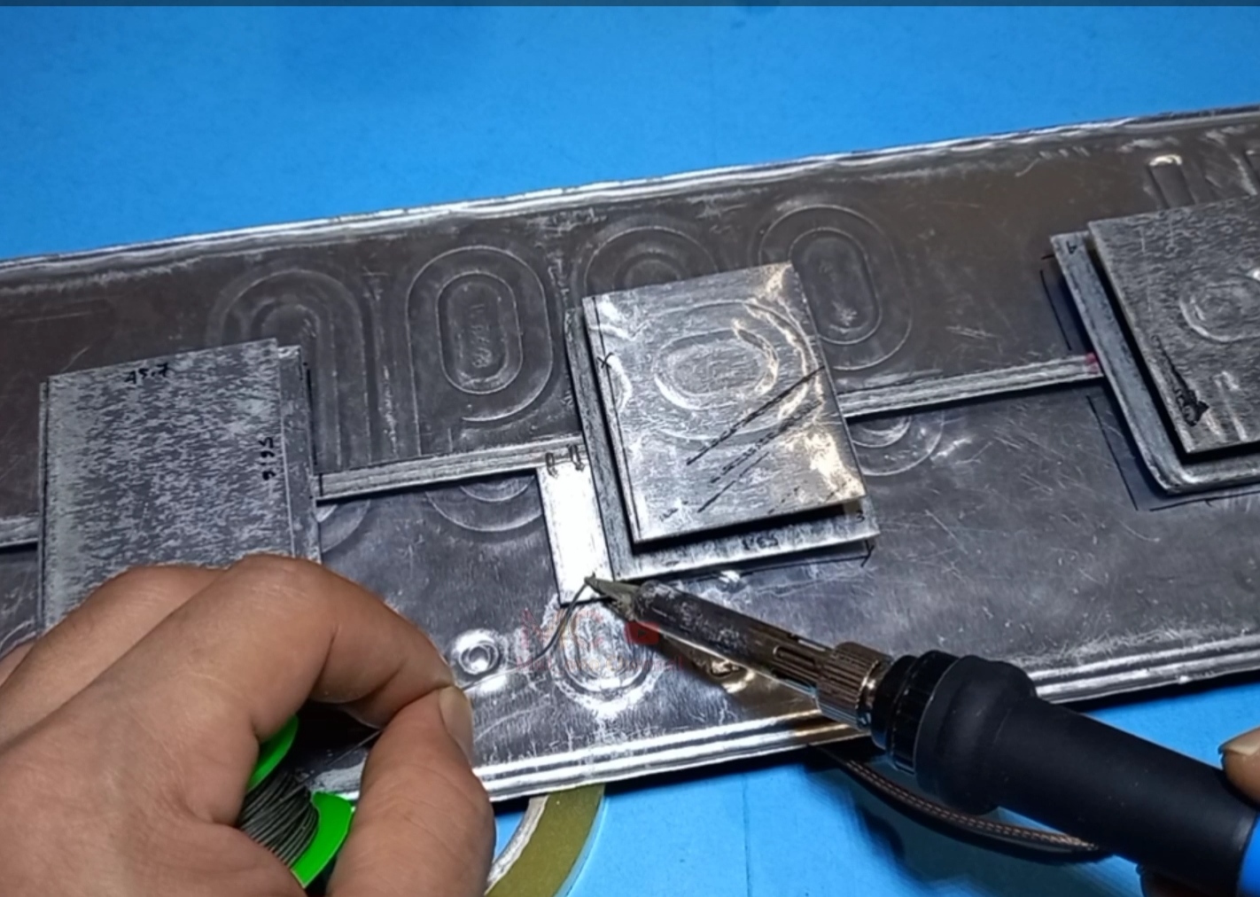

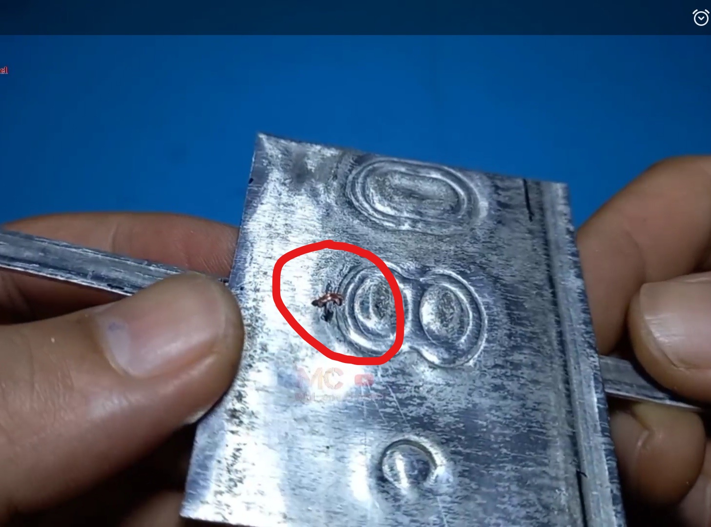

To conclude from the image above, each joint I'm about to solder looks like a small coil of copper wire. The key to making soldering on aluminum easier is the winding of the copper wire. I took this copper wire from a piece of LAN cable. Then, the two plates to be joined, I made holes with a diameter of 1 mm on both sides, then the two holes were joined with a copper wire coil, wrapped as tightly as possible, then just glued the tin with solder on the front and back. I think this is the easiest way to do it.

It's not  soldering Way  at all. ?!!!
You just attached the aluminium  pieces  by coper wire. And you solder the coper wire .
So the aluminium pieces are attached but not soldered .
Anyway you are welcome bro   and have good luck.
if there's movement (wind , manipulation , vibrations) you might experiment ups and downs in signal strength (VSWR , Mismatch impedance, resonance , etc)
As long the CONTACT is good , all ok.

If it was made a little neater, would it still affect the resonance? That's right, the material I use is the vehicle number plate / License Plate.

At each plate connection, I put a little wedge which I glued on both sides. So the connection remains secure.
Styrofoam is the most TRANSPARENT material  (almost no effect on Resonance) , but thin PET is good too...Silicone sealer are NOT recommended (high losses)
