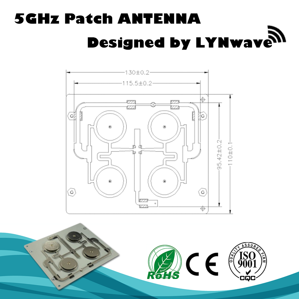

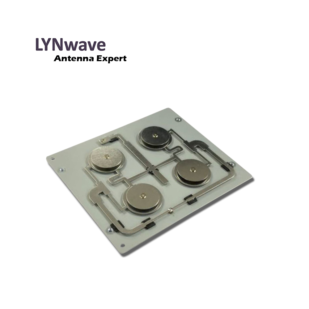

2x2 5GHz High Gain 14dBi Panel Antenna
Model #OLX19M-097130-A Frequency (MHz)5150-5825
Antenna 2 Peak Gain (dBi)13.81
VSWR2.0 : 12.0 : 1
Power (Watts) 55
Impedance (Ohms) 50
HPBW (Azimuth)30°28°
HPBW (Elevation)28°34°
Dimension (mm)129.5 x 120 x 5.3
Polarization Linear
Connector IPEX
Cable Length (mm) 160 (customized) 112 (customized)
Operating Temp (C)-40~+85
Manufacturing 100% made in Taiwan

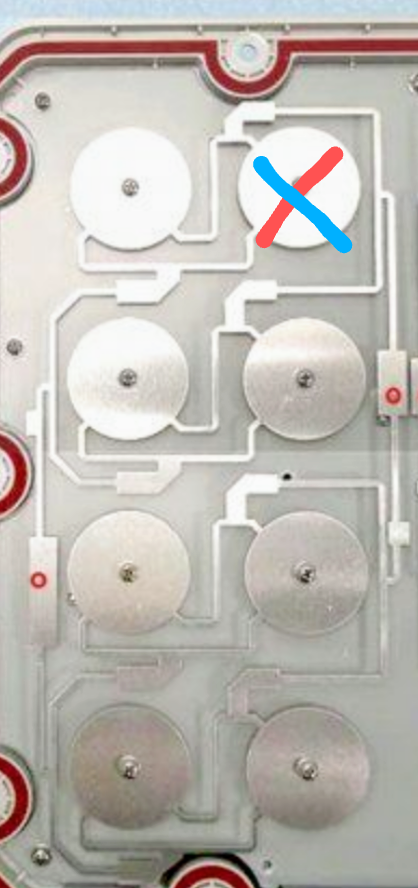

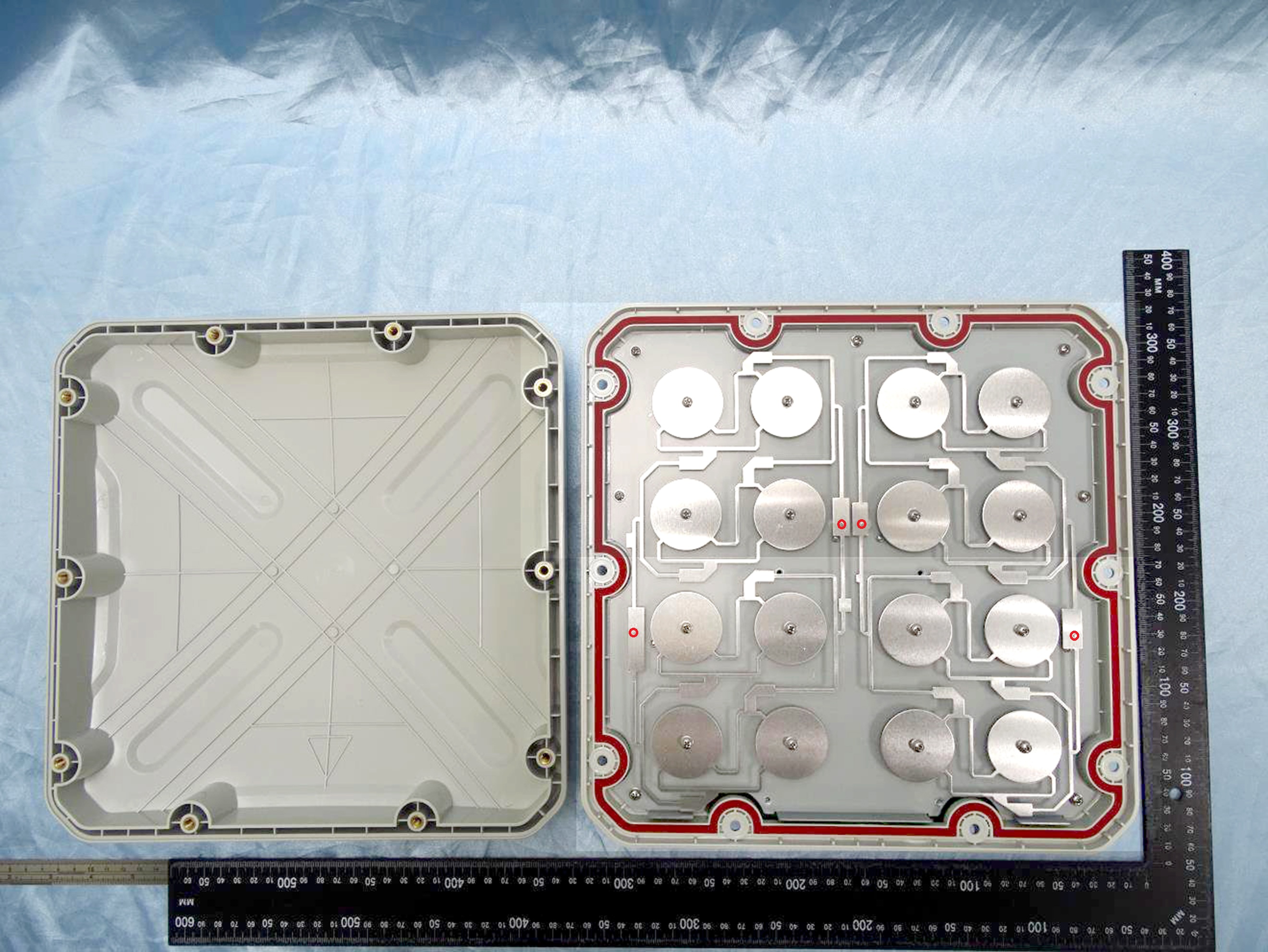

this are microwave links designs from Israel ...don't remember the brand , tho ...Alvarion ...Ceragon ...Radwin... (more Gain and 2 x Mimo 2x2)
is it me...? i see TWO antennas with TWO PORTS each...?
