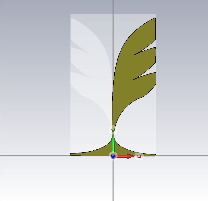

Vivaldi is OK ABOVE 1ghz...
not much GAIN tho, and it SUCKS under 1ghz...we must try and reconsider...JOMY might have a UWB design...CONE and DISC...

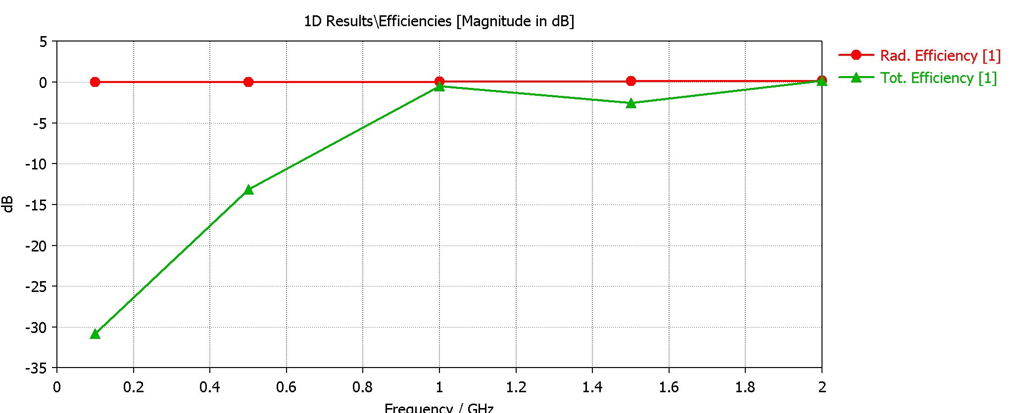

I have ordered one of https://moonrakeronline.com/skyscan-desktop-25-2000mhz-scanner-antenna  to see how it behaves. In the meantime there is cnc laser cutter that may accept commercial orders for some bat wings at the 2.4 and 5 (as dish feeder ) and also Wide Band Batwing Dual from the admin post. Otherwise the connectors are 100Khz-30Mhz and 25Mhz-17000Mhz. Also I am thinking to do some more bester if I get my hands on latte cuz the last time I did it with drill and sand paper to the exact measurements .... long long time do get there.  On the to do list Bi-connical( looking for materials)  and Inv-ammos. I will post the dimensions fot the skyscan if you like to make some simulations.

I just got the antenna. Next week I will have stubler  to take the exact measurments and post it here.
