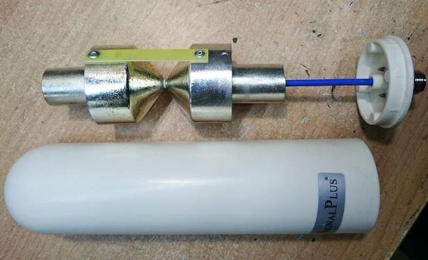

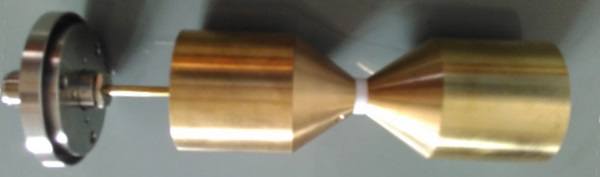

,,,another option...
 I am very busy these days, but in the yard, I will solve this problem..!!!

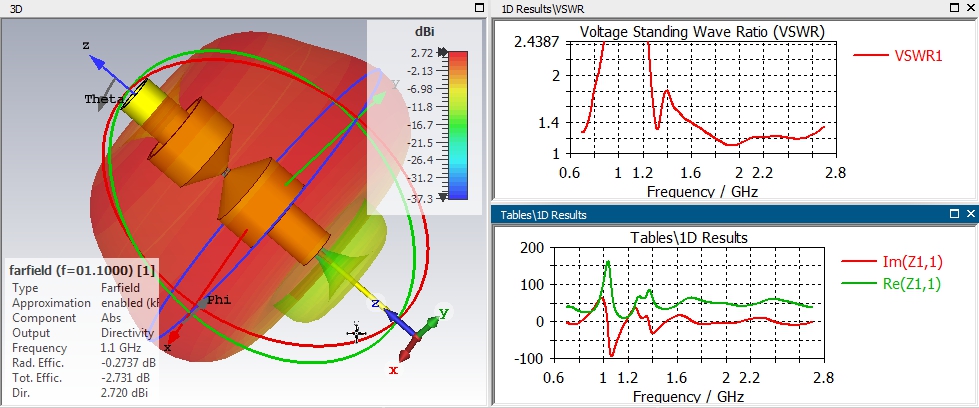

,,, yes, I came back with a simulation of these omni antennas...
,,,,but it still looks like it can't reach 6 dBi gain in directivity...!!!

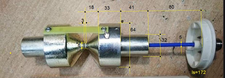

,,,and these are the dimensions used...
