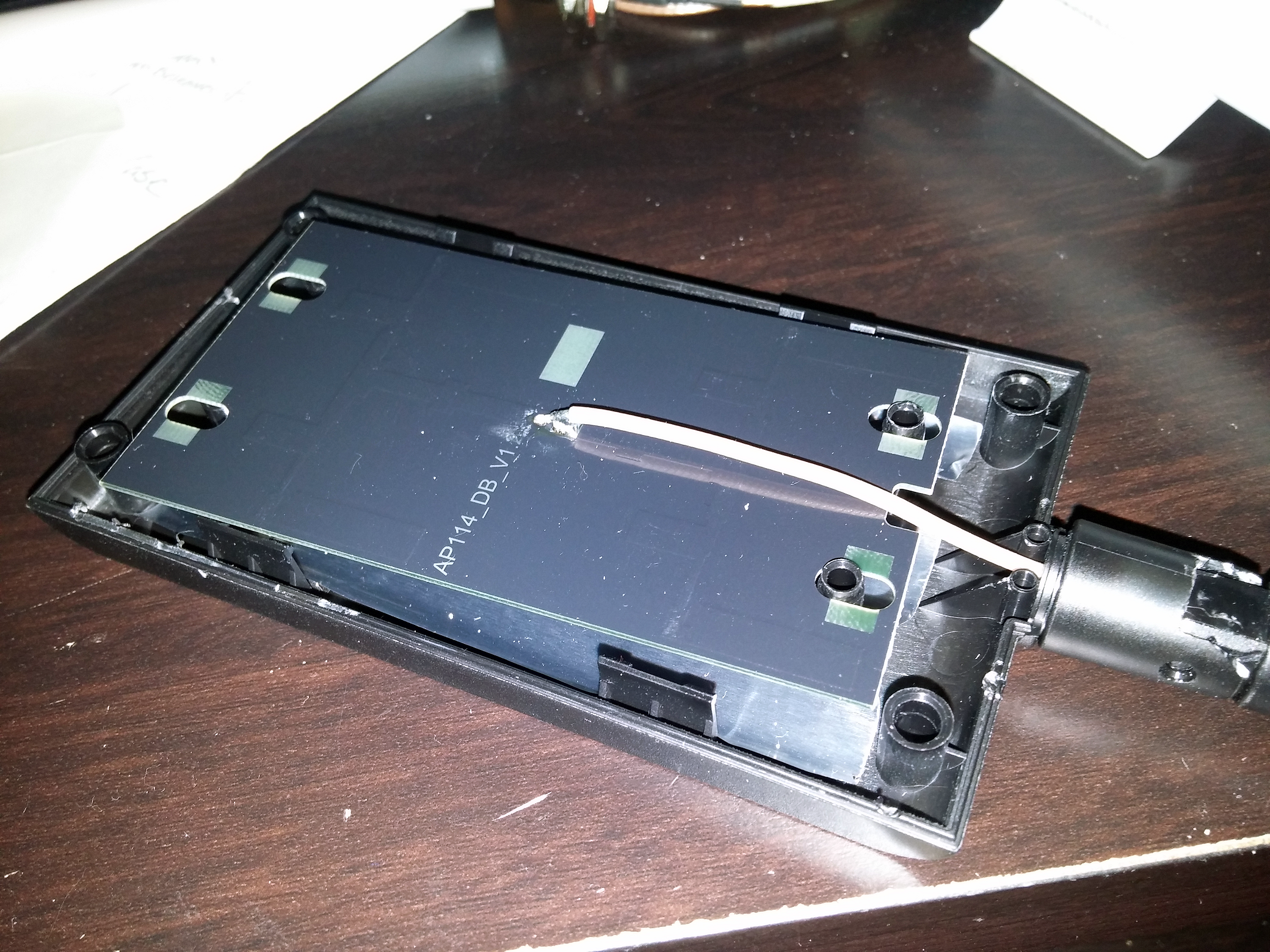

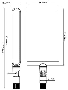

Clanon, somewhere on this site there are also dimensions...!!!
Couldn't find any...(searching , i'm trying)

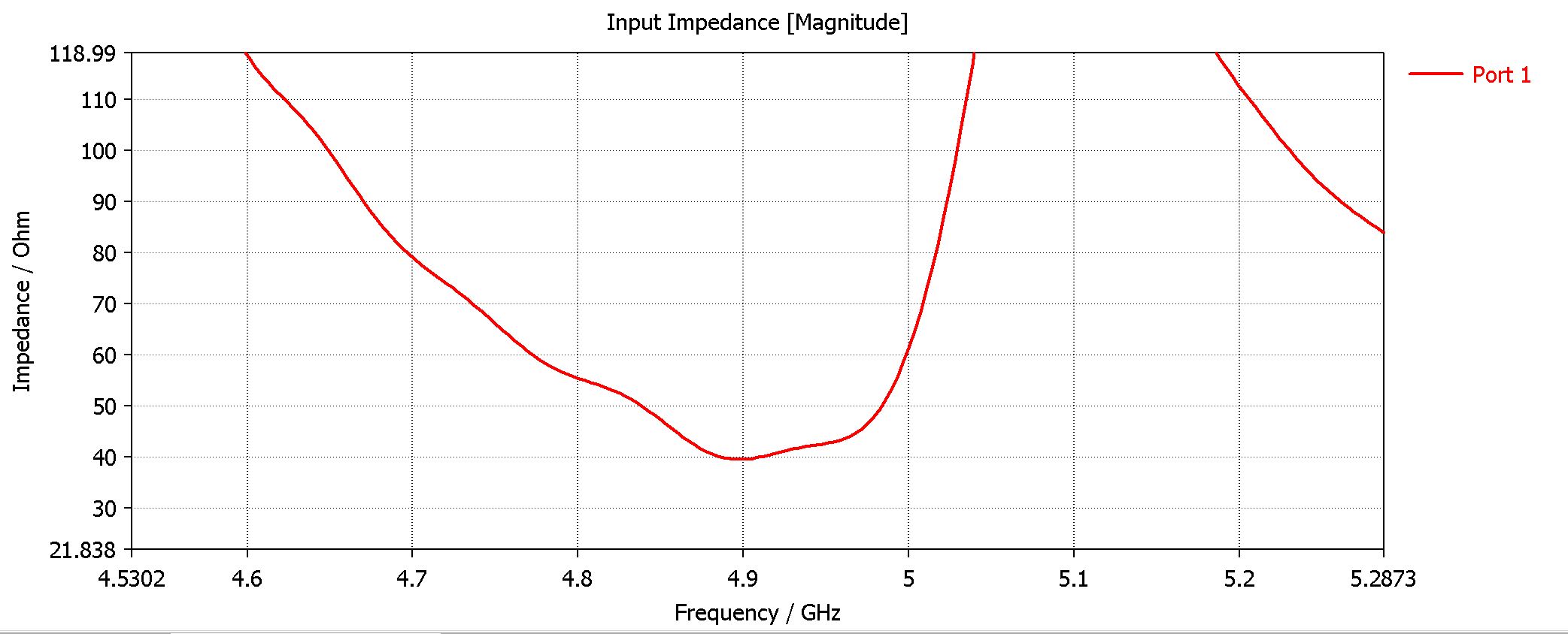

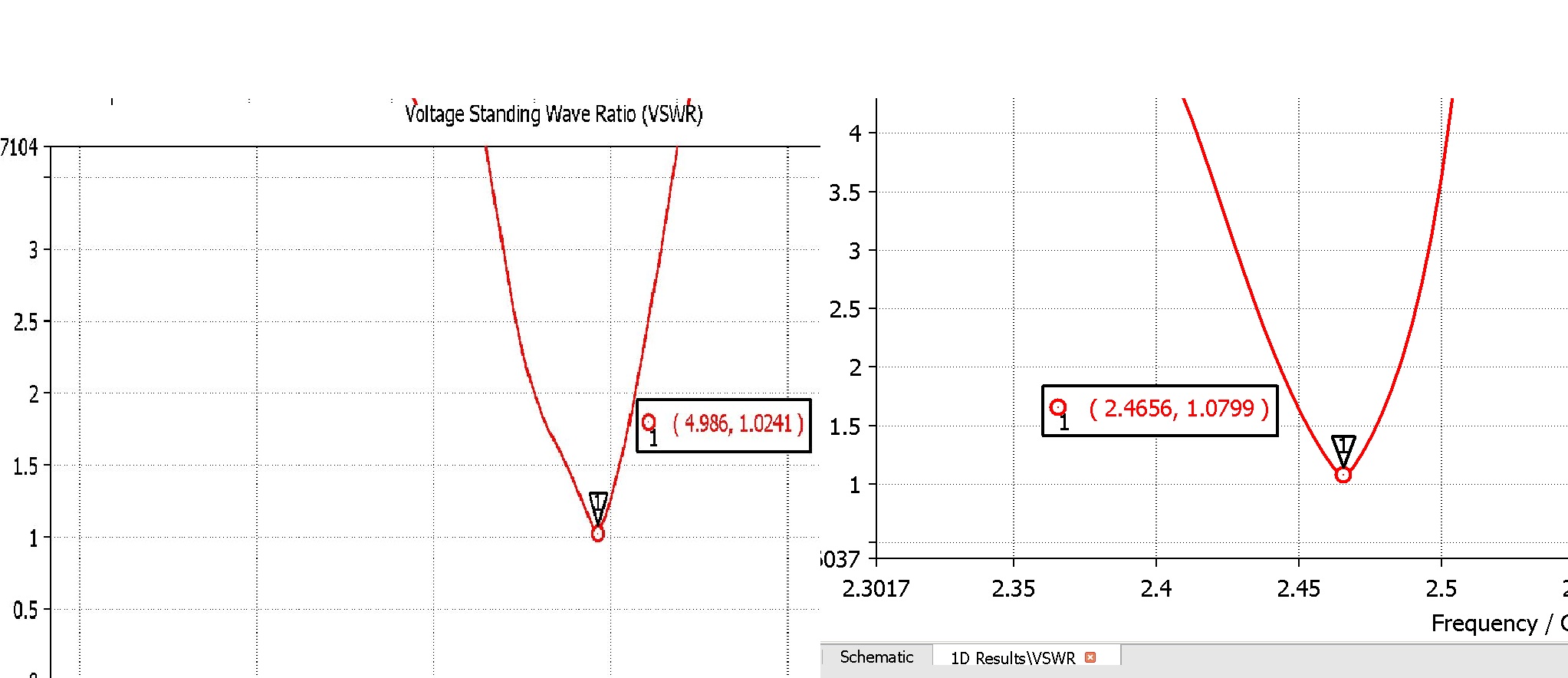

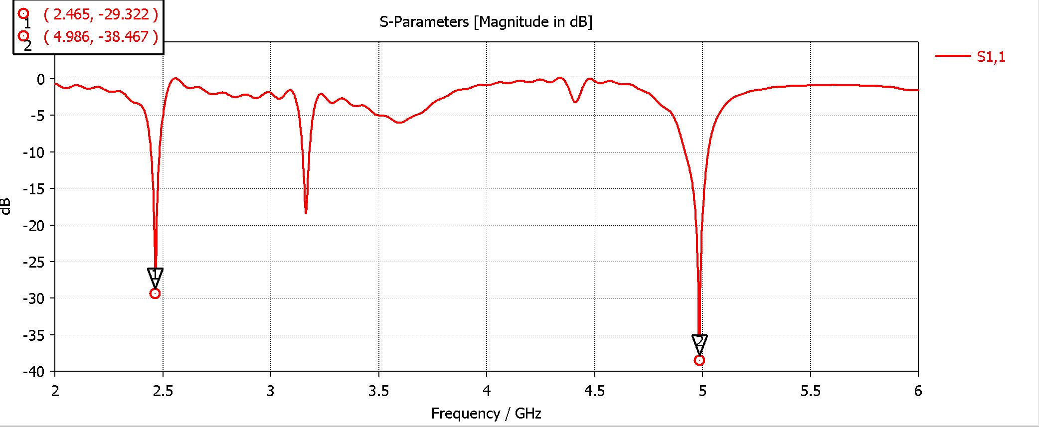

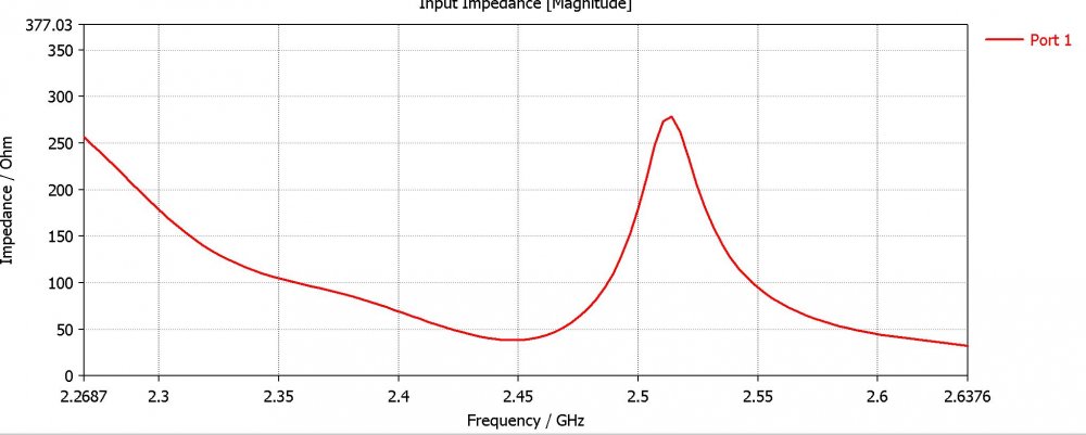

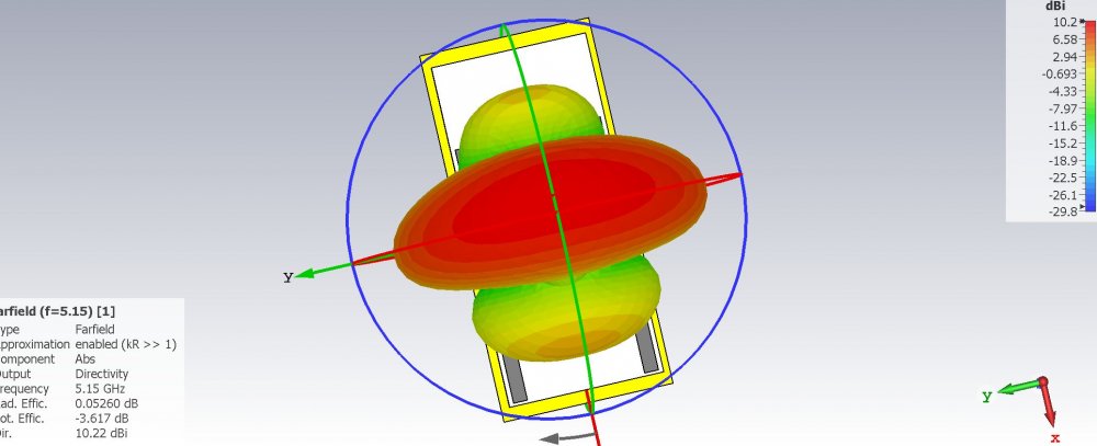

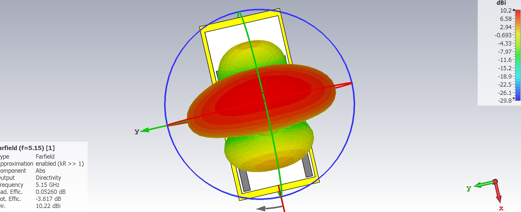

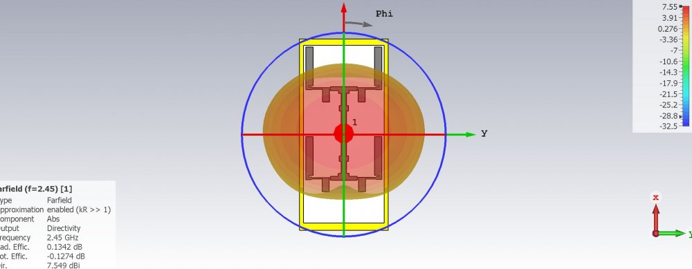

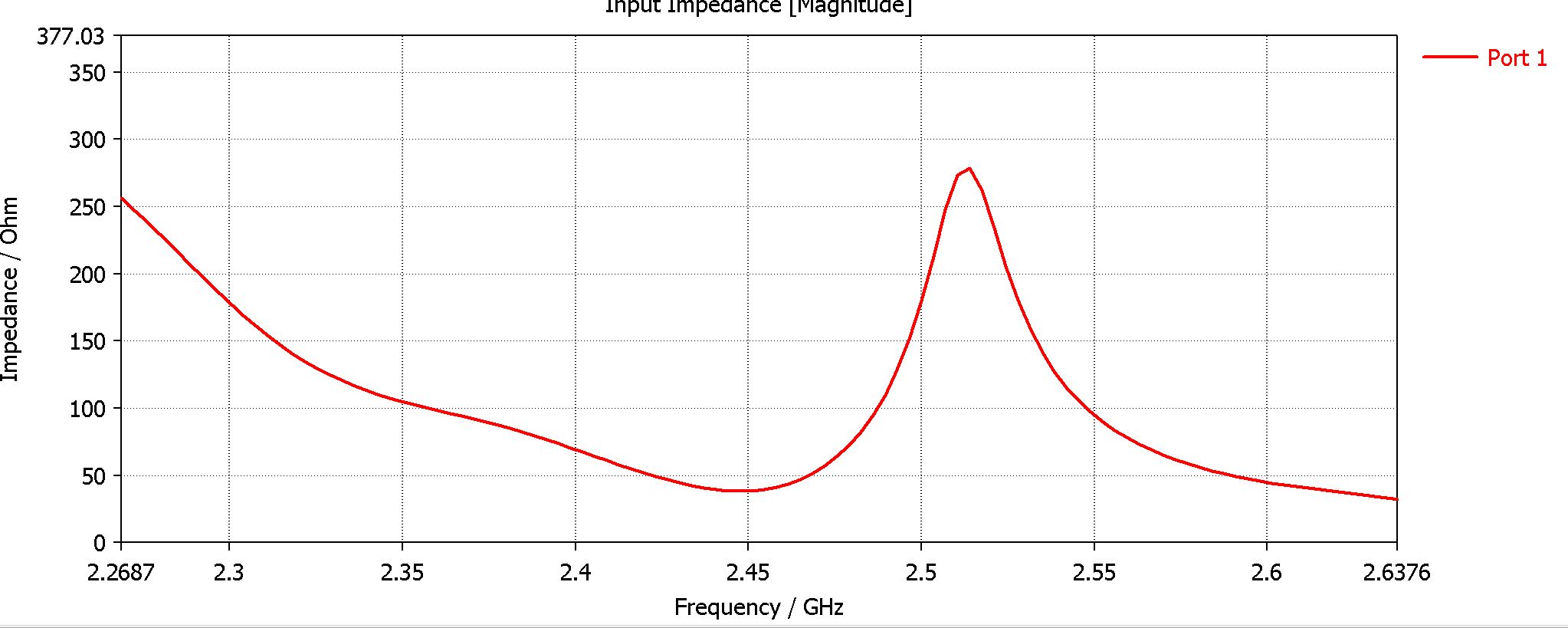

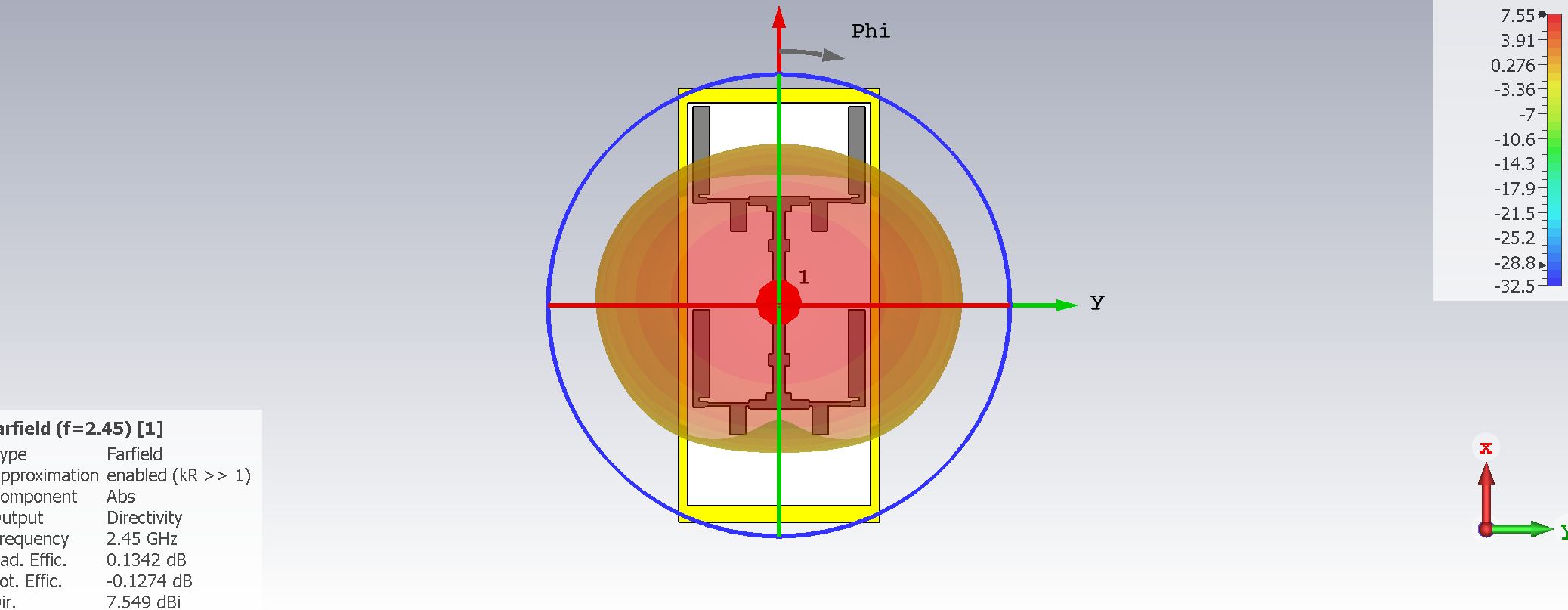

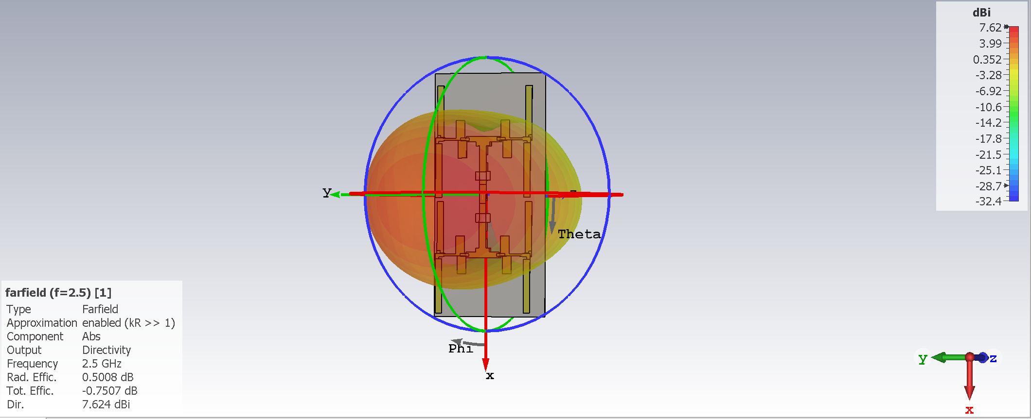

Working on IMPEDANCE adapting...

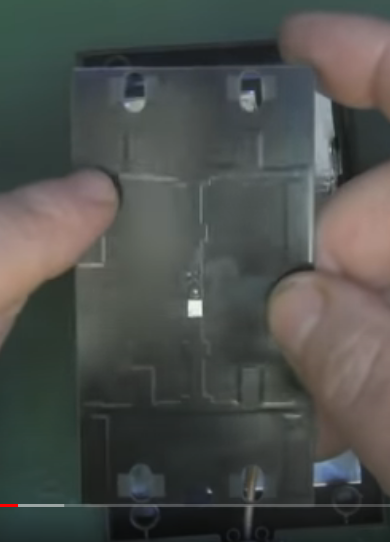

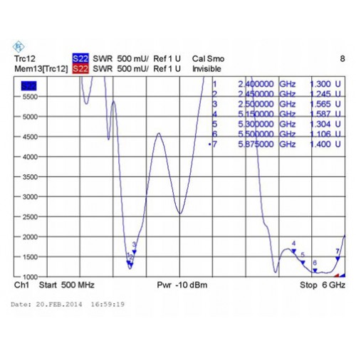

That TRENDNET is easier to build and simulate...
wouldn't be GREAT to develop an ARRAY bi-band using dipoles...? (15 or more dbi)
DISTANCE to REFLECTOR must be TAILORED to local needs...(FR4 quality . reflector enclosure sizes and shapes) but it's on ballpark...i think
