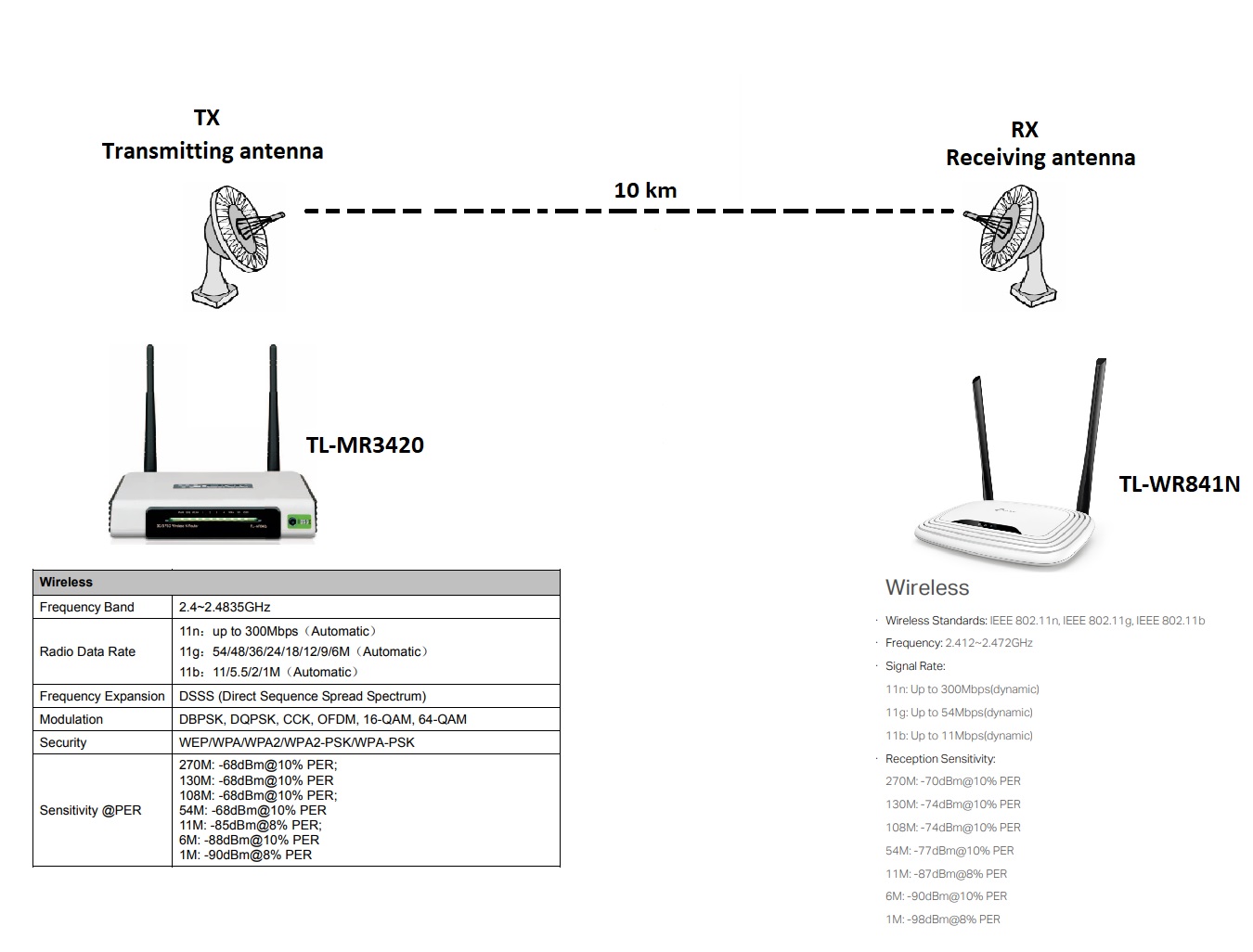

Hi,
The image below shows what I would like do.
I can place the antennas on the roof and there shouldn't be any kind of obstacles.
Questions:
1) The proposal sent by @Admin it is feasible?
2) It is required to build two equal antennas or it is sufficient just to create the TX antenna as parabolic and the receiving antenna could be normal without parabolic dish?
3) Both the routers have 2 antennas, should I create antennas with two SMA connectors? If yes, where shoud I place these connectors?
Thank you for you support
Those are  2T2R (mimo) they NEED both antennas to make FULL use of BANDWIDTH
sensitivity is better on the 841 (need less gain and power)....
Link budget calculates at least 18 dbi gain needed for 17 18 dbm of power and -68dbm sensitivity...

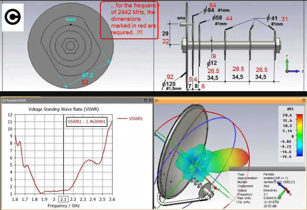

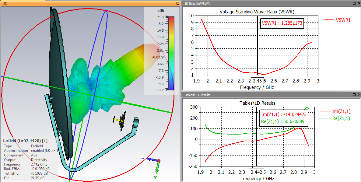

,,,you have two options...with the center phase where the focus of the offset parabola is placed..!!!
14 hours ago, Marcello971 said:
If I understood well, this antenna should have a sufficient gain that I need (18 dBi).
I have to create 2 identical antennas with a parabolic disc (1 for TX and 1 for RX). The only think we shoud add in the design is the additional feed since the wirless router has 2 SMA connectors.
Before to start to build the antennas I will wait the results from the simulation and a confirmation from Adim.
Please correct me if I said something wrong.
Thanks
if you choose parabolic dish reflector
you'll need
any good TWO PORTS feed for that dish (mimo 2Tx2Rx REQUIRES two cables , two antennas or one at 90 degrees between two ports) to get FULL SPEED it maight work okay with just ONE cable-port but NOT FULL SPEED  (depends on HOW it was configured , firmware settings)

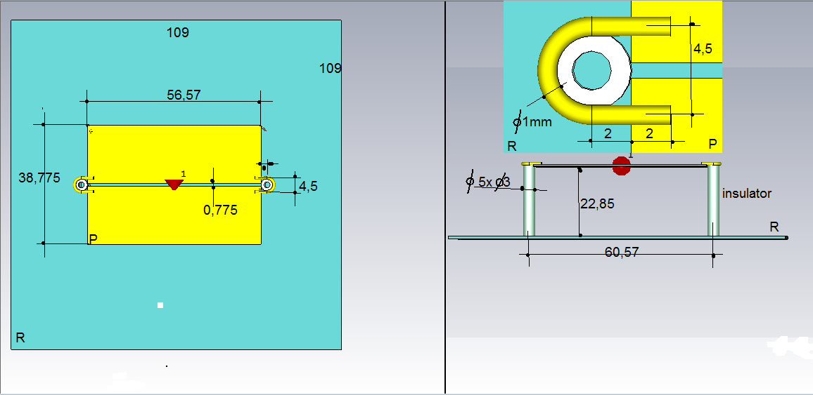

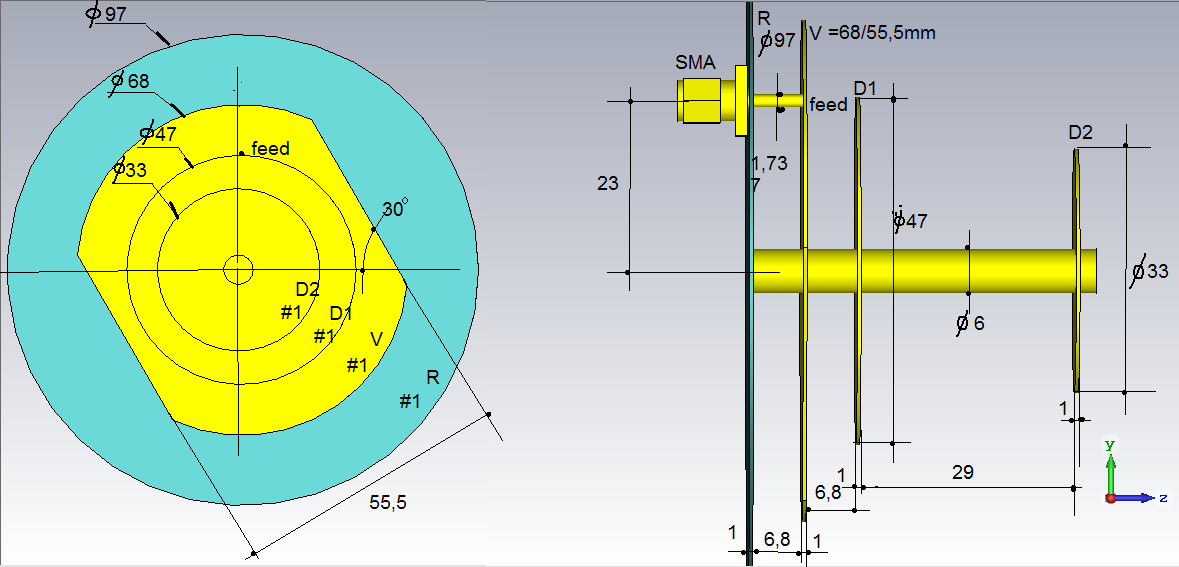

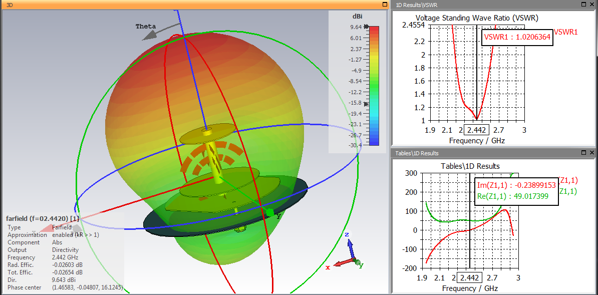

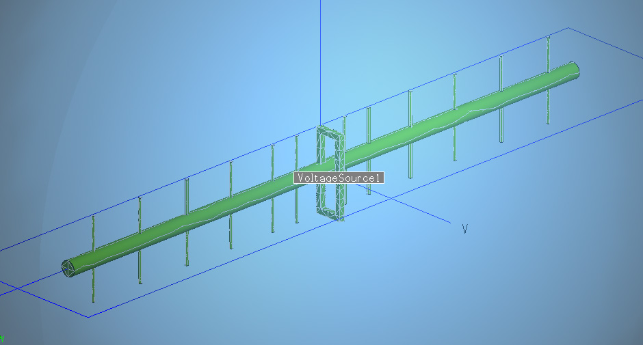

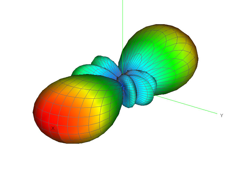

,,, the simplest UWB antenna, Sputnik antenna...
SputnikV 9_9

you gonna need TWO of those at 90 degrees...+ some separation (a couple of cms)

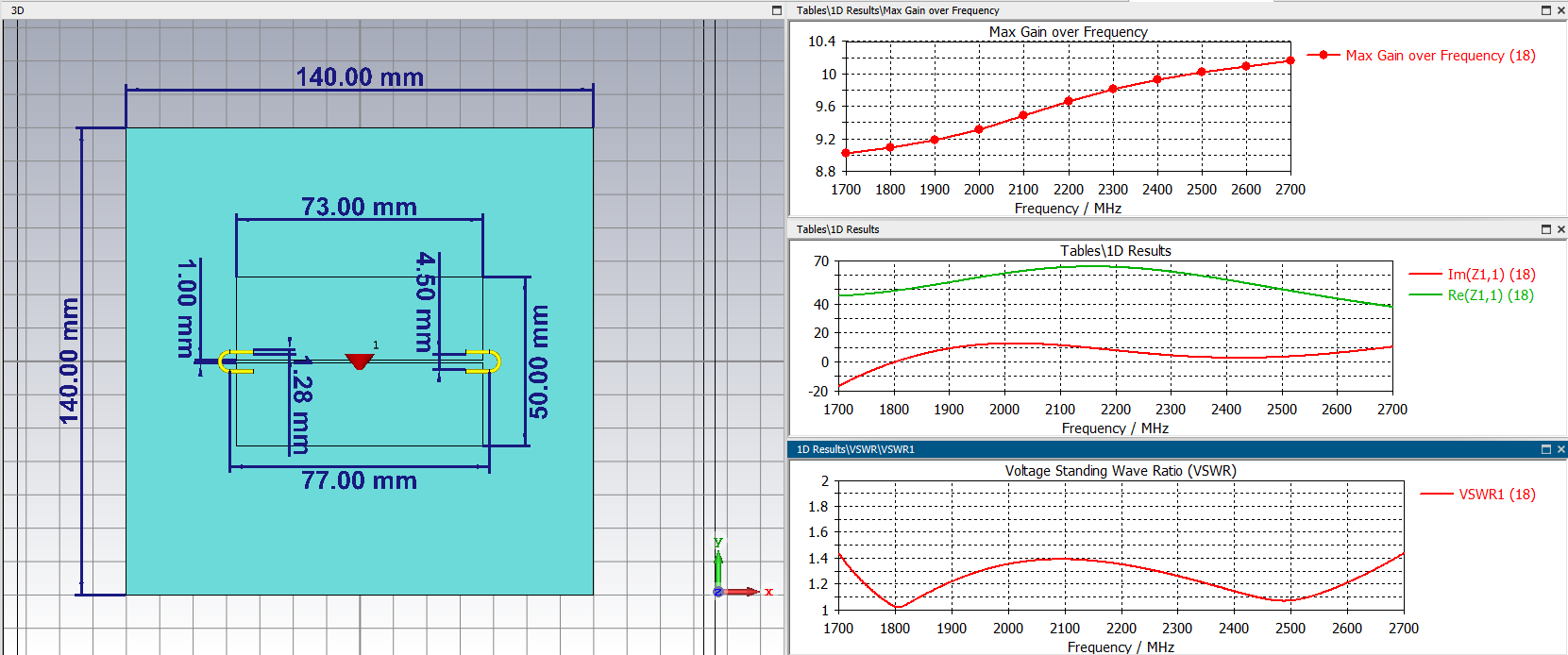

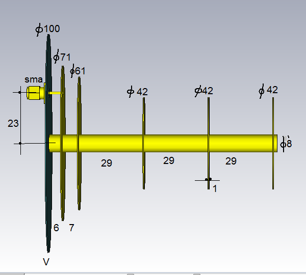

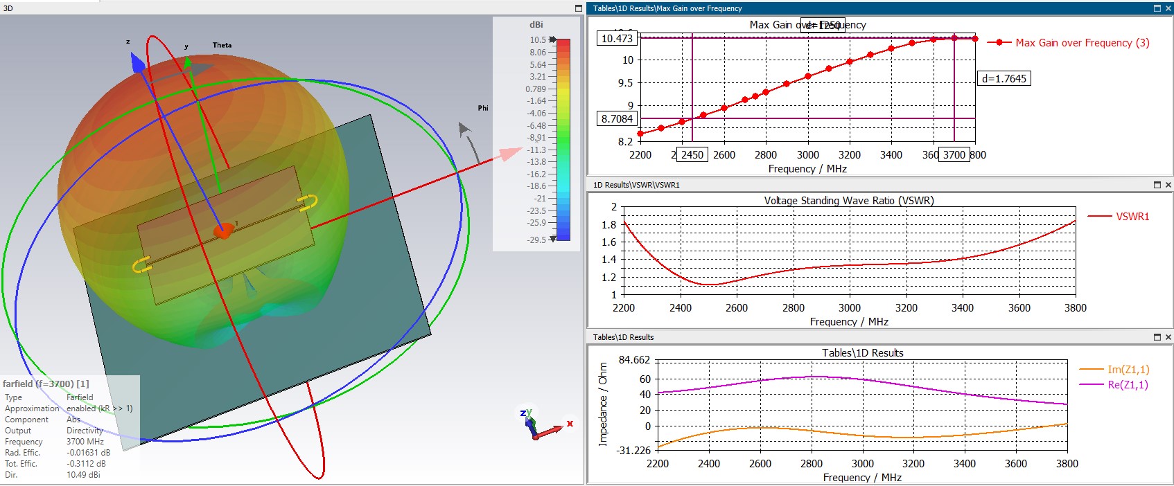

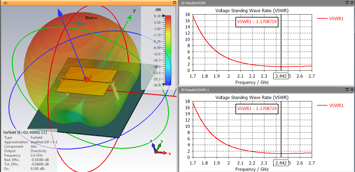

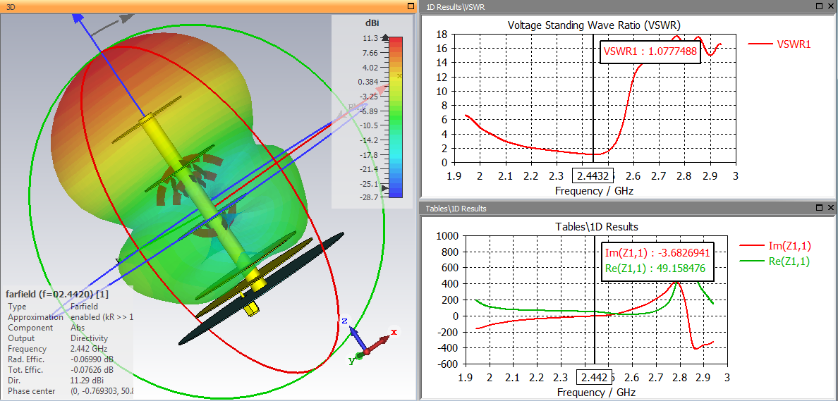

Harry36, with your dimensions, the antenna does not have VSWR <-1,2-1,4 on the frequency band 1,7-2,7MHz....!!!
If you want you can post your cst file....!!!

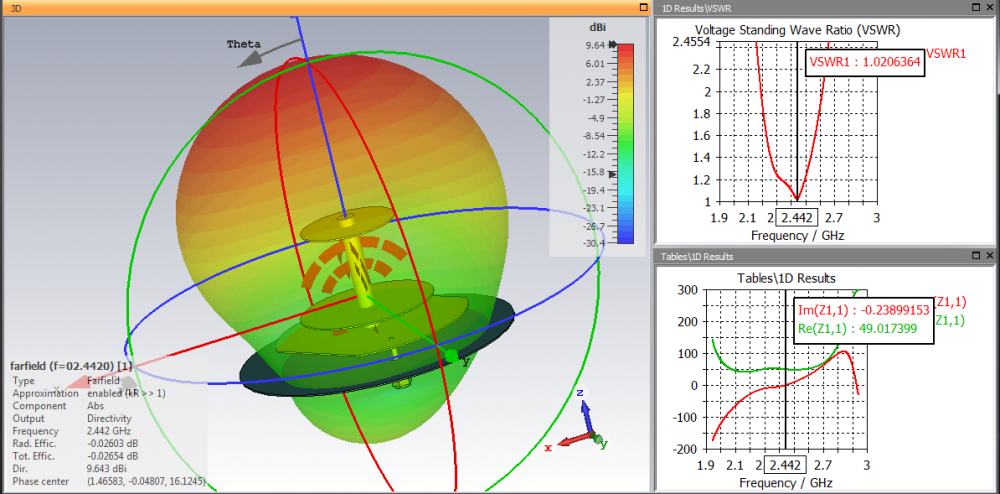

how much will it turn out? 18 how are you? I will not give you the cst files, you are not linking to the original source and posted earlier than I requested. It makes no sense to talk about the final dimensions of the antenna without detailing the power port. Draw a real cable and the characteristics will change.
Using your dimensions, you get an antenna for the range 2200-3800 by SWR2. Realizing that at the beginning of the range we have the lowest gain, you knowingly doom the user (2.4 GHz) to a loss of power.(1.75 dB).
For antennas of this type, for use in a narrow frequency range (wi-fi 2.4), it is more advantageous to match at the end of the range in order to obtain maximum gain.

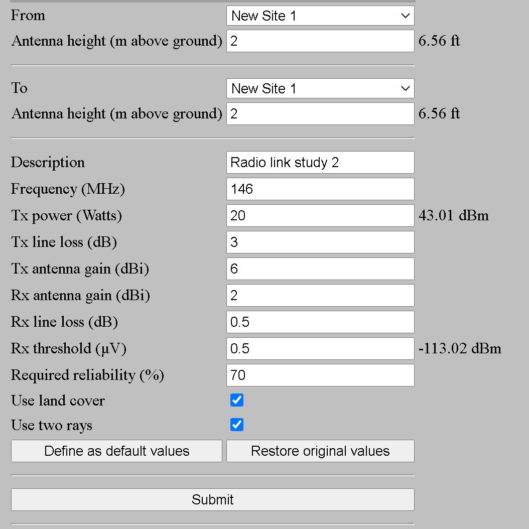

In order to build a connection for 10 km, you need to understand the physics of wave propagation and know a little about geometry. The range is 10 km - over the horizon. Even if we take an ideal “flat” terrain, the horizon for the observer will be at a distance of ~ 5 km. For a line of sight at a distance of 10 km, both points must be raised ~ 8 meters above ground level. If there are obstacles in the path of the link, then the transmitting and receiving antennas must be raised higher. But there are also Fresnel zones that allow you to receive a signal and "without line of sight." Antenna selection should be started by surveying the terrain at the link site and calculating the link budget. By budget we mean not financial resources, but the power of transmitters, antenna gain and losses at a distance. There is a very good service for calculating the link budget. http://www.ve2dbe.com/rmonline.html
try to figure it out and then it will become easier with the choice of antenna.

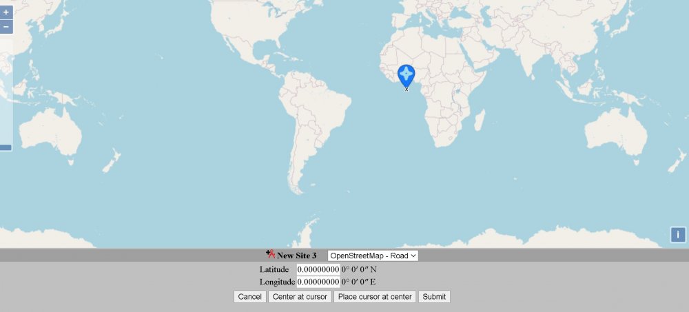

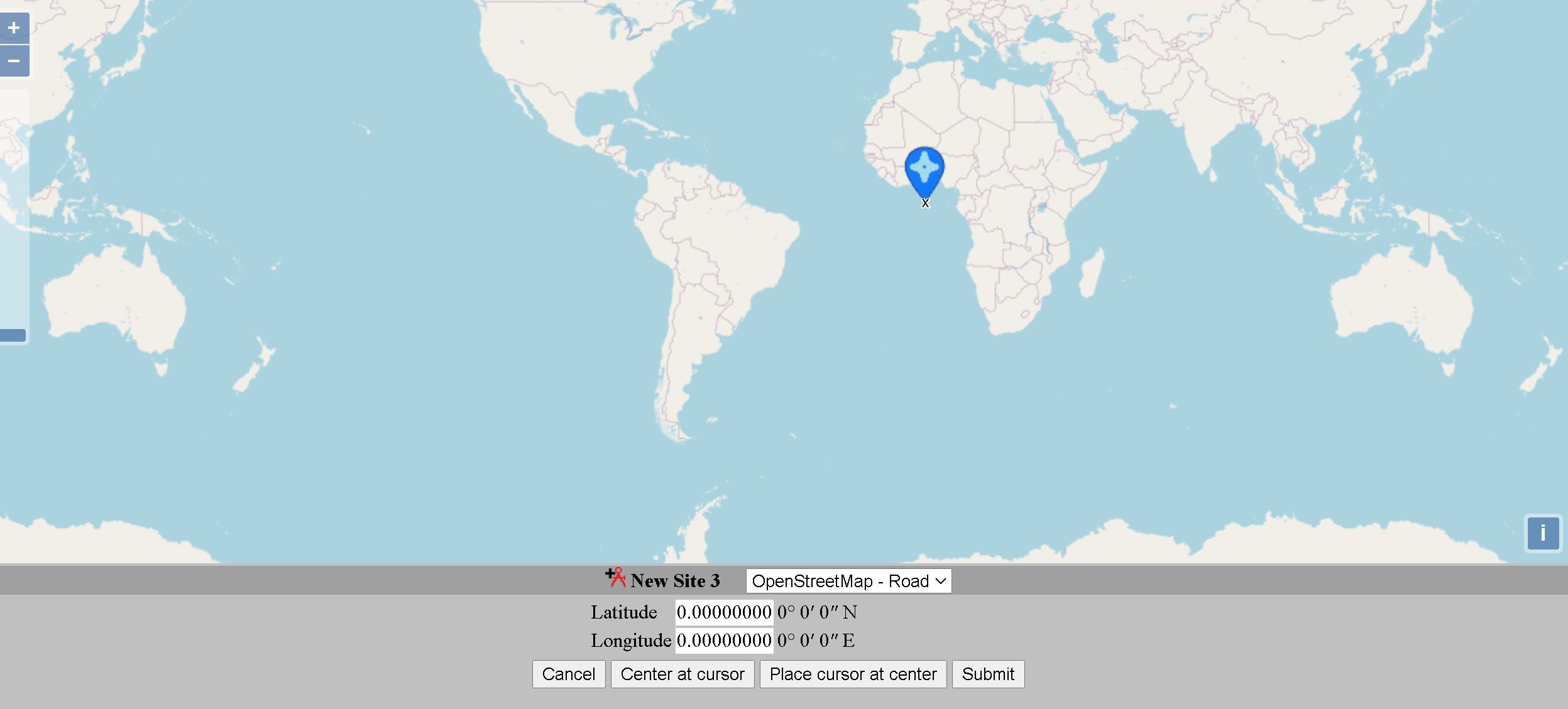

You need to locate TWO points in map (New Site  1 and New Site 2) + this info
