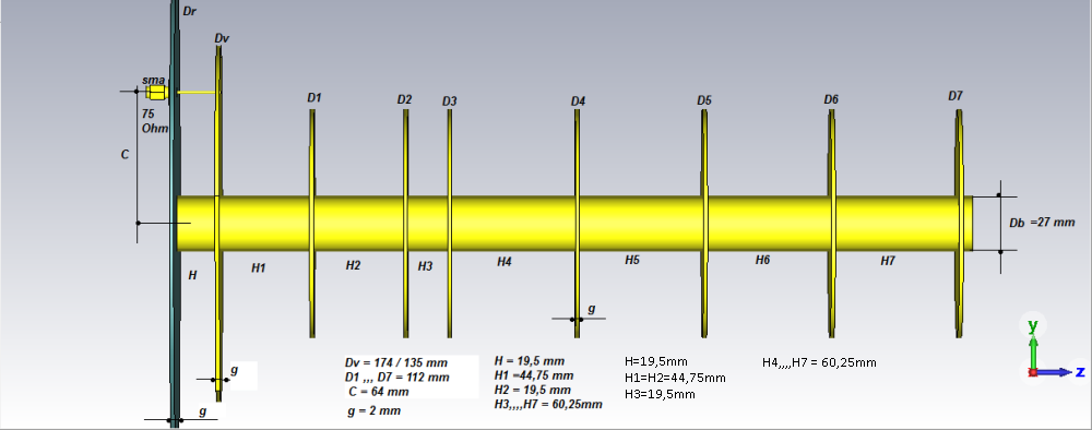

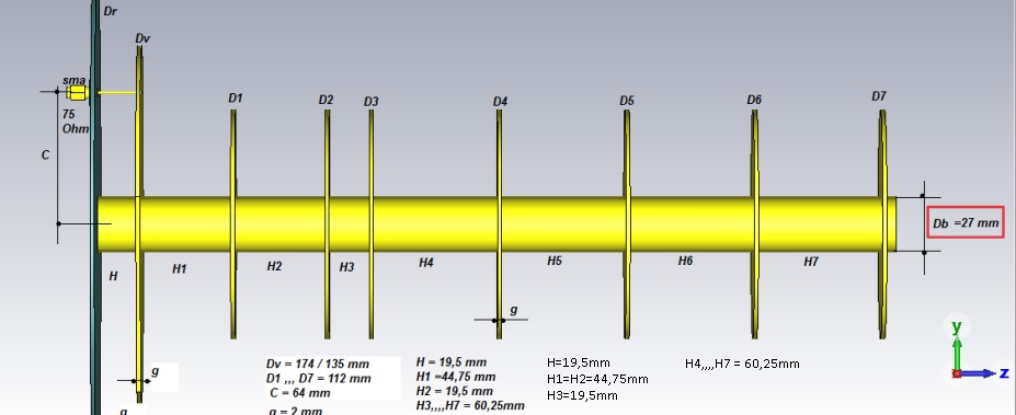

Hello!
Is the decrease in the size of "Db"? Suppose to make it not 27mm, but reduce to 8-10mm. How can this change affect the characteristics of the antenna? What material can we make this element?
Edited by askot
,,,yes, it is possible and the characteristics of the antenna are not changed too much...!!!
,,,any material (pipe) other than the insulator...!!!
OK. Thank You!
On 24.06.2023 at 00:33, Admin said:
Is it possible to use 2 cables for the antenna?
,,,yes, it is possible, but the isolation between the two ports is not good, so two antennas with different polarizations(Horizontally+
Vertical) would be preferable...!!!
,,,да, это возможно, но изоляция между двумя портами плохая, поэтому две антенны с разной поляризацией (горизонтально+
вертикально) будут предпочтительнее...!!!
And at what distance should they be placed?
,,,here, on this forum, you will find what interests you...!!!
