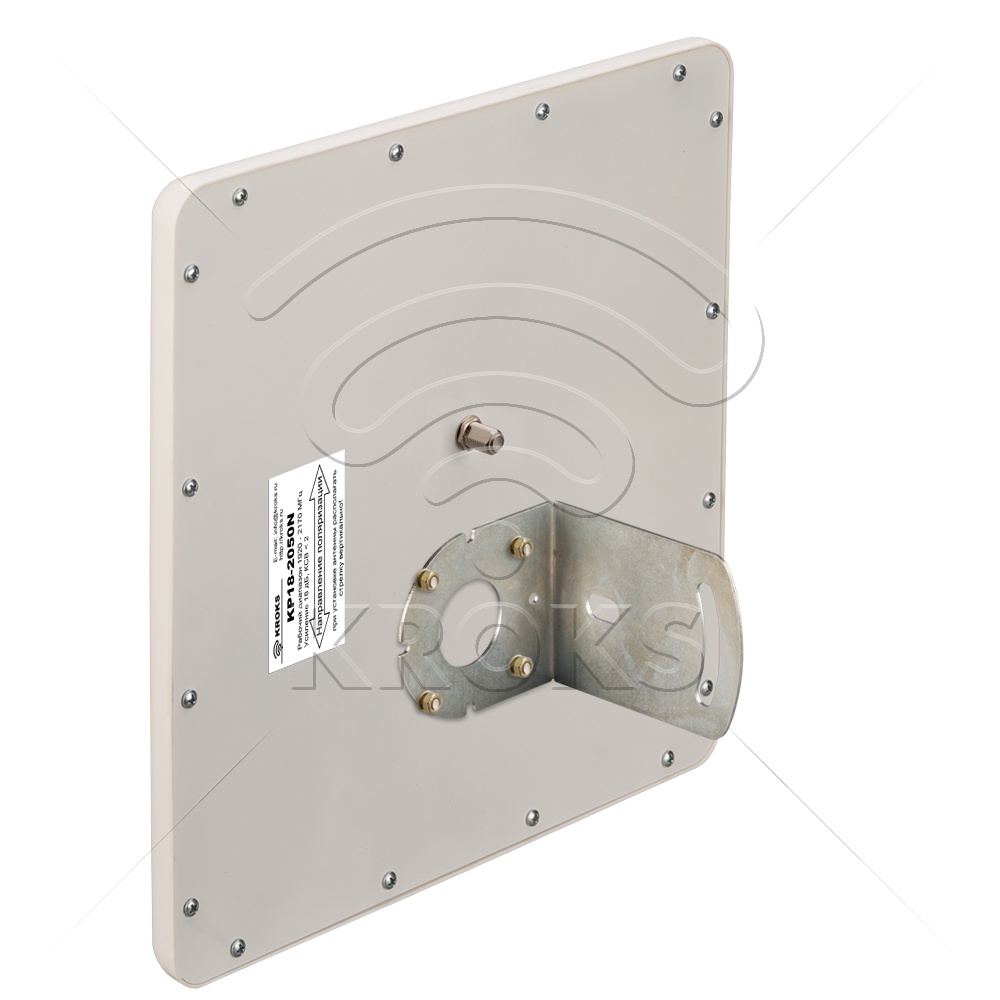

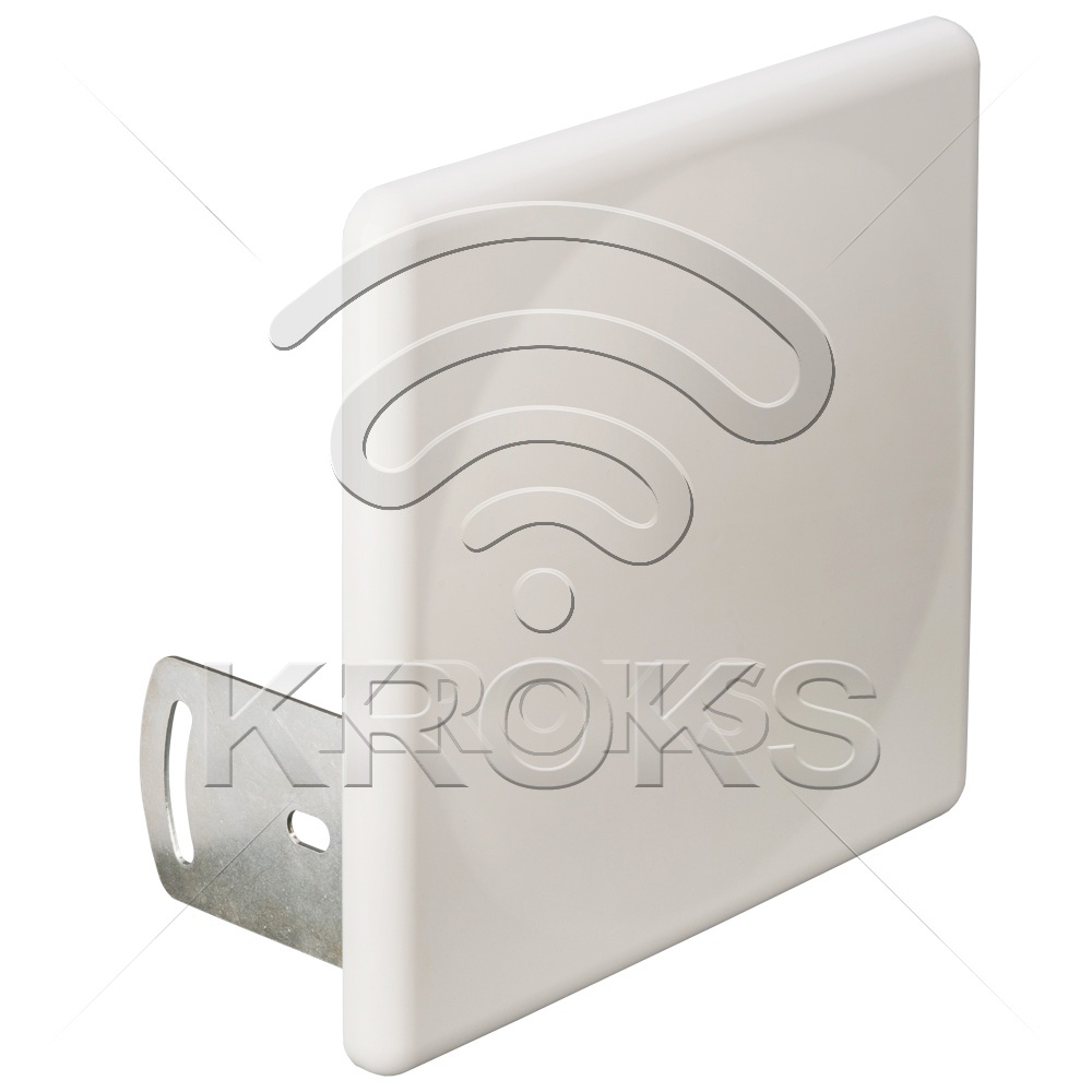

Directional 18 dB panel 3G antenna KP18-2050

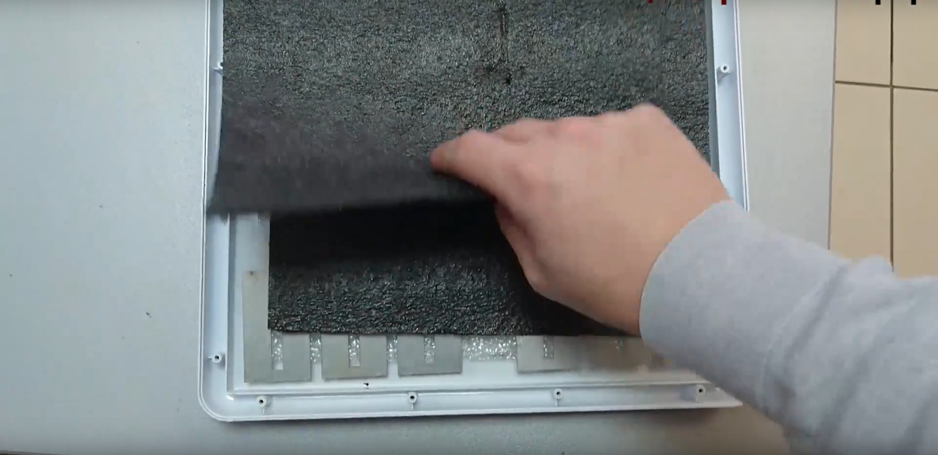

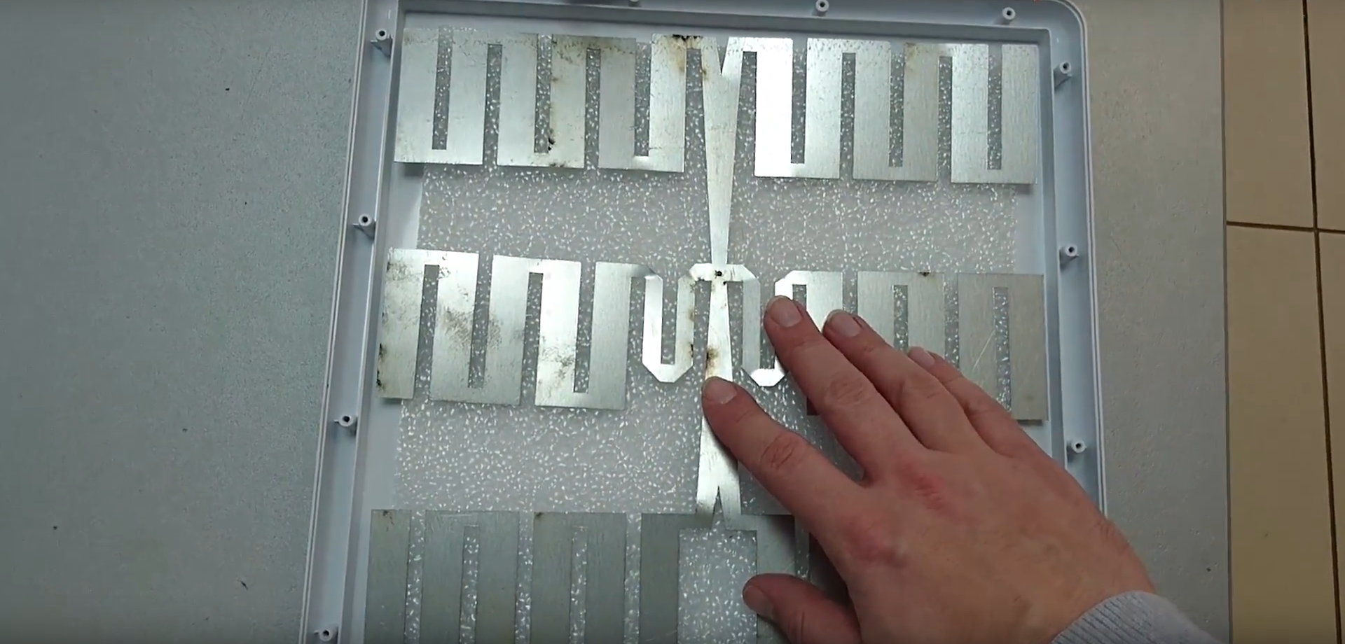

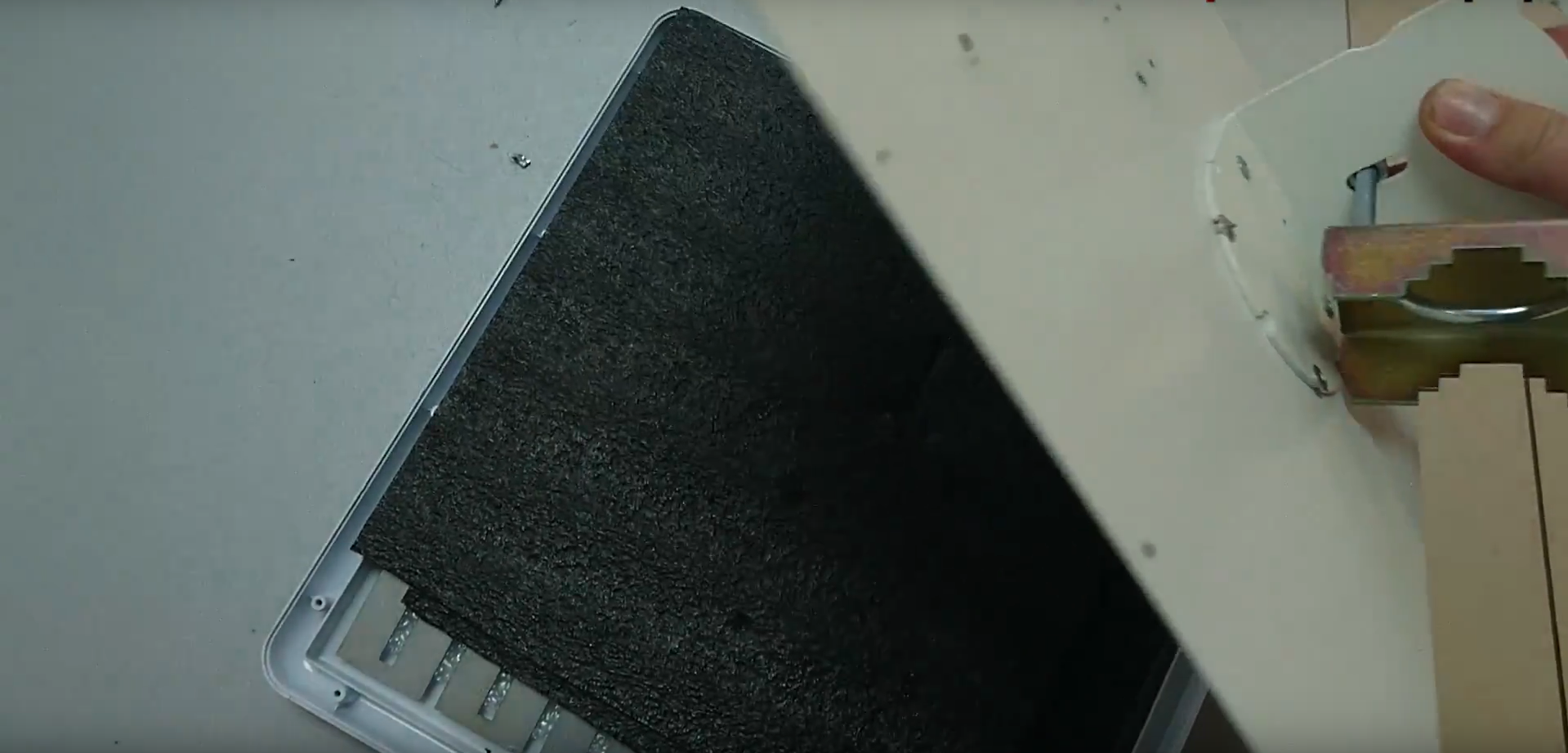

Very interesting concept of summing  three open meander dipoles.
Each dipole resonates in a certain frequency band.

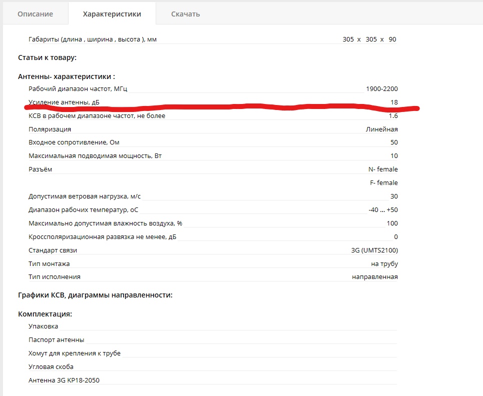

But I have great doubts about the 18 dBi gain.
However, we calculate the gain of a meander dipole with a finite reflector can not reach that value.
Yes, they can write everything they want.
Anyway, it's good for marketing

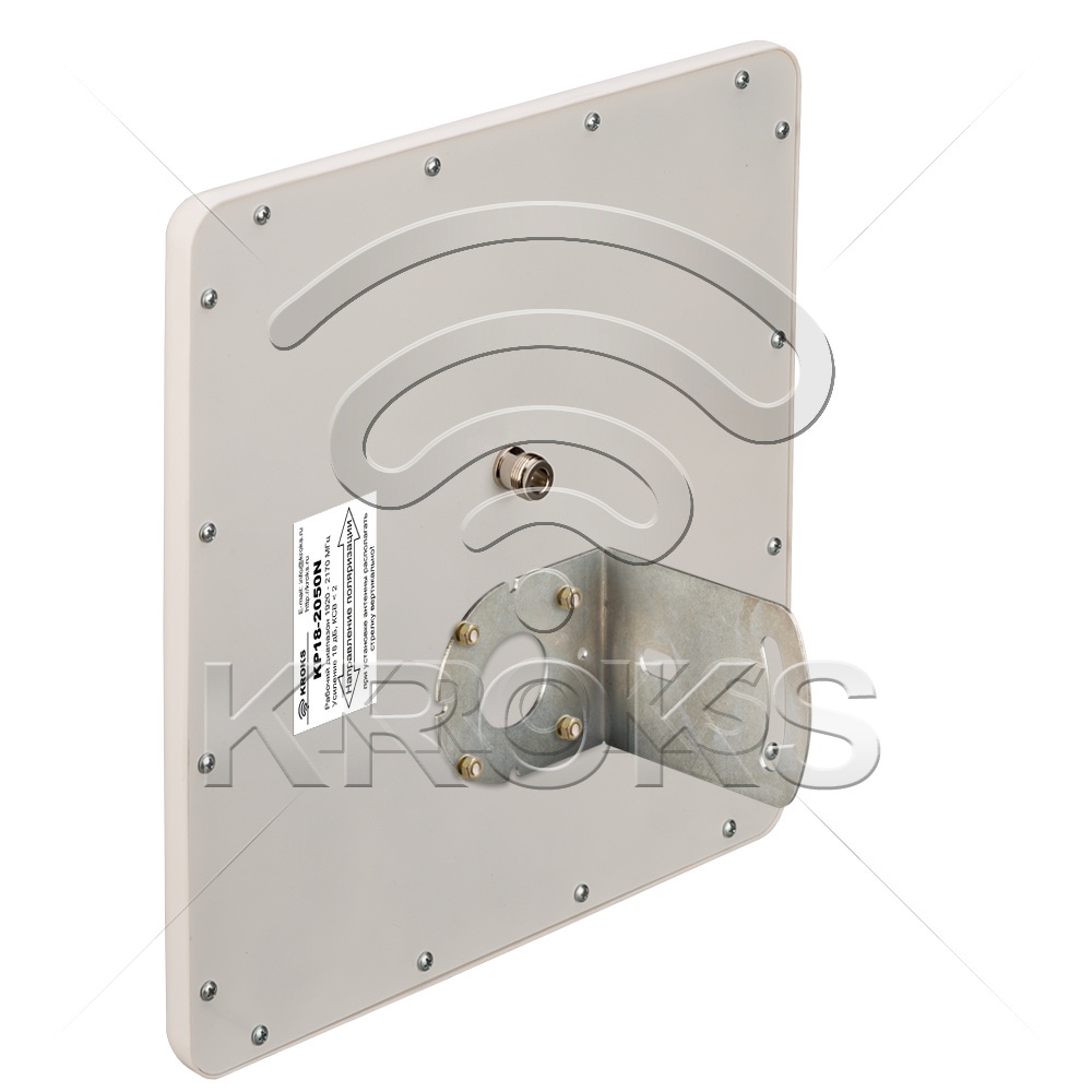

Dimensions...? anybody...

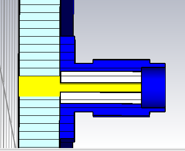

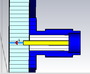

JOMY , i've tried making  the inner wire longer...didn't work (i'm pretty sure mi solver settings and/or port are to blame) Sooner or later i'm gonna get the hang of it...
