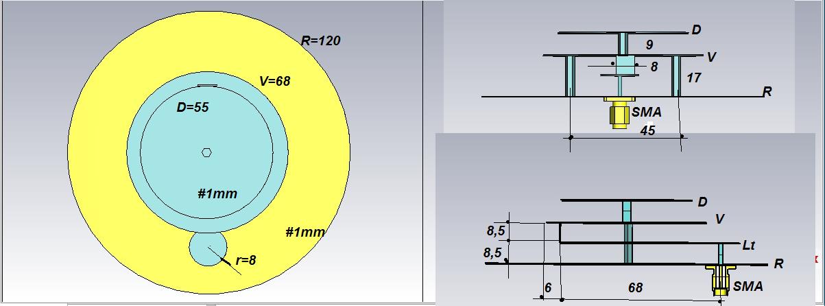

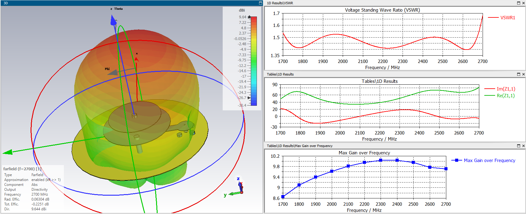

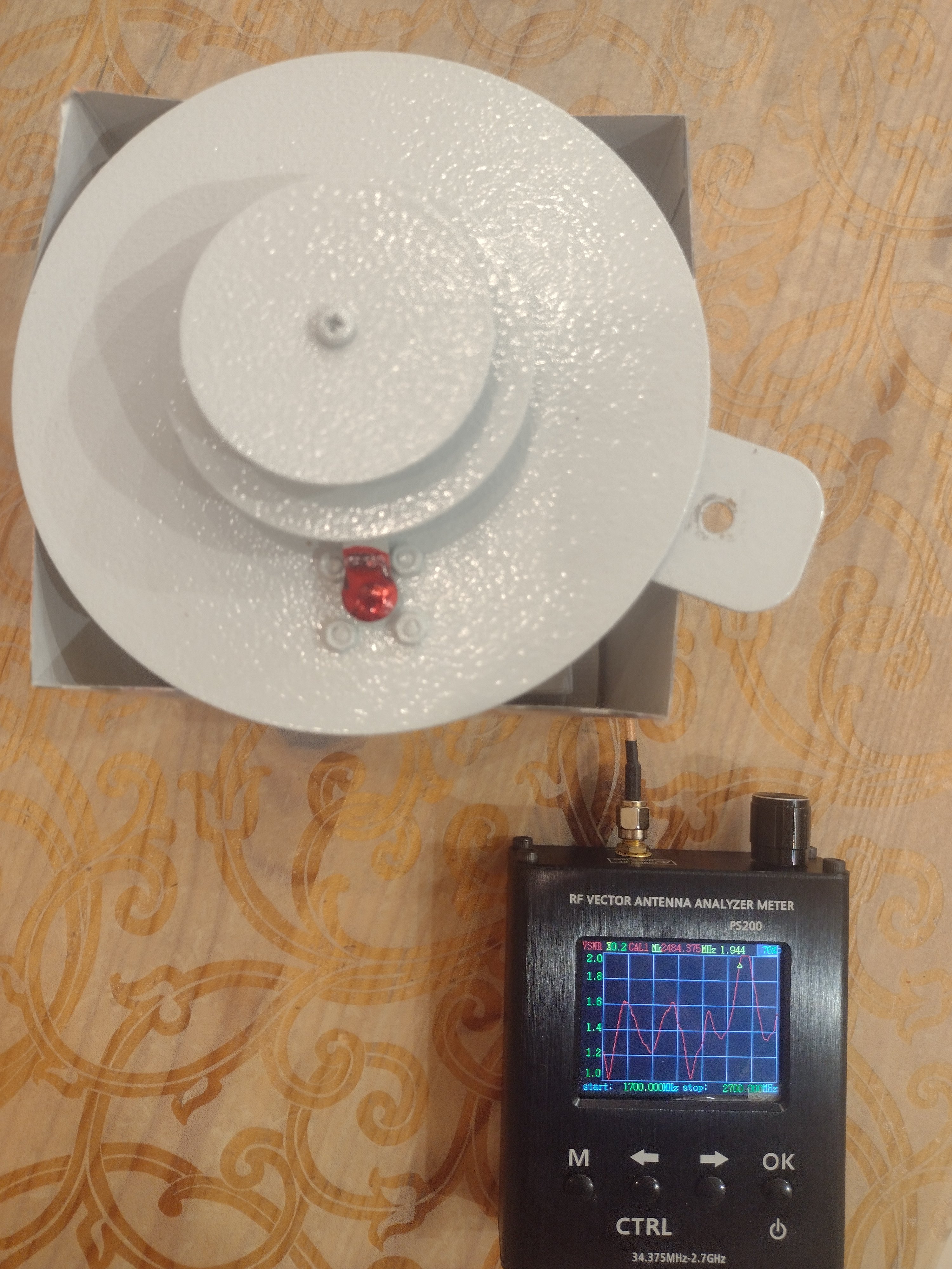

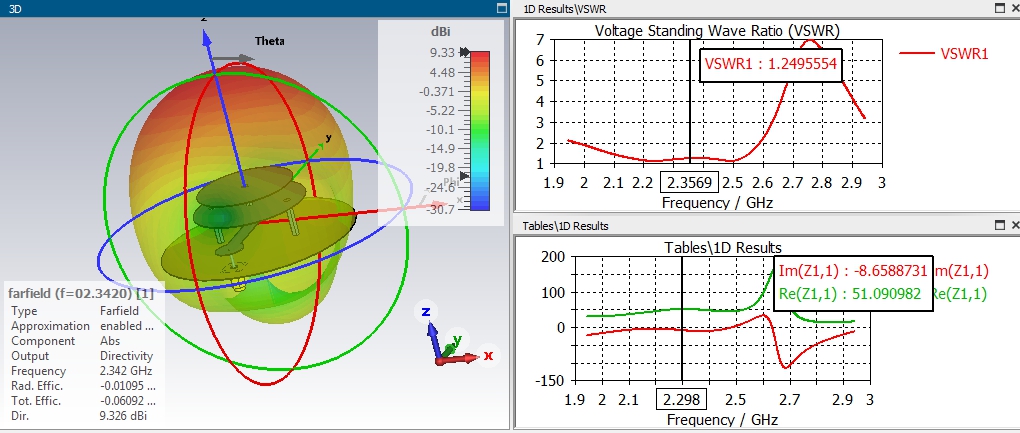

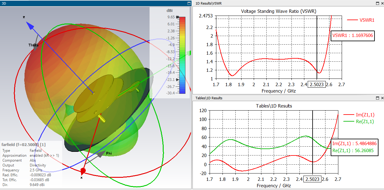

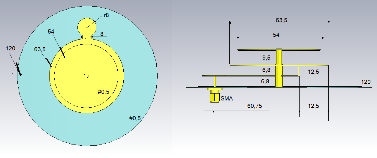

I took over the redesign of this antenna and I came up with this version...
