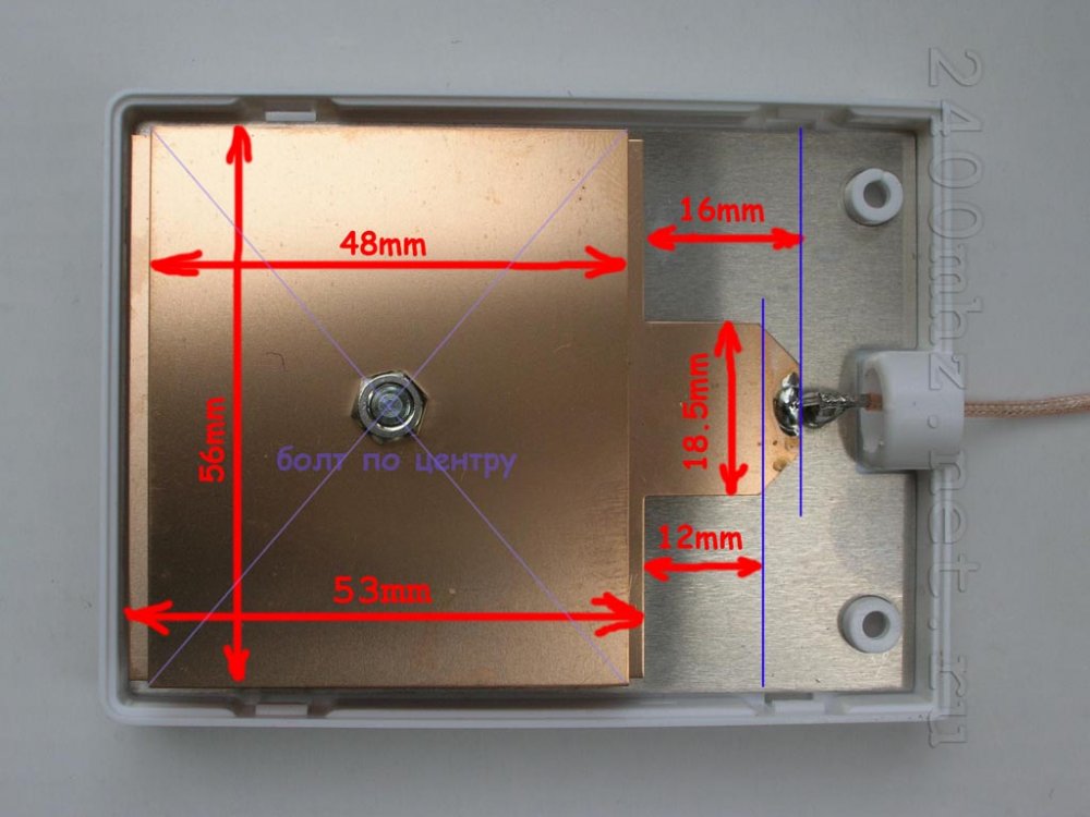

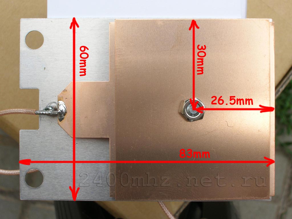

Let's make the next copy of the antenna..
Caracteristicas:
Conexion: por cable RG-178 a RP-SMA.
Frecuencia: 2,4 ~ 2,5 GHz
Impedancia: 50 ohmios.
Ganancia: 10 dBi a longitud de cable "0"
Polarización: Lineal
Dimensiones: 100 x 65 x 30 mm
Material: cobre (bronce) de 0,5 mm de espesor.

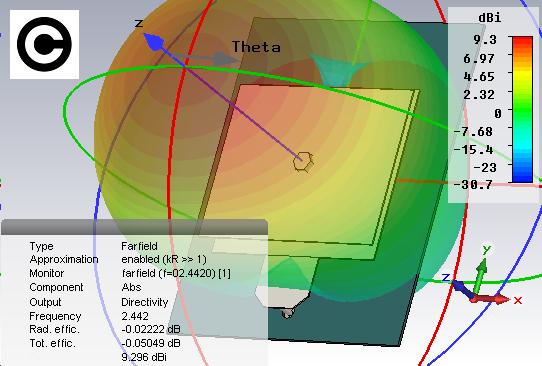

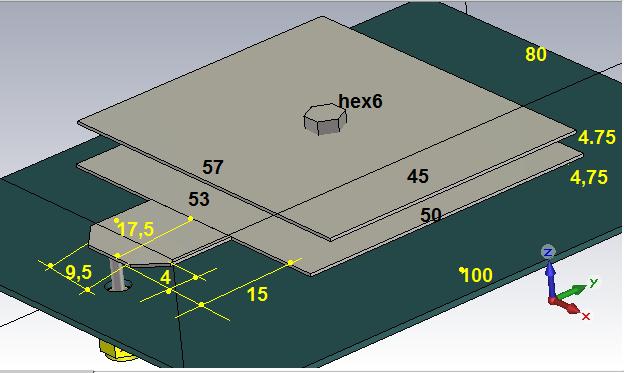

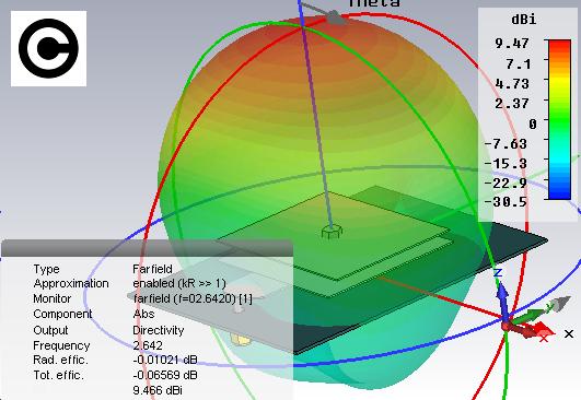

,,,only if the reflector is increased to 80X100mm...

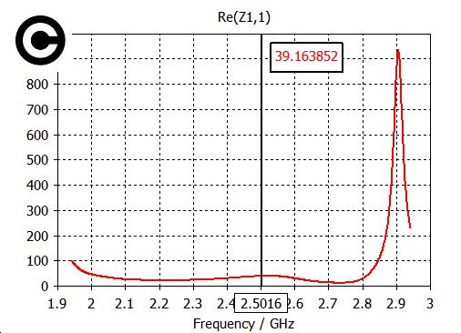

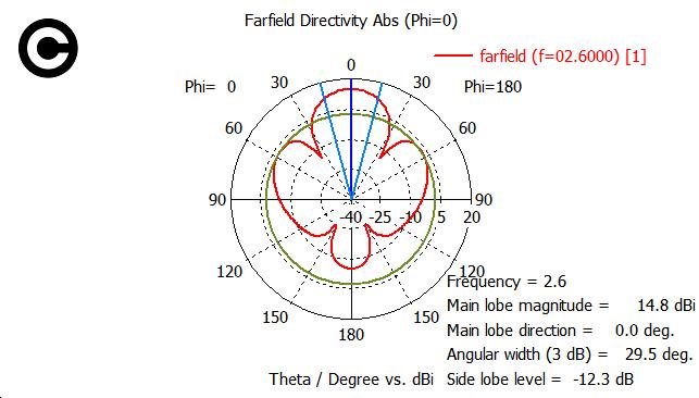

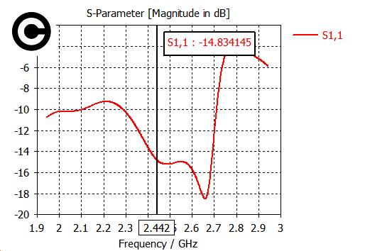

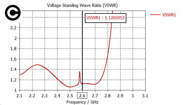

14 minutes ago, garry said:

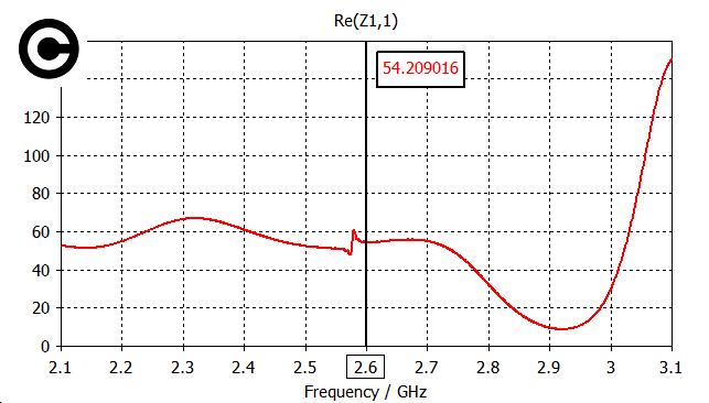

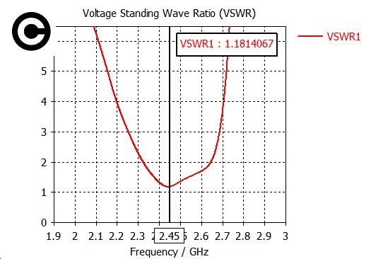

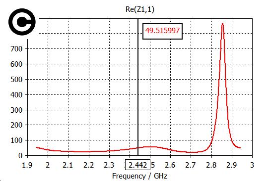

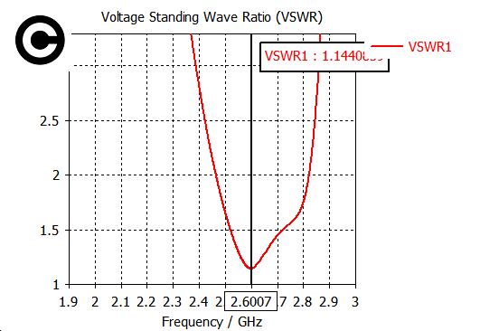

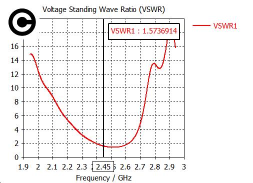

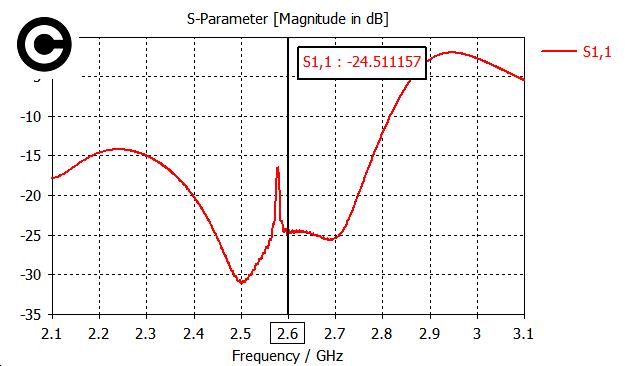

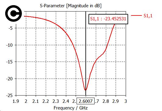

Is this design change acceptable for the 2600 MHz frequency?
Yes, it can ... !!!
About that could be, with the same reflector ...
I was a bit hasty, but the Director can be cut to size in the drawing.
And... that's what happened, the test will come when my 4G modem.

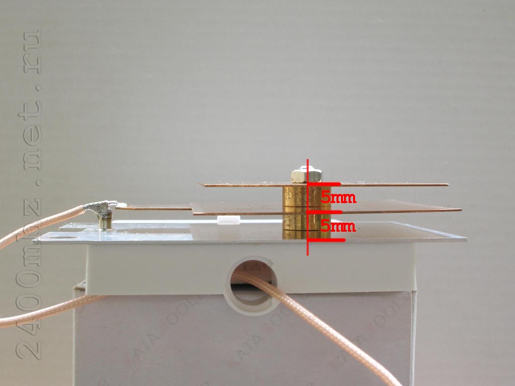

,,,both the director and the vibrator must be shortened, the height instead of 5mm comes 4.75mm...!!!!
The height of the M6 nut was 5 mm. Wiping it, I achieved the thickness of the nut 4.7 mm, more precisely I can not measure.
,,,it"s okay...!!!

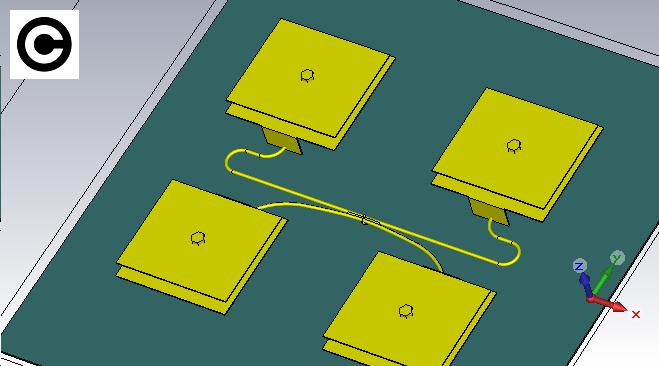

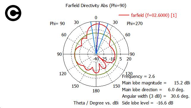

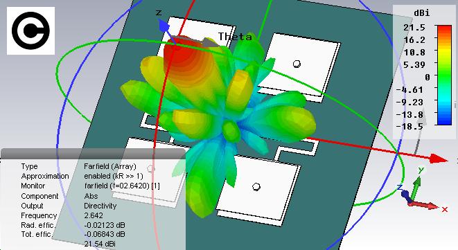

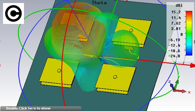

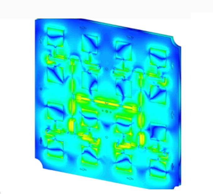

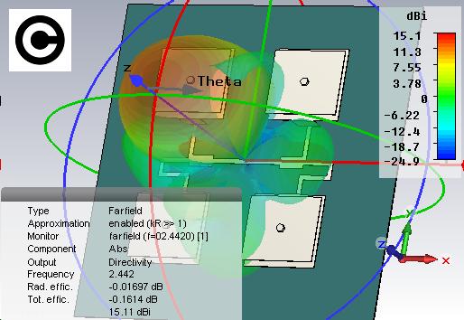

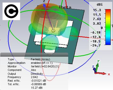

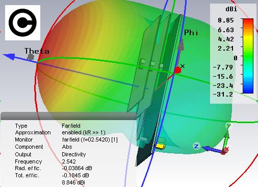

,,,if you make a panel with 4 such antennas, it will be the gain in directivity (15dBi)...!!!
This design is not difficult to repeat. Method to balance the four elements in future antenna I don't know.
Edited by garry
""", something like this ,is hard to do ...???
If the matching lines are made of copper wire, it is quite possible.
Yes, the adjustment lines are made of copper wire with a diameter of 1.5 mm,
I will try to make a project with this antenna for you...!!!
Thanks, buddy...!!! This project, I think, will be interesting to all users of our forum!

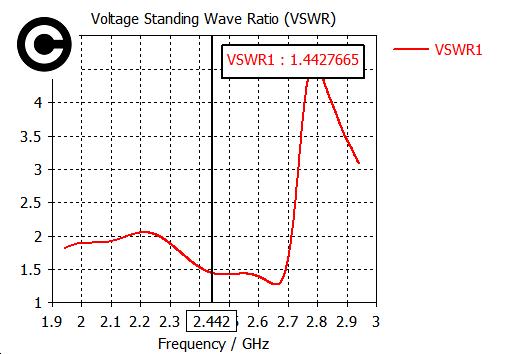

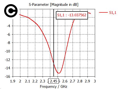

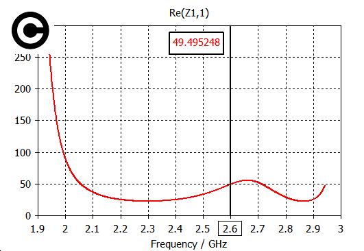

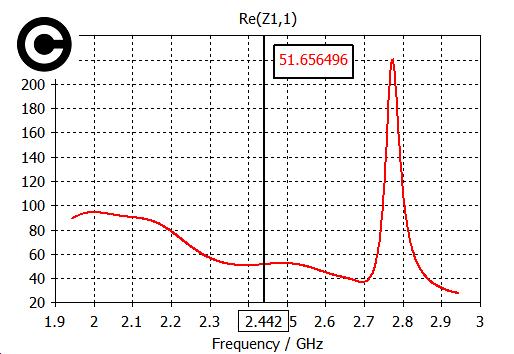

Good, it seems that the antenna works very well but I think for reducing the impedance to 50 ohms, it is necessary to modify the diameter of the copper wire
,,,and in a 4x4 panel version it looks like this...
,,, sure, it can ... !!

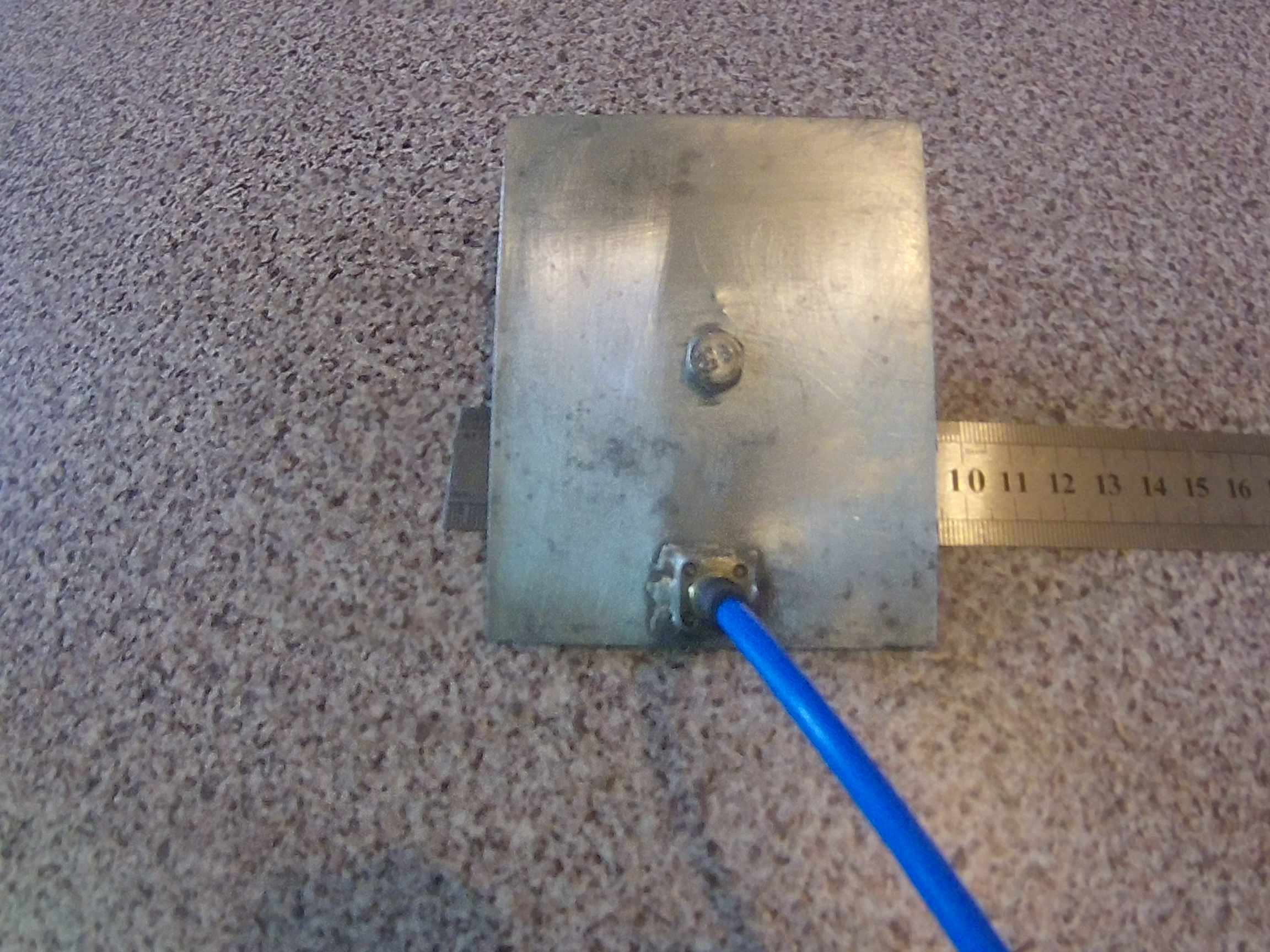

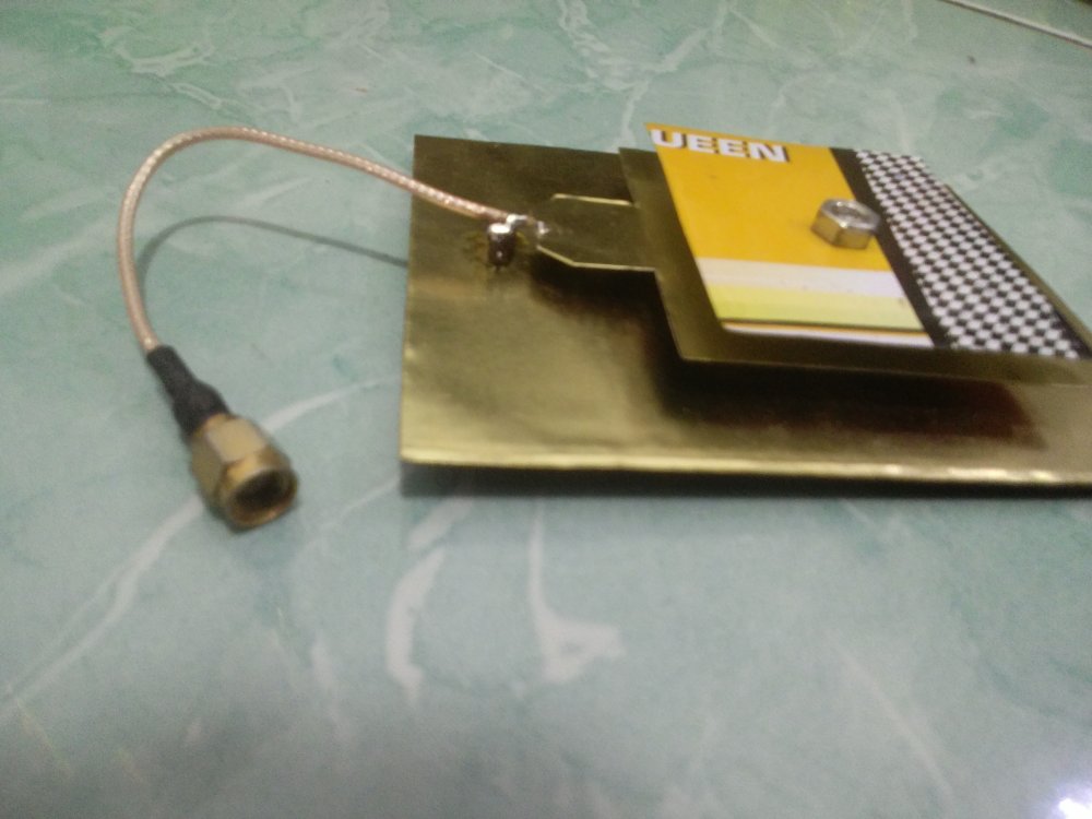

Our Bejonet user says ...
""hi friend,
i was made it, but still not good, unlucky me
i dont have any instrument for check if this antenna is working or not, just try to connected to my router and wifi signal is not good..""
"and still  I do not understand what the problem is ... !!! ???
I have this design works well. Does the SMA connector match the connector on the router? If so, I don't know what can be changed.

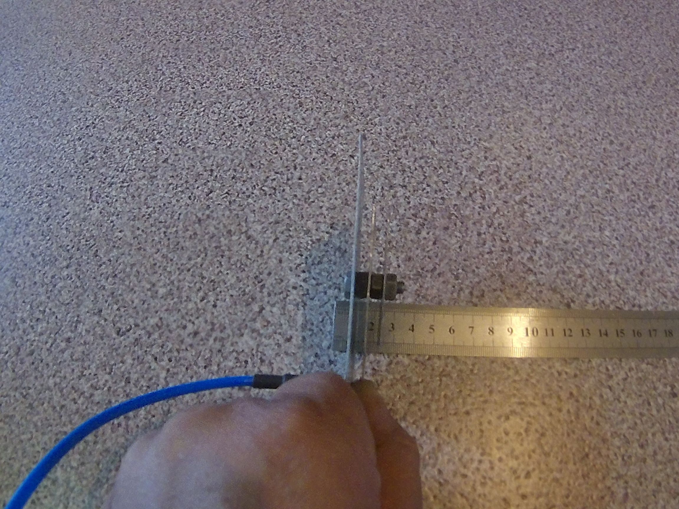

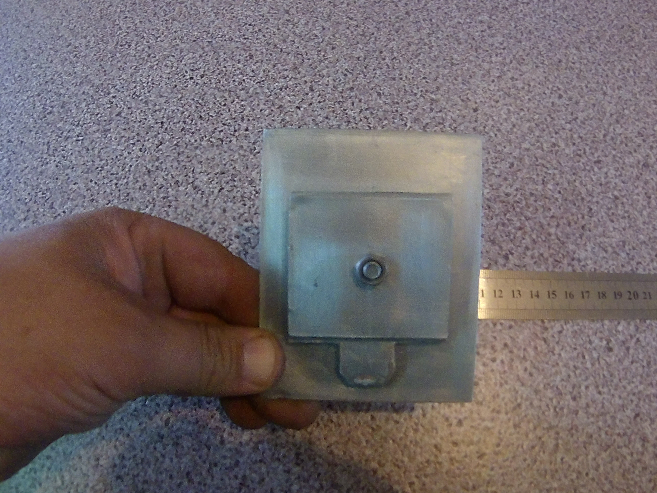

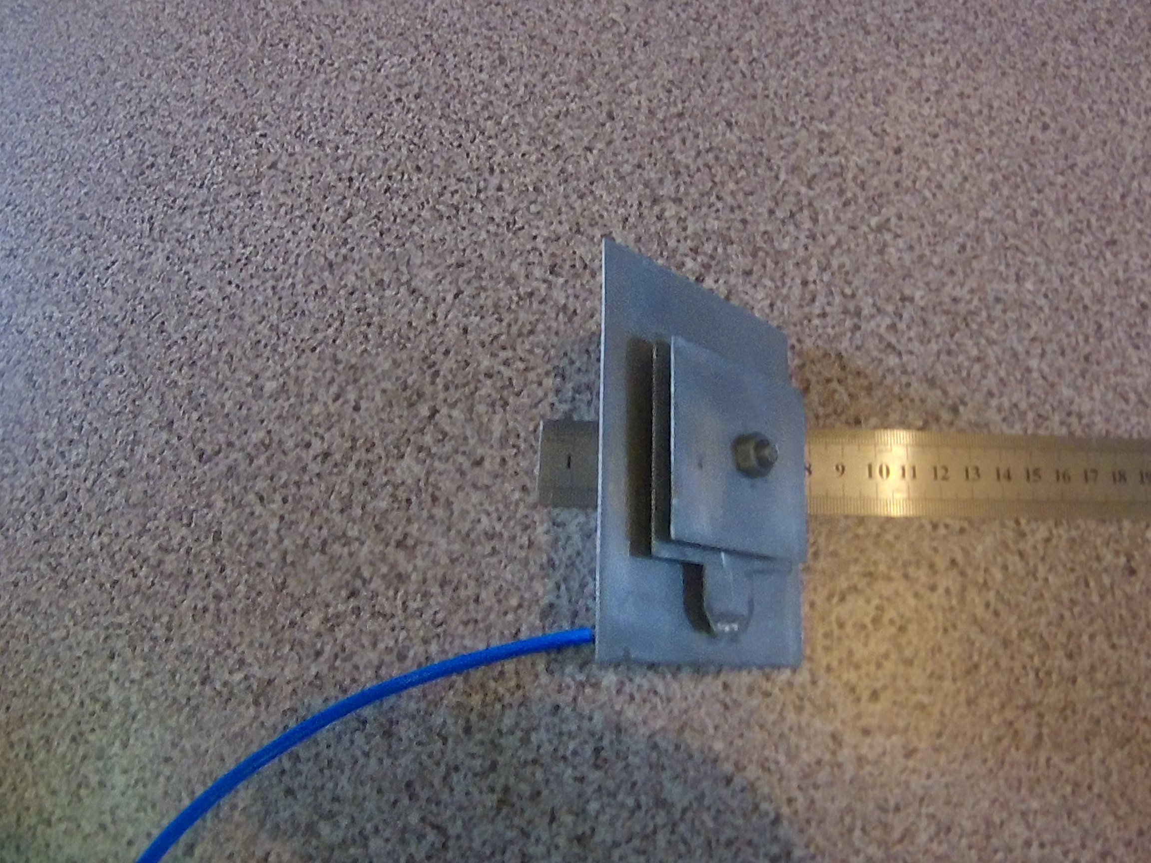

what material do you use and how thick
I think the thickness of the material is not that critical. I used galvanized steel with thickness 0.2 mm for the vibrator and the Director, reflector in galvanized steel with thickness of 0.5 mm.
my mistake have  look at the picture,  nut not to  the center vibrator and director
