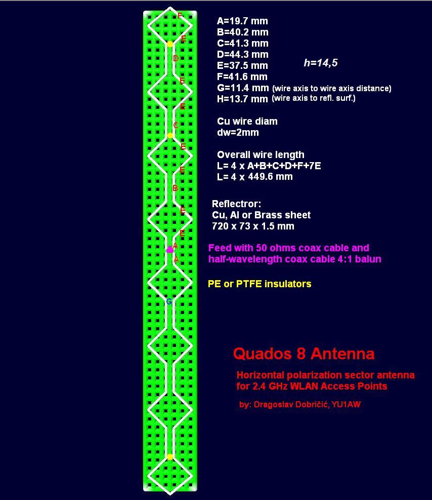

hi everyone I wanted to ask for information kindly, I built a double biquad wifi and it gives me a nice + 13db of gain. if I stretched the double biquad the db increase? there is in the sense the more squares I put together and the more power in db I have after? if the answer is yes each biquad together how many db increases? ... I would like to try to experiment a little bit of everything here
,,,hi buddy...!!!
,,,maybe try to do this...17 dBi
