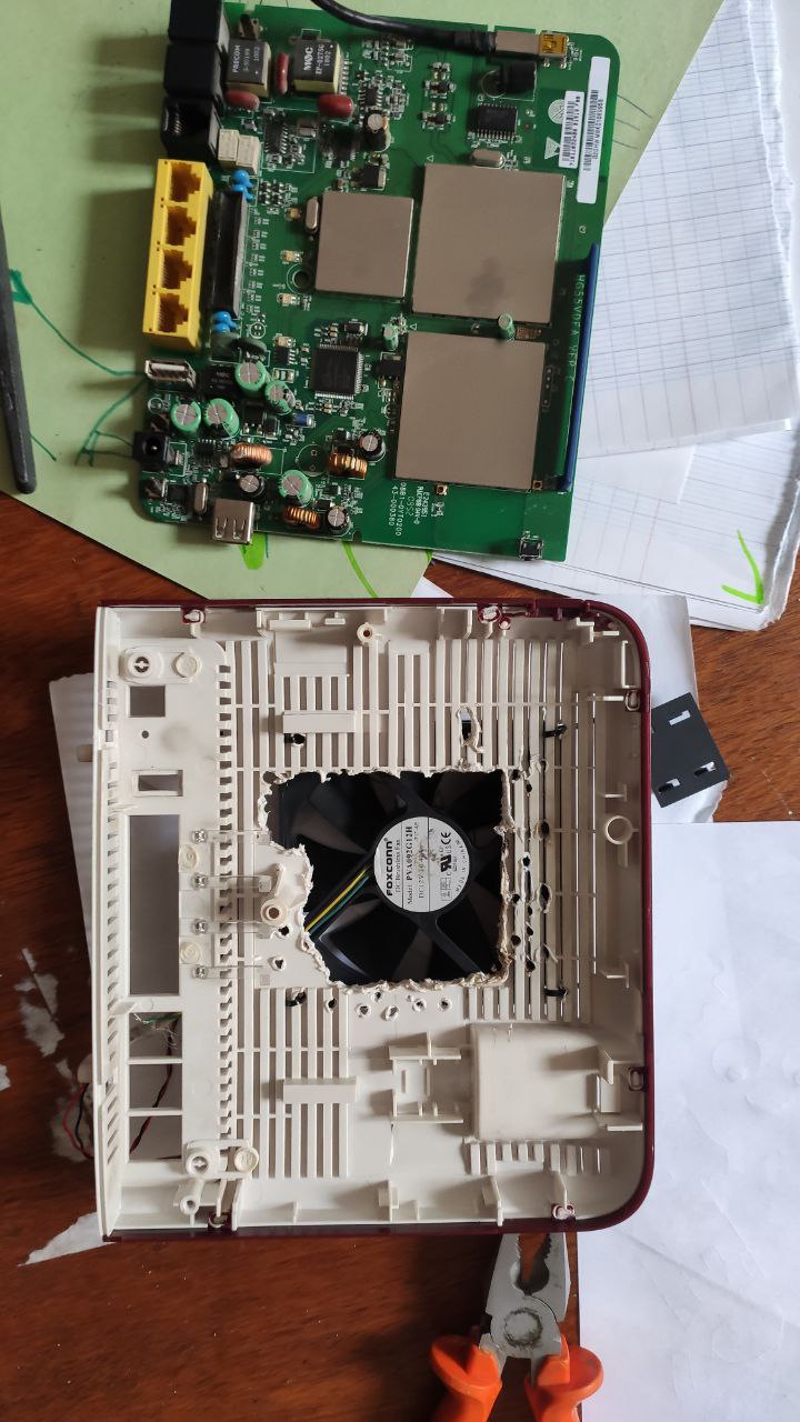

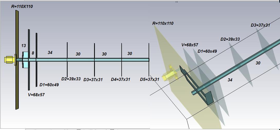

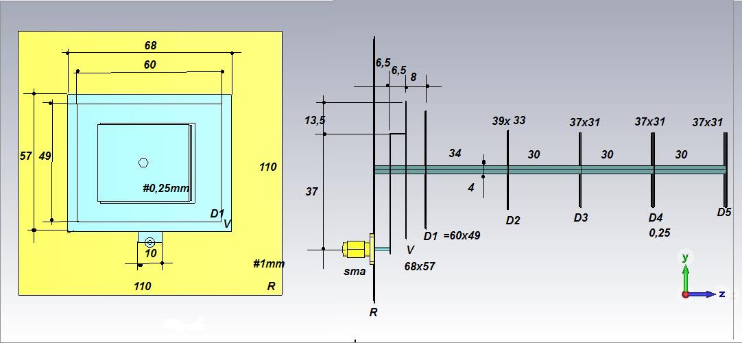

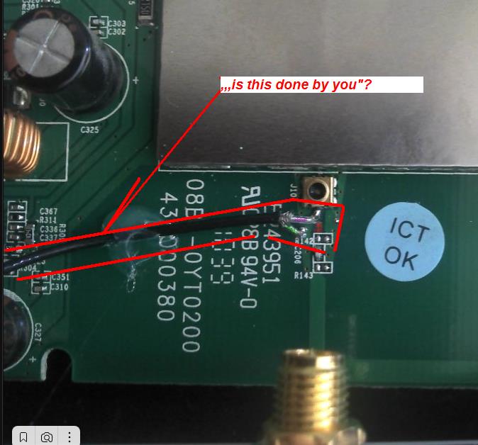

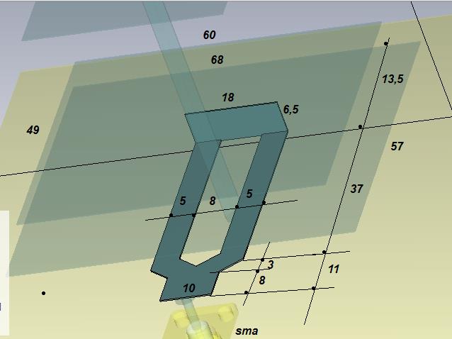

1- I want to make an antenna for my access point but i don't know if this measurements are good or no

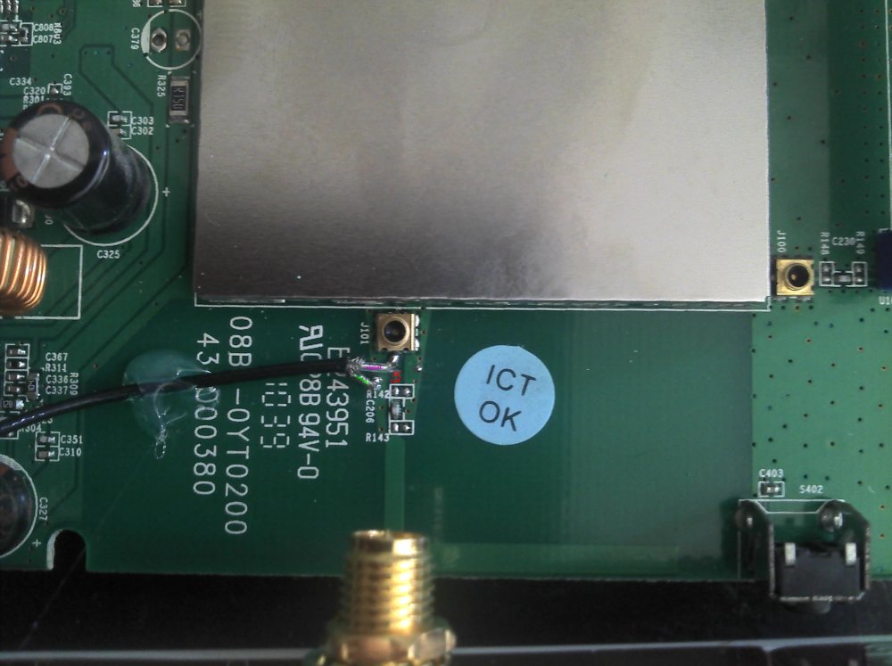

2- and also this is my access point pcb I'm going to solder it directly with no sma adapter or any coaxial cable is it going to work ??
( my access point don't have any sma port or anything )

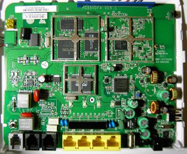

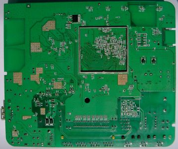

it's an huawei HG556a ver C (atheros version) I'm using it as access point with openwrt installed on it
,,,can you give me a complete picture of the inside...??
more pics

ok and what about about the antenna the measurements are good ?
,,,,for which frequency do you want the antenna...???
2.4 ghz
15 hours ago, Admin said:
,,,good, then you can run this antenna...!!!
,,,with the above connection...!!!

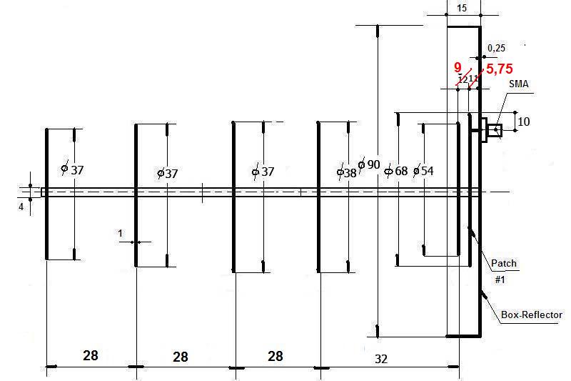

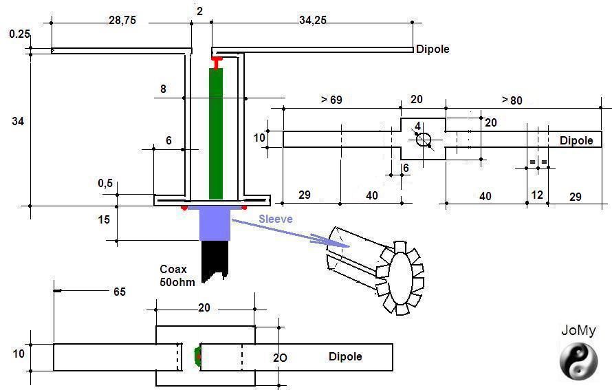

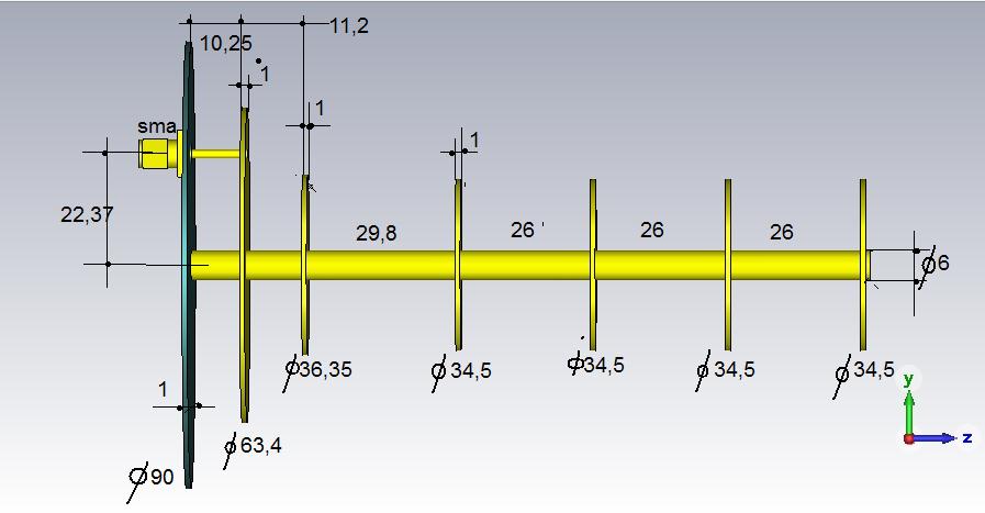

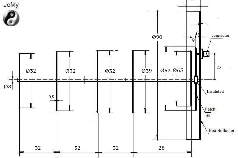

can you please give me any good yagi antenna diagram with rectangle elements not circular
11 hours ago, Admin said:
,,,see this...
hi man sorry to bother you again i was cutting the elements to 37mm but i missed them now they're all 35mm .
I'm thinking to change to this antenna is it working (32mm) ????
10 hours ago, Admin said:
,,,look more closely,,,they are all sizes...only the directors can be made of aluminum...!!!
can you please explain more it's my first time
now the director can be made from aluminum but what about the reflector?
,,,you are a child...in which class are you>>>???
lol why i asked if i can make it with aluminum??
,,,so what...??
no dimensions for that part . how to make it ?
,,,see this...
,,,maybe this will help you understand something...

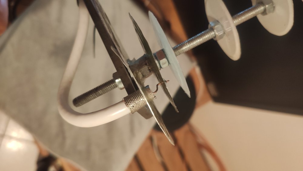

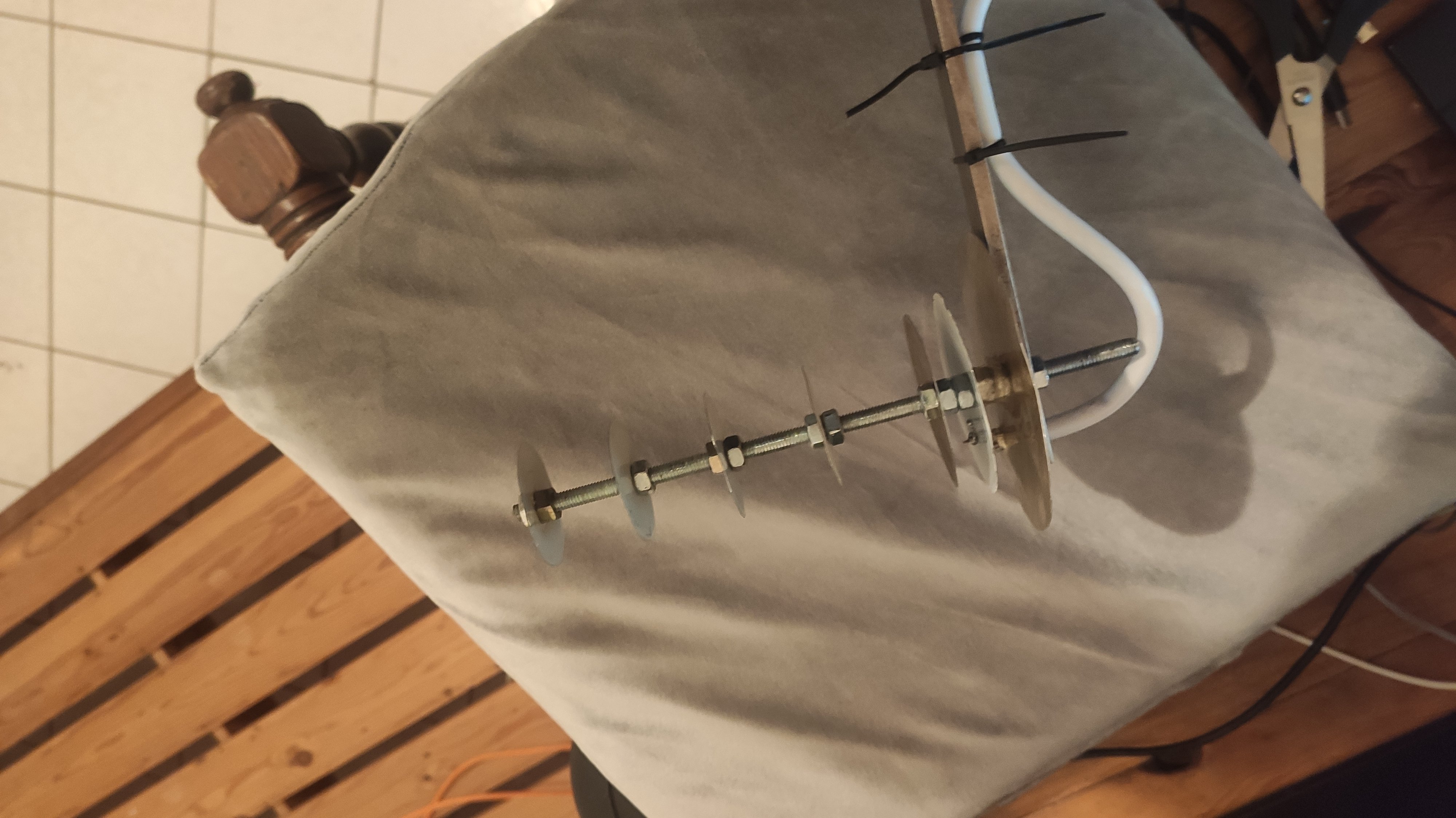

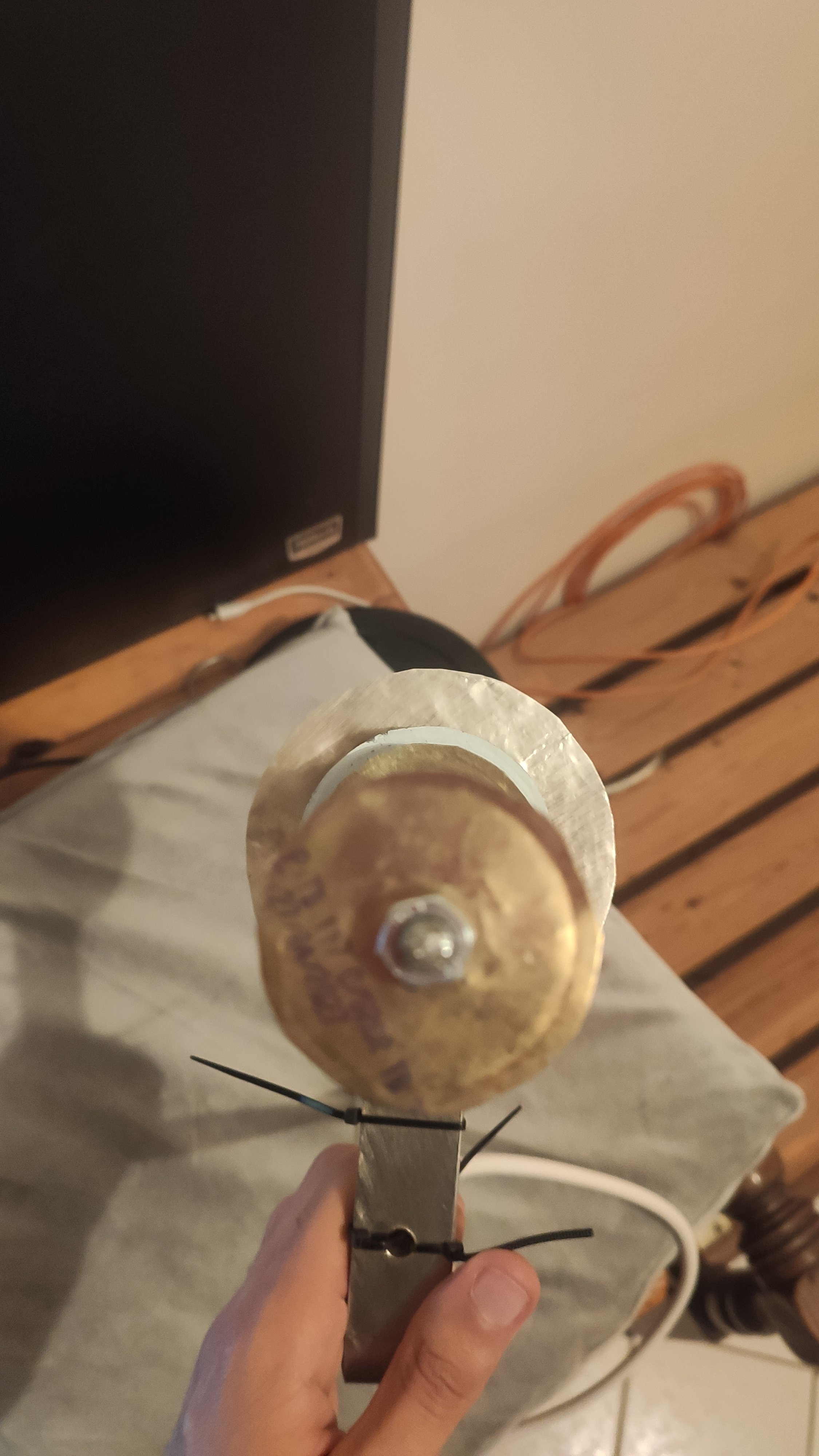

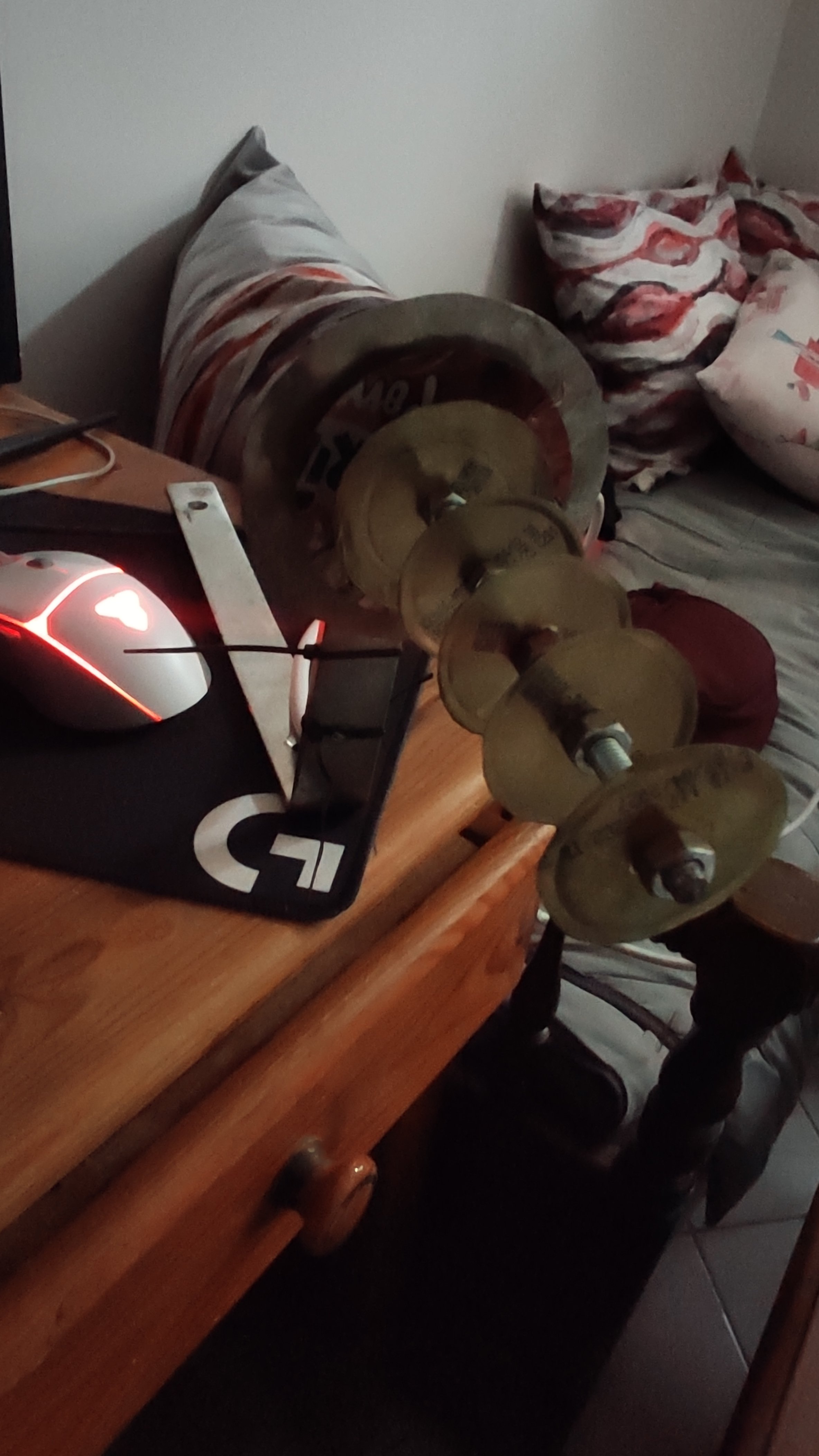

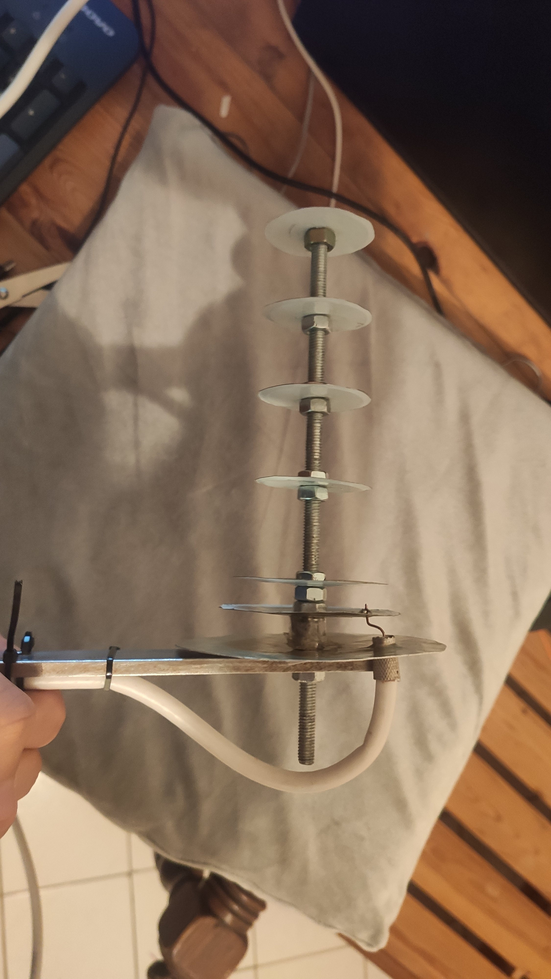

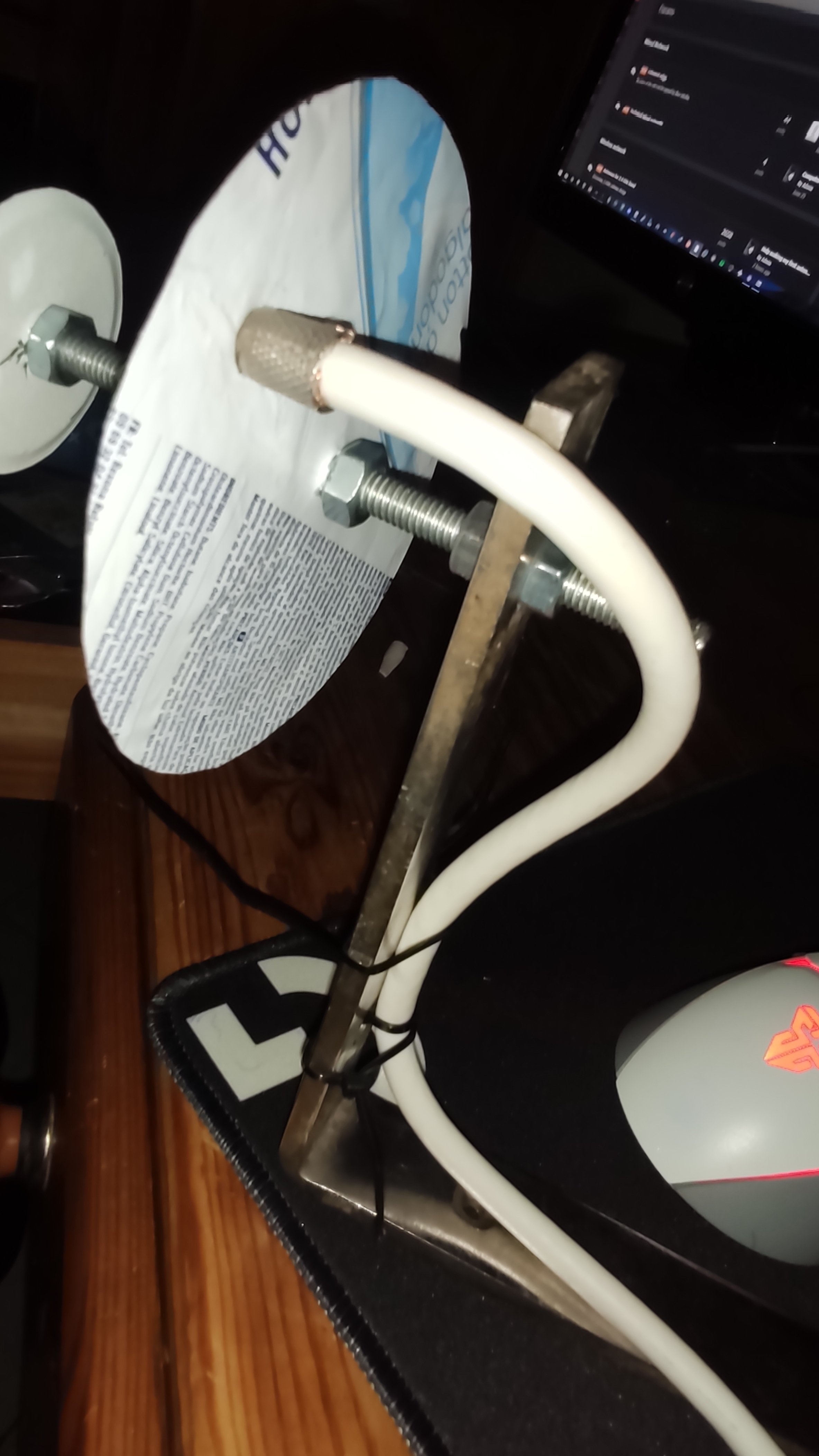

11 minutes ago, _karimhi said:

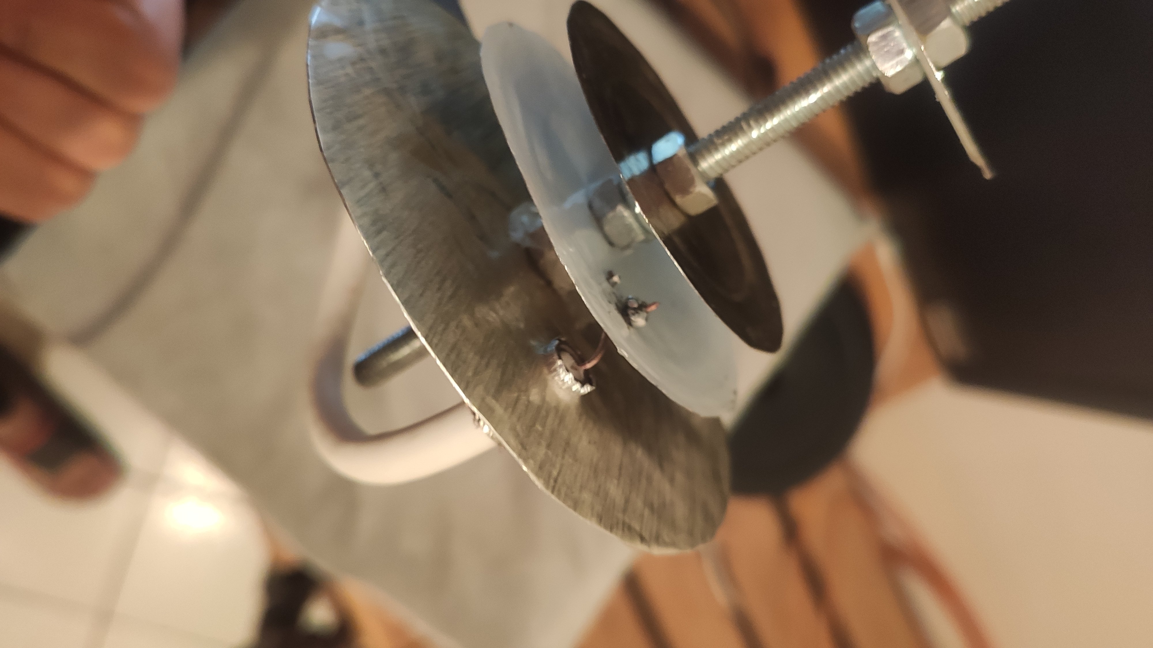

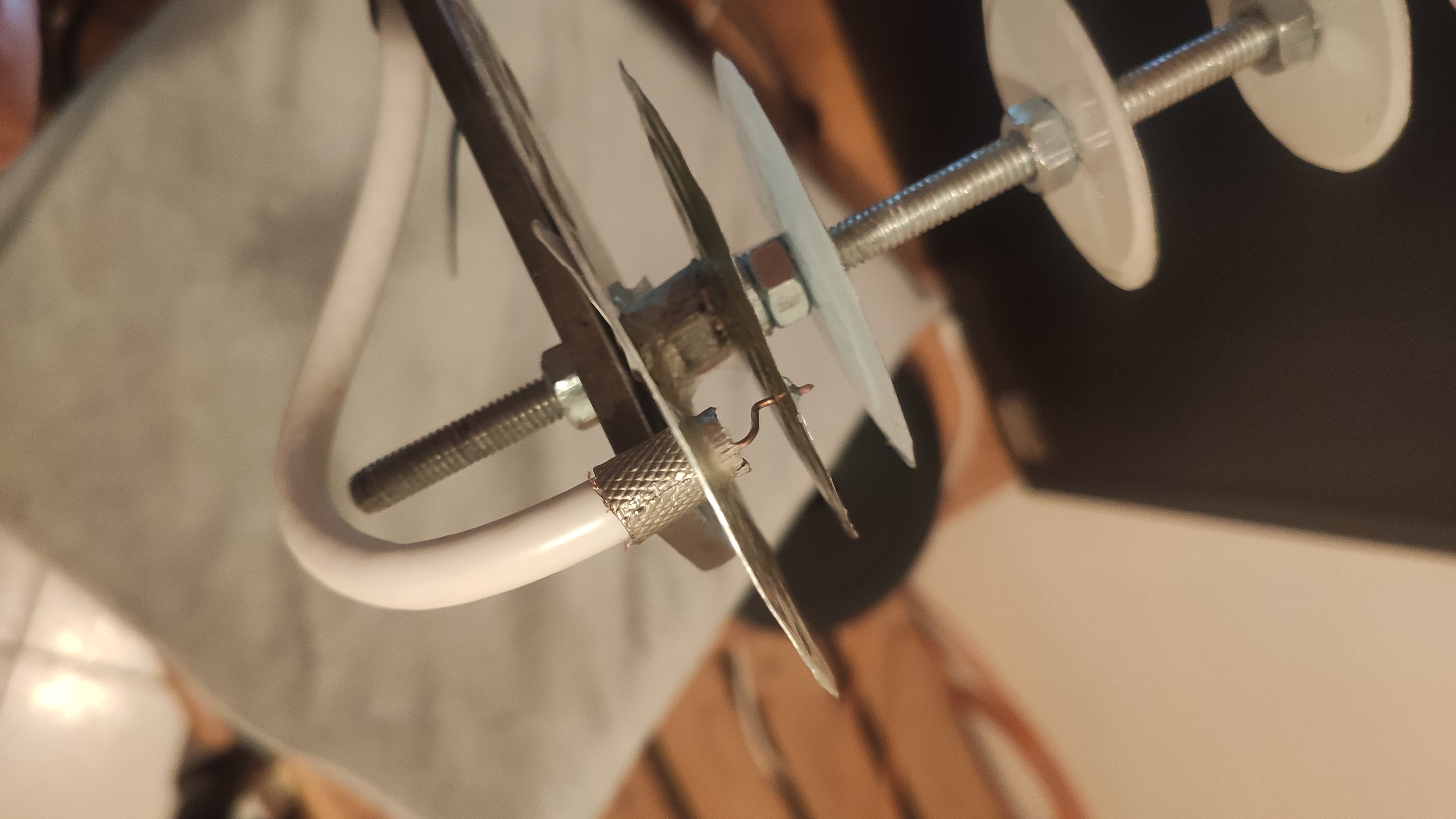

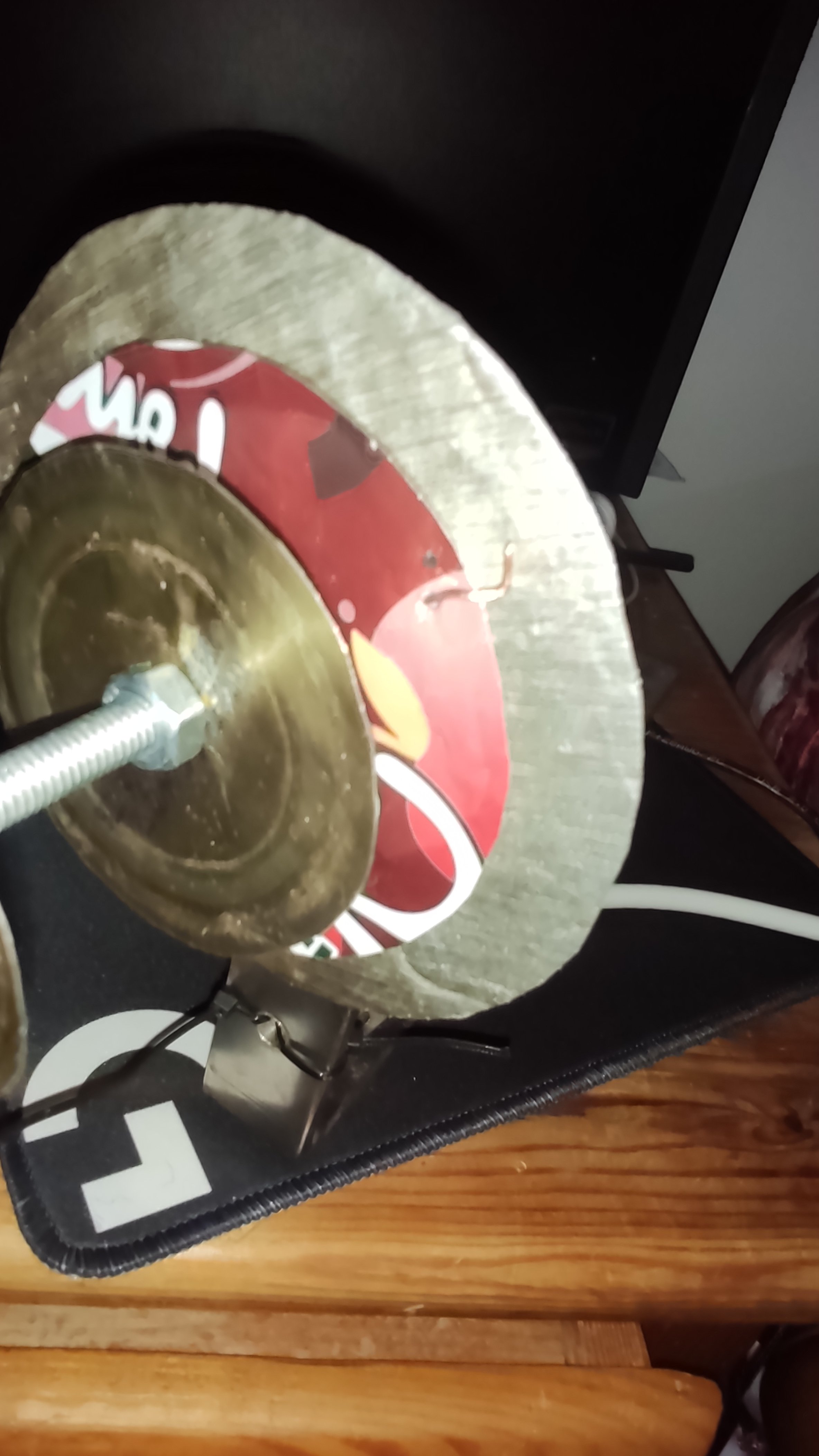

thanks i already made a normal circular one
can now tell me where should i solder the coax cable and the ground on it

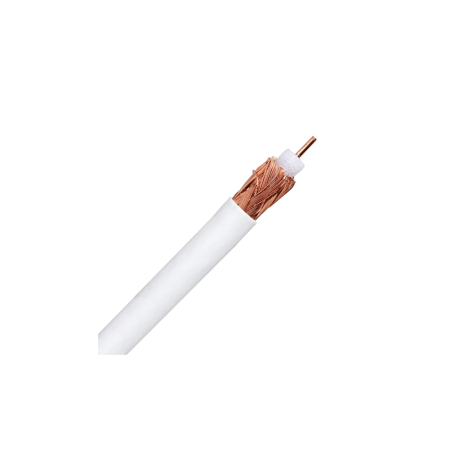

and also can i use this cable
,,,you can use a tin sleeve around the coaxial cable as below...
done and it's working.

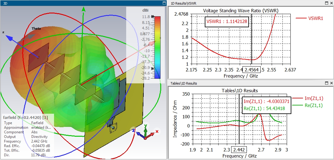

i saw in a YouTube video that we can upgrade this antenna by isolating the driven elements from the others is that true ???
,,,it is also possible with an isolator for the vibrator but to change the distance from the reflector...!!
do you have the simulation model for this antenna
can you share it with me please
