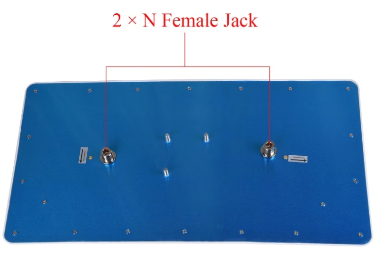

Connector: 2 × N Female

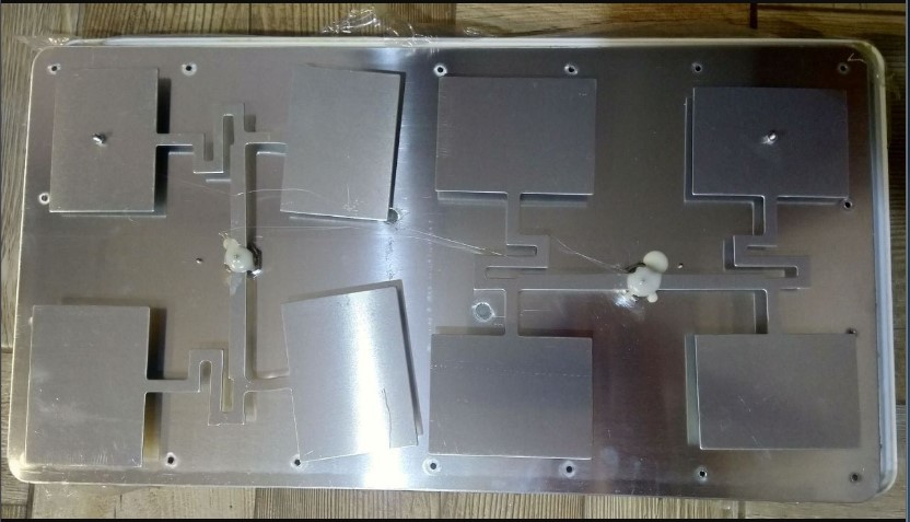

Looks easy to build
this is narrowband design, can cover 2440 +-40 MHz WiFi for example. This particular is sized to 2150+-30 MHz.
Because it is SISO design, you need 2 anennas and double total size for MIMO.
