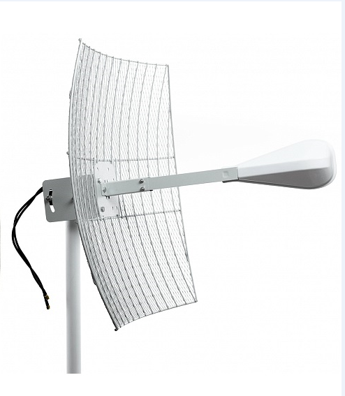

KNA27-1700/2700-27 dB Parabolic MIMO Antenna
The KNA27-1700/2700 parabolic MIMO antenna is designed to work in LTE 1800, 3G (UMTS 2100), Wi-Fi 2400, LTE 2600 networks at frequencies from 1700 MHz to 2700 MHz.

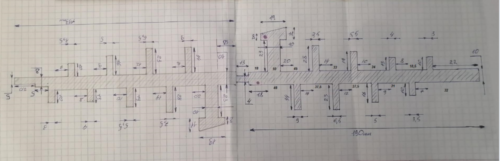

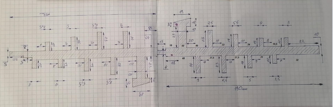

,,,these are the dimensions...
