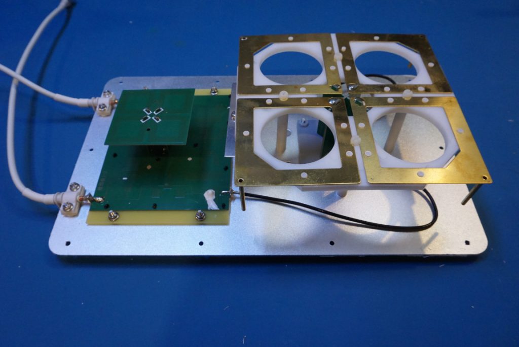

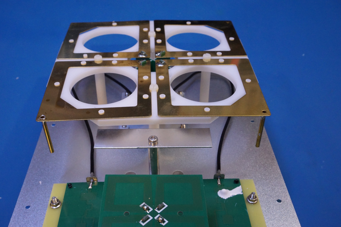

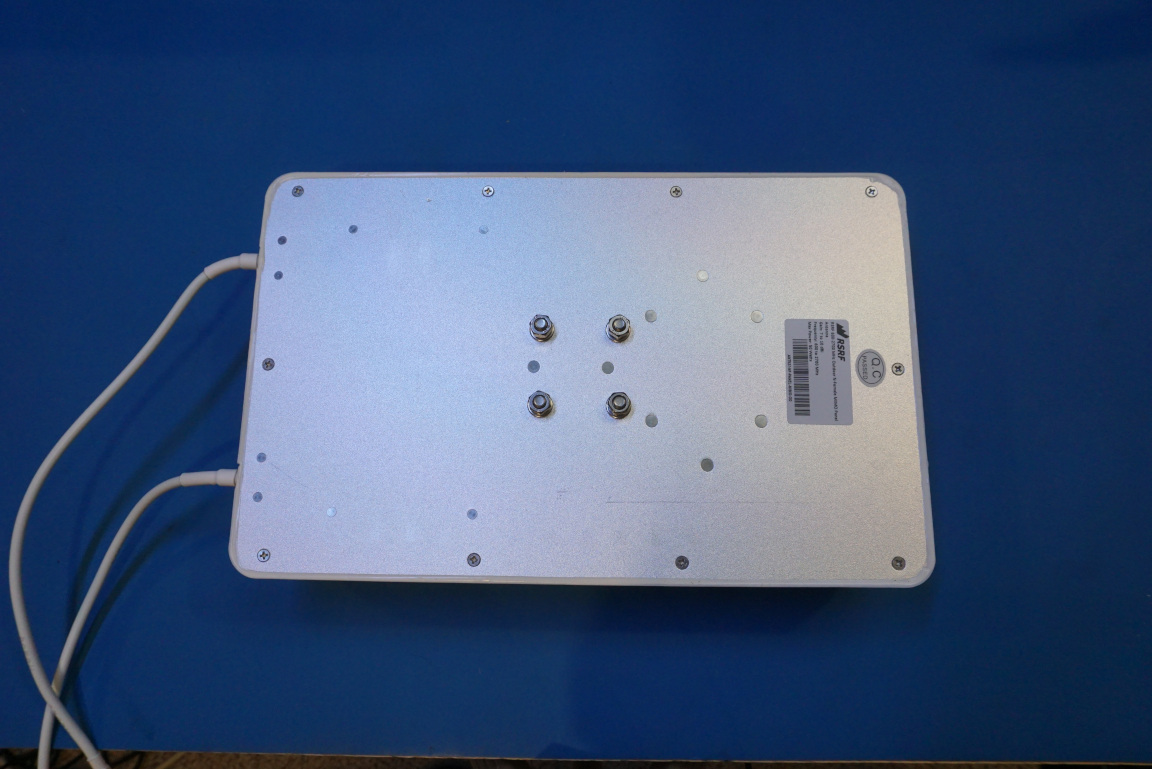

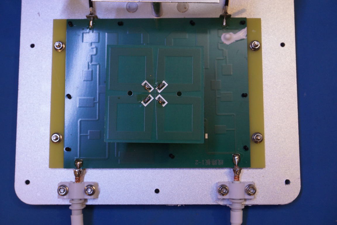

Teardown of an RSRF Cross-Polarized Dual Band Cellular MIMO Panel Antenna
This dual band antenna is designed and made by RSRF. According to the datasheet, it operates between the frequency ranges of 600 to 960MHz and 1690 to 2700MHz with a modest gain of 6dBi and 9dBi respectively. These frequency bands pretty much covers all the cellular frequencies used for 3G and 4G LTE in North America. You can also use this antenna for low-band and mid-band 5G applications. As the low-band 5G lies between 600-850MHz and the mid-band 5G is between 2.5-3.7 GHz. Although this antenna only covers a small portion of the mid-band 5G frequency range.
